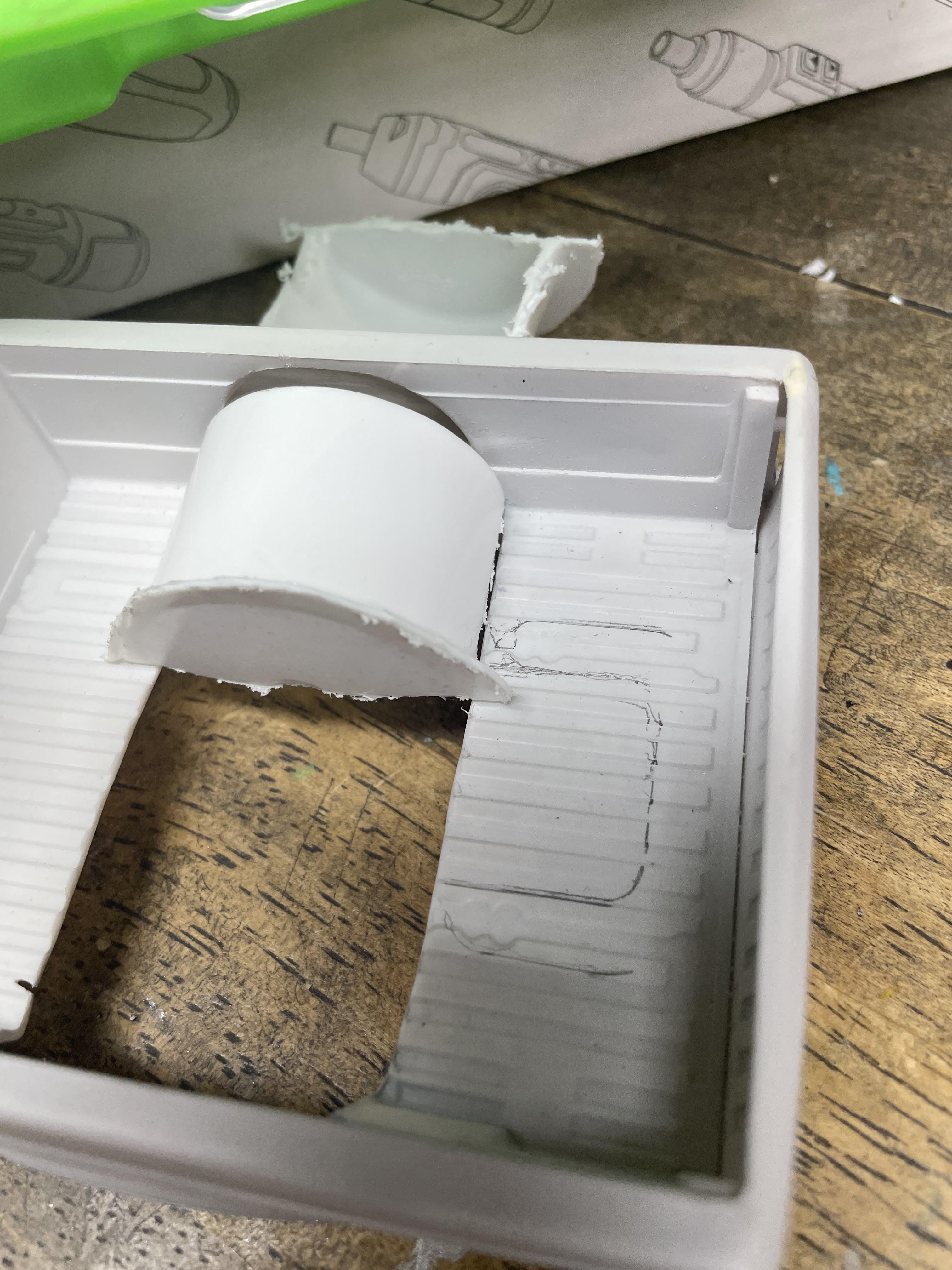

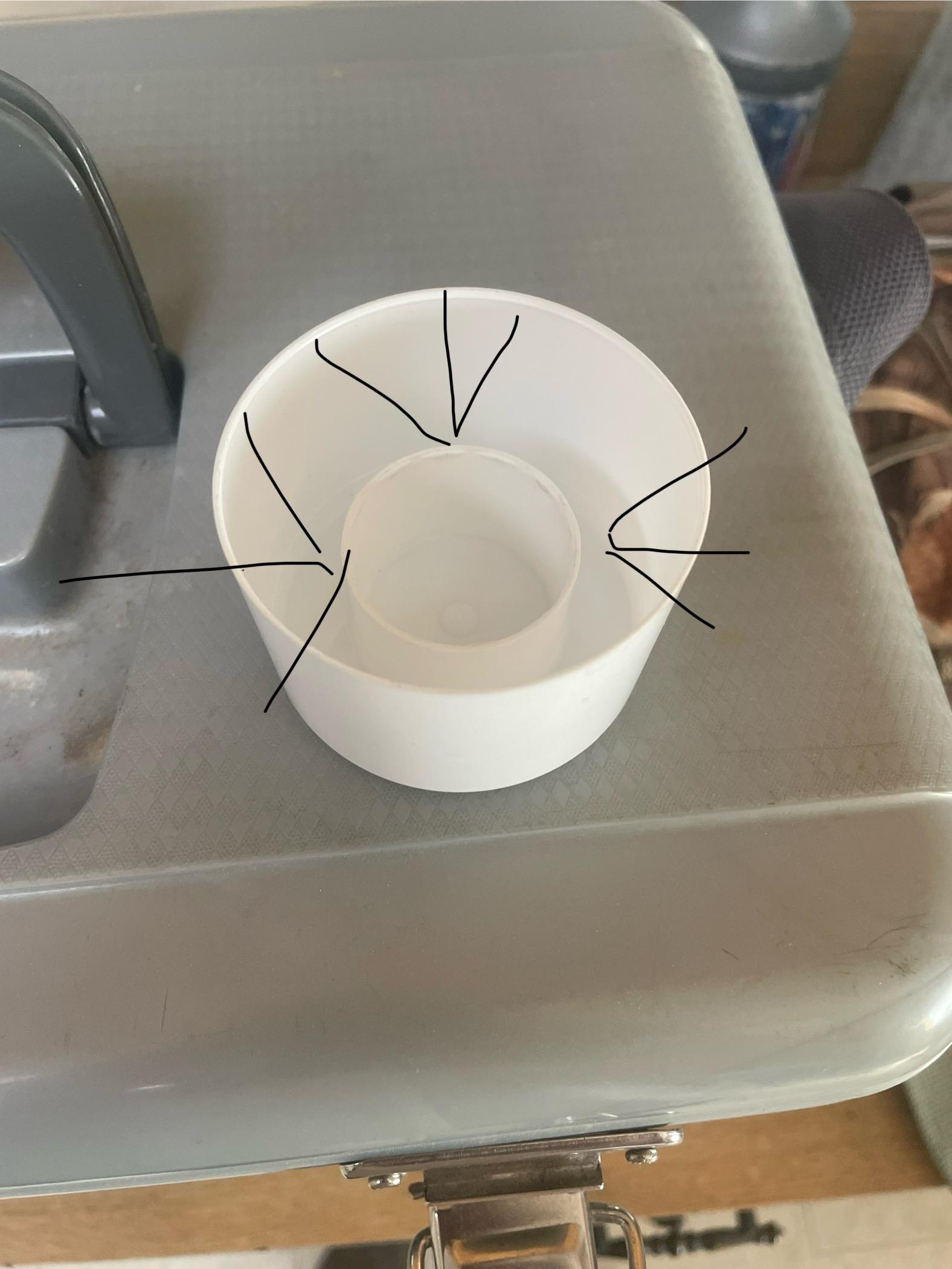

WayfromSmoke Posted 23 hours ago Posted 23 hours ago Idk if anyone can use this or not and Ive still got trimming and cleanup to do but I used a rattle can lids and cut the little inside part out and in half 1

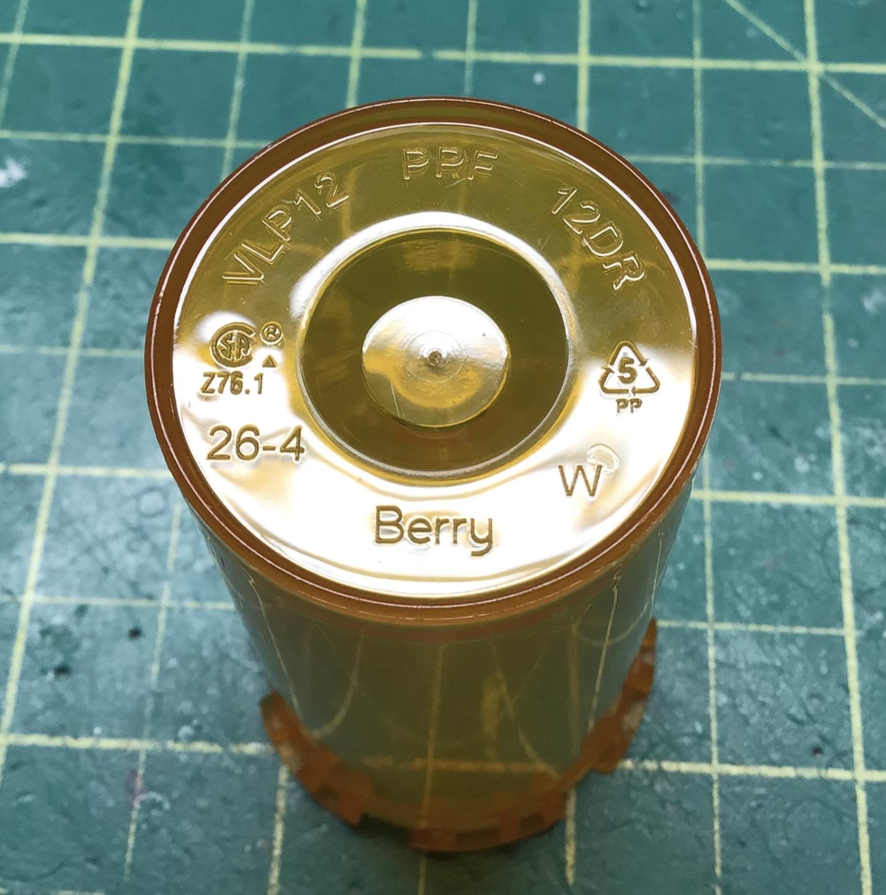

peteski Posted 14 hours ago Posted 14 hours ago The plastic can caps are made of doesn't take glue well, but in my experience neither do pill bottles, which are made from Polypropylene, not Polystyrene. At leas all the amber color pill bottles I deal with. Their recycling symbol is #5 PP.
Ace-Garageguy Posted 13 hours ago Posted 13 hours ago (edited) 6 hours ago, peteski said: The plastic can caps are made of doesn't take glue well, but in my experience neither do pill bottles, which are made from Polypropylene, not Polystyrene. At leas all the amber color pill bottles I deal with. Their recycling symbol is #5 PP. My most recent amber prescription bottles (2020) are marked PETE, polyethylene terephthalate, recycling #1, which will bond kinda OK with CA or epoxy if roughened, but much post-bonding handling is asking for failure. CA adhesion to PETE and other "low surface energy plastics" is enhanced by using Permabond POP primer or similar "adhesion promoters", and of course there are bonding materials designed specifically for this purpose, but the average modeler isn't going to buy expensive 2-component industrial adhesives. PETE and PETG are frequently used for replacement clear model car parts like windows, and are often held in place with PVA (the white glue family). But the bond isn't very strong, so fit needs to be precise and post-gluing handling should be minimal. Also please note: I specifically said: "If they're styrene bottles, they glue much better than most rattlecan tops will". I have had older bottles made of styrene, which is why I mentioned them. Edited 8 hours ago by Ace-Garageguy punctiliousness 1
peteski Posted 8 hours ago Posted 8 hours ago 4 hours ago, Ace-Garageguy said: . . . much older bottles made of styrene, which is why I mentioned them, but sometimes it seems almost everything I say has to devolve into an argument. Why do you think I'm arguing? I wasn't even making a counter point. I simply conveyed my experience as we usually do in online forums. Isn't that what the forums are for? To share modeling experience. All the amber bottles I have in my possession, some still with the current medication in them, and ones I collected over the last 20 years are made from Polypropylene. I also know that (as you also mentioned) most glues used by average modelers do not bond Polypropylene or PETE well. Using those materials for tubs usually means that they will likely be exposed to a bit more structural stress than a windshield. That's all I did - no need to get your feathers ruffled.

NOBLNG Posted 8 hours ago Posted 8 hours ago The ones I have are #5 plastic and Tamiya thin cement has zero effect on it.
