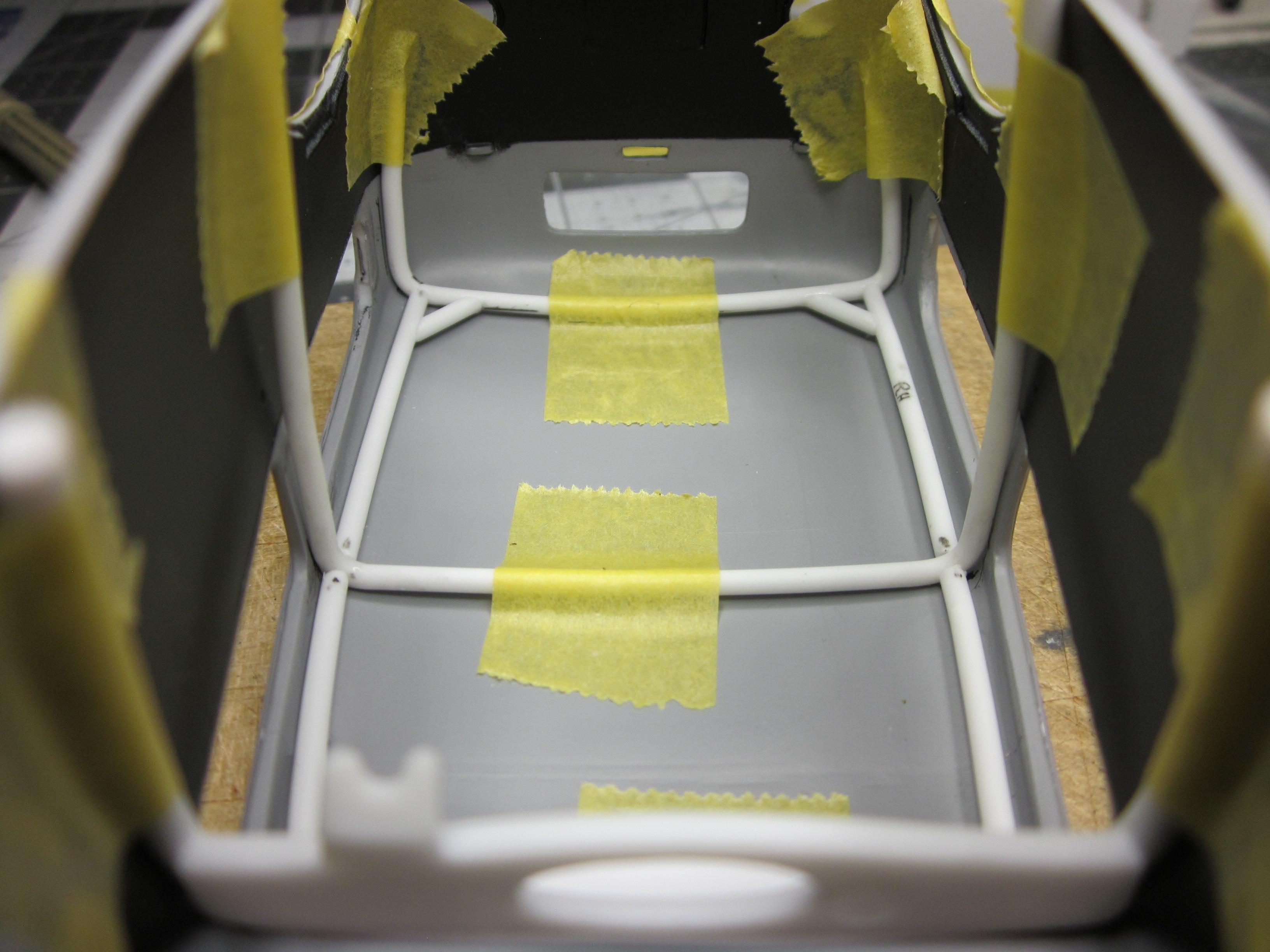

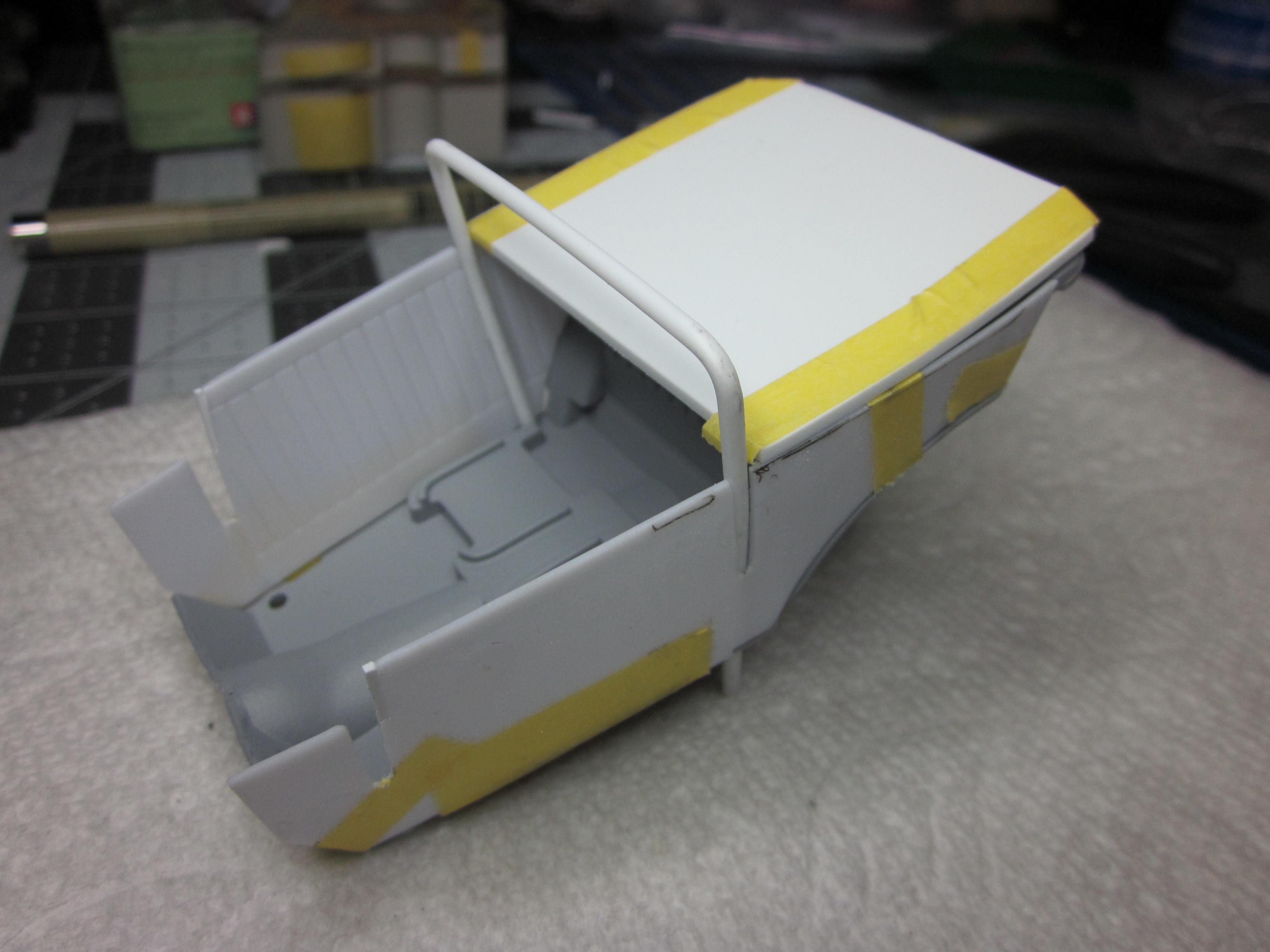

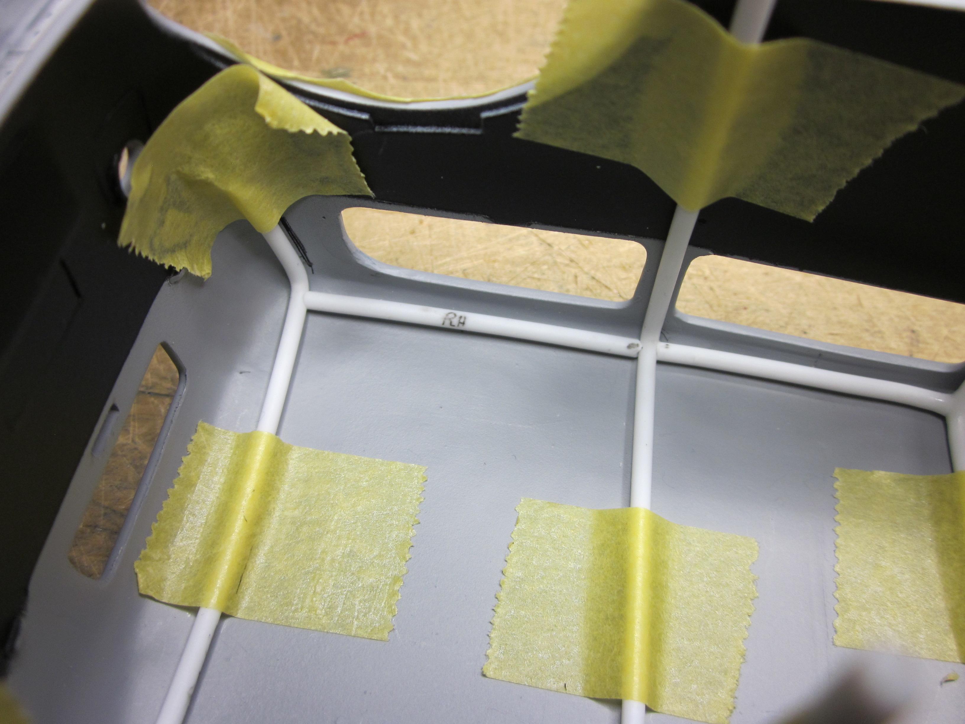

With all the things that have been done on this '32, I just had to throw in one more addition to the interior. Safety is always a concern and with that in mind, I decided to add a roll cage. I think I have figured out a way to build it in sections for ease of installation. I will be using .080 rod to build it with as It looks to be the right scale. Started off by bending up a main hoop that will be centered on the B pillars. The hoop was left long on the ends as it will pass through the floor. This allows it to be adjusted easly when installing. Holes were drilled in the floor and the hoop was put in place.
With the angles that the main hoop has, It will be necessary to file a slot int the door panel to get it to fit tight to the B pillar. This also proved to be a perfect way to keep the hoop centered while building other parts of the cage to it.
Next up is the front hoop. It was bent to fit tightly around the windshield and the dash. I found that incorporating the dash to the front hoop was the best way to keep everything tight to the cowl. Once I was happy the fit of the hoop and dash, they were glued together. At this time the door panels were filed so the front hoop fits nice and snug. Holes were drilled in the floor for the hoop ends to pass through. I will be leaving the hoops long till final assembly. At that time they will be glued and cut flush. And everything should fit nicely.

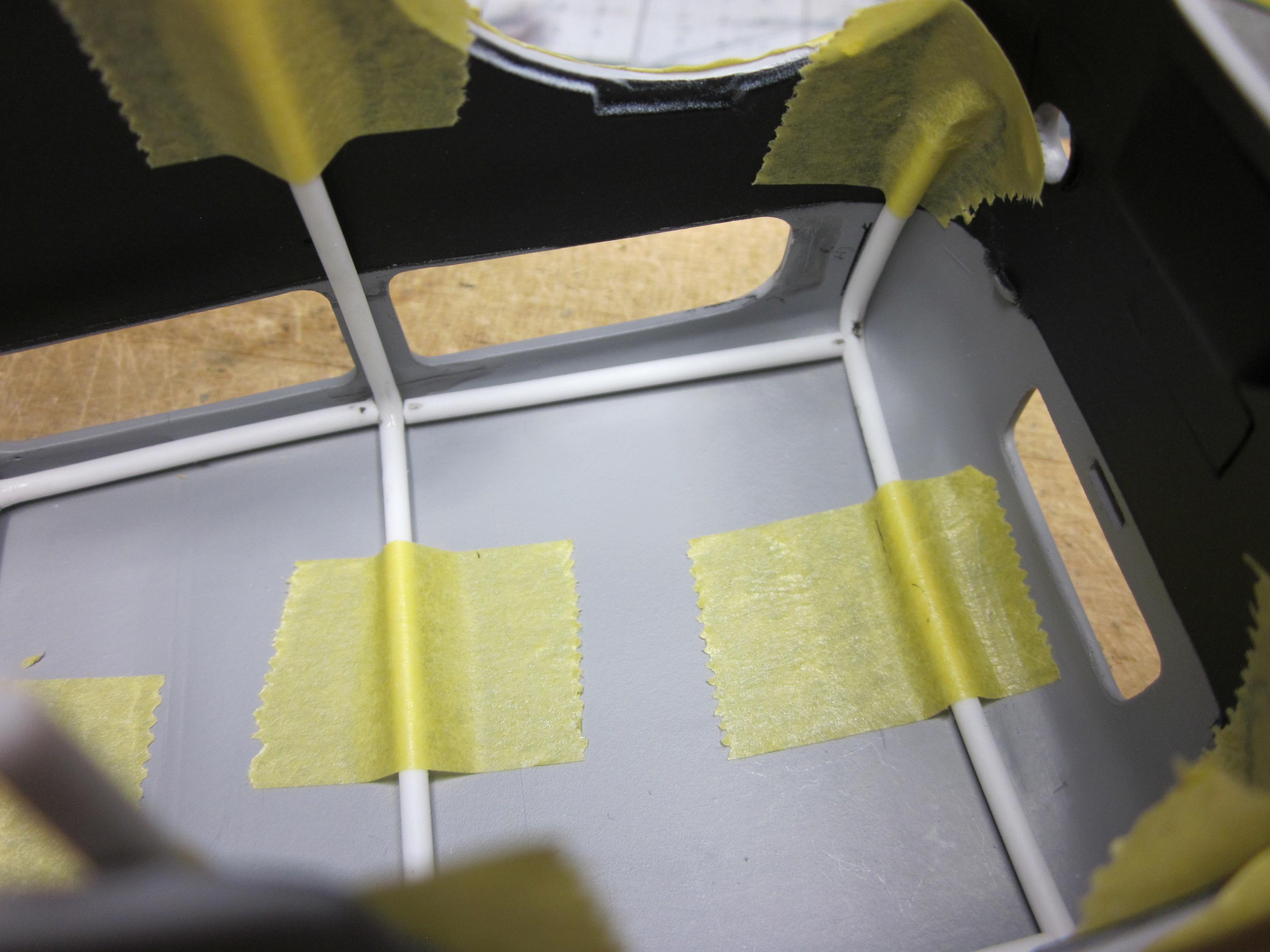

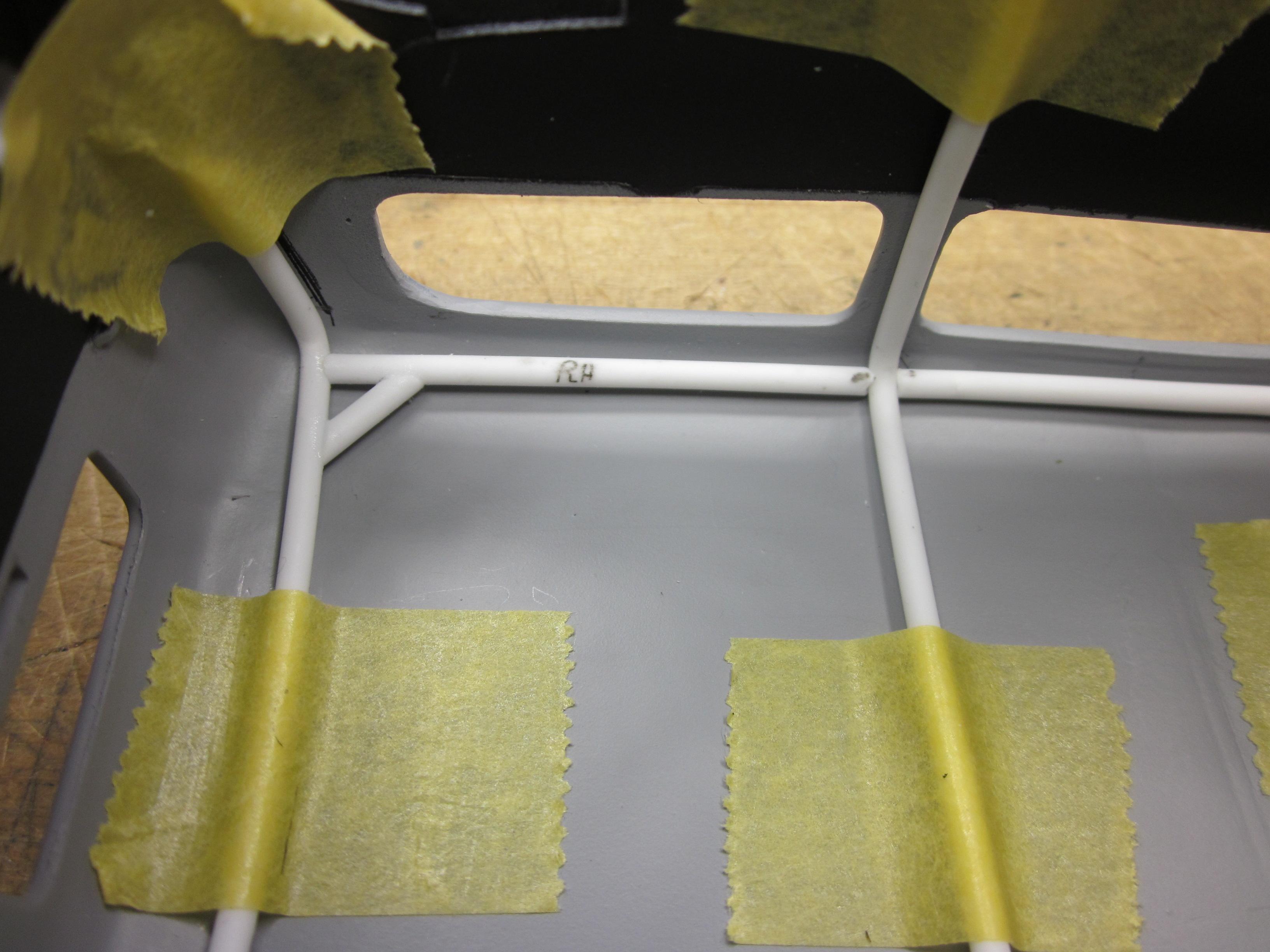

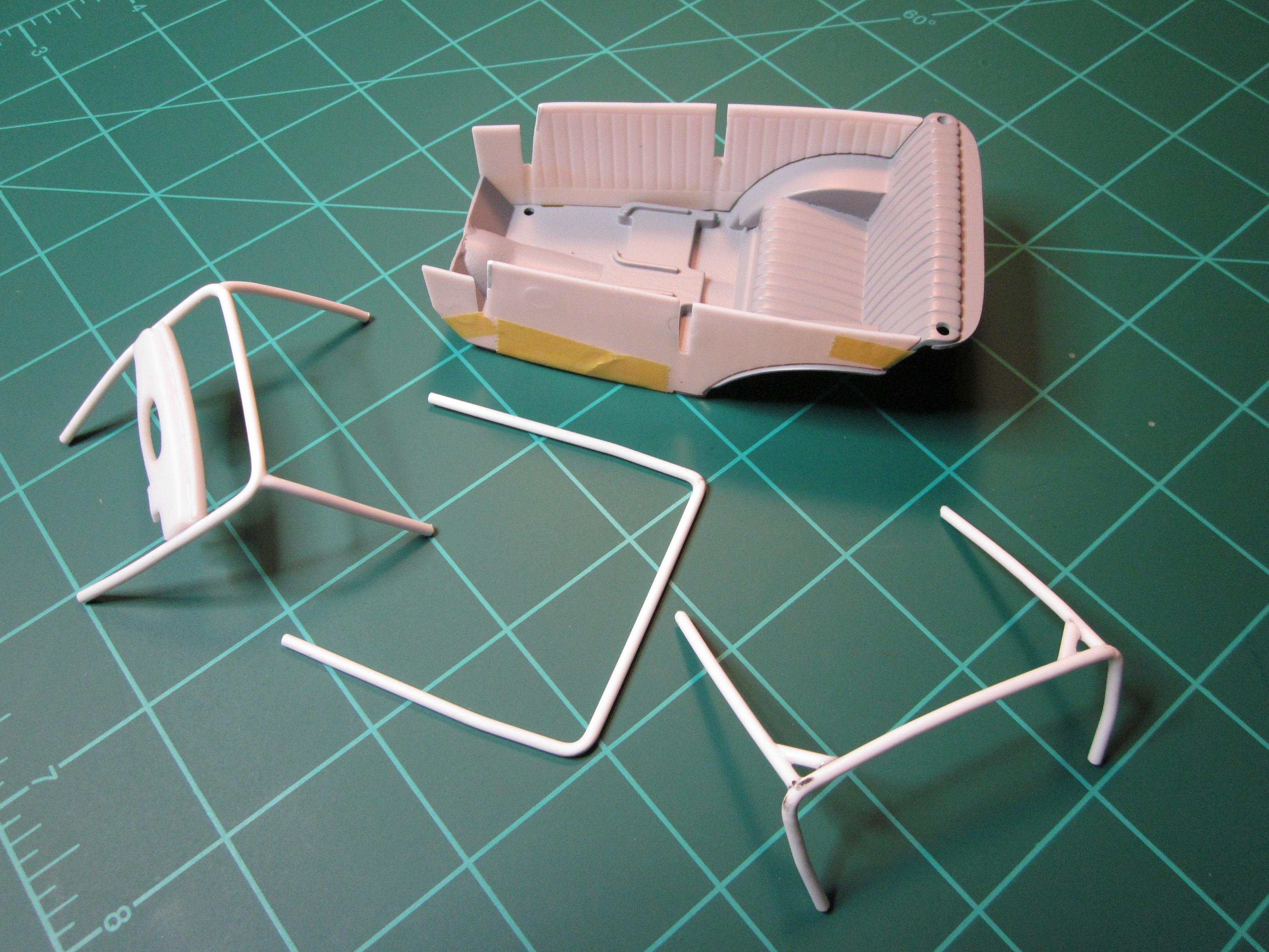

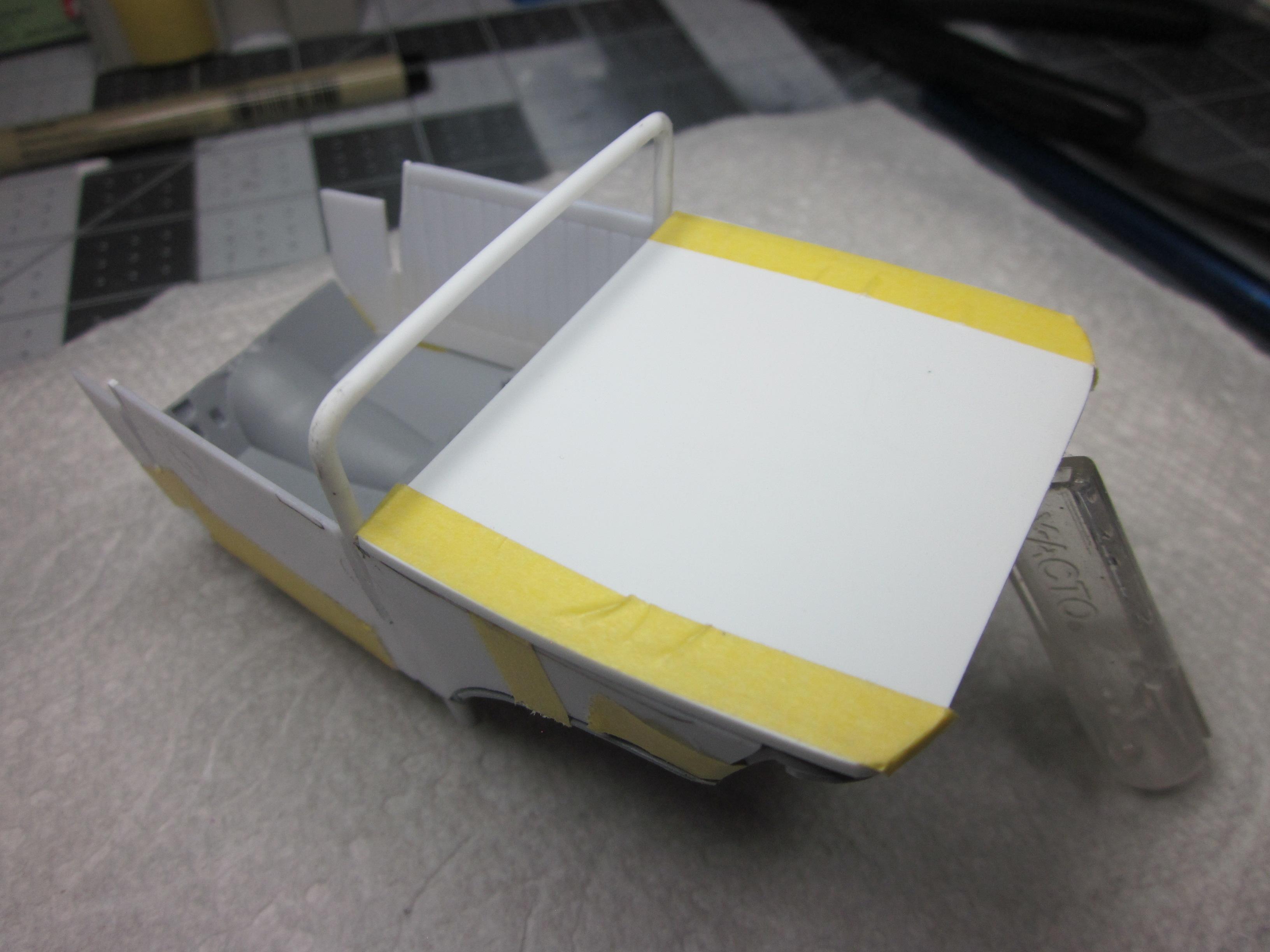

Got more done on the roll cage. Seems every step just wanted to challenge me as you can see by the pile of rod so far. As I had said, this will be done in sections. The front, middle and maybe the rear. It will only be glued at the bottom where the rod goes through the floor. The slots in the door panels are what is holding eveything in position with no chance of moving. This is how it will go together. First, the front part of the cage goes in first. It is the biggest part as it is the front hoop, dash and the top bars. It is put in at the rear of the body and brought forward to the cowl. It was made so the top bars connecting to the main hoop will not be glued. They are just a nice tight fit. To get the interior bucket inside the body, the main hoop must be pulled down being almost even with the top of the door panel. Once the interior bucket is inside the body, the main hoop can be pushed up inside the body against the roof. At this point the interior bucket can be lowered in place, feeding the rod through the holes in the floor.

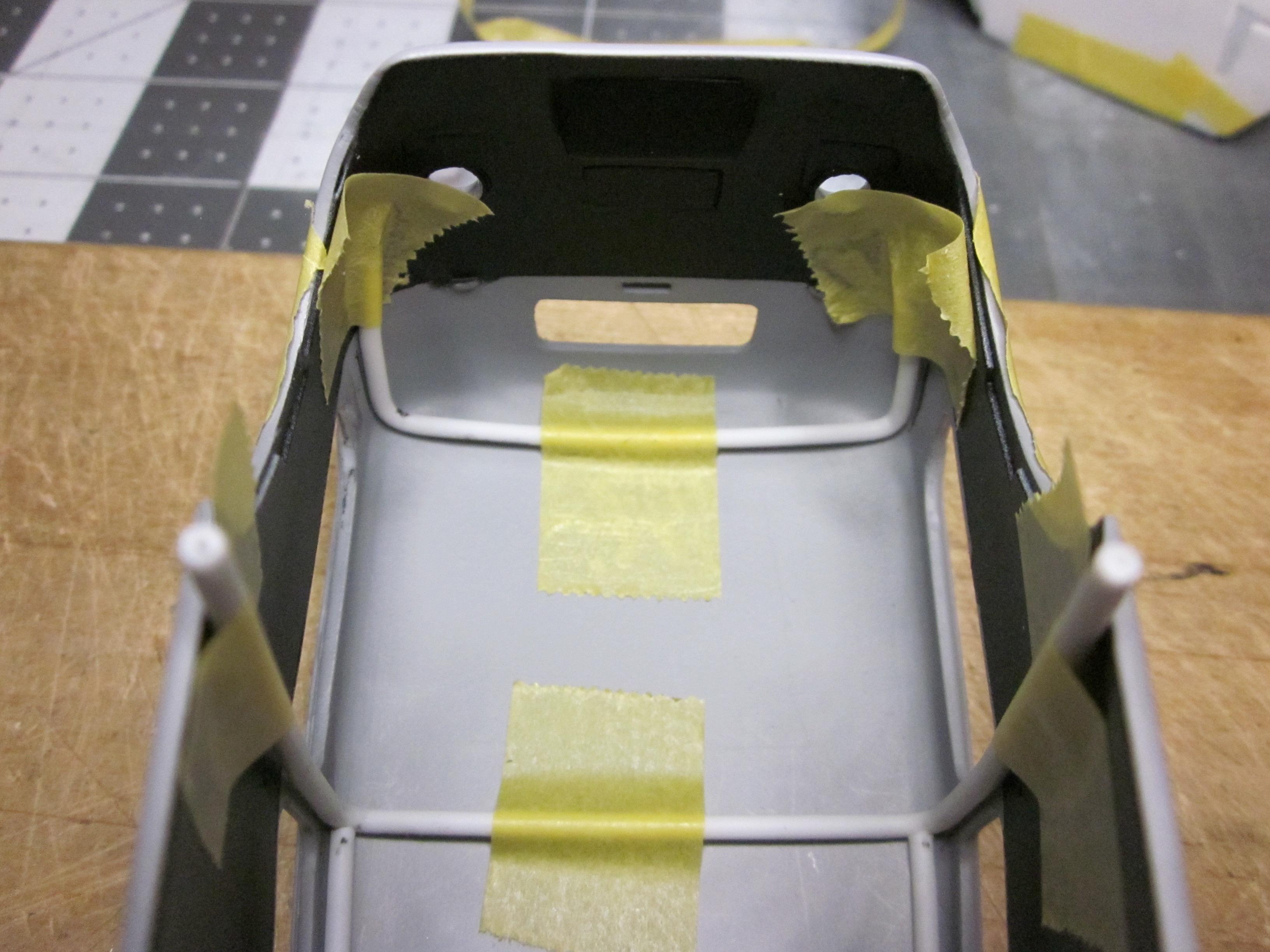

20 hours ago, customline said:
Can you feed the rear tubes up through the bottom through slant-drilled holes, up against the sides of the rear seat ?
Appreciate your input Jim, I have looked at several different ways to build this part of the cage. The way you mentioned is one of the easy ways of going about it. Right now I'm toying with the idea of a tannue type cover. This would allow me to just build the rear part of the cage too the cover for ease of assembly. What you can't see, can't hurt ya kind of thing as far as where the bars go under the cover. This is just something i'm looking at doing. Not in stone.

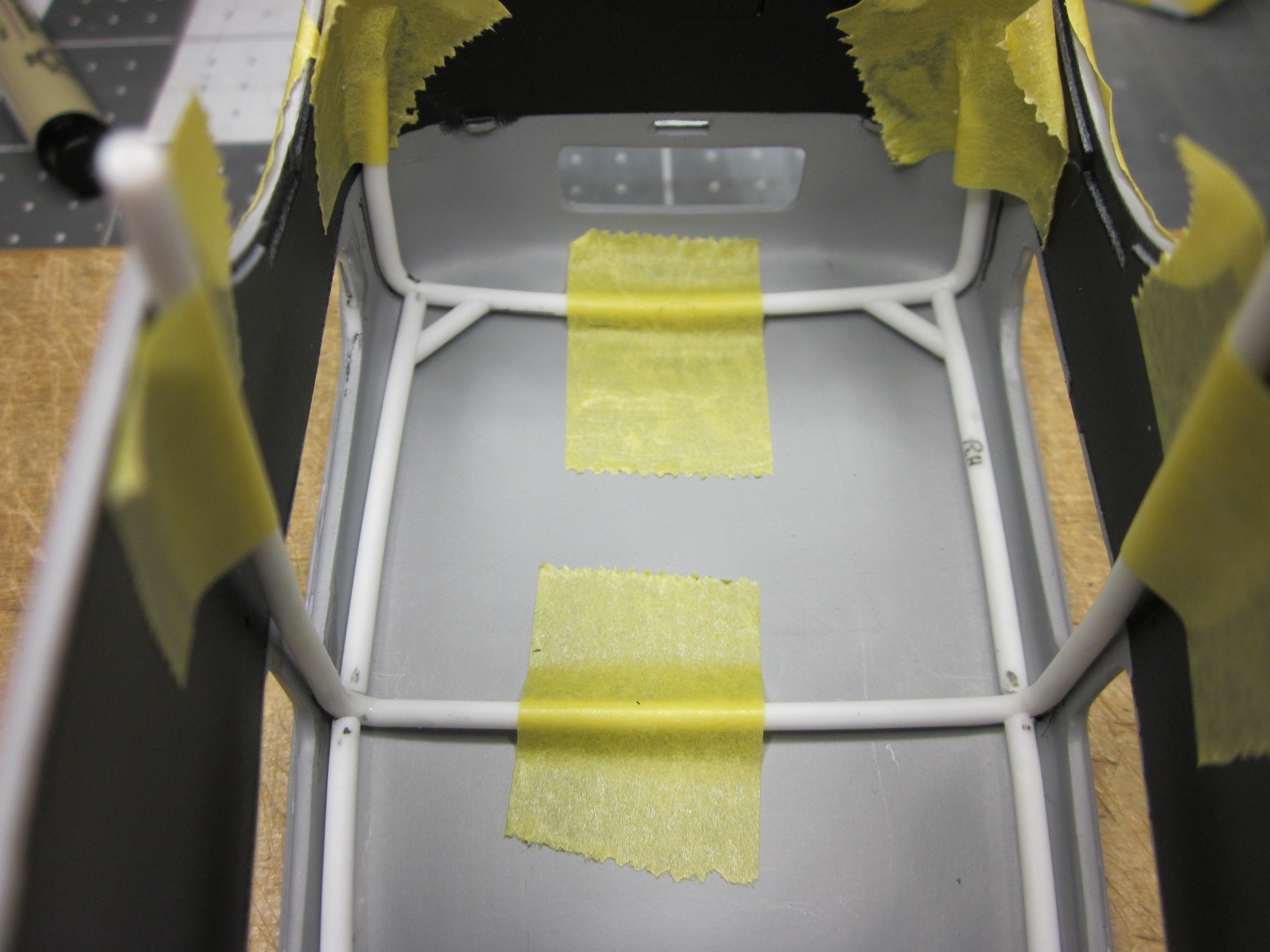

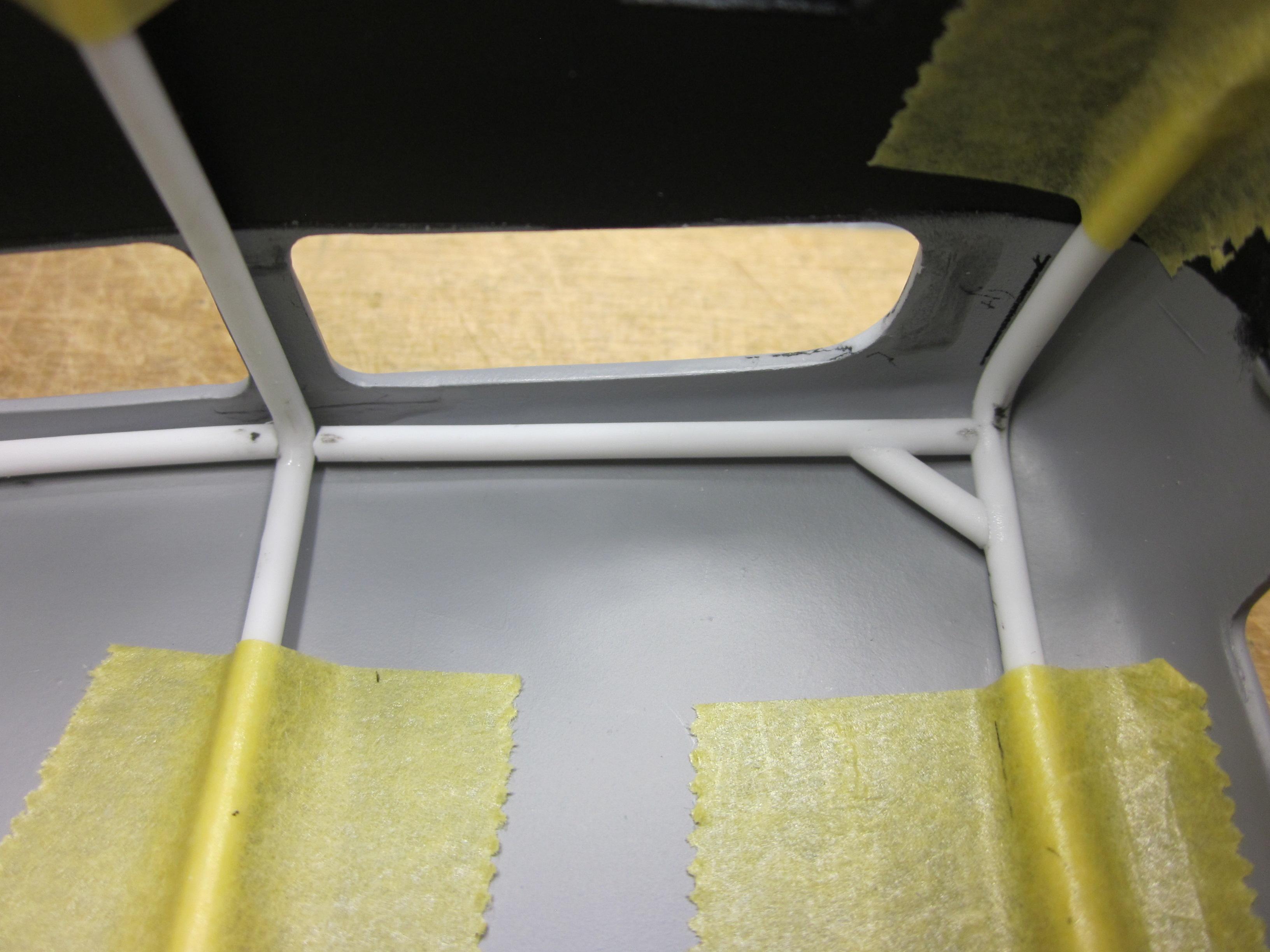

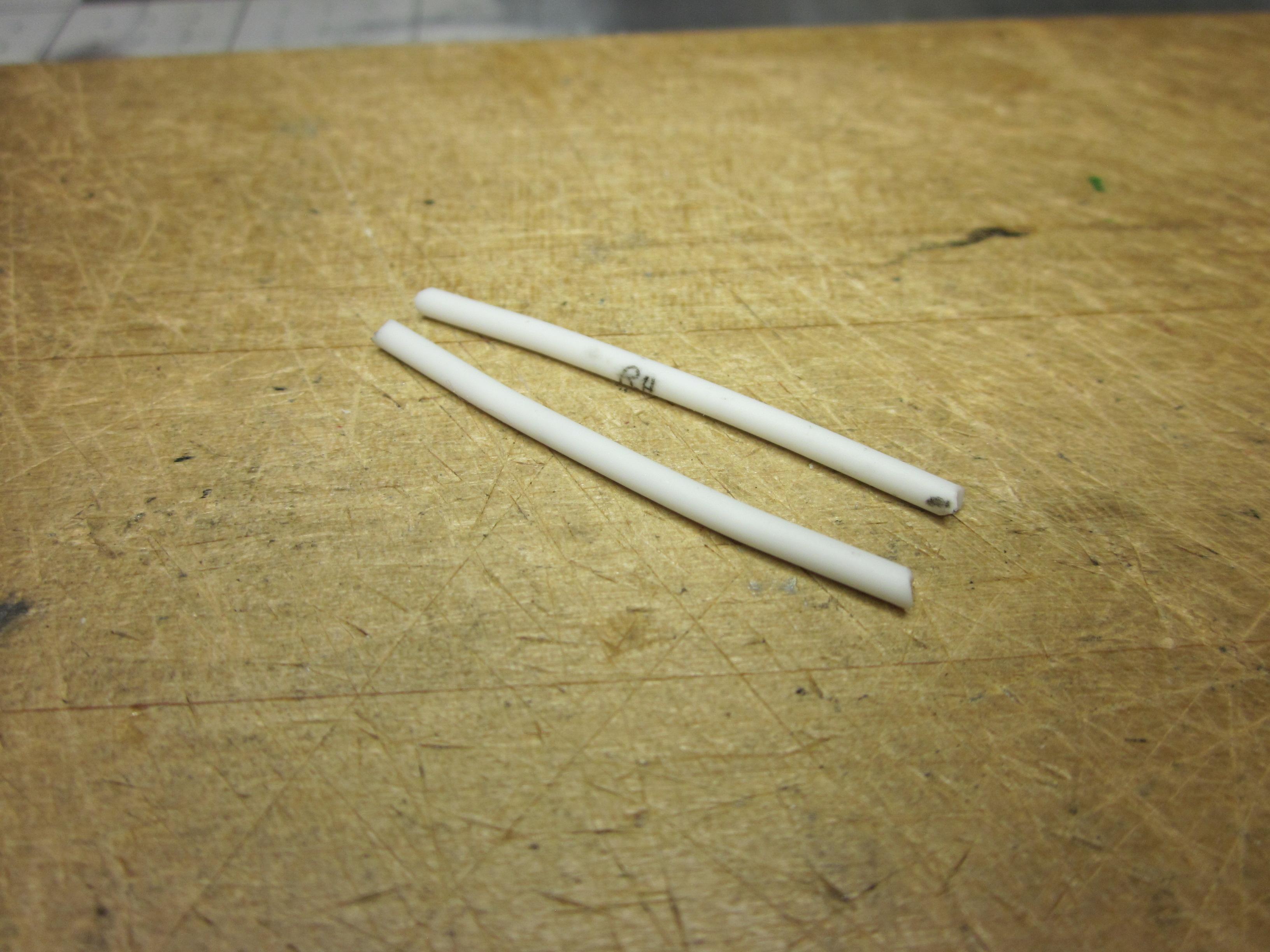

After trying a few different ways to build the rear part of the roll cage, this is what I came up with. It's done with the same concept as the front part. I built a separate part that will install like the front part of the cage. The front cage and main hoop pass thru the floor, this part passes through the top of the back seat. A couple gussets were added to help keep it together. Kinda tricky getting everything in at the same time, but it works. I think that in the end, this was a unnessesary feature of the car as you really can't tell it's in there. I'm hoping that after it's all painted and against a contrasting color it will be more noticable. Time for some paint.
