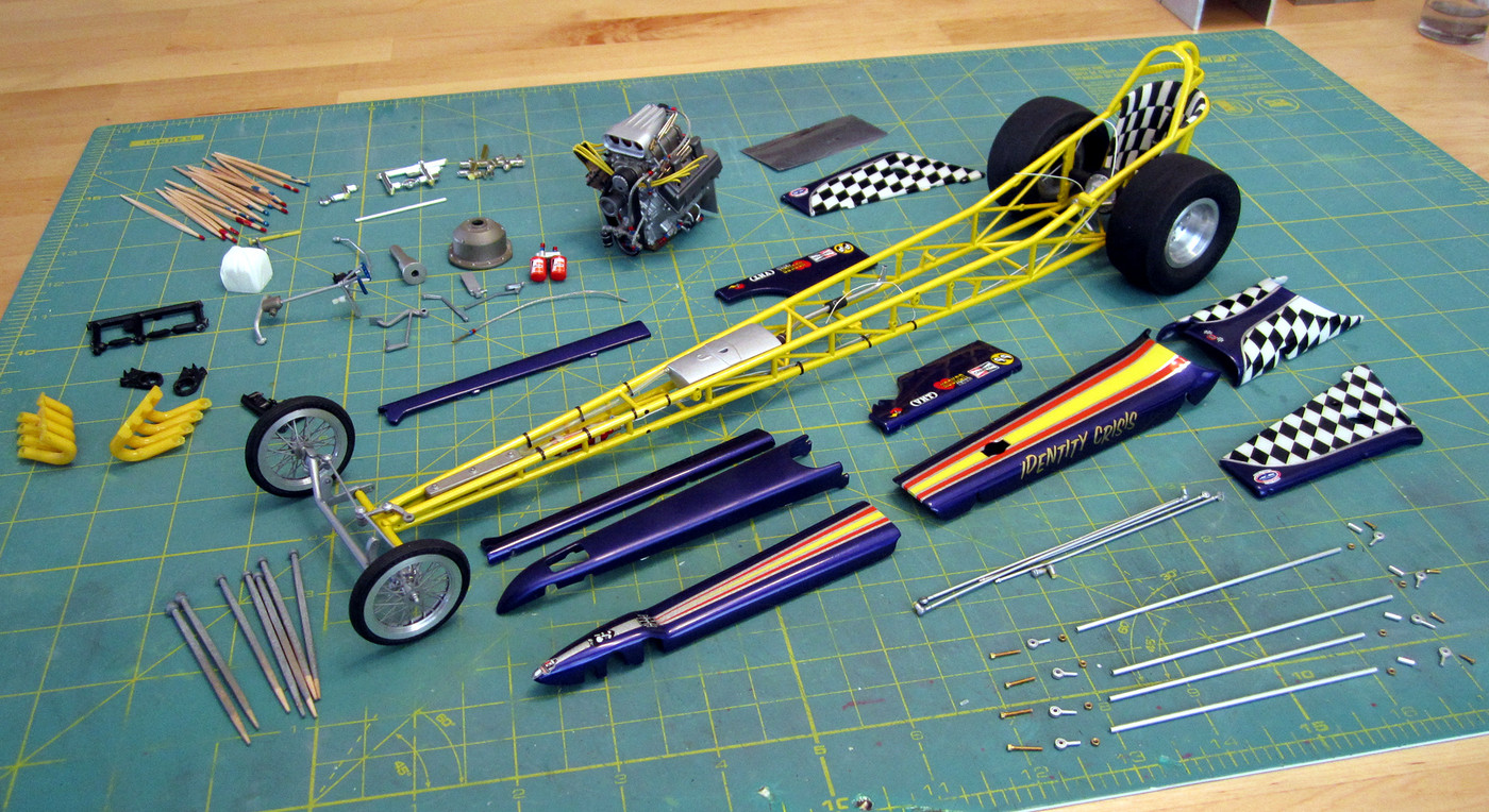

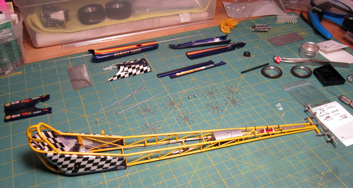

Mooneyzs Posted March 17, 2014 Author Share Posted March 17, 2014 (edited) Well Fellas... In the midst of building the Army Vega Funny Car, I have decided to knock the dust off of this build that I started 17 years ago and of which I painted 3 years ago right before I dove into the Army Vega build. And well since I have not completed a model in the past three years I figured it was time to finish the one. Keep in mind that everything you see here was done when I was about 20 years old Everything that you see in the 1st pic is what has been sitting for the past 17 years other than the Machined Aluminum Specialties Photo-Etch Wire wheels and the new radius rods. This weekend I worked on the Wire wheels and the updated radius rods. There isn't a whole lot left to do to this build and with our Local Contest coming up next month, I wanted to have something to enter since I didn't enter anything the done for the year before other than putting the funny car on the display table. Here are some pics to share... Â Â Here is a quick over view of all of the parts. Everything seen here was done as I mentioned 17 years ago, other than the paint and the front wire wheels: Â Â Â Â Here was the start this weekend when I was going to redo the radius rods and make the front wheels, as you can see I removed the radius rods already in this shot: Â Â Â Here is the kit radius rods removed and the new ones mocked up on the chassis. I ended up using 1/16" dia aluminum tubing and I decided to try out the TDR rod ends. I really wanted to use RB Motion rod ends because I think they look better but I only had one pack of 4 in the size I wanted plus I didn't want to dump a whole lot of extra money into this one: Â Â Â Â Upclose Shot: Â Â Â And another view: Â Edited July 14, 2017 by Mooneyzs Quote Link to comment Share on other sites More sharing options...

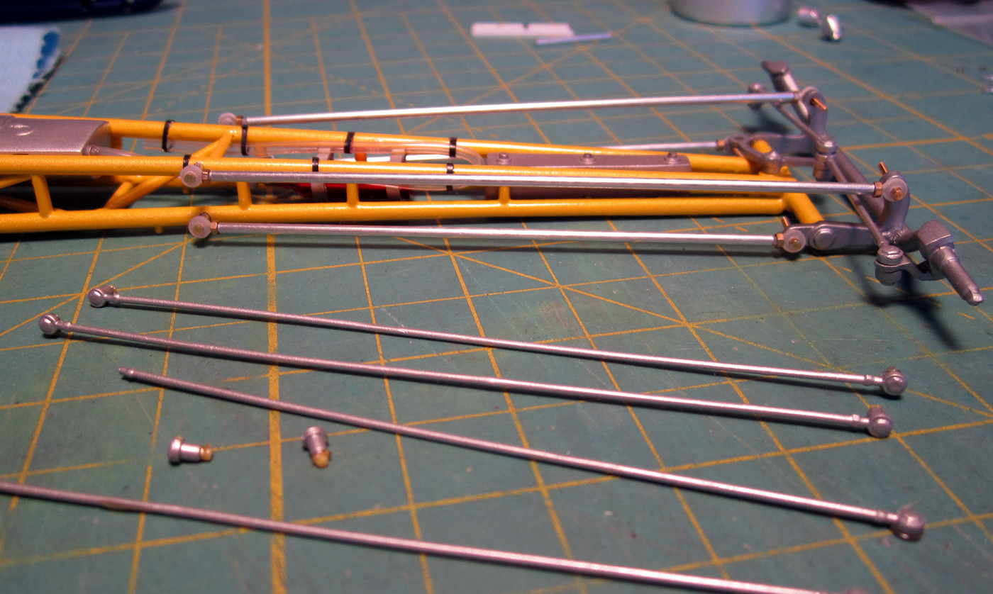

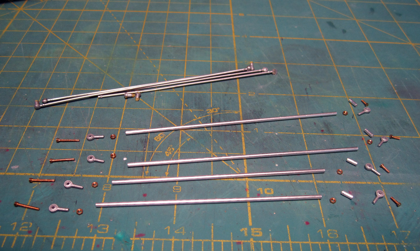

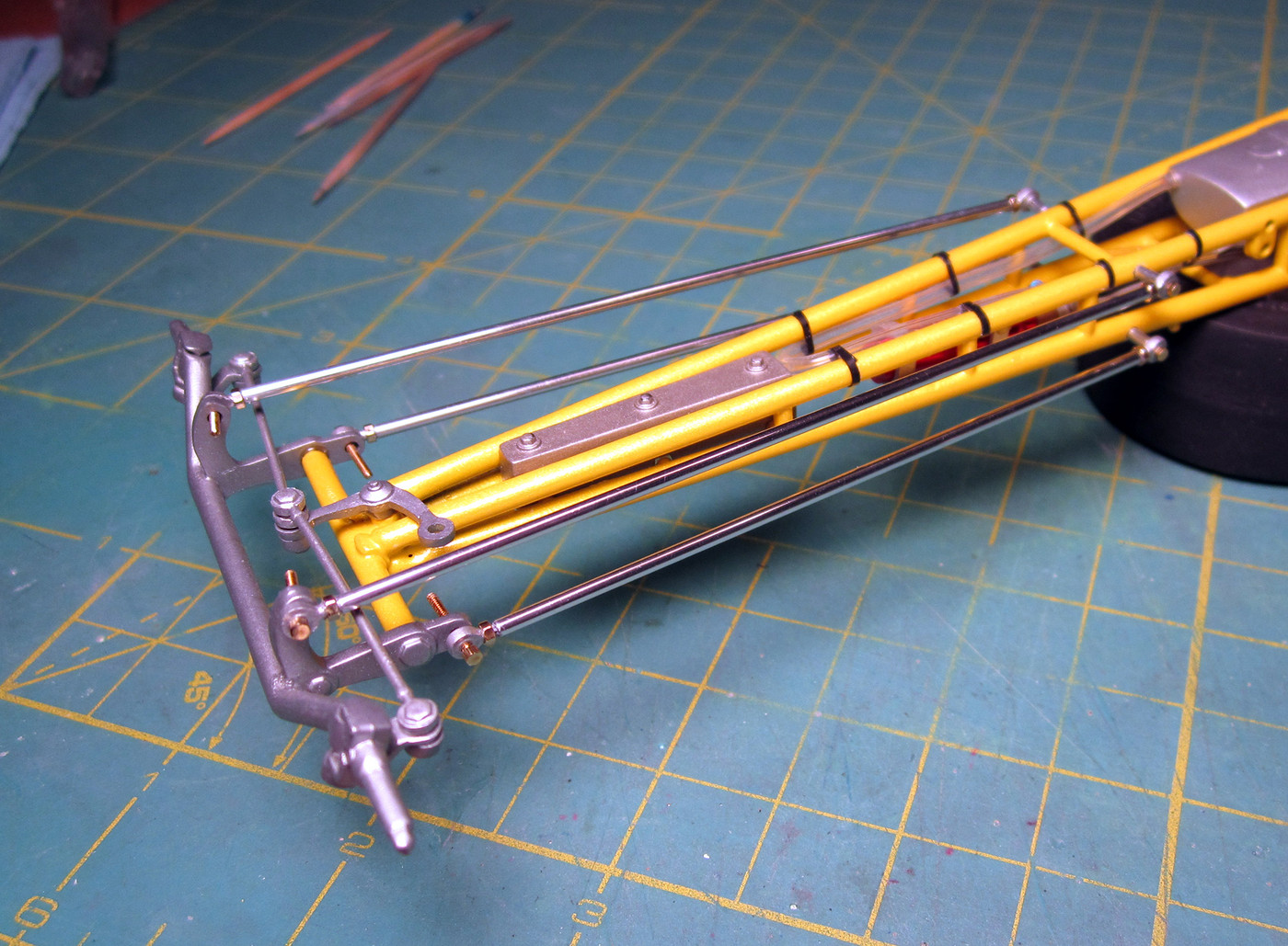

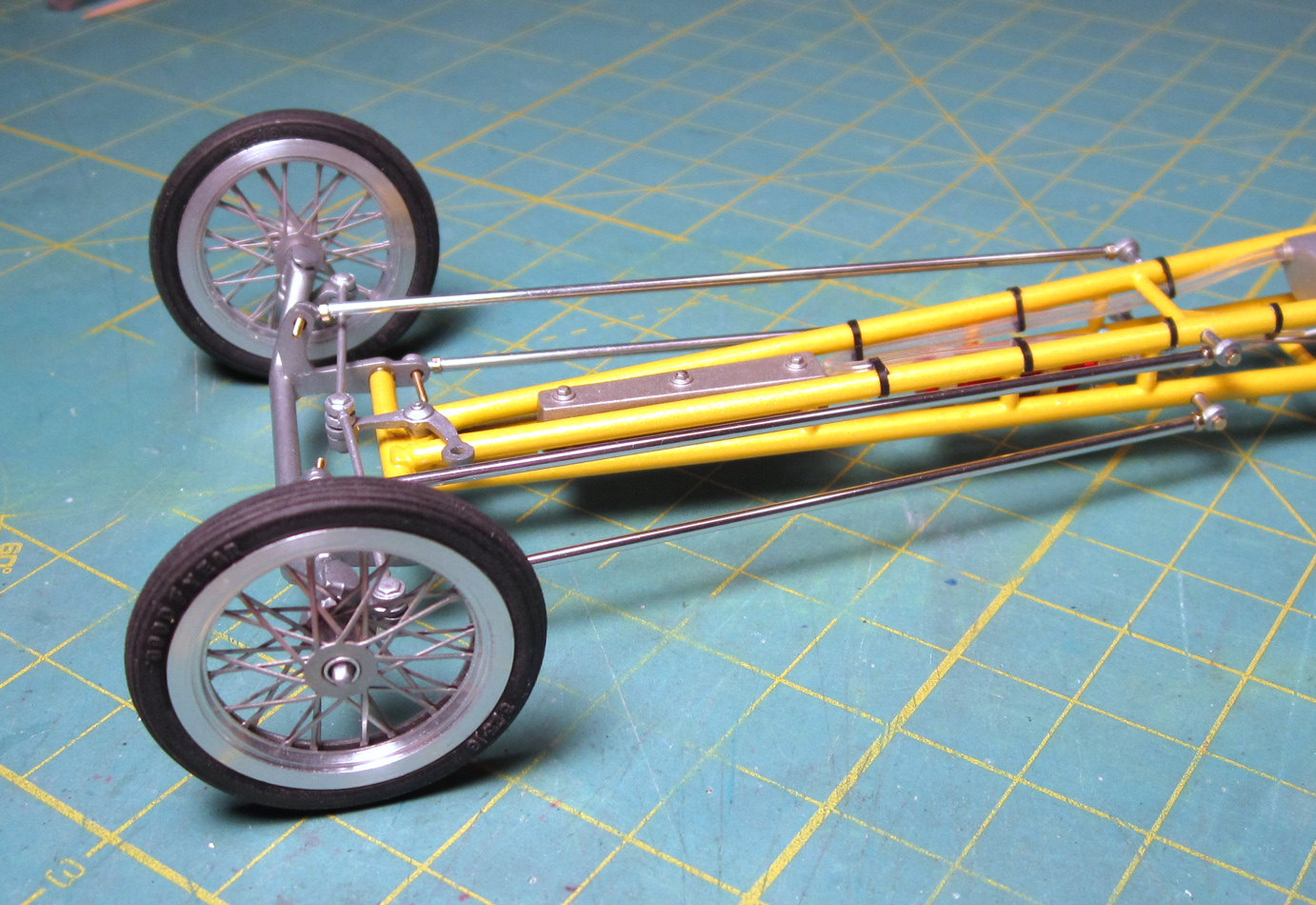

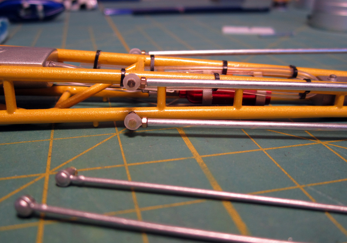

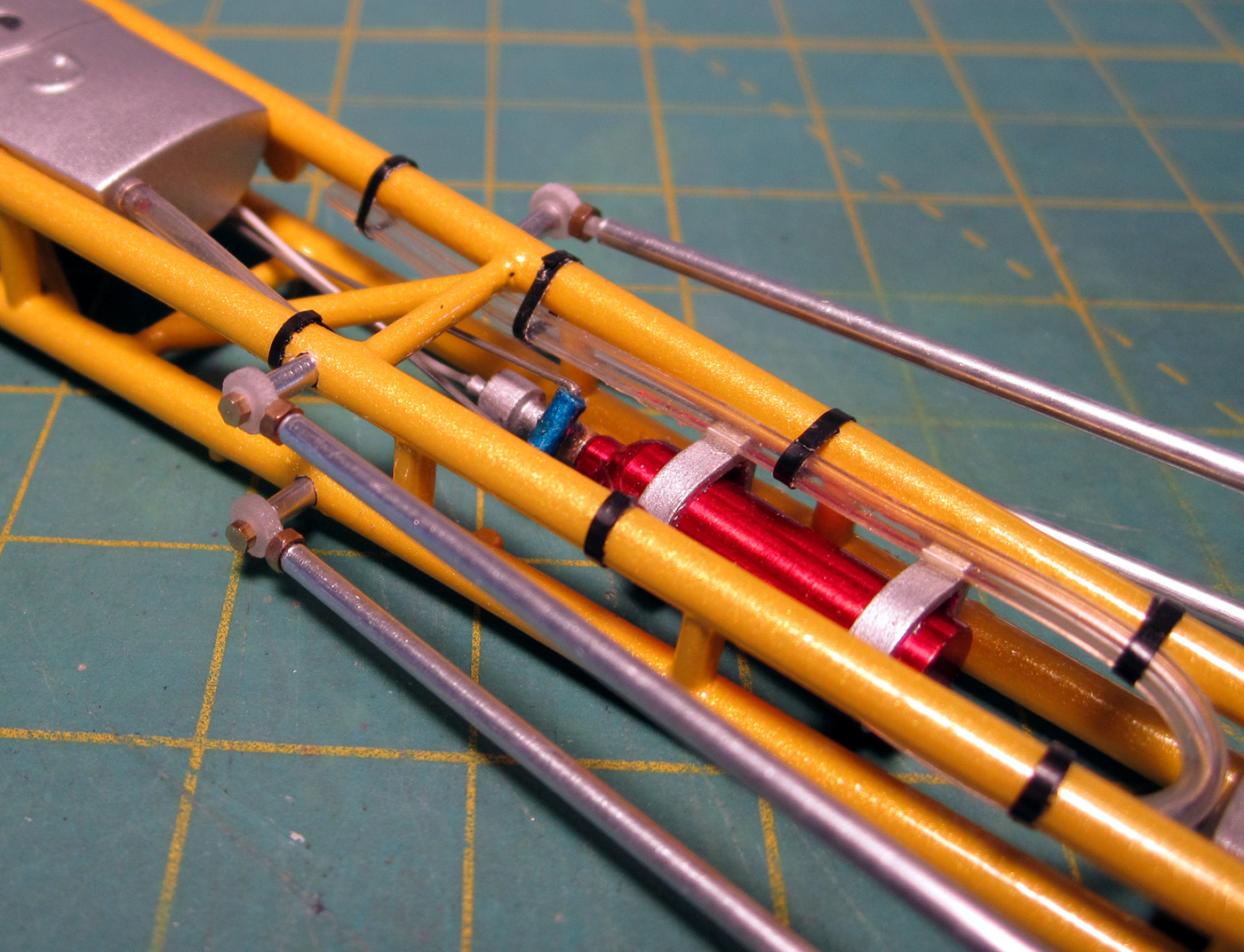

Mooneyzs Posted March 17, 2014 Author Share Posted March 17, 2014 (edited) Here is the kits radius rods removed and the new radius rods I fabricated. I painted the rods a silver color and used scale hardware nuts to go on the rod end and polished the aluminum tubing: Â Â Â Â Here are the MAS photo-etch wheels. Man were these a bugger to put together. They had me frustrated for sure. I have a few more sets of these for some other build but I will have to make a jig or something to better align and put them together. But I will say that they look a little better than the kit wheels but my other sets the main rim portions look better because they aren't as big: Â Â Â Â The new rods mocked up, I need to cut down the long bolts for the front and then just glue them in place then they will be done: Â Â Â Â Here is a straight on view. Now I am not sure on the real cars if they tires camber was like this or not and wondering if it was just the way the front end went together way back when I did this but I am half tempted to heat the front end up to try and make the wheels have a little less camber in them...lol: Â Â Â Â Â Another shot of the front end: Â Edited July 14, 2017 by Mooneyzs Quote Link to comment Share on other sites More sharing options...

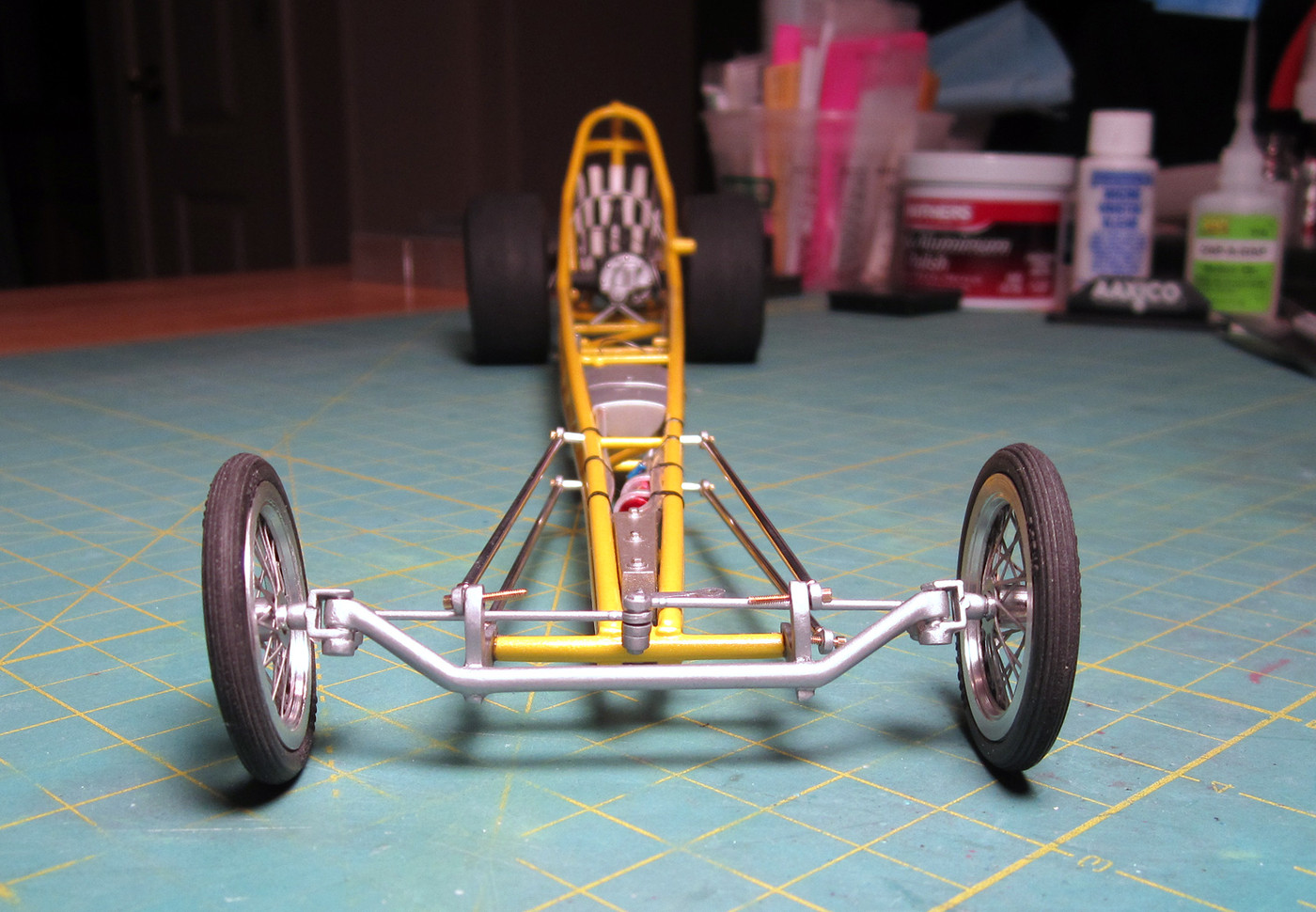

Chi-Town Hustler Posted March 18, 2014 Share Posted March 18, 2014 (edited) Chris, Top notch, incredible work as always.... As far as the front wheel camber question, I can recall seeing several photos of older diggers with the fronts cambered outward a slight bit, but can't recall ever seeing any that were cambered inward....That might be a real handful to drive!!....Not saying they couldn't be but my recollections were either outward a slight bit or straight up and true.... Out of curiosity, how were you planning to heat up the front end without risking damage if I might ask?.... Or, is there possibly a way of redoing the bolt holes on the top of the "C" joints where they attach to the front axle to achieve a truer vertical camber?....Just a thought....Either way, it's a stunning model to say the least!! Cheers Edited March 18, 2014 by Chi-Town Hustler Quote Link to comment Share on other sites More sharing options...

bobthehobbyguy Posted March 18, 2014 Share Posted March 18, 2014 Chris I think that trying to use heat to fix the camber isn't a good idea. Are the spindles plastic or metal. If they are plastic you could adjust the camber by redrilling the holes. Quote Link to comment Share on other sites More sharing options...

Mooneyzs Posted March 18, 2014 Author Share Posted March 18, 2014 Danno.... Thanks buddy. I had to have something to show next month Bob... The spindles are the plastic kit ones and the way I have glued them in and did the body work on the axle, don't think there is an easy fix for it....lol I could see if I could cut the axles off and redo but sorta leary at the moment on it...haha Kevin.... Hey Buddy its great to see you on here. Hey will you PM me your email Addy I have some photo's I want to send to you that I told you about a while back, I finally got them scanned into my computer. Hope you are doing well. You should show some of your gorgeous builds here. Have you talked to Paul or George lately?? Tell them Hi the next time you see them. Dave... Thanks buddy. Yeah Its gonna feel good to get this one into the Done bucket...lol I think it will turn out ok. Just the camber on the wheels is bothering me but I don't want to tear the whole front end apart haha. Quote Link to comment Share on other sites More sharing options...
bobthehobbyguy Posted March 18, 2014 Share Posted March 18, 2014 Chris, Might be better to leave it alone. If you ever do another take it into account. You have done a lot of nice work on this. Quote Link to comment Share on other sites More sharing options...
Mooneyzs Posted March 18, 2014 Author Share Posted March 18, 2014 Bob.... I was also thinking that to just leave it and when I do my next 1/16th FED I will make sure to fix the camber then. Quote Link to comment Share on other sites More sharing options...
Prostreet Posted March 18, 2014 Share Posted March 18, 2014 (edited) Chris, great looking build, can't wait to see it finished. What you have there is alot of positive camber. I have never seen pictures of any with positive camber, most i have seen have a tiny bit of negative camber, not sure how much they put in. Here's what they usually look like. Chris, did you glue the spindles on allready? I wonder if you may have put them on the wrong sides? Negative camber. Edited March 18, 2014 by Prostreet Quote Link to comment Share on other sites More sharing options...
Mooneyzs Posted March 19, 2014 Author Share Posted March 19, 2014 Joe... Thanks bud.... You know it makes me wonder if I glued them on wrong 17 years ago... I think I may have. I wonder If I cold remove and flip them. Love that pic.... seeing that makes me want to fix these to make them look right. I just went back and checked an unbuilt kit and the spindles were installed correct. I think maybe just a flaw with the kit from Revell...lol But I have a way that I think will fix the issue...lol will show it when I finish it. Quote Link to comment Share on other sites More sharing options...
