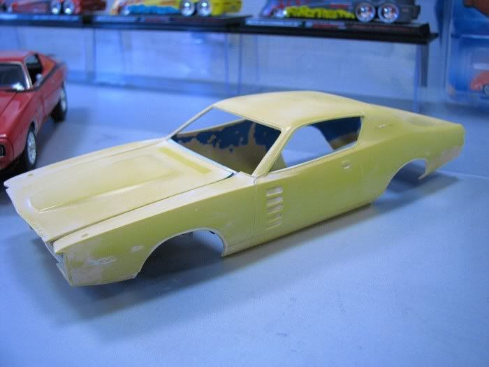

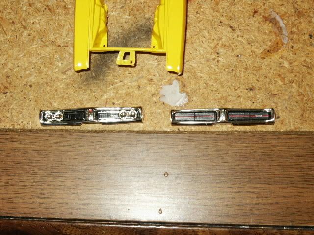

Sport Suburban Posted October 6, 2010 Share Posted October 6, 2010 I like those hide-away headlights. Where did you find that grille? If you didn't, how did you make it? Charlie Larkin Thanks, I somewhat made it. I used the grill inserts I got from AFX. You can get them from Time Machine now and maybe somebody else. I used the kit issued grill/bumper and ground down the molded grill inserts. Then the Hide-a-way inserts just dropped in. Quote Link to comment Share on other sites More sharing options...
ChrisPflug Posted October 6, 2010 Share Posted October 6, 2010 The original MPC hidden headlight inserts are too narrow for the AMT bumper- resin parts have been offered through several vendors The MPC General Lee includes the grille inserts from the '72 annual Quote Link to comment Share on other sites More sharing options...
