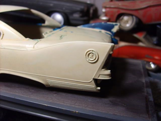

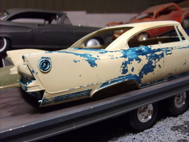

James W Posted August 6, 2009 Posted August 6, 2009 Here is an old build-up I found last spring. I am in the process of removing the paint to repair the body and rebuild the whole thing. The starting point. Traded a good promo for two glue bombs to satisfy the builder in me After weeks in the Purple Power Pond, some of the paint just was not coming off. Observation; if it dose not come off in the first day or three it won't come off in a week or three. Here is the same model(other side) after only 36 hours in brake fluid(non-silicone type) it easily came off with a tooth brush. Close-up of emblem that had been filled with paint. There is no way to remove this without damaging the detail unless the paint is softened. Conclusion; Purple Power is a corrosive degreaser that works well on paint that has not cured completely or is otherwise disposed to fall off a model body. But it dose not soak into paint that has acheived that ideal rock hard status. Like I said above, the paint that had not softened in the first few days of soaking was no closer to coming off after weeks of soaking. It just had no effect beyond a point. Brake fluid breaks down the paint and softens it regardless off its state. The brake fluid is a true solvent. Further, I had damaged the body by trying to make the PP work, scrubbing and heating and just handling the body so much that some of the previous glue work and fragile featrues were stressed. I have in the past left parts in brake fluid for months without affecting the plastic. I hope this helps someone who is not sure where to turn if the Purple Power dose not do the job. It works to a point, but that is it.

James W Posted August 7, 2009 Posted August 7, 2009 Mike, as Pete said there are different solutions to each problem. I have heard much said about corrosive degreasers as paint strippers, but their use is limited. My reason for using PP on the two models I did was because the degreasers are a little easier to clean up and even use in my work area inside the house(no bad smell). And most of the paint came off both models right down to the plastic, each had been repainted at least once in it's life with different colors that had then been painted over. Another reason to use degreasers is that I have heard that brake fluid makes plastic brittle. I have not experienced this but thought I would try PP on these old bodies just in case. When it came down to the end, I did more damage to the Plymouth trying to scrub the paint off than if I had used the brake fluid from the start. And that is why I decided to share this. Good old brake fluid dose a nice job. Caveat emptor.
