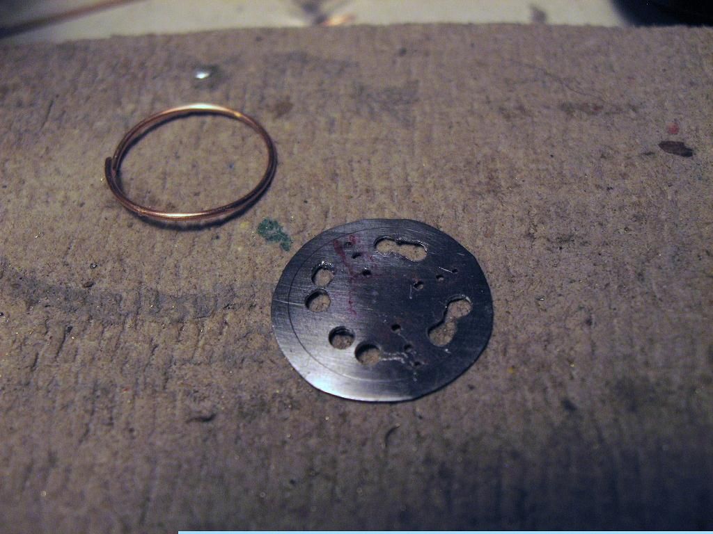

I have gotten some e-mails asking about how I build up parts so I took a bunch of pics showing how I built a steering wheel. This is just my method and I don't claim it to be the best way :D

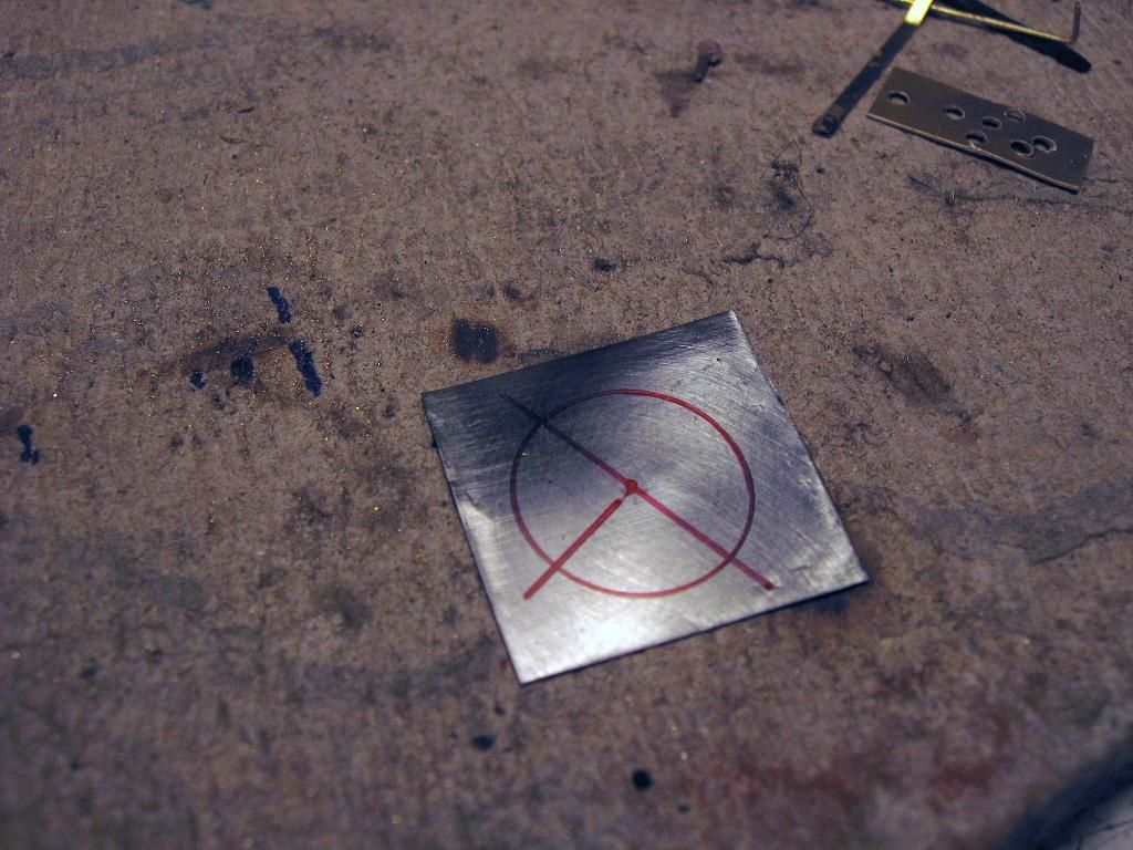

Starting with a piece of .008 tin sheet. Simple layout lines...
Starting to remove material by drilling...

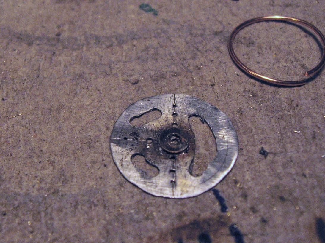

Using files and an exacto knife to get the basic shape. The tin is starting to get pretty fragile at this stage so I will solder on brass washers and copper rings to strengthen it. It has to be scale but also strong enough to actually turn the wheels without folding up!

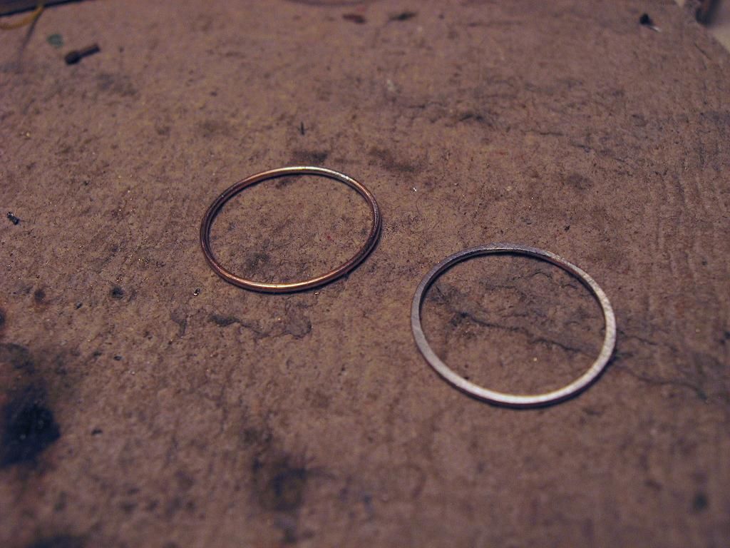

Filed the rings into half rounds....

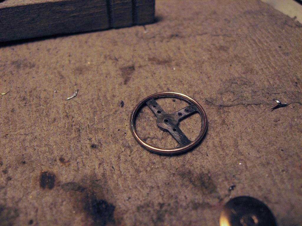

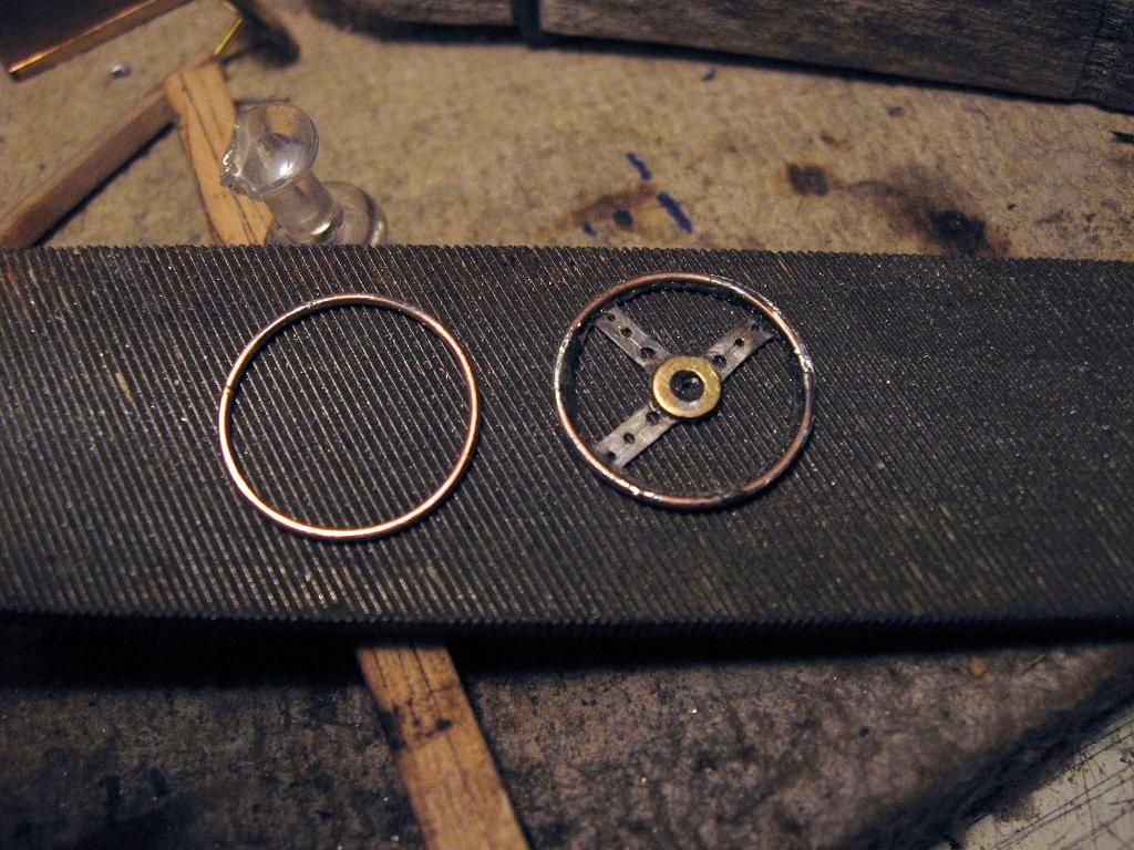

Now that it is stronger I can remove more material by filing...

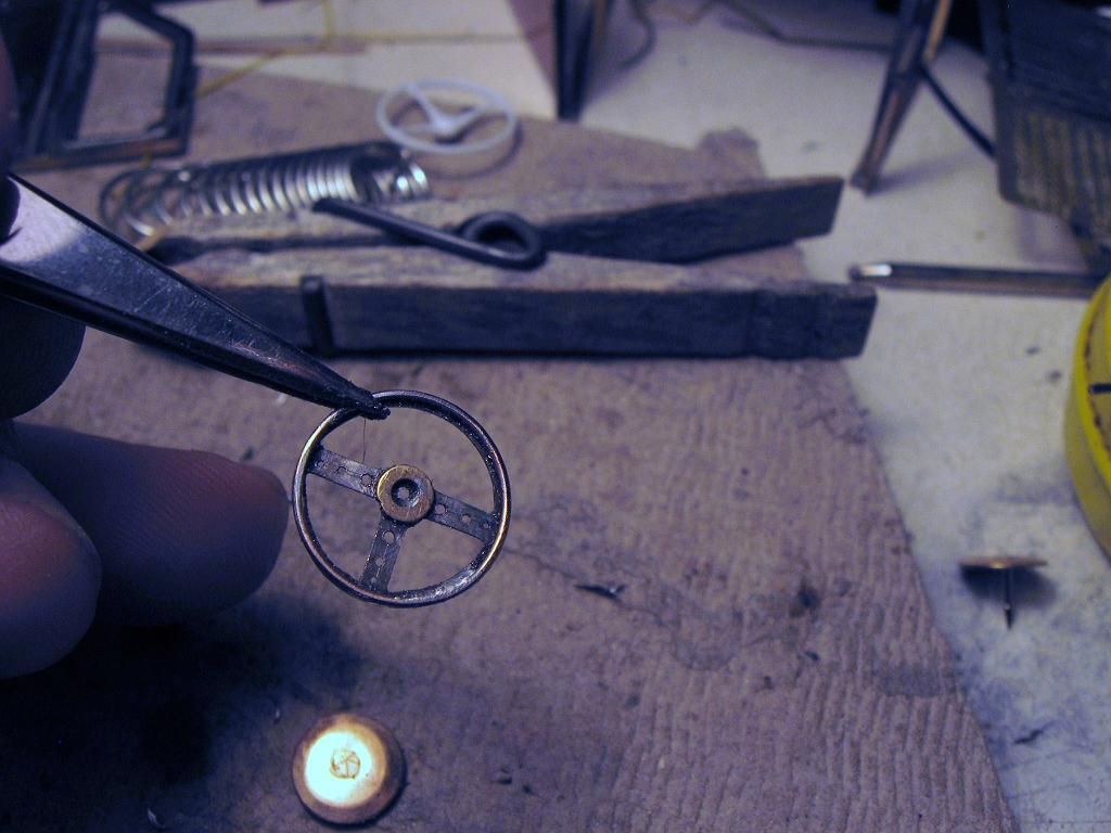

The shaft will slip thru the steering column and then I will put a pin thru the threads that the slotted piece on the steering wheel hub will fit into. The wheel then gets bolted on. ...
I added a little knob on the steering wheel to hide the seam in the rings ....
Hope this makes sense!
