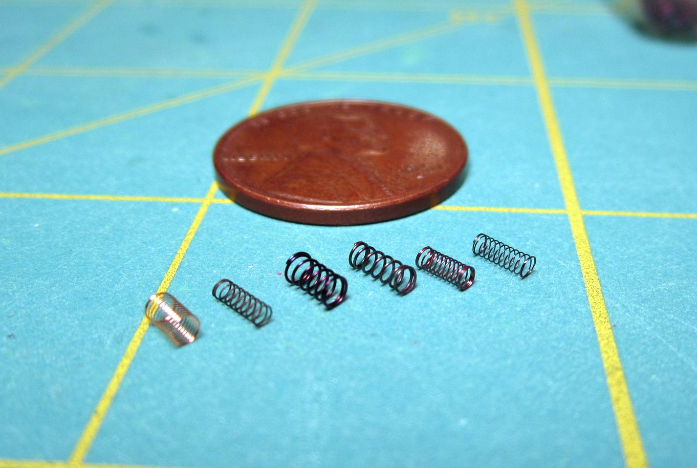

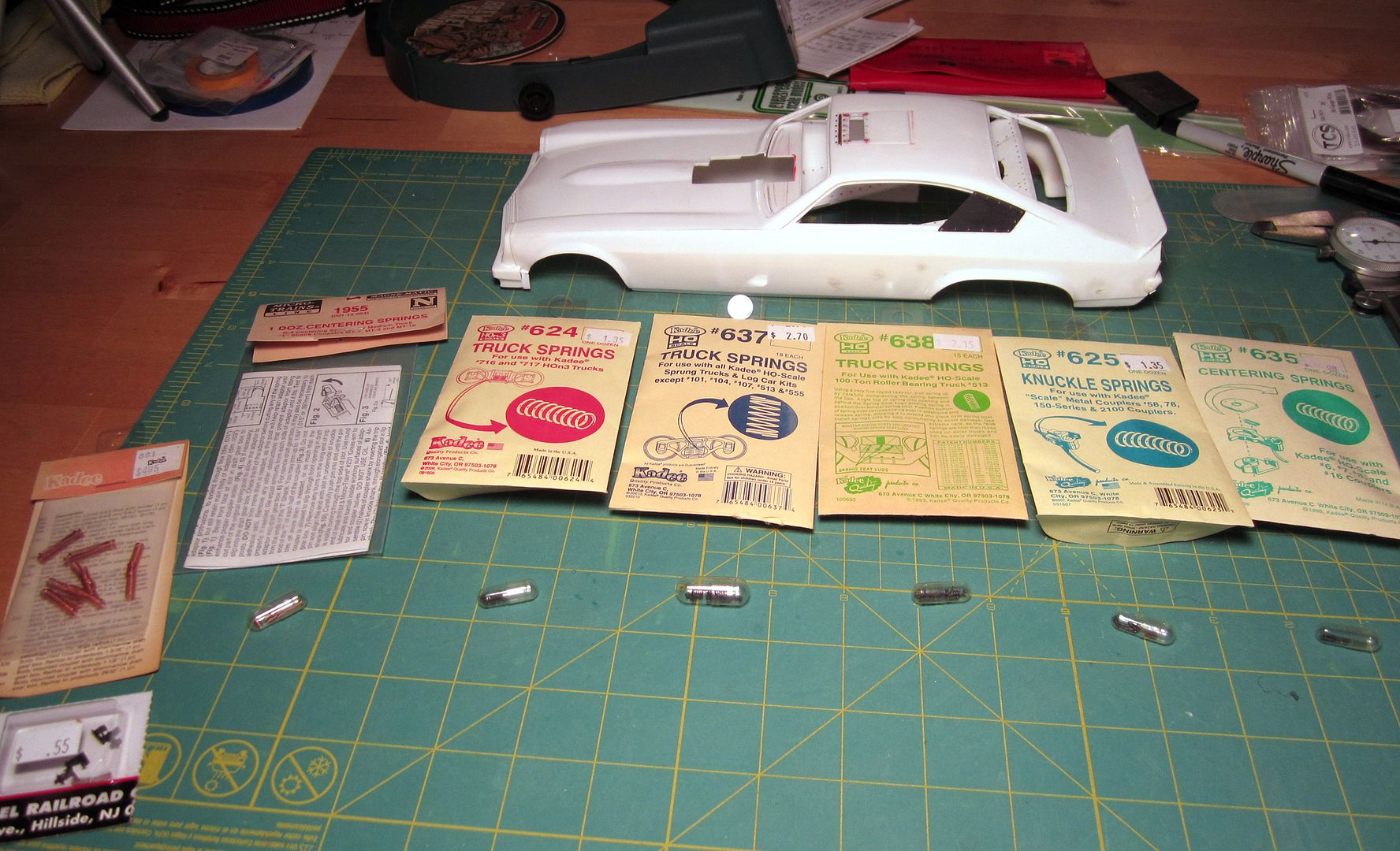

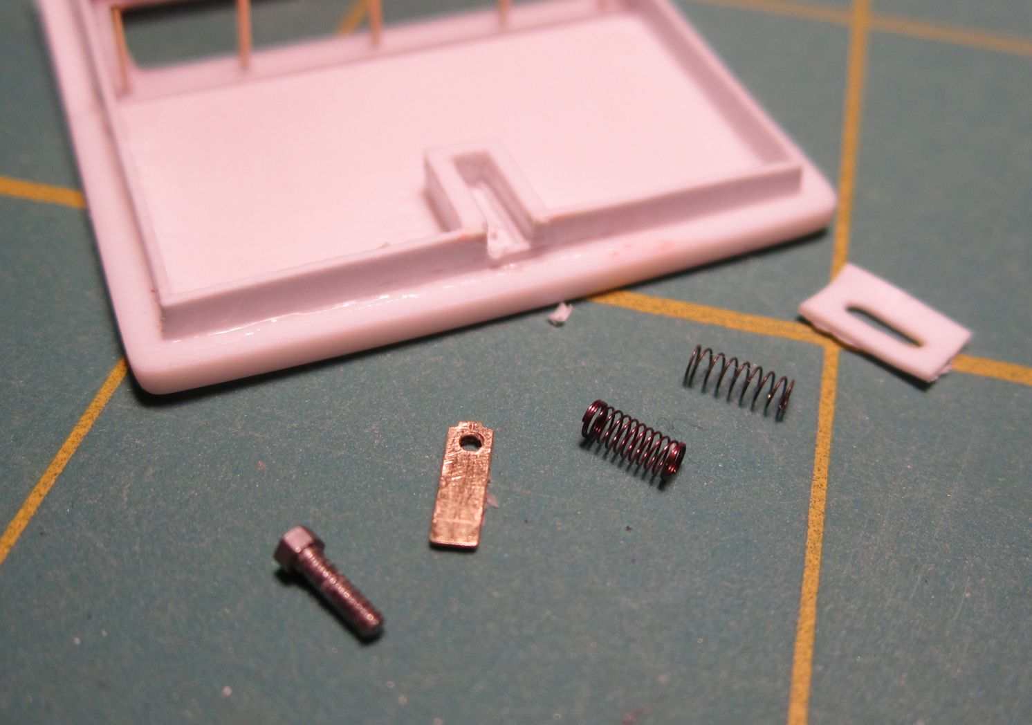

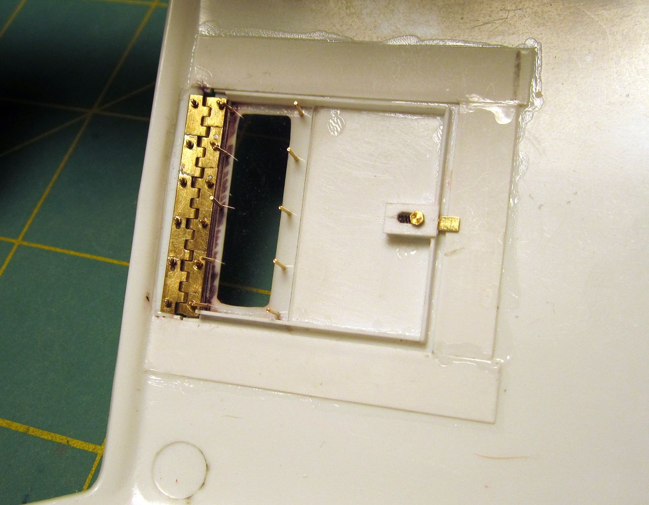

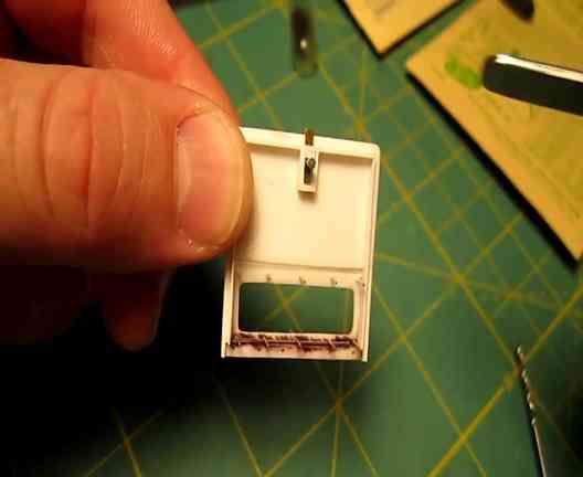

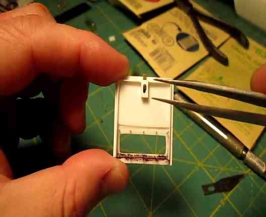

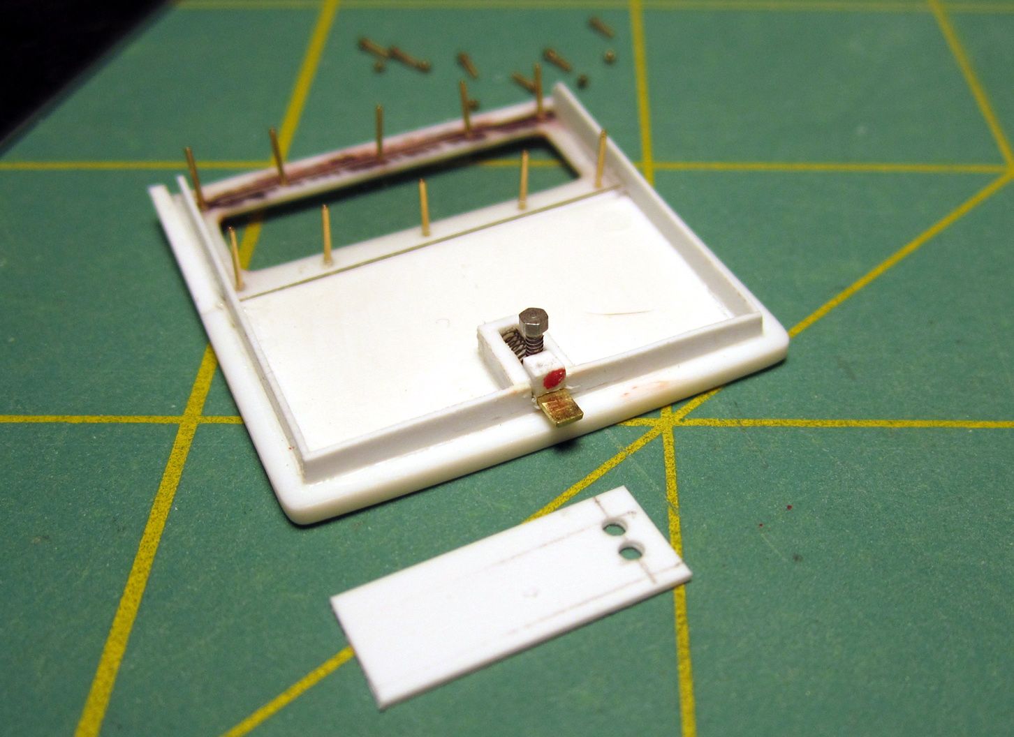

Mooneyzs Posted February 5, 2014 Author Posted February 5, 2014 Well Fellas... I got to the bench tonight and used tonight to fix the latch in the hatch. I have to say that I am pretty happy that I took the time to redo the latch and I ended up adding a spring to make it function. I feel that it works better now. Now I can put the hatch aside and work on some other parts of the body and the engine. I think that I am going to start on the Air Dams tomorrow for a change of pace on this build. Any let me show you what I accomplished tonight.... So over the weekend I hit up a local Train shop in Mesa, AZ looking for different springs from trains to used in the latch and I think I picked up just about every size I could find since I didn't know how big or strong they would be...lol. Here they are: Here is an up close shot of the springs next to a penny to give you an idea on their size: Here is the latch after I disassembled it. I had cut off the top piece and then not sure if you can see it but I filed that latch itself so that it would have a lip that would fit inside the I.D. of the spring. and the top piece with the slot is the one that was removed and a new one will be made for it: I then decided to drill a small hole that the spring could set in on the inside:

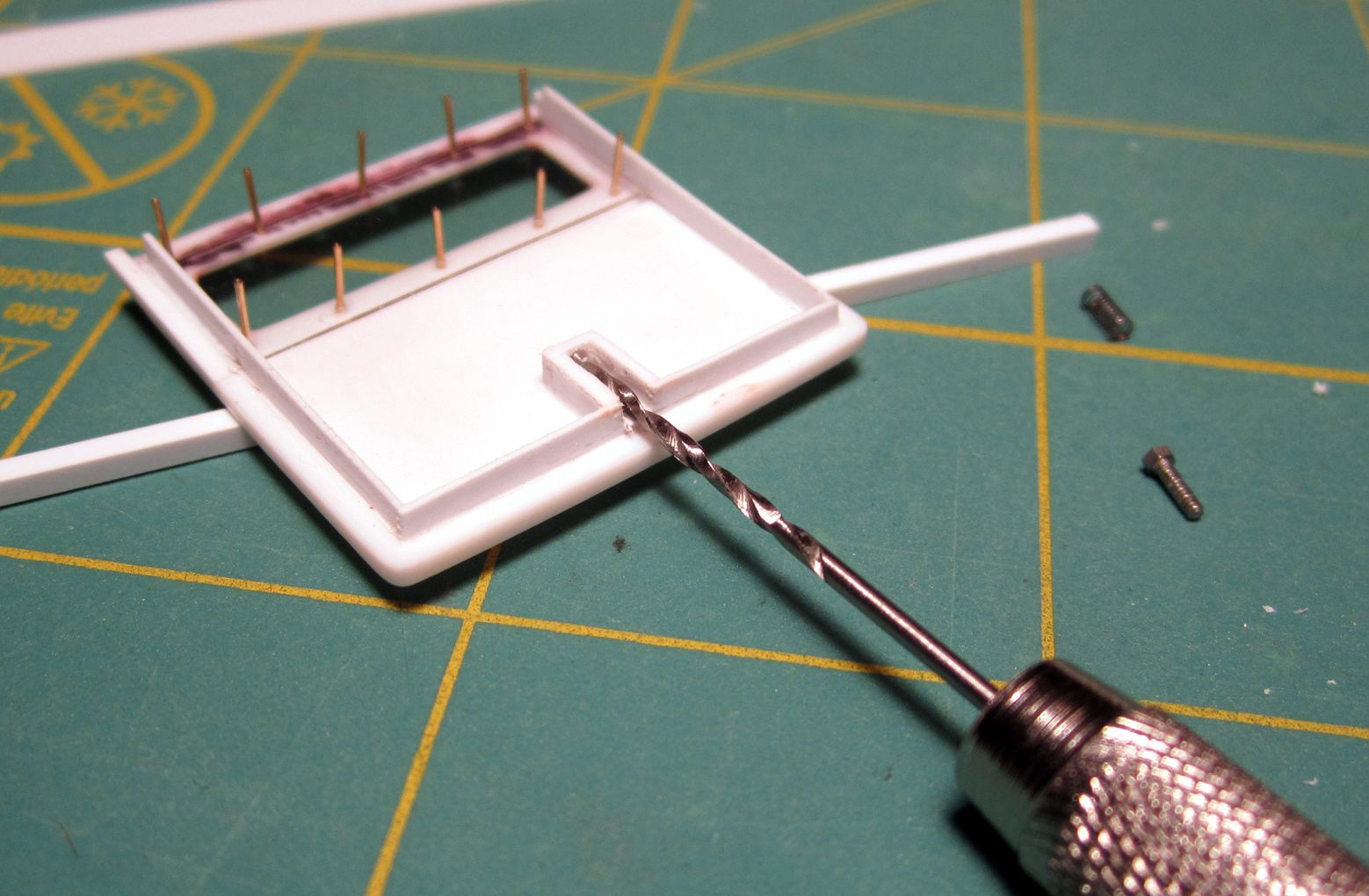

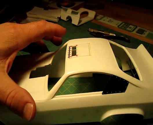

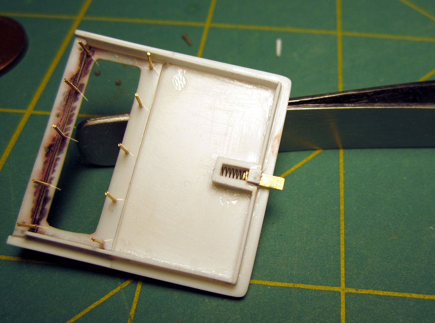

Mooneyzs Posted February 5, 2014 Author Posted February 5, 2014 Here is the spring set into place and the latch portion for you to see. I also glued in a new bridge piece at the opening of the latch: Here is part of it assembled with a new top piece being made. I took Brads advice and cut down a brass hex bolt so that it wouldn't stick so far out. you will see in a following pic: Here is the hatch installed back into the body after the fix, I am really happy that it only took a couple of hours this evening: Stay tuned I have a special post following this one, showing the latching in action..... ...Yep I took a video to show you all how it works....
Mooneyzs Posted February 5, 2014 Author Posted February 5, 2014 Ok so I had to take a few videos to show you guys the hatch and latch in action.... This first video is showing you the latch working with out the top off so you can see the spring in place and that it keeps the latch i position: This next video is basically the same as the first but with the cover on the latch glued in place: Ok... I think this video is my favorite of the 3. This one is showing you with the hatch mounted back into the body and showing the function of the latch and movement of the hatch. I think it turned out ok:
