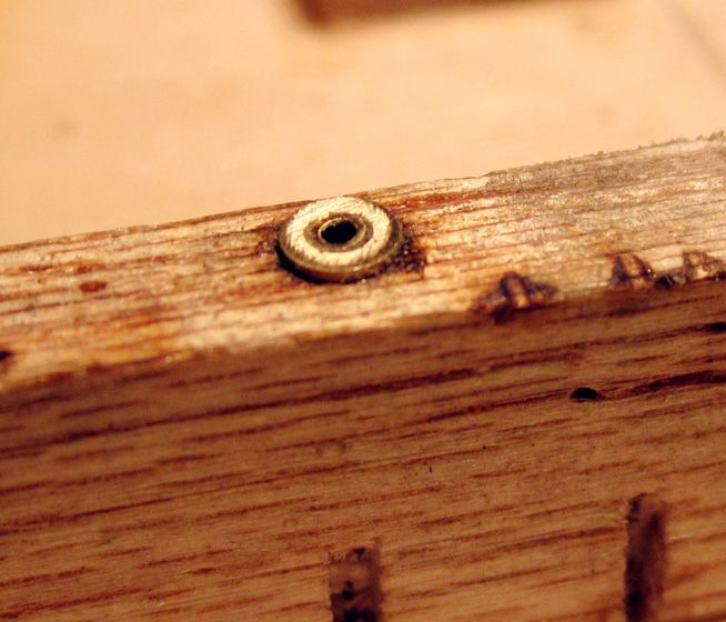

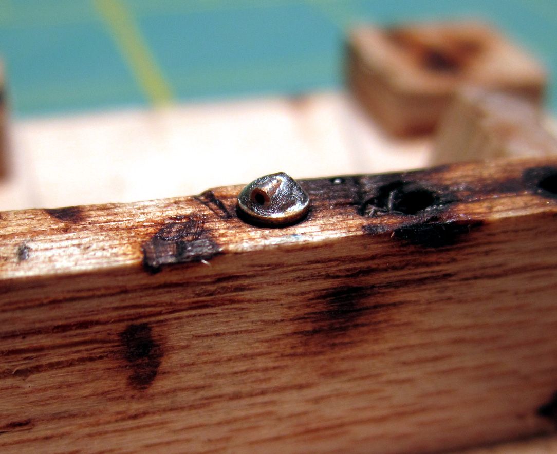

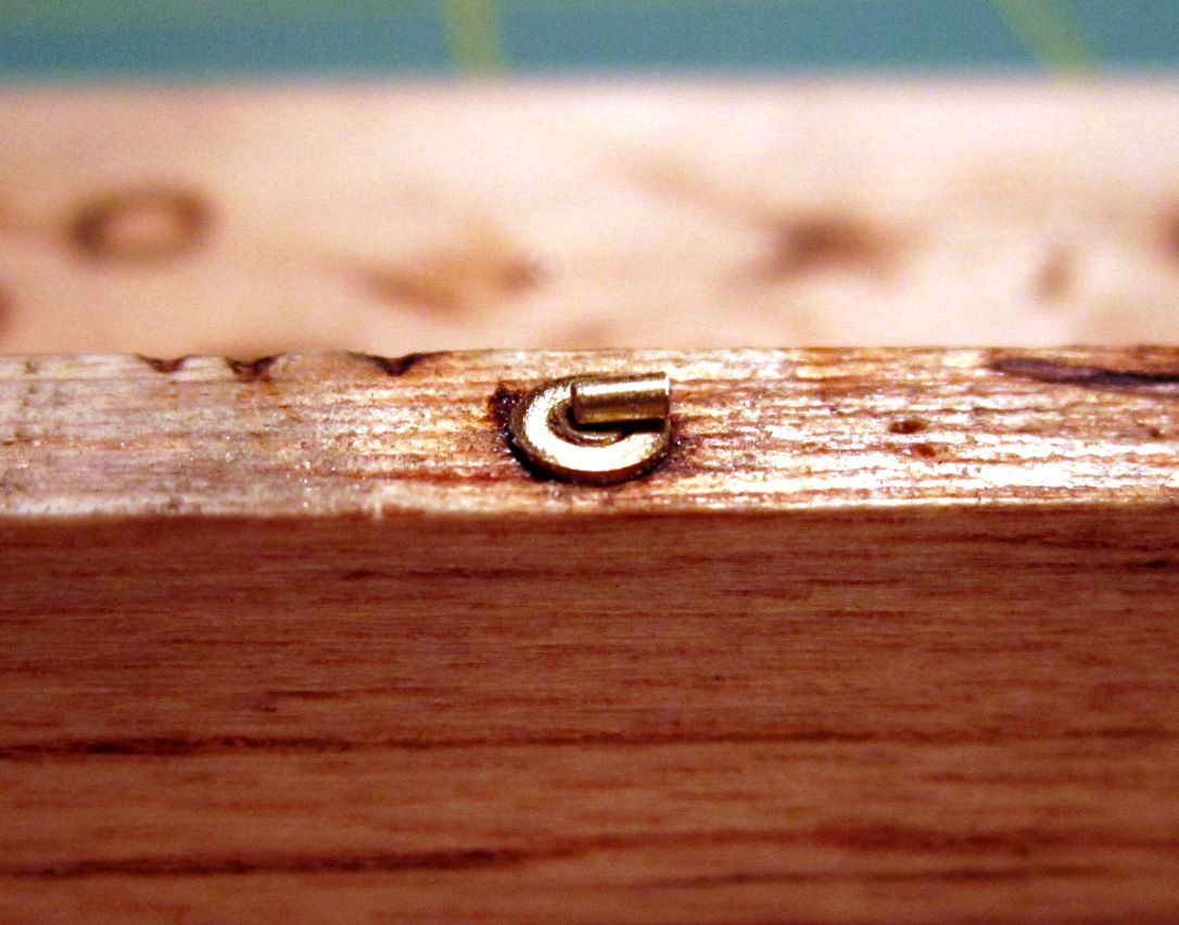

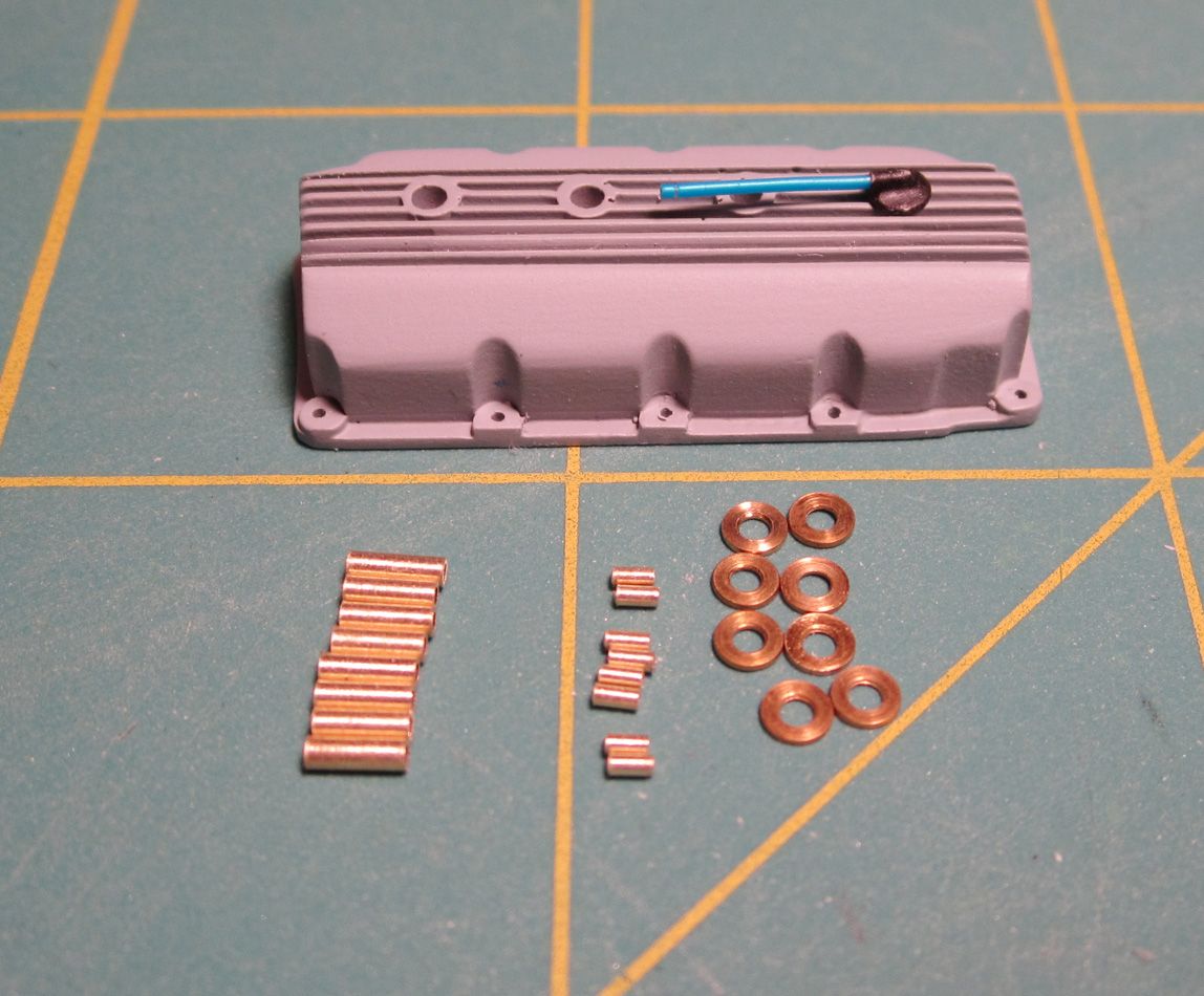

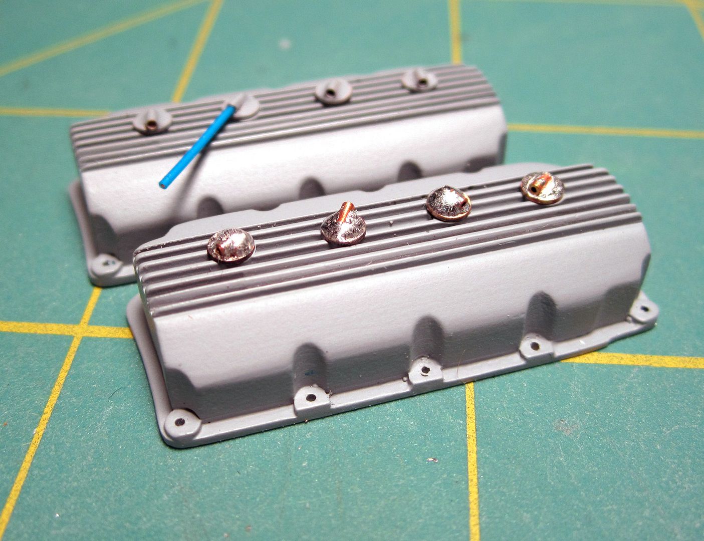

Mooneyzs Posted February 1, 2013 Author Posted February 1, 2013 Ok guys.... just want to show you some progress of the spark plug boots and the process that I used to make them...... Here is all of the materials I started with. 3/64" OD brass tube, 1/32" OD brass tube, 00-90 brass washers: Then in my make shift Header jig I drilled a hole to hold the 3/64" brass tube and set a 00-90 washer on the balsa wood so the washer and brass tube was flush: next I then took the 1/32" brass tube and set on top: After that I took my soldering iron and set it on top of the 1/32" brass tube heating it all up and then hitting it with solder: After repeating that 8 or more times Here are all of the finish soldered parts. It seemed it took me a couple hours to get it the way I wanted: I took one set here (the one to the left) and filed the solder down with a round file and then took sand paper to shape them as well as drilling the 1/32" brass tube ID with a .024" drill bit that will fit the Pro Tech 1/16th scale Spark Plug Wire: Here is a pic after I put a quick coat of primer on the spark plug boots. The next step is to finish the other four the same way I did here and then I will add bondo to the spark plug boots for final shaping and they will be ready for another coat of primer, then Paint :

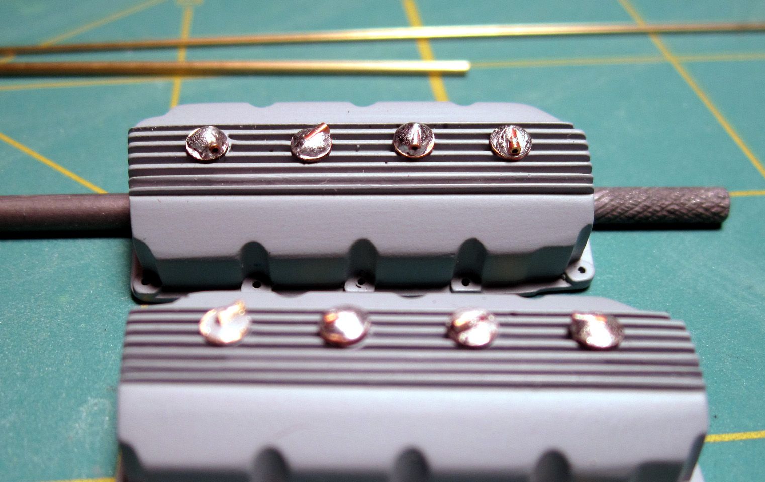

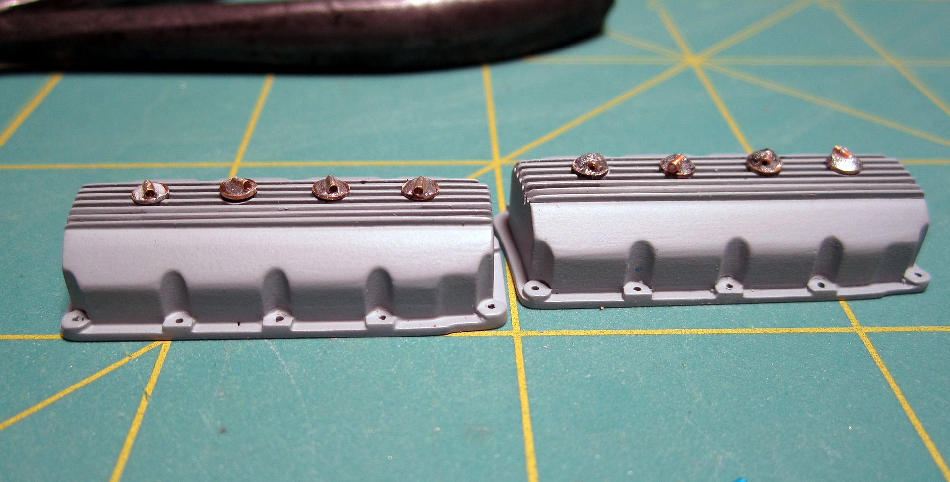

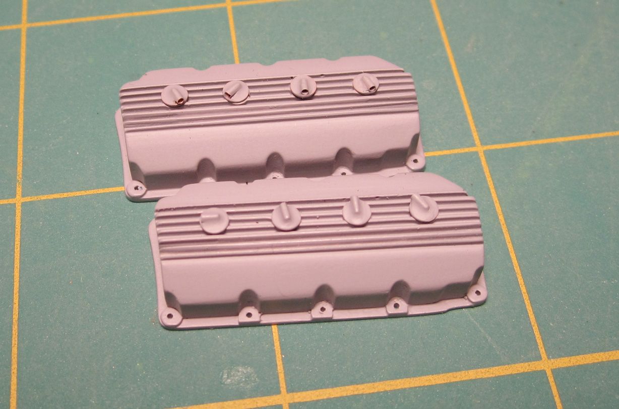

Mooneyzs Posted February 5, 2013 Author Posted February 5, 2013 Bill.... thanks buddy. I am pleased with them so far So tonight I felt like I sanded and filed for an hour our two...and then had to so a little re-soldering on one I messed up. Anyway I got the rest of the spark plug boots done and tomorrow night I will add some bondo to them and sand, then finial primer. Then they are ready for paint. for such small Items that they are they sure took a lot more time that I thought but then again doesn't help when I am trying to make them perfect . they all have their own character...haha... anyway here is a pic of them.... Spark Plug Boots ready for final details:
