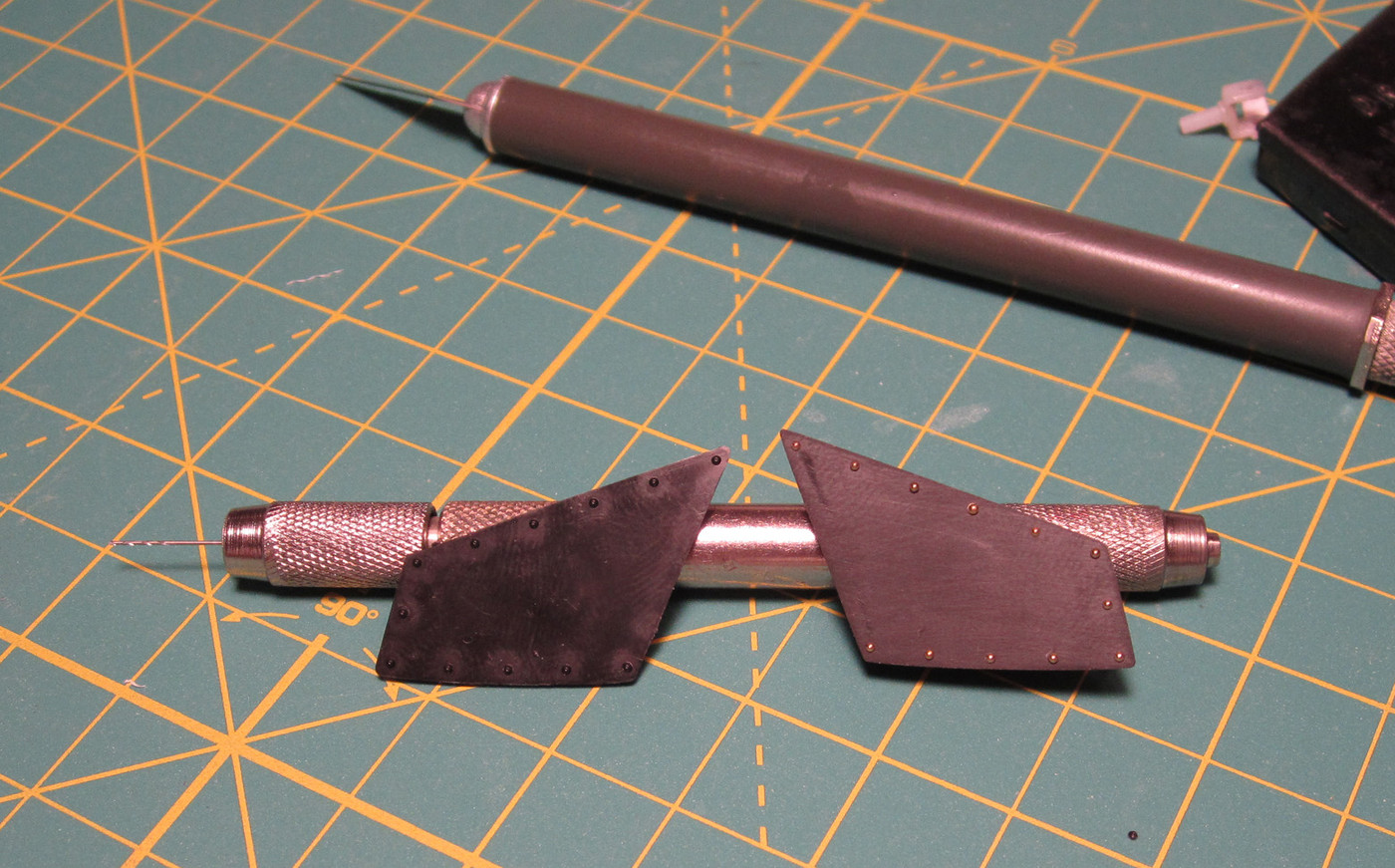

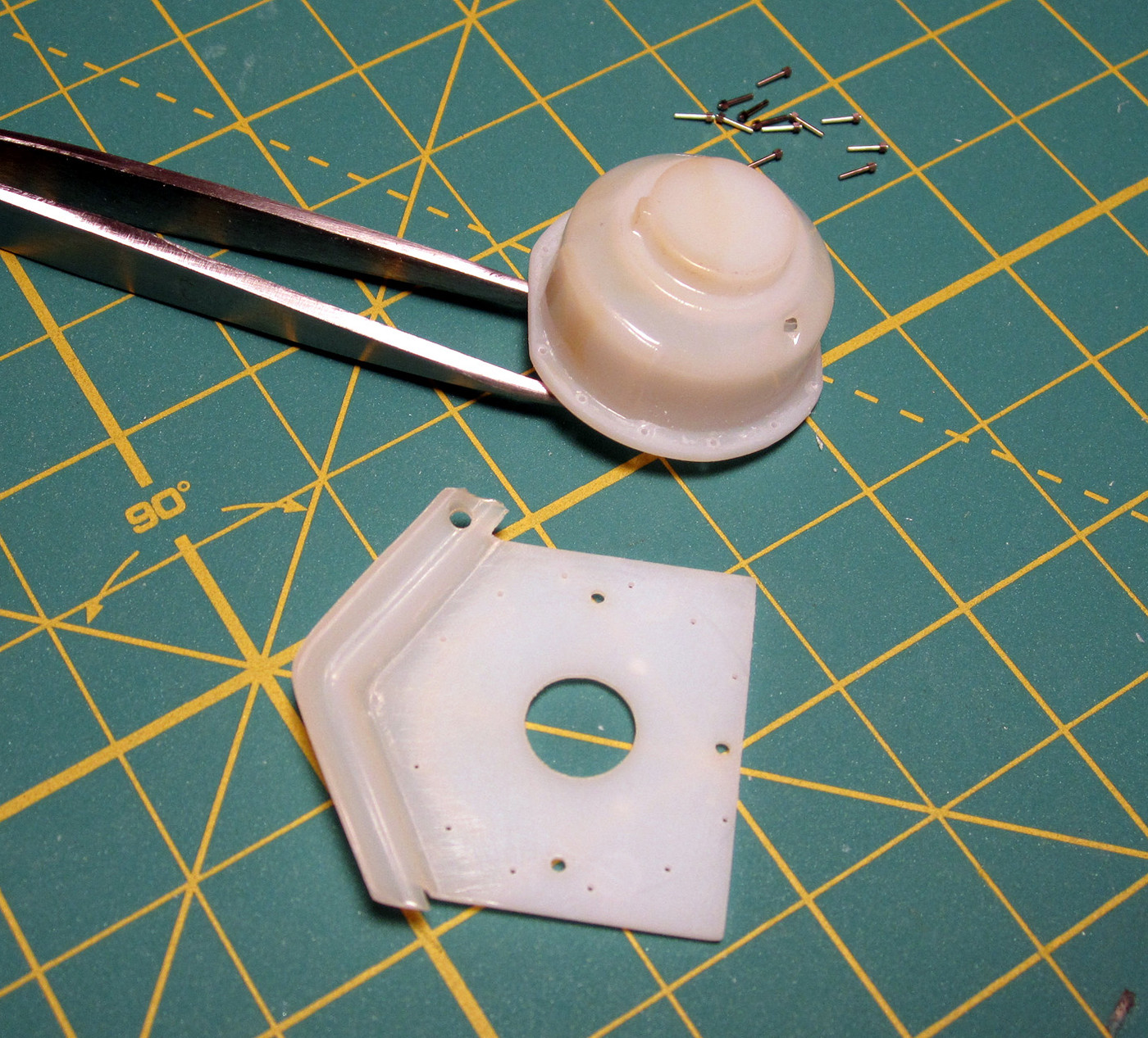

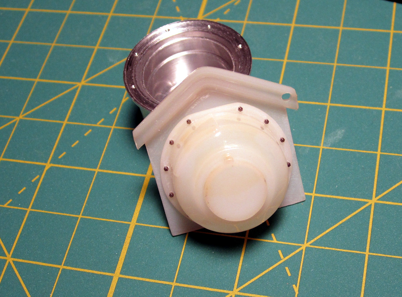

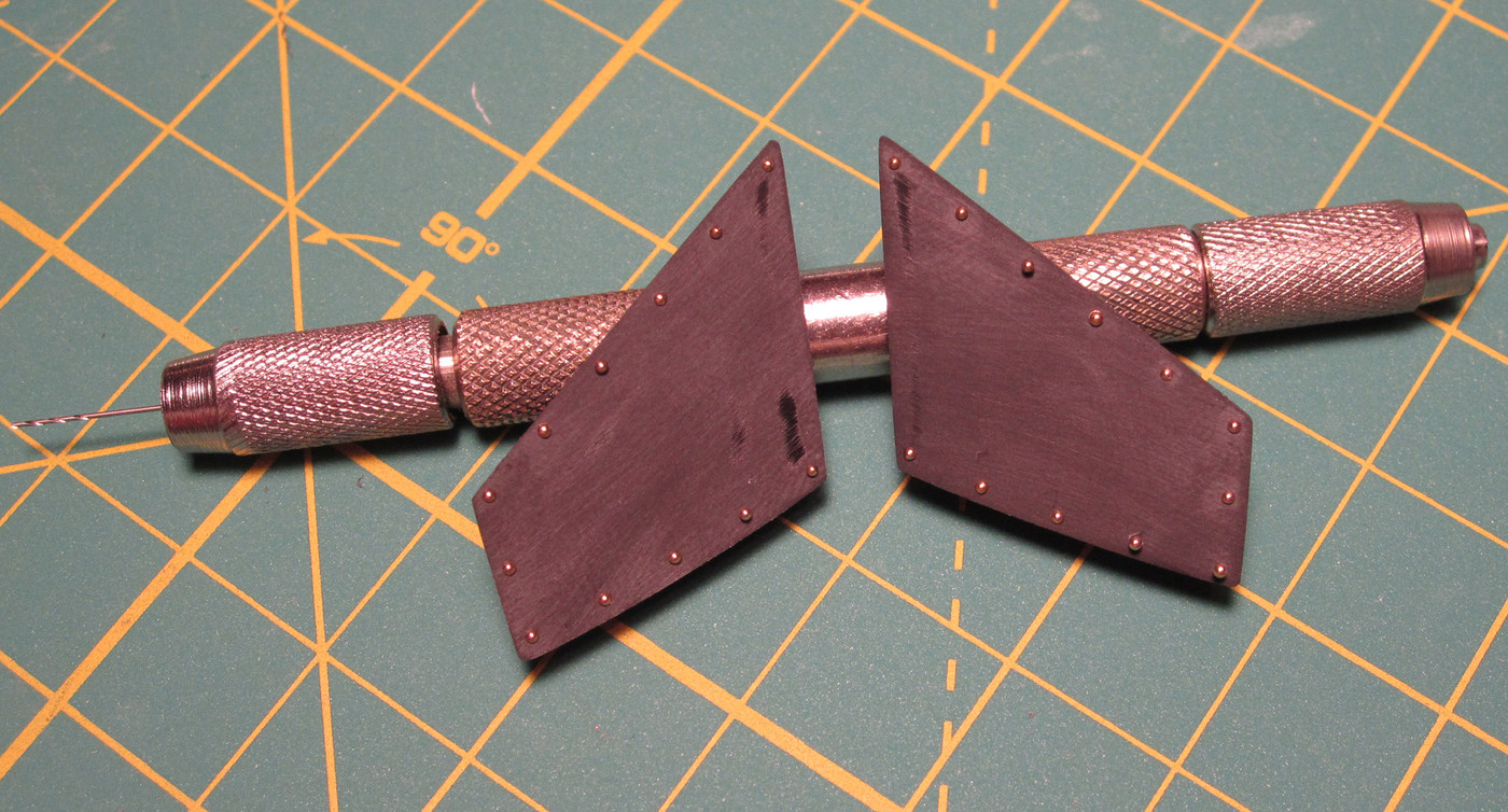

Mooneyzs Posted August 10, 2011 Author Posted August 10, 2011 (edited) Thanks Shane. Was able to get more done to this. worked on Drilling out the bolts on the clutch bell housing. Also started with a couple of body pieces removing rivets and drilling them out for Scale hardware rivets. Drilled out a couple of bolt heads on the manifold and was able to shoot some primer on the front Spindles. Here are the pics..... Here is the Clutch Bell Housing with the kits bolt heads removed and holes drilled for hardware: Here is the Clutch Housing mocked up with the bolts in place: Side window pieces, the left is the kit rivets and on the right the rivets have been removed and holes drilled for Scale Hardware Rivets: Both sides done, I need to take the rivets out and lay some bondo down to fill the low spots and will be ready to glue to the body: Edited July 23, 2017 by Mooneyzs

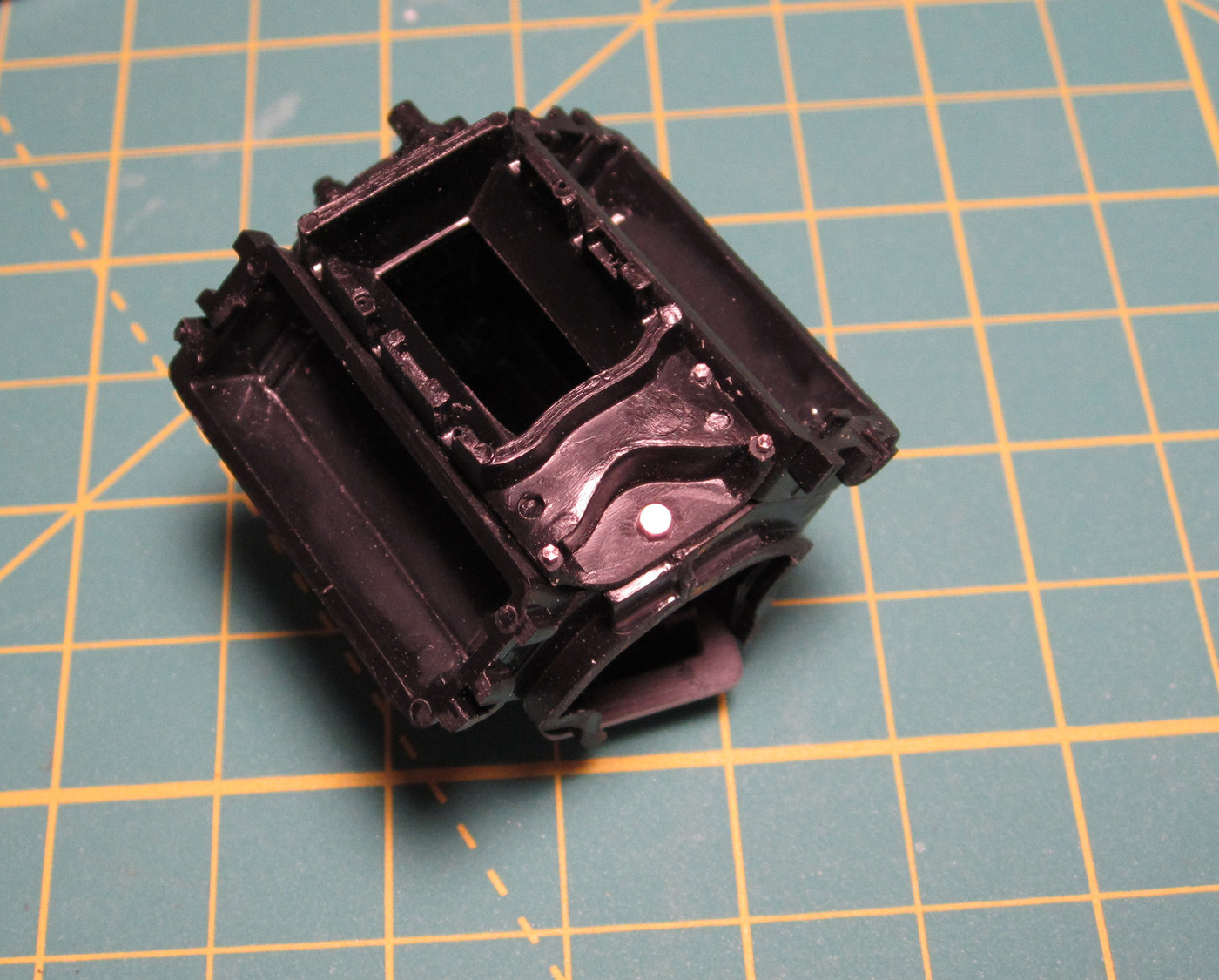

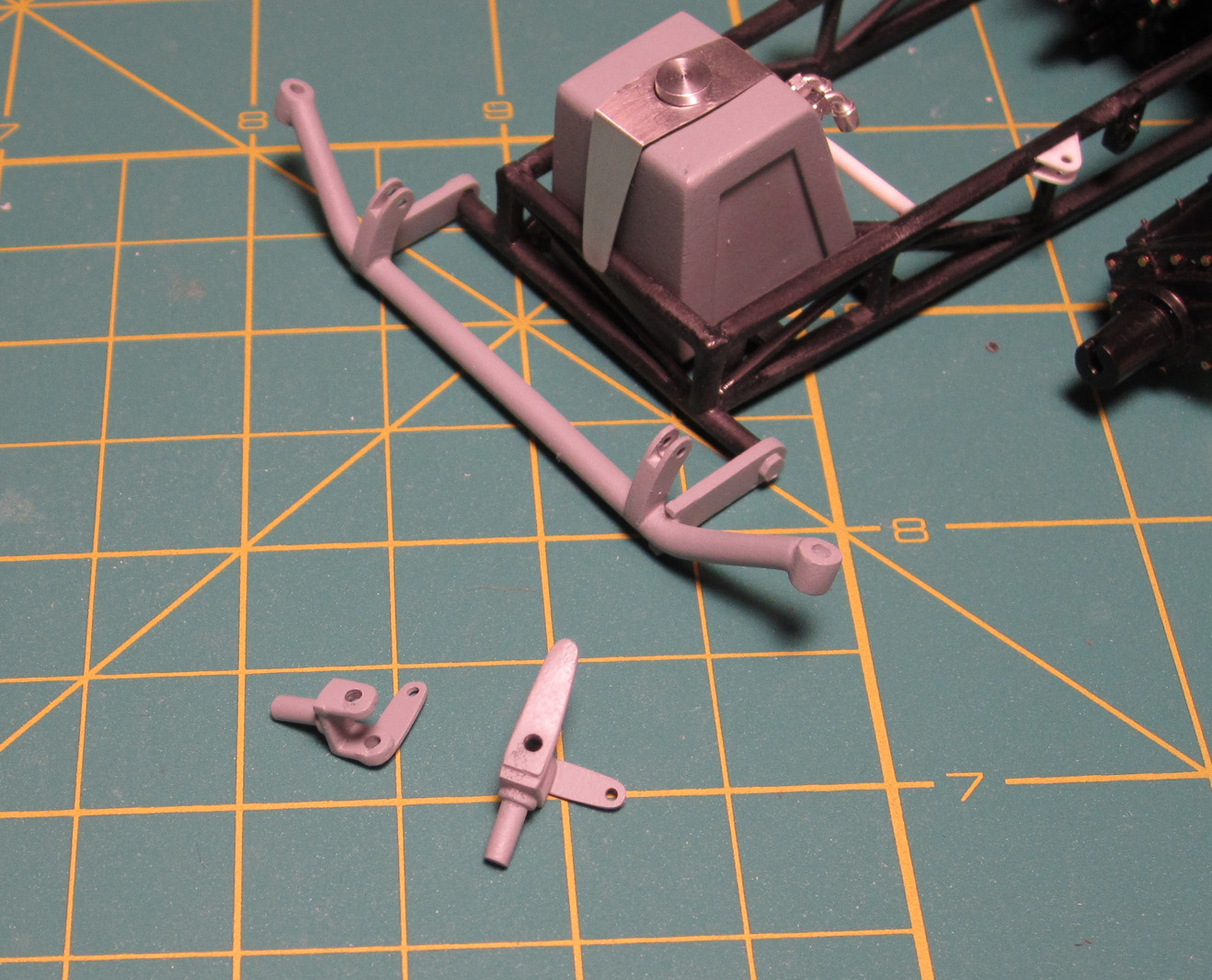

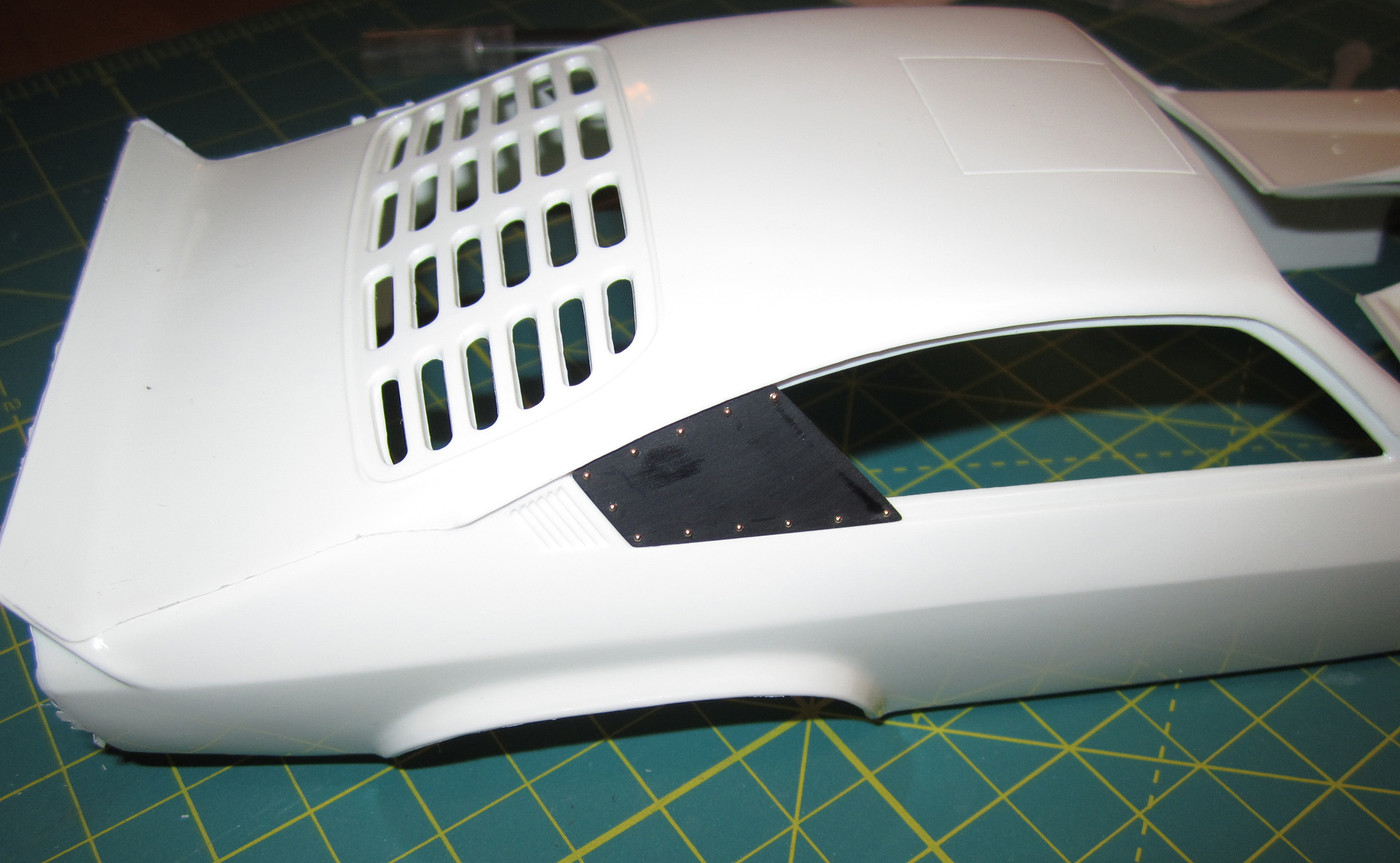

Mooneyzs Posted August 10, 2011 Author Posted August 10, 2011 (edited) The side window pieces put in place and transfer drilled holes into the body: The Manifold drilled for bolts on the rear: The Front Spindles primered and just about ready for some Alclad: Edited July 23, 2017 by Mooneyzs

Dragracer Posted August 10, 2011 Posted August 10, 2011 Chris, I was just wondering (after seeing the pic of the body with the side window pieces mocked in),are you gonna cut down the front hood scoop to match the real car or are you planning on keeping the Revell Super Shoe scoop on?

Mooneyzs Posted August 11, 2011 Author Posted August 11, 2011 Chris, I was just wondering (after seeing the pic of the body with the side window pieces mocked in),are you gonna cut down the front hood scoop to match the real car or are you planning on keeping the Revell Super Shoe scoop on? Richard... to answer your question, yep I have been wanting to rework the scoop on the hood. the kit is way off compared to the car...so I will be doing some magic on it... haha Wow Chris, better and better each update Thanks Brett I have a couple of the 1/16 Jungle Jim Vegas and I am inspired to build one of them after watching this build. bobthehobbyguy Hey Bob glad to hear my build has inspired you to break one of them out. feel free to save and use any of the pics as reference.

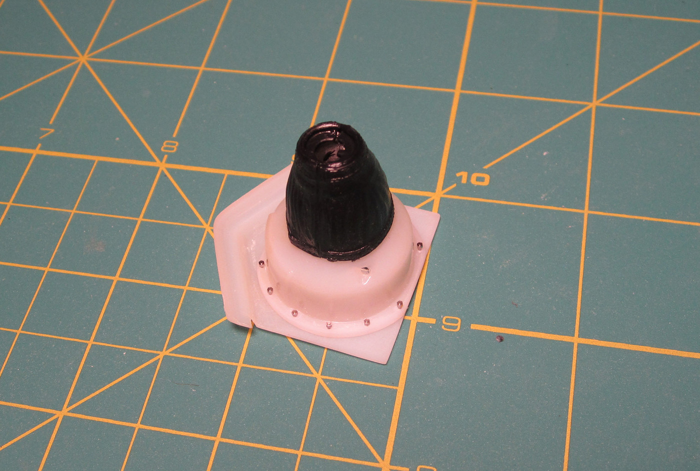

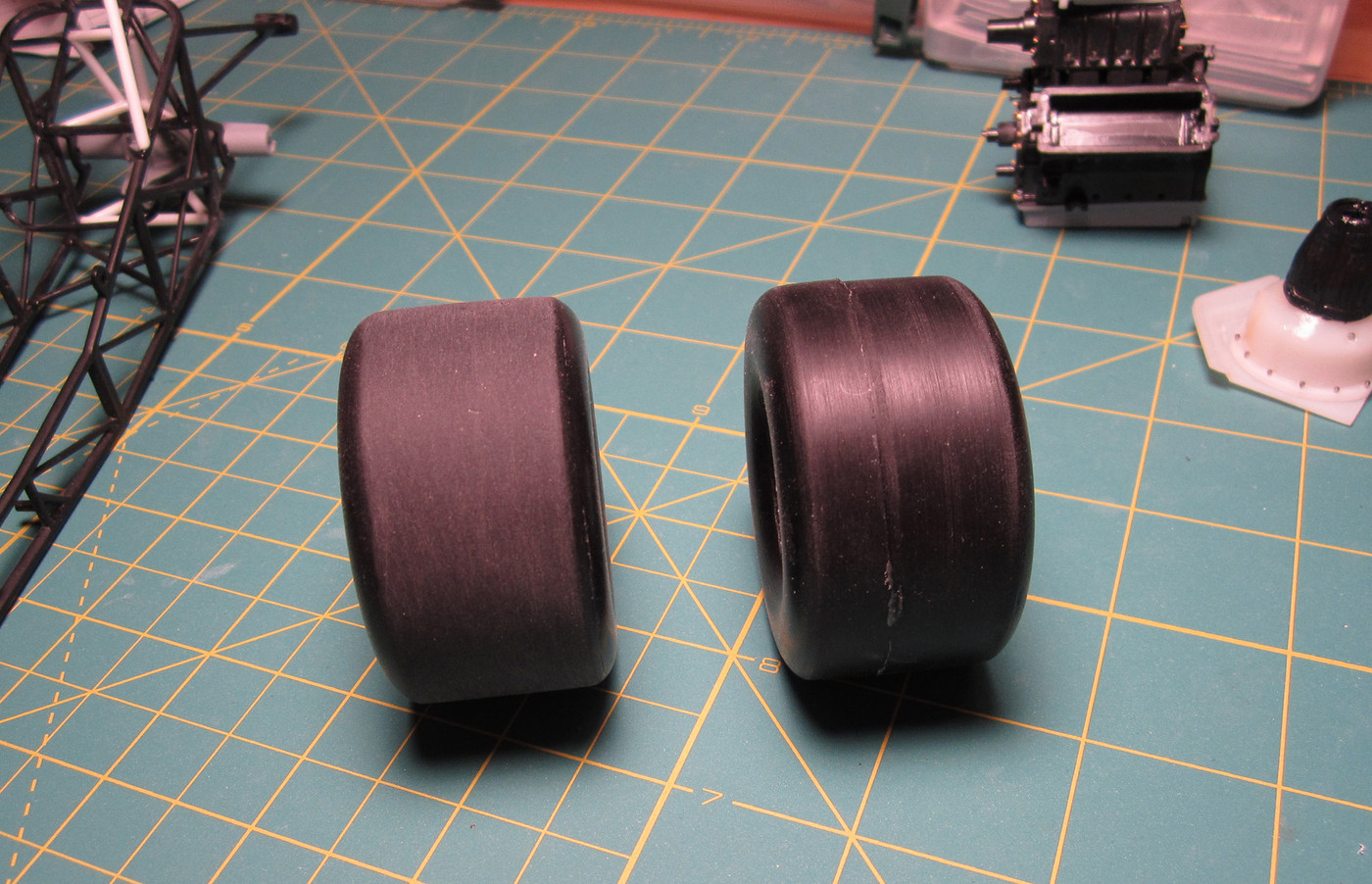

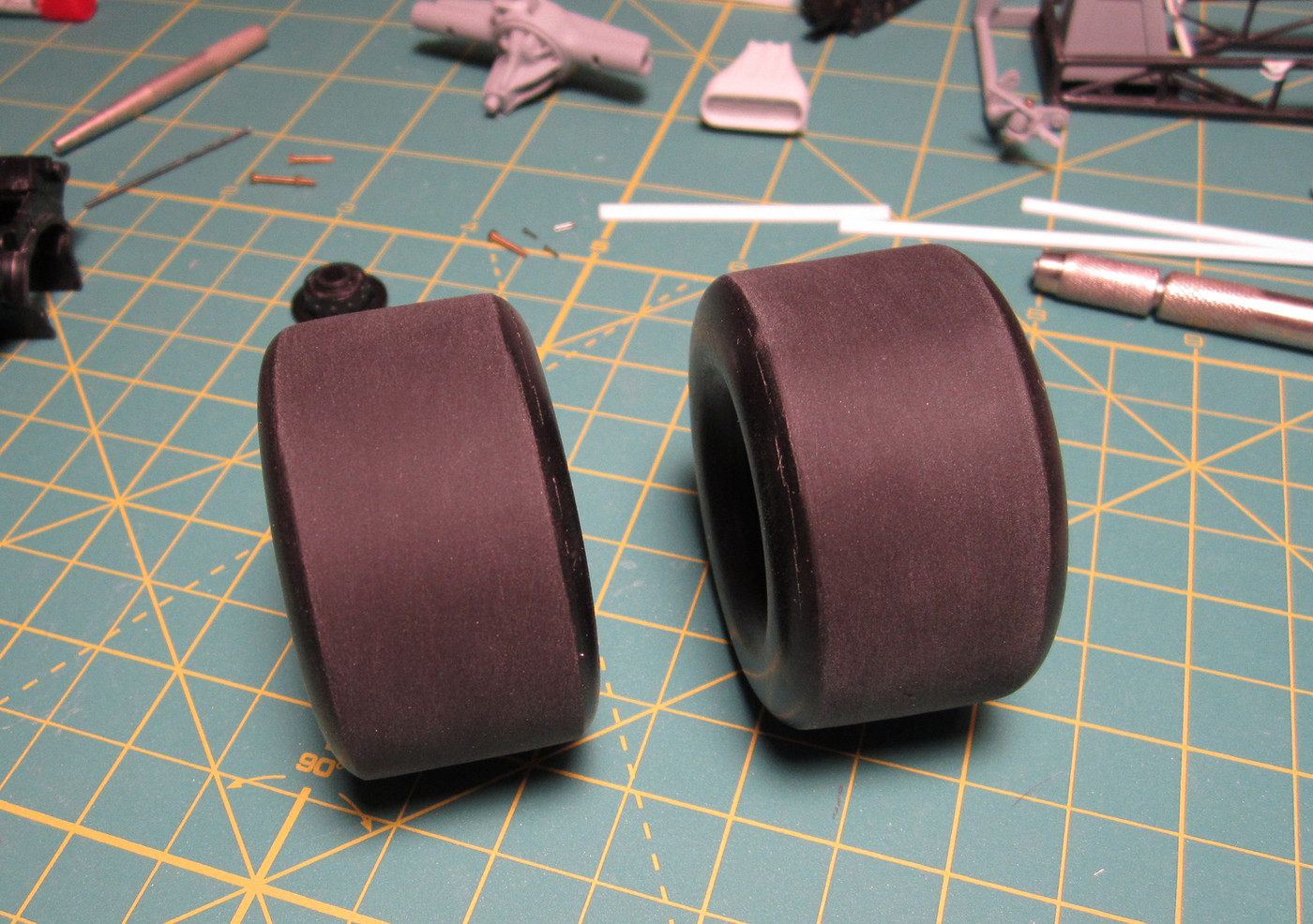

Mooneyzs Posted August 11, 2011 Author Posted August 11, 2011 (edited) I tinkered on this a little tonight but not as much as I was originally planning. Just got the clutch safety blanket glued together and sanded on the rear tires. Not much of an update but heres a couple pics.... Sanding the tires... tire on left completed, tire on right still needs sanding: Clutch Blanket Halves glued together and just placed on the Clutch Bell Housing: Edited July 23, 2017 by Mooneyzs
Romell R Posted August 11, 2011 Posted August 11, 2011 Thanks for the reminder Chris I need to get my tires sanded down! LOL! great work as usual buddy!
bobthehobbyguy Posted August 12, 2011 Posted August 12, 2011 I tinkered on this a little tonight but not as much as I was originally planning. Just got the clutch safety blanket glued together and sanded on the rear tires. Not much of an update but heres a couple pics.... Sanding the tires... tire on left completed, tire on right still needs sanding: Clutch Blanket Halfs glued together and just placed on the Clutch Bell Housing: Where did you get the tires, they don't look like the kit tires? Bobthehobbyguy
Mooneyzs Posted August 12, 2011 Author Posted August 12, 2011 (edited) Where did you get the tires, they don't look like the kit tires? Bobthehobbyguy Bob.... You are right they aren't from the kit. I got these from Flashpoint Motorsports Resins, very nice tires. He has a few sizes to choose from. Edited August 13, 2011 by Mooneyzs
stump Posted August 14, 2011 Posted August 14, 2011 Chris, this is getting better with each instalment.. Details on the clutch can and manifold look sweet as. Great tip, looking for brake parts in alternate areas too...would never have thought to look at 1/18 parts. I'll be checking evilbay now.... Be interested to see Charlie's linkages too....they sound kool.

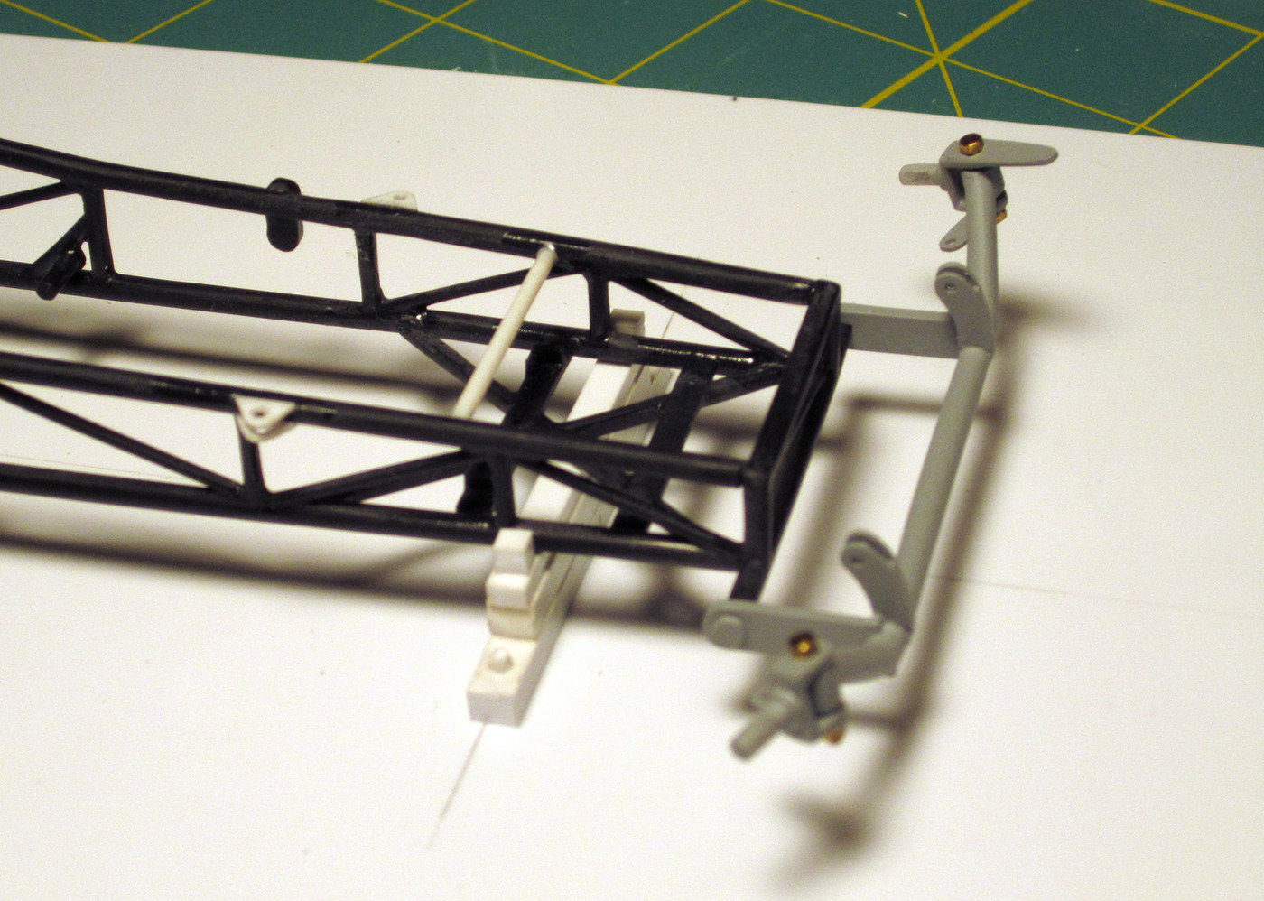

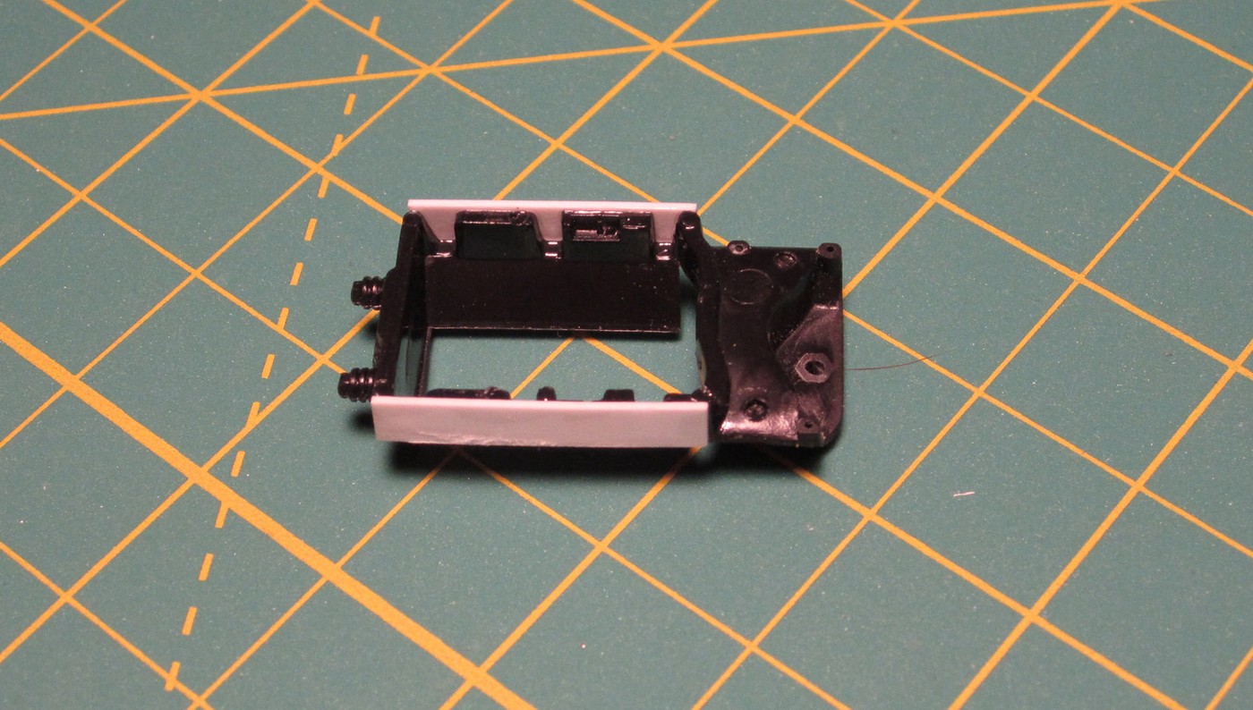

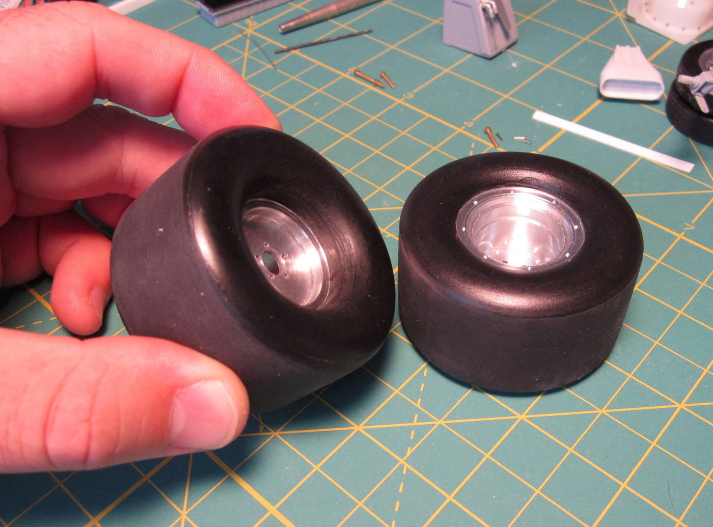

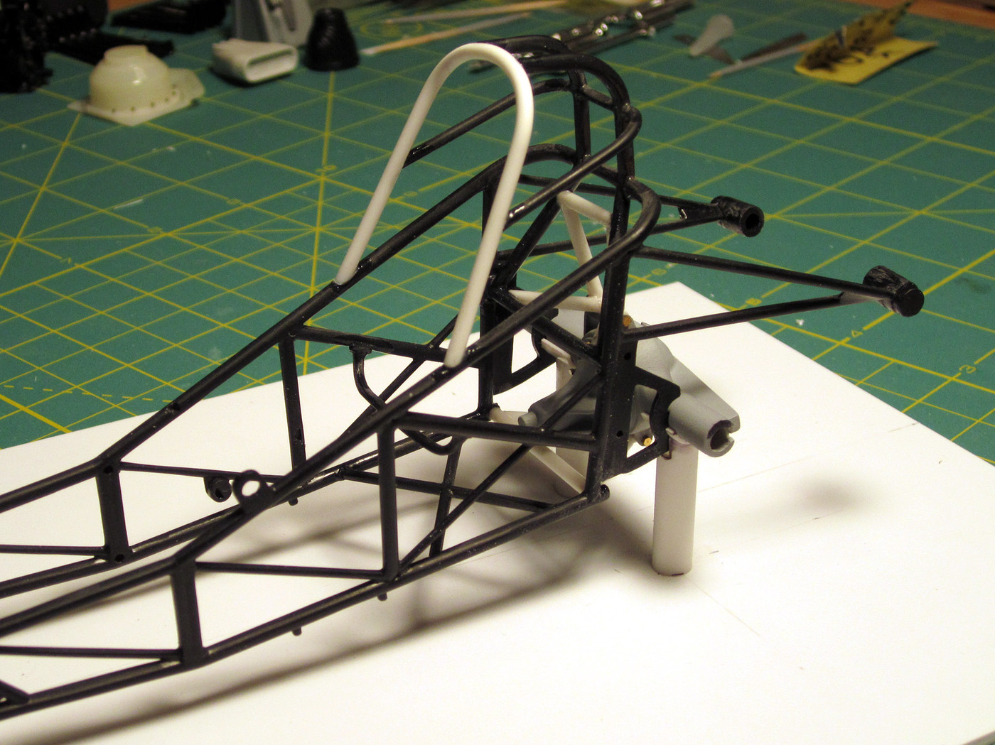

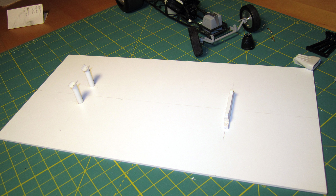

Mooneyzs Posted August 14, 2011 Author Posted August 14, 2011 (edited) Thanks Greg and Danno..... Greg I had someone steer me in that direction with the disk brakes and was thankful they did was able to find 1/16th and 1/18th scale ones. so been able to put some hours in this weekend and have some more pics to share with all of you. Started doing more work to the manifold, added plastic to the side so that I can drill the locations for the fuel lines and fittings: Finished sanding the rear tires and they are ready to go: I decided I was going to test fit the rims into the tires and glad i did. I realized I ran into a snag here after Inserting them. These tires are wider and the rims were not quite wide enough. Going to talk to Jim at Micro Nitro and see if he can turn another set that is a little wider or make a piece and splice them together. Thinking though that machining a new rim may be the better way to go. still not sure which route to go: I also decided to make a Jig that I can set the funny car on with the correct height of the chassis: Edited July 23, 2017 by Mooneyzs

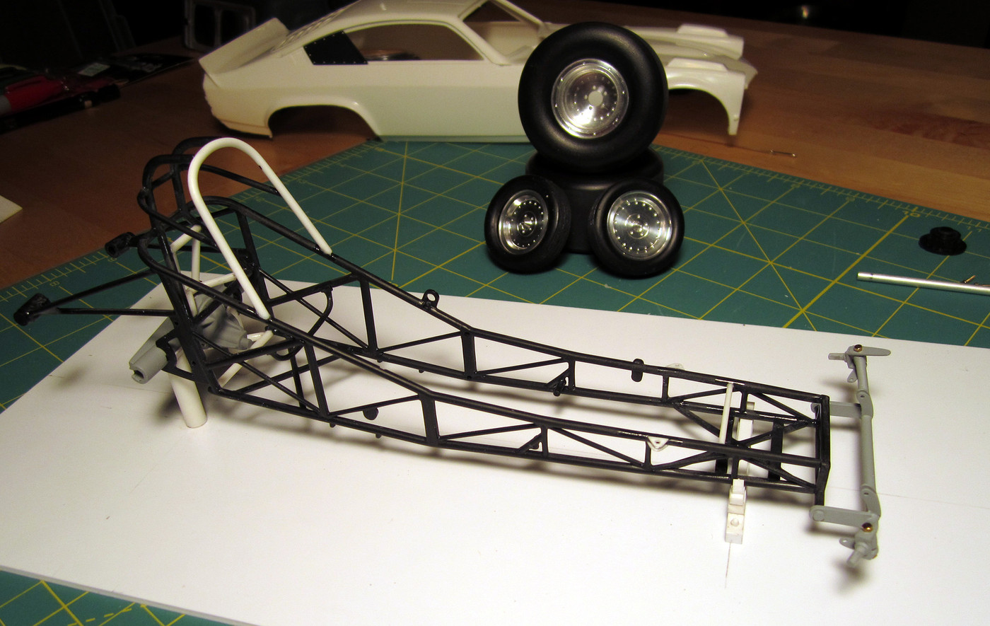

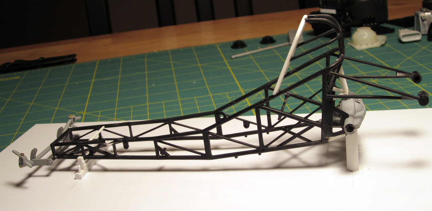

Mooneyzs Posted August 14, 2011 Author Posted August 14, 2011 (edited) Now time for some pics of the chassis sitting in the Jig..... Here I have the chassis sitting in the Jig: Sitting on the front blocks, sorry the pic is a little blurry: Side View: The rear sitting on the rear blocks: Time to get back to work on this. I will be working on redoing the body pivot mounting brackets on the back half of the chassis..... Stay tuned and will have more pics to share later..... thanks for looking Edited July 23, 2017 by Mooneyzs
