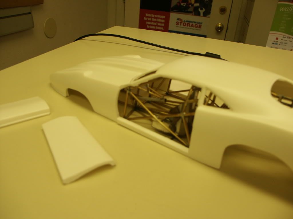

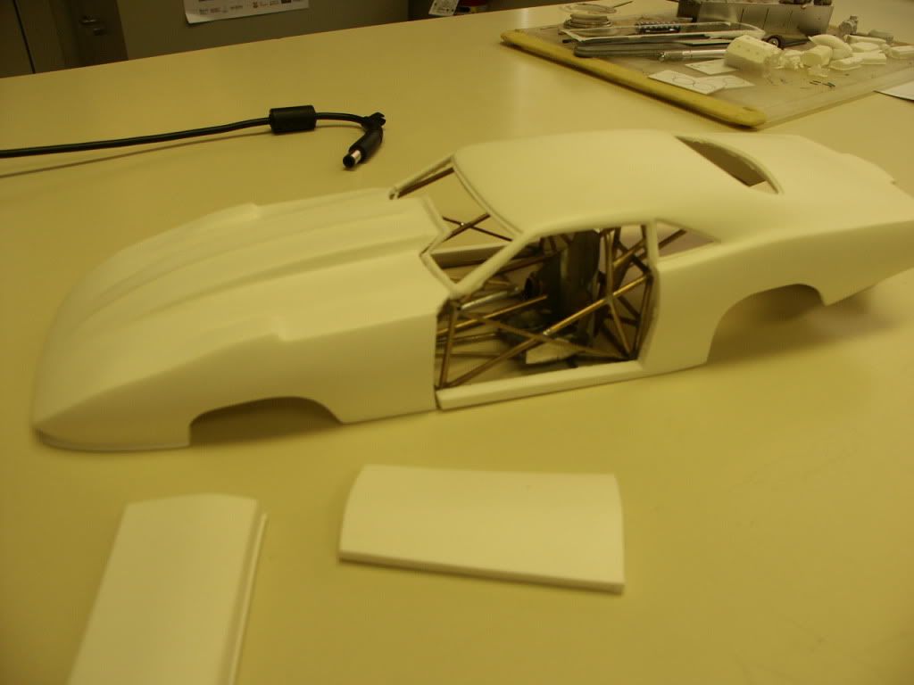

Hey fellas I know its been a fews days sence Ive made an update , but with the camera down and the soldering iron kicking the bucket I didnt have much to do. But I decieded to get some work done on the body and start the motor. so heres a few pics to get the show back on the road.

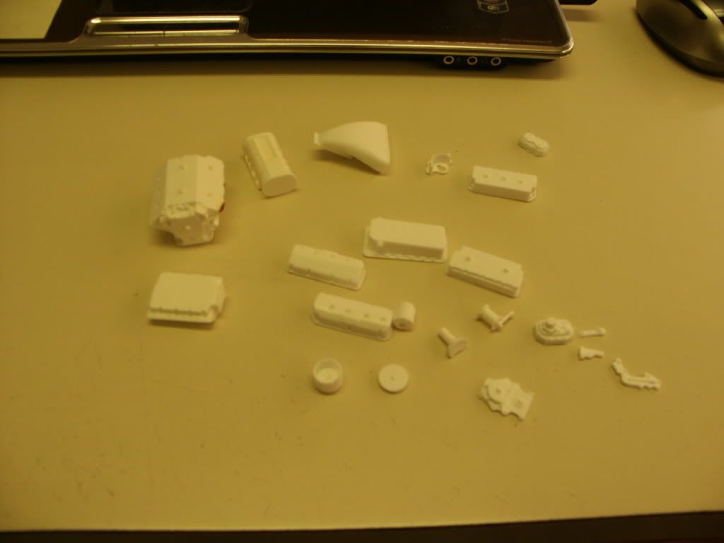

heres the motor pieces , not sure how many of them I will actually be using but its a start. lol i burned the corner of my engine block with my soldering gun, also took out two fingers at the same time LOL!

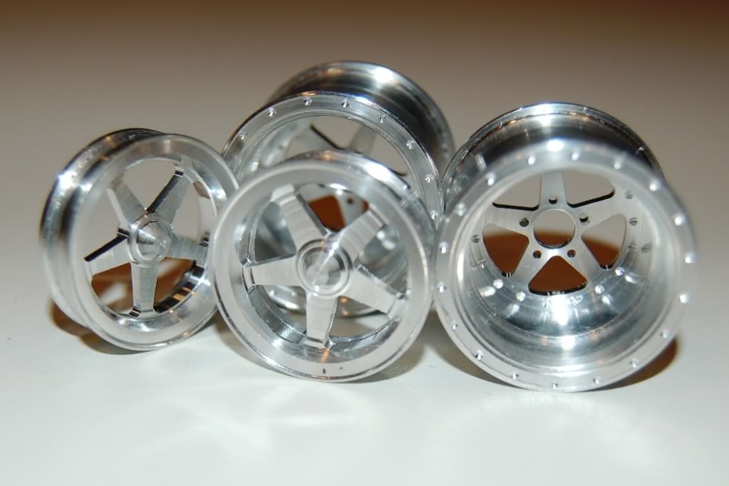

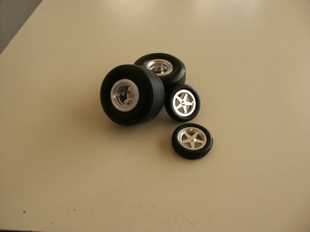

these are the rims that forum memeber Micro Nitro is turning for me.

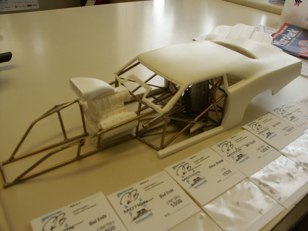

I would like to post a small update if you can call it that or more of a showing of things recieved and things started. I recieved a bunch of stuff from my buddy Robert at RB Motions , and now I can begin detailing some of the parts im now working on. enjoy.^_^
some of the parts from RB motion and a motor mockup to check for fittment

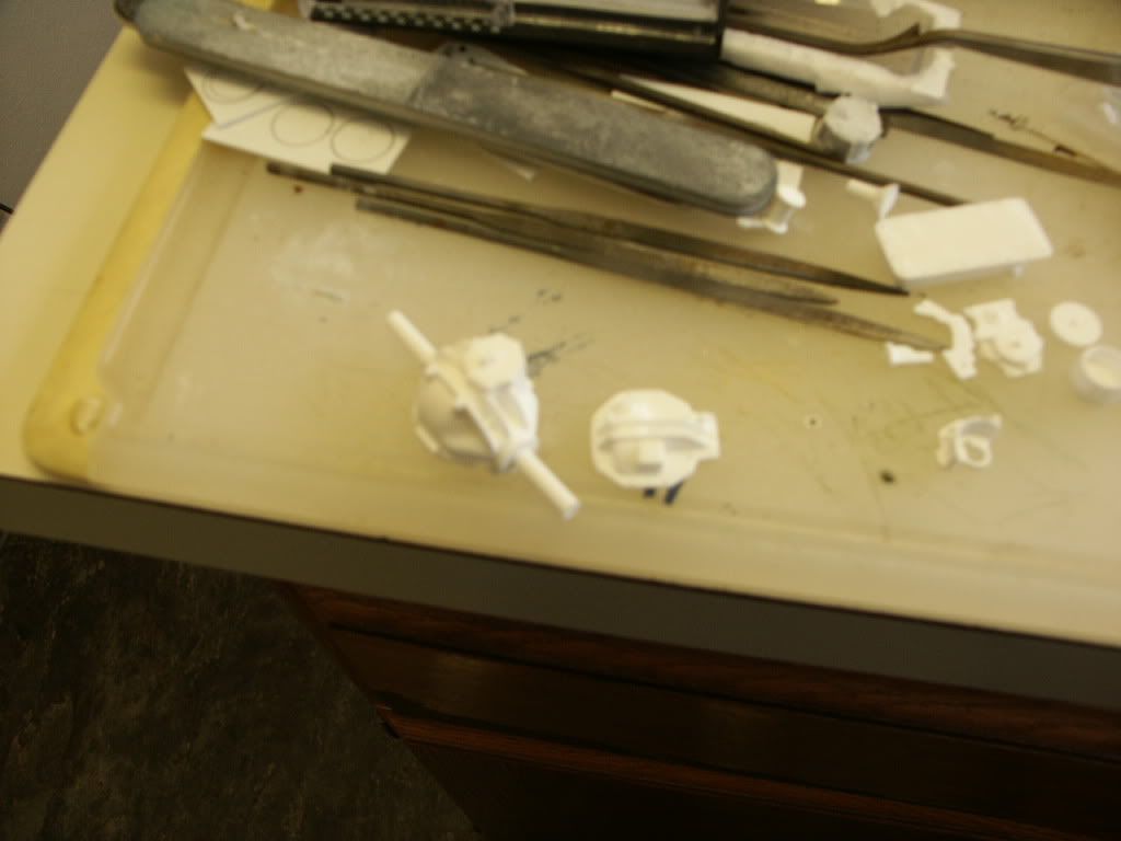

getting some work done on the brass Lenco tranny just need to smooth a few things outrbmotionparts006.jpg
And here ive drilled the holes and cleaned up the rear end and i'll be painting it today and getting all the details on it.

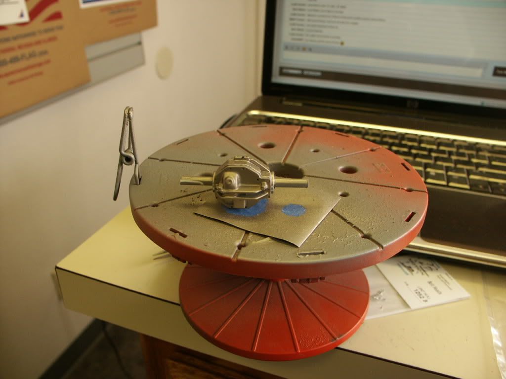

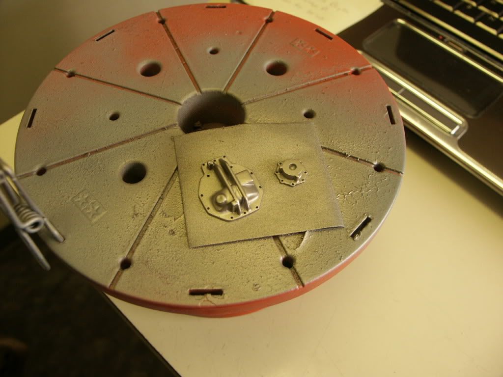

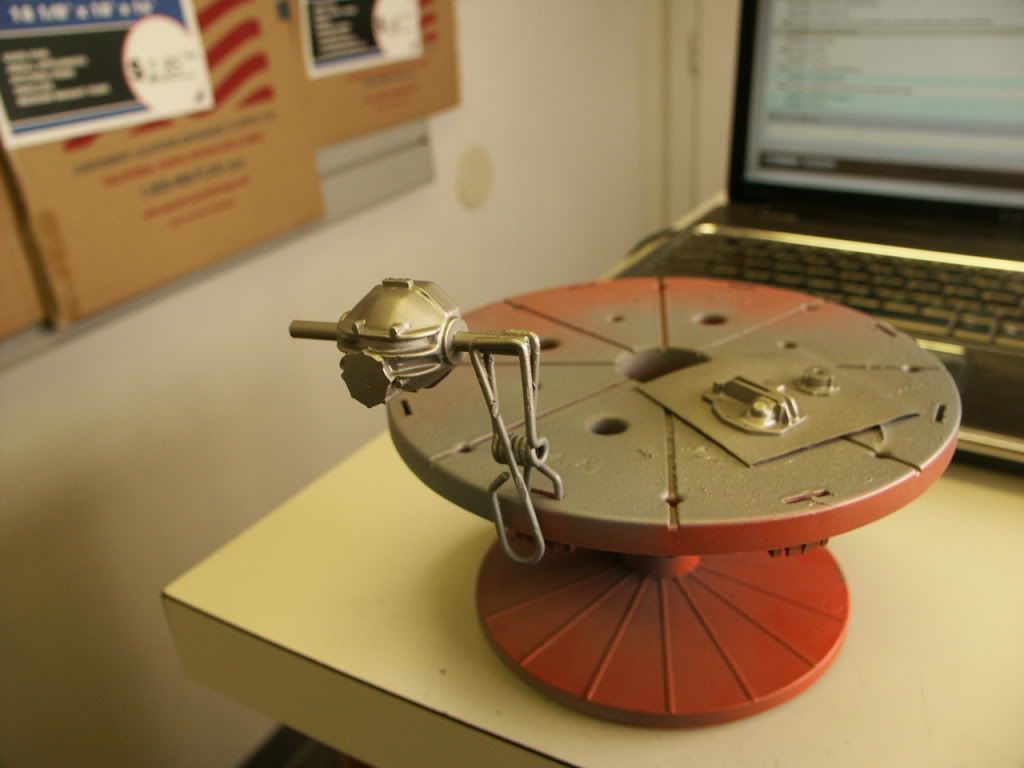

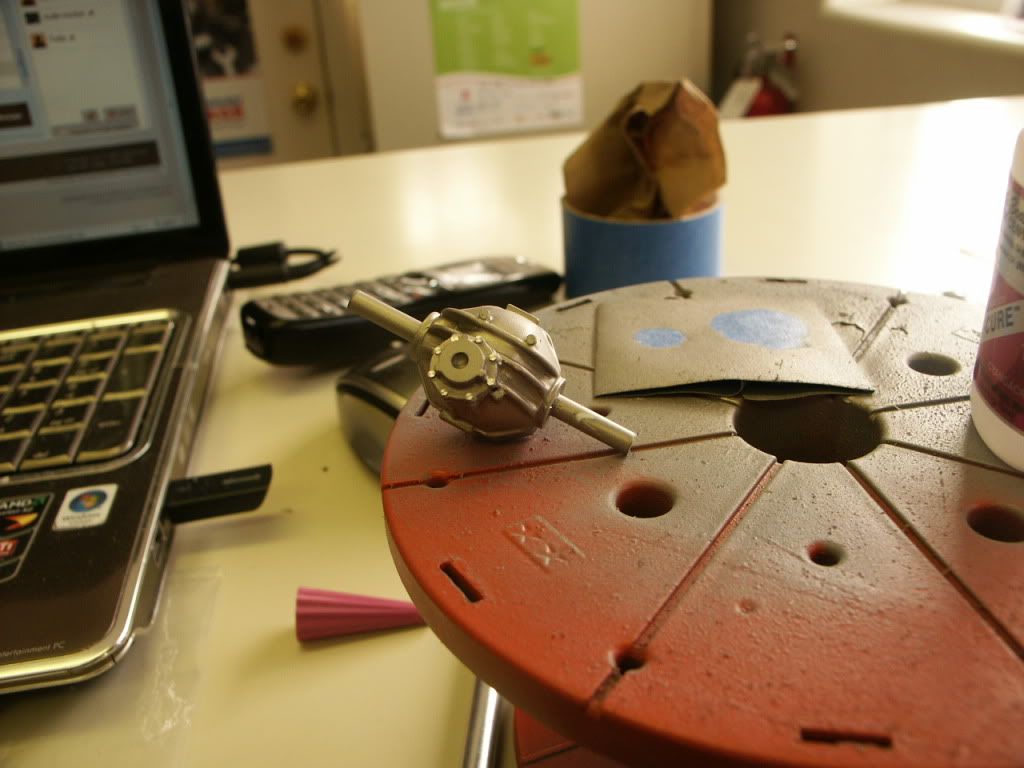

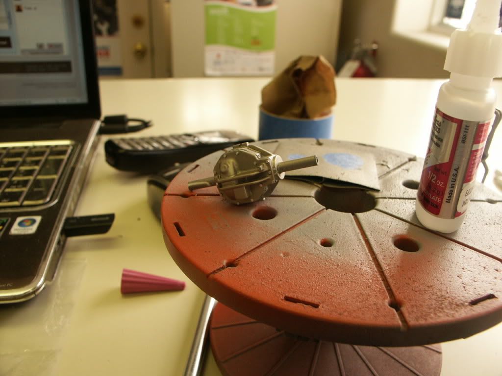

Hey Fellas I have another update today ! Wow 2 in 1 day i must be doin something right LOL! Anyway I have the rearend housing painted up and bolted down . hope you enjoy!
housing has a fresh coat of Alclad burnt steel on it.
this is a 3 piece housing
And here she is all put together just need to bolt her up.....
Bolted up .....used a whole pack of .042 hex bolt from RB Motion on this puppy....

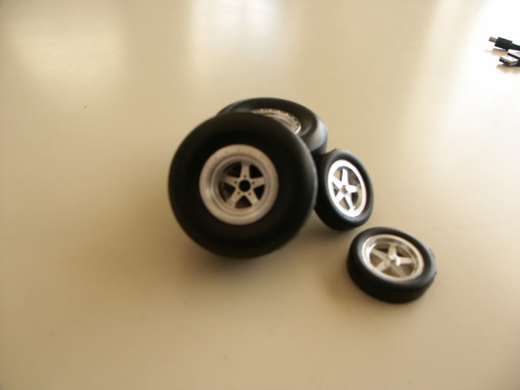

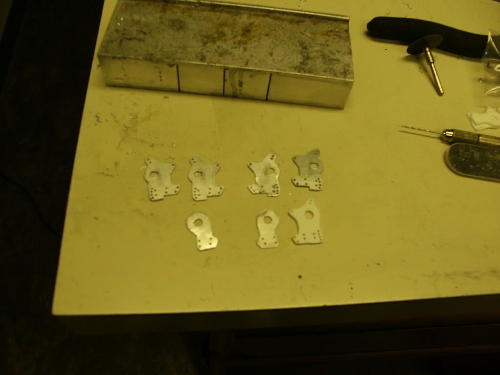

Well I worked all day on the rear end four link braces and im fairly pleased with the outcome. I also got my custom wheels turned by Forum member Micro Nitro he did an outstanding job too. I got some decal I purchased from slixx but i'll have to up scale them to 1/16 because these are for 1/24 scale. AND i got my c arbon fiber decal from scale motor sports. So things are starting to look good for building. I hope you enjoy this small update......B)

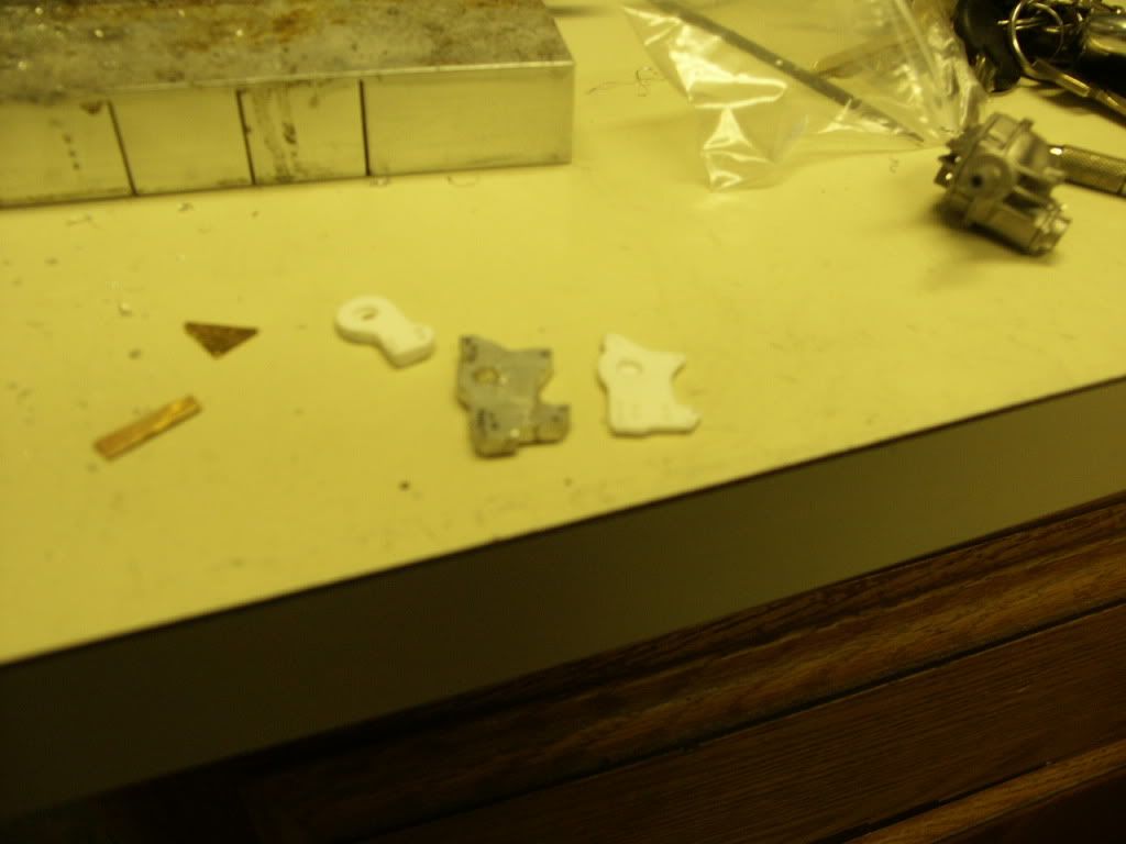

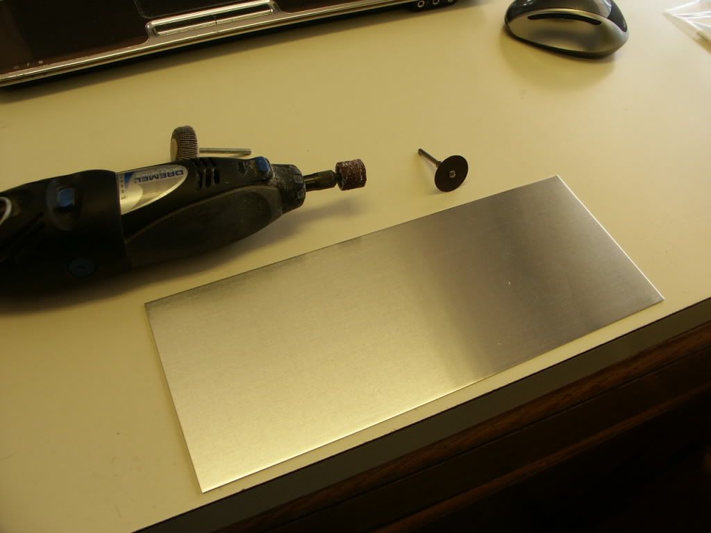

heres what im starting with for the 4 link brackets.....

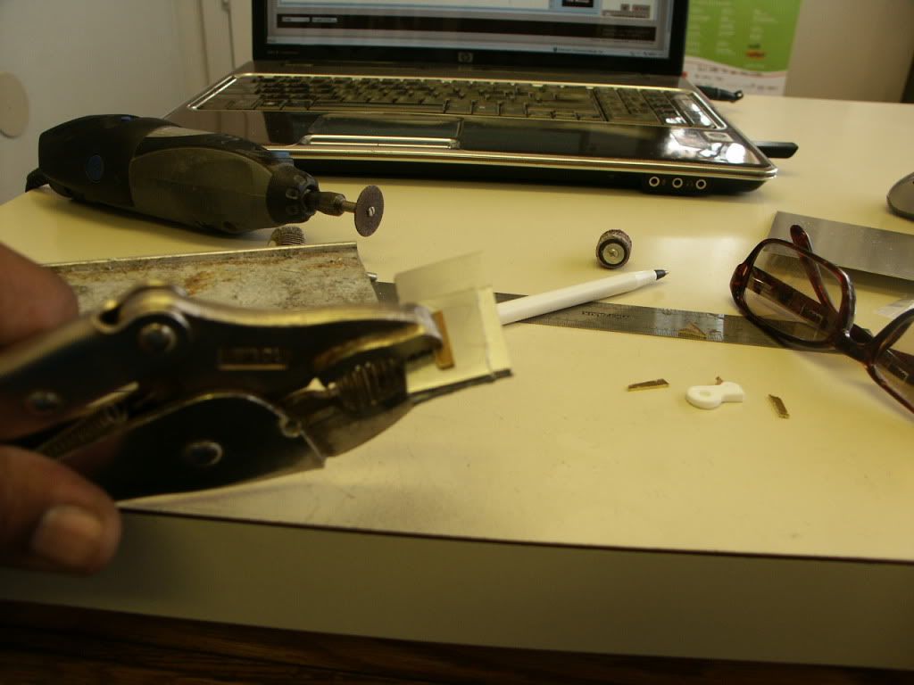

I started by cutting and clamping four small pieces of aluminum sheet together and drawing the pattern for the braces on the top one. this is done so all the braces will be the same size and accurate.

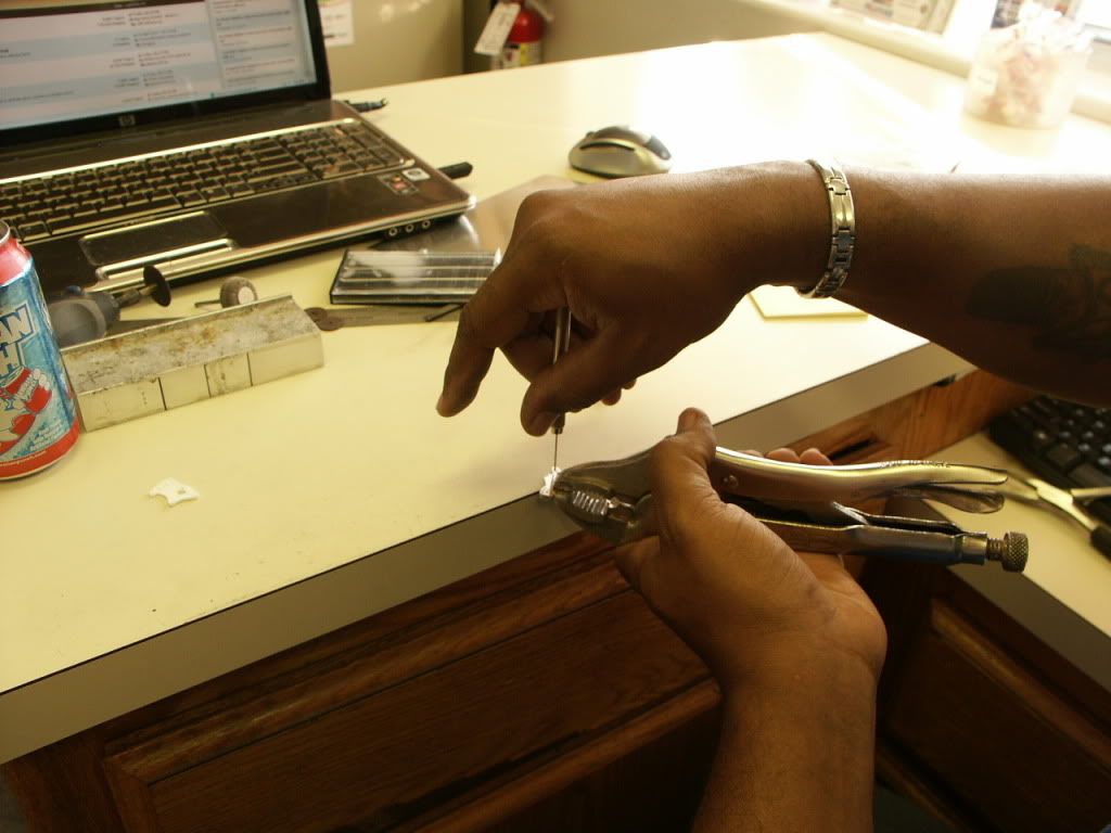

ok once the general shape is cut out I can file smooth and then drill hole through all four pieces , this insures allignment and a uniform apperance. By the way drilling 12 holes through four pieces of .032 aluminum sheet is not fun and takes all day.
ok now i have my ruff braces the four are still stuck together at this point , but just check out the differance between the aluminum and the resin.
here are the pieces semi cleaned up and almost ready to install.....
