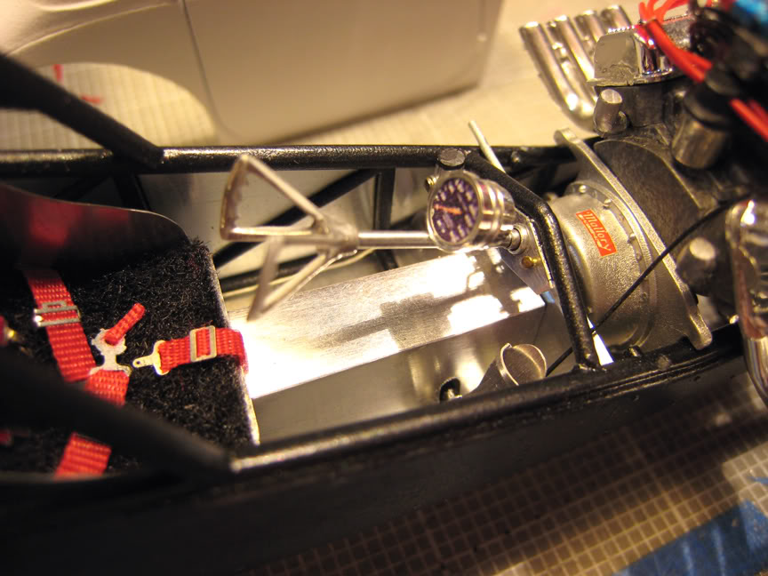

gasser59 Posted August 25, 2011 Author Share Posted August 25, 2011 (edited) Niko - thanks for the comment and following along. Got a bit more work done after work last night, well actually this morning. Got the steering mechanism and instrument panel in. Still more interior details to go like fuel shut off lever, wiring for the dash switches and steering wheel button. I bought a PE butterfly wheel for this but its just too big. Might try my hand at making one out of printing plate. As always, input welcome. Edited August 22, 2017 by gasser59 Updating photos. Quote Link to comment Share on other sites More sharing options...

HondaRacer1124 Posted August 25, 2011 Share Posted August 25, 2011 (edited) Brad.......Crazy good!! How did you turn the aluminum tubing using a dremel? Your steel brake lines look so authentic (metal?) I'm following this thread. The drawing are great to have. Edited August 25, 2011 by HondaRacer1124 Quote Link to comment Share on other sites More sharing options...

gasser59 Posted August 25, 2011 Author Share Posted August 25, 2011 Thanks Eric and Hugh. Yes, the brakes lines are actually metal rod that I found and it's very flexible and still retains it shape. As for turning aluminum in my Dremel, well it was already the correct diameter but I wanted it a bit shiner and the leading edge smooth and shiny so I married it up with the correct sized collet and polished it with 600 grit. After it was done, I cut off the excess by rolling/cutting with an X-Acto. It was actually done on a low speed with my Dremel Stylus power tool. The modeler's best friend. Quote Link to comment Share on other sites More sharing options...

gasser59 Posted August 26, 2011 Author Share Posted August 26, 2011 Thanks for the compliment John. The brake cylinder was made from 1/16" tubing for the horizontal piece and a piece of 1/8" tubing for the vertical part which was notched out to fit the smaller tubing. I puttied up the larger tubing at the top and after sanding, painted it flat black. The head of a small straight pin is on the visible end of the smaller tubing to give it a finished look. I'd like to say I made the tach as well but it is an aftermarket piece purchased at the LHS. Its turned aluminum and has a couple decals and PE pieces that I found it hard to even see with my magnifier, like the gauge needles. More updates soon. Thanks all for following along. Quote Link to comment Share on other sites More sharing options...
