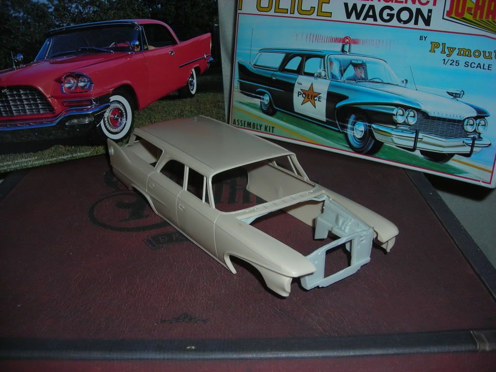

W-409 Posted January 20, 2012 Posted January 20, 2012 That is a sweet looking motor Thanks, Dirk! Jim: That looks like very interesting build, I'll be wathcing VERY closely. That Chrysler 300C chassis fits nicely on that body, it would be nice to have that kit- or at least body from it.

CorvairJim Posted January 21, 2012 Posted January 21, 2012 Opened it two days ago. Looked at things yesterday and decided to kitbash it with an AMT '57 Chrysler 300C yesterday. I cut and glued some styrene today. I figured that the first thing I needed to do was to make sure everthing would fit the way I intended, so out came the ruler and I started measuring. Then I roughtd the 300's floor pan, interior sides, dashboard, firewall, back seat, and chassis together to test fit to see if everything would fit in the wagon body. So far, so good, so I got out my trusty X-Acto with the scribing blade in it (the tip snapped off a #11 blade) and scribed the engine bay sheet metal out of the 300. Then I cut what passed for the radiator wall out of the wagon and did my first test fit of the 300's engine bay in the wagon body. I found I had to cut it right in front of the radiator wall, so that's what I did. Two minutes with a razor saw and we're almost there. A little finessing with some of the plastic bits molded inside the wagon body in the hood hinge area and where the radiator wall used to be and we're nearly there. I got out the Dremel and took down the top of the radiator wall ablut a scale inch so the hood would fit and Voila! It was like it was intended to go there all along, like AMT was channeling the engineer that made the Jo-Han molds all those years ago when he did the 300 molds! Gee, ya think that maybe that Mother Mopar might have used the same basic car for these two? Now to get started cutting up that 40+ year old interior bucket!
CorvairJim Posted January 22, 2012 Posted January 22, 2012 I got a couple more hours in on the wagon last night after I signed off. I made a lot of progress on the interior. I decided to leave the 2nd seat in place, the way it would be at the beginning of the Cannonball. The floors are gone from the front and middle foot wells, and the 3rd seat was cut down to allow me to put in a flat piece of plastic for the folded down 3rd seat. I scribed lines into it to represent the three panels, and cut in the handle to lift the rearmost one. I also ground down the insides of the interior's rear side panels and the Chrysler's rear wheelhouses to allow them to fit together and still have the chassis fit up under the interior with everything in place where it has to be. After several test fittings, I made extensions to go on the bottom of the door panels to extend them down to meet the Chrysler floor. Would you believe the interior bucket was 3/8" too short??? I knew it looked too shallow, but that's almost half an inch, folks! 3/8" in 1:25 comes to 9" in 1:1! How would YOU like to have 9" less depth to the foot wells in YOUR car? Anyhow, I scribed lines in the bottom of my new side panels to represent the sills on the floor at the bottom of the doors. I still need to make kick panel extensions to go up in front of the doors, and extend the seats down to the right depth (the back one down to the floor and the front riding about 3" scale above it). In typical early 1960's Jo-Han fashion, the seats had sharp cutoffs at their leading edges instead of curving over. I took a few minutes to sand them to a more comfortable radius. I'll be cutting the pedals from beneath the Chrysler's dashboard and attaching them to the underside of the Plymouth's dash. I'll add my own dimmer switch. The Plymouth kit comes with a clunky piece that's supposed to combine the shift lever and turn signal stalk on one ring that goes around the steering column. Ain't gonna happen in this model! I'll make my own, thank you very much. Mine will actually look realistic, as opposed to the hugely out of scale things Jo-Han wants me to use! That ring even has a tachometer mounted to it's top! (How many 1960 Plymouth wagons do you suppose ever had a column-mounted tach?) I'll post a couple of pictures once it's closer to being ready for paint.
