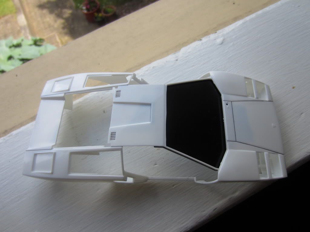

Thanks to Marcos (and his feature article coming soon in MCM), I did a quick once-over with the 2009 Revell Challenger that I was building before.
I love the difference.
I will say this: Don't give up after your first attempt.
Practice makes perfect, or something like that...
