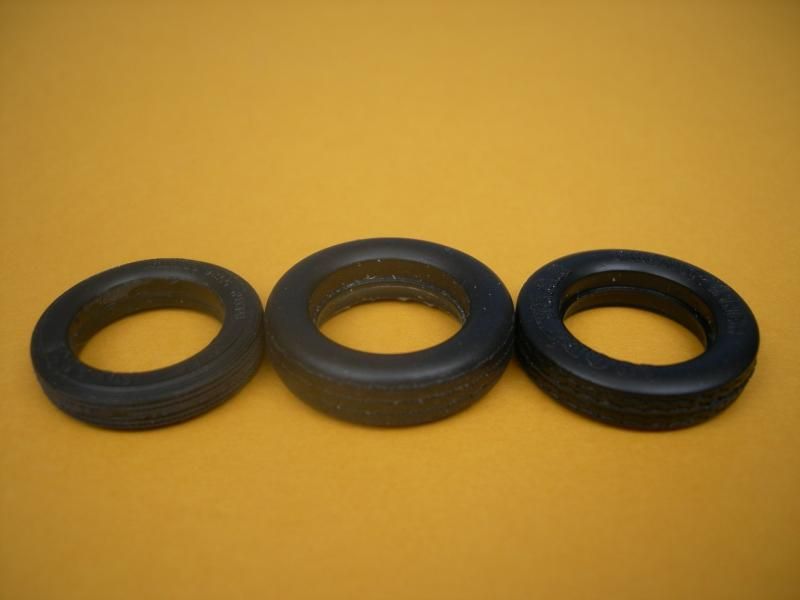

W-409 Posted June 22, 2014 Posted June 22, 2014 The Frontrunners that you have... I didn't find them from your web page as you said that everything doesn't show there so I'll have to ask what size are they? The Frontrunners that can be found from Revell Pro Stock kits (The ones that have Good Year Frontrunner texts in them) are often too small for Stock Eliminator / Super Stock Drag Cars. Are your Frontrunners taller? The reason why I'm interested in this is that I've been working on a master for a tall Frontrunner tire. But it's a lot of work and if someone did the same thing already I could just buy complete sets of them instead of making the master and then buying them from a friend of mine.
futurattraction Posted June 22, 2014 Author Posted June 22, 2014 Niko, I'll plan to take a picture of my new Frontrunner side-by-side with the kit Frontrunner and Moroso tires, just for sake of comparison.

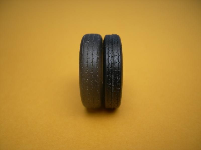

futurattraction Posted June 23, 2014 Author Posted June 23, 2014 (edited) Niko - here are a couple pics of the new Frontrunner tire: Side-by-side with kit Frontrunner Comparison of redesigned tire, flanked by kit Frontrunner and Moroso tire. Mine is a direct replacement for the kit tires. Jimmy - Thanks for taking the time to go through the thread. I hope there are some things that will prove to beneficial to you... The Lord really has blessed me with patience, if nothing else... LOL Edited June 23, 2014 by futurattraction
W-409 Posted June 23, 2014 Posted June 23, 2014 (edited) Thanks for the pics Scott! Your Frontrunners look really good, I might have to buy a set when I run out of those I have now. The one I've been trying to make might be a bit taller, but your tire would fit perfectly on a bit smaller car like Nova. Thanks again! Edited June 23, 2014 by W-409

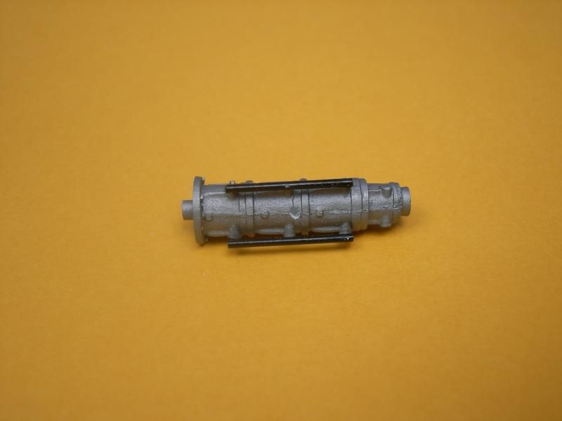

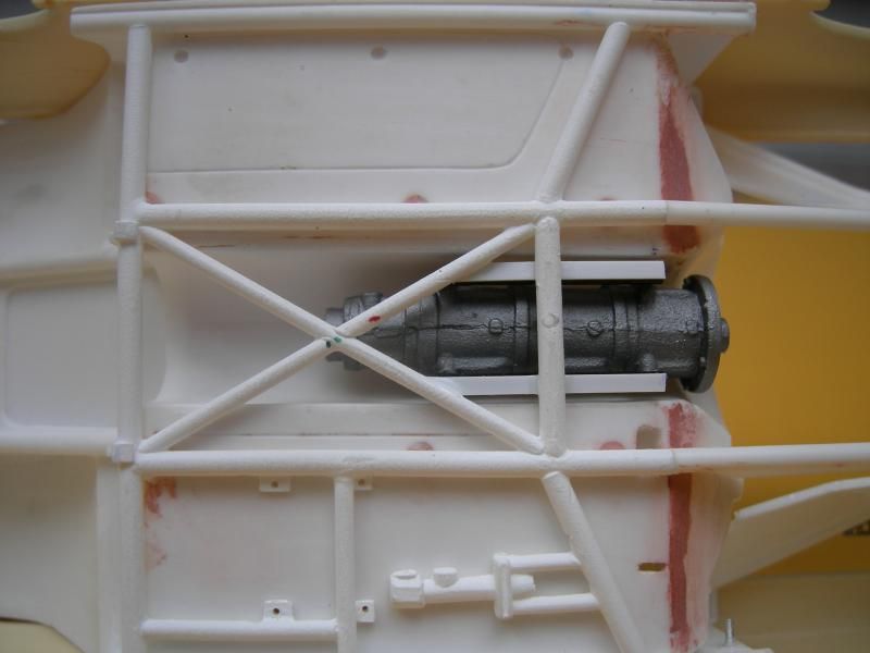

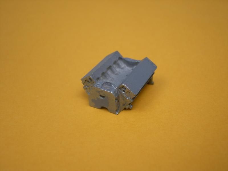

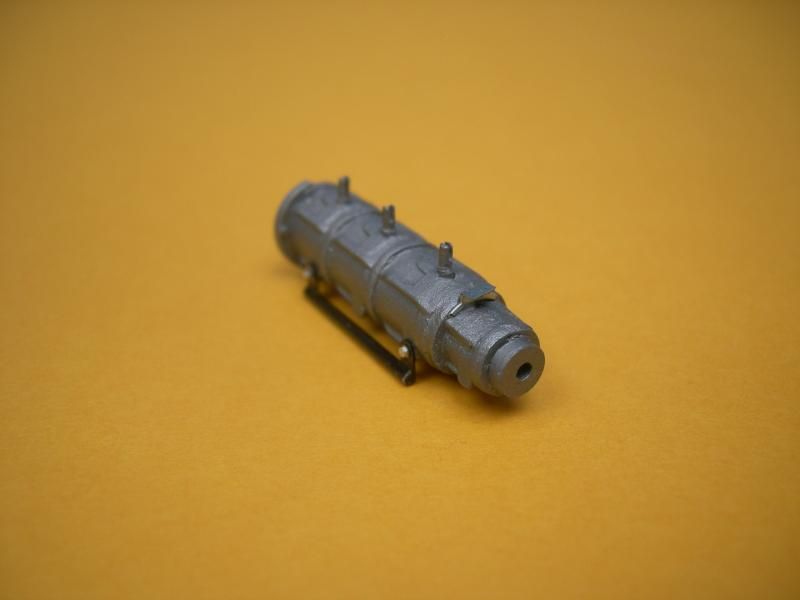

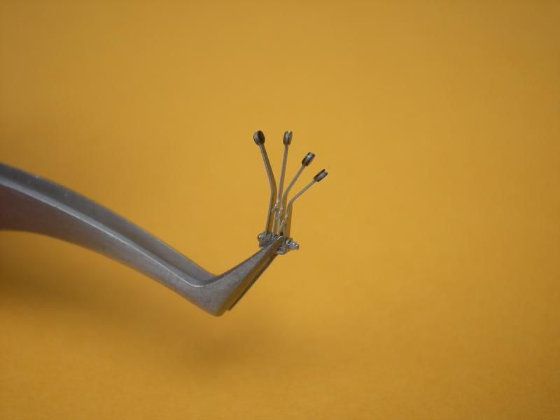

futurattraction Posted June 26, 2014 Author Posted June 26, 2014 Made some progress over the past several days. Haven't had as much time to work on things as I'd have liked, but oh well... After quite some time of thinking and mentioning this, I finally got around to adding slide mounts to the central frame rail system. You can see the trans portion of the mounts and the mount for the shifter above the reverse case. Setting on the central chassis I got so frustrated with myself a couple nights ago. You've heard the saying two wrongs don't make a right. It's true. I'd "cleaned out" the pivot holes on this set of Lenco handles and attached the grips before I realized (bad recollection) I'd drilled the holes bigger than I'd needed to, so I had to fuss around waaay too long trying to find all the appropriately sized pieces to "adapt" to the circumstances. The grip halves are .006" PE pieces that I primed and painted with flat black. After attaching them, I touched a dot of Future to them to give them a tiny bit more thickness and a bit more shine, similar to the black phenolic grips on the OEM Lenco parts. Something I've just barely started on is my aluminum block 351C Now I'm going to have to screw up my courage and take out the trans tunnel before I'll be able to do any more fitting the trans or attaching the levers and linkage to the trans. More to come, Lord willing... Comments welcome!

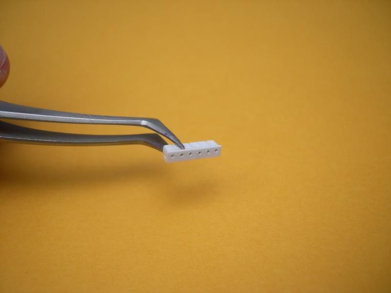

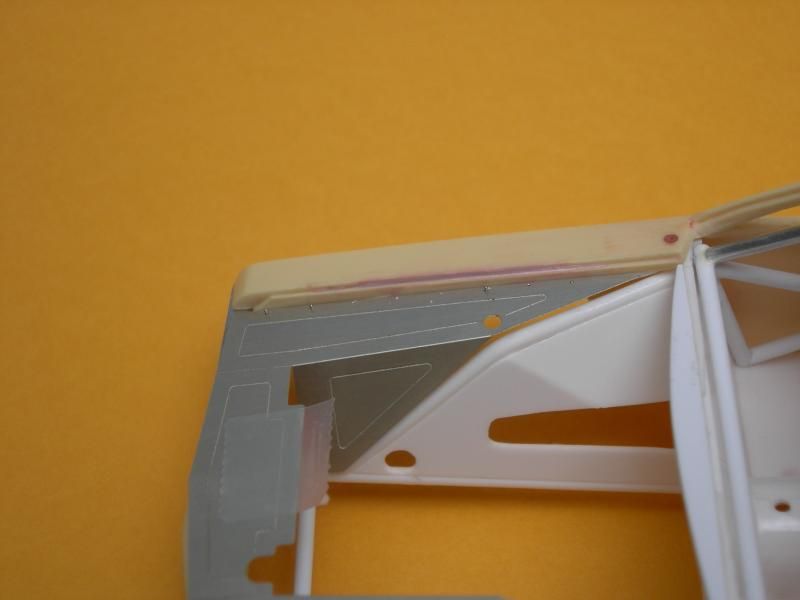

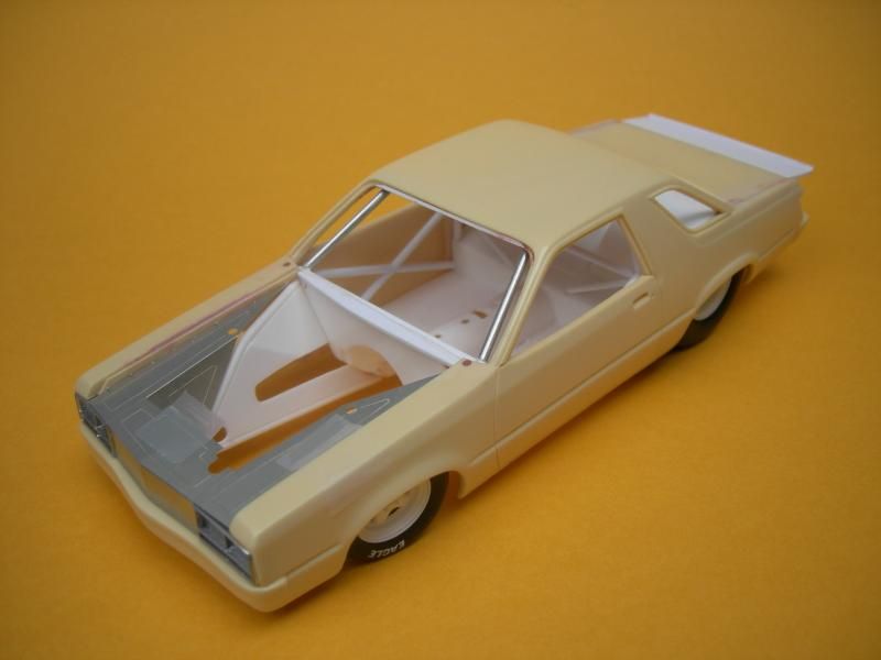

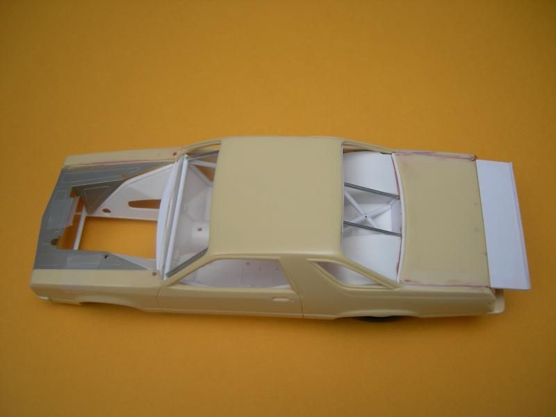

futurattraction Posted June 29, 2014 Author Posted June 29, 2014 (edited) Got some more done. Worked on overhead switch panel. Though not pictured, I added some small PE washers on the ends of the "switches" I'd shown previously to help me keep holes drilled in the face panel in a straight and well spaced line, then glued the switches to the back side of a piece of .080 angle bracket. I will add sides to it to attach it to the cage. Got the holes drilled on the front after drilling through from the inside out. Toggles, when made are going to be .020 styrene rod flattened on one end, leaving the rod end to insert into the switch panel. I added a strip of styrene to the fender flange area so I'd have something to attach the tin work to. I began drilling that so I can add rivets at the junction of the fender and tin. I've still got to do the driver's side and will add one more at the rear on the passenger side. Also got around to starting the rear deck spoiler. I will be adding PE spill plates to it but it's at least started. It's laminated out of three pieces of styrene, .015-.010-.015" so the rivets I'll use to attach the spill plates will have a place to reside. I tried making a spoiler and drilling into it from the outside edge and it was too easy to get off-angle and drill into the surface material. That's all for now. Comments welcome. Edited June 29, 2014 by futurattraction
