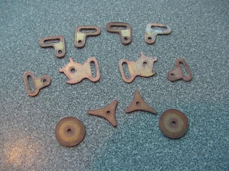

These are most of the raw acid cut brass lap belt buckles.

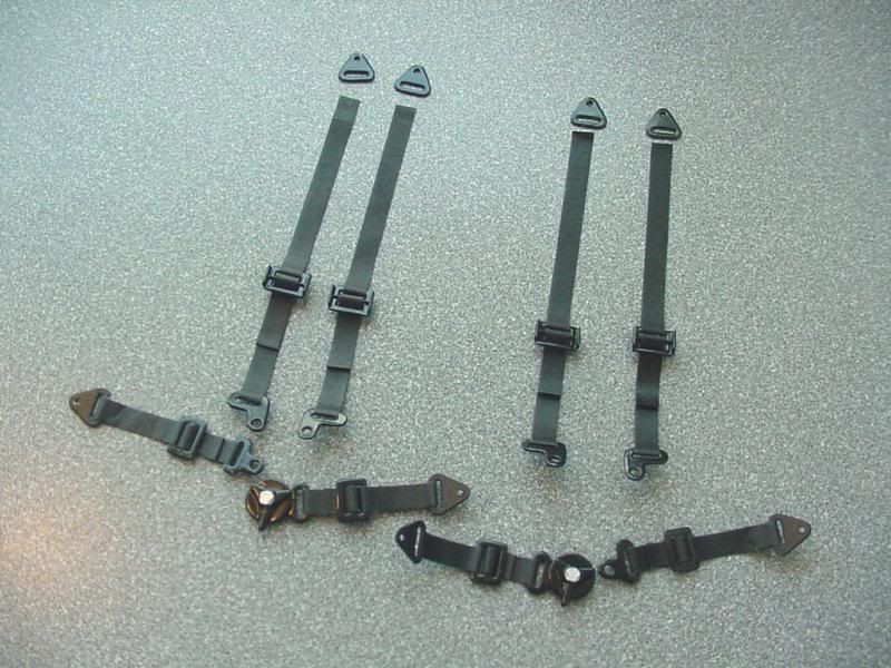

Here is the seatbelt hardware set after it has been “powder coated” semi-gloss black.
The belts and hardware have been assembled. The shoulder belts have pull down adjusters; the lap belts are the pull up style.

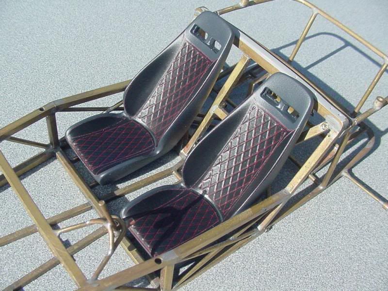

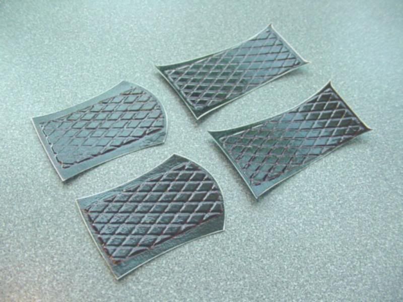

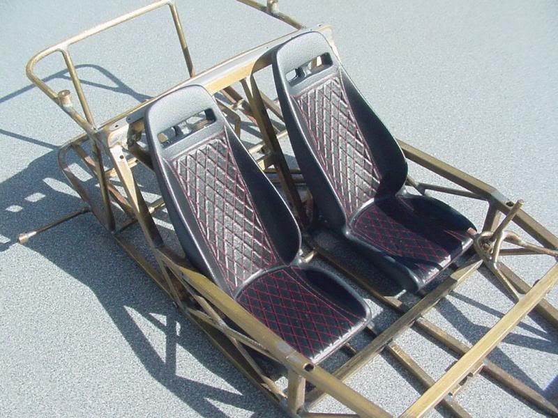

I am making a diamond tufted pattern for the seating surfaces. First I cut the pattern of properly spaced diamonds out of vinyl and applied them to a sheet of decal paper. Then I cut another set of diamonds, each about .020 smaller, and applied them individually to the vinyl already on the decal paper. (That is 262 pieces of vinyl per seat.)

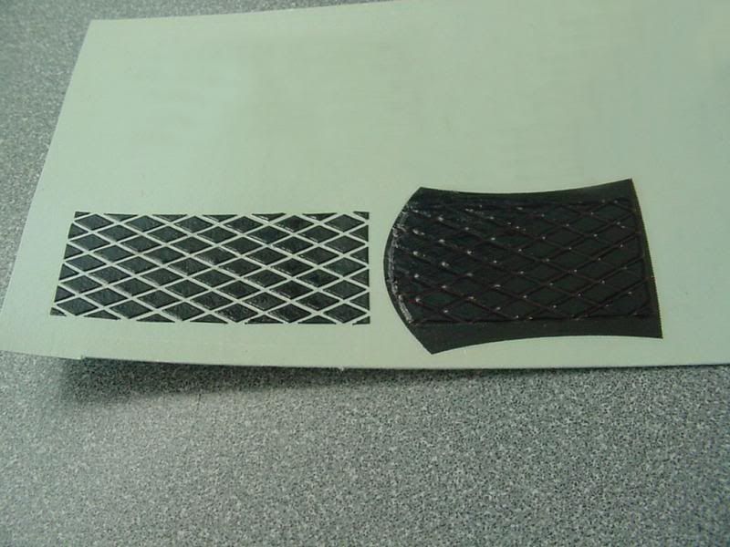

In this photo the left (the seat back) shows the two layers of vinyl on the decal paper. On the right is the lower seat cushion, it has a decal I made applied on top of the vinyl texture that contains the red stitching that runs between all the diamonds.

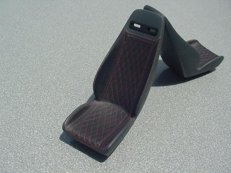

Here are the textured decals ready to apply.
Wait, I want to understand this. So you laid down the two layers of vinyl diamonds on the decal paper, then on top of that you added a separate decal consisting of the overall "vinyl" texture and the red stitching... then you applied that "decal sandwich" to the seats? Am I reading that right? Very ingenious.

Hey Mark... not to put too fine a point on it, but once more, explain your method of creating the seat decals. How were you able to lay the top decal over the vinyl diamonds and base decal without the base decal detaching from the paper? Is there just not enough moisture there to disturb the base decal? And once the "decal sandwich" was made, how were you able to wet the sandwich to release it from the base decal's paper without the top decal layer coming off?
Since there is clear lacquer on the top of the decal paper water won't hurt it. It's getting it wet on the back (paper side) that would activate and release the decal. Once the decal glue from the top layer is dry, the "fresh" glue on the bottom layer lets loose from the paper much easier when it is wetted.

:blink: :o OMG! I LOVE those seat inserts Mark, they could truly pass as 1:1 in my book. Sensational work mate. :)
