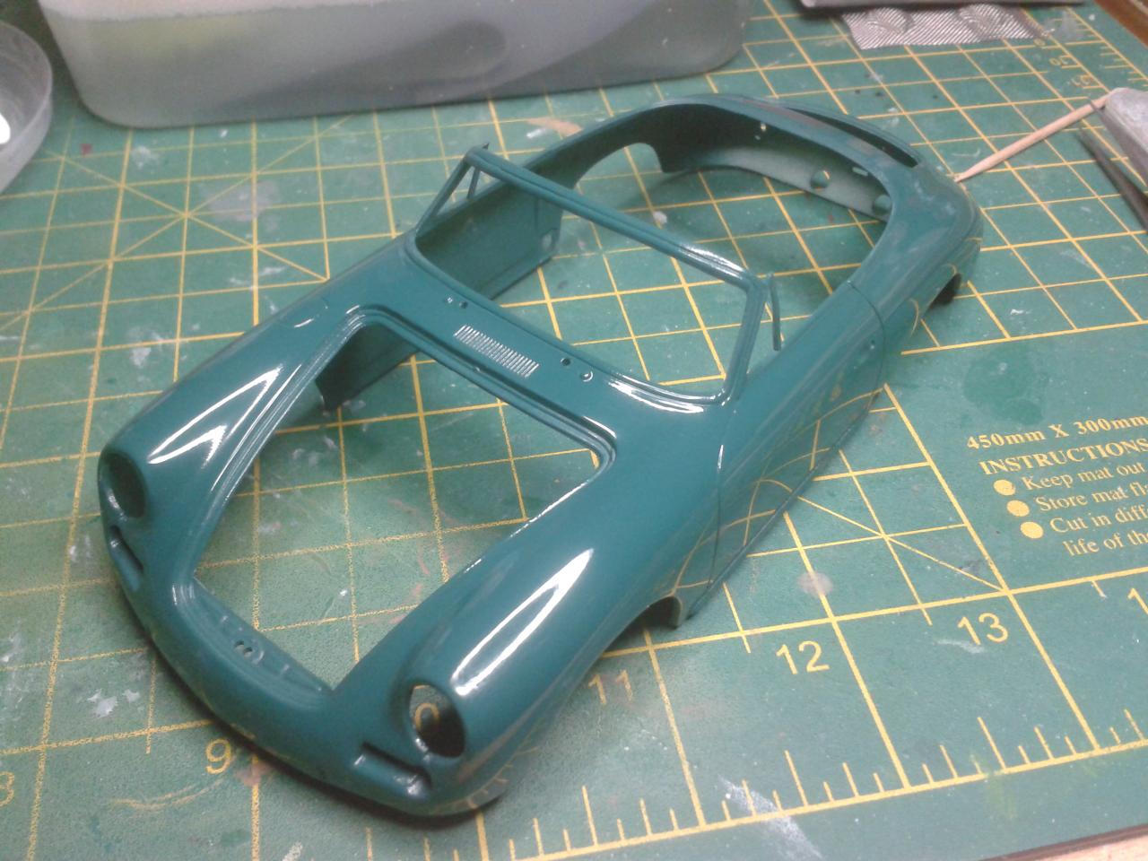

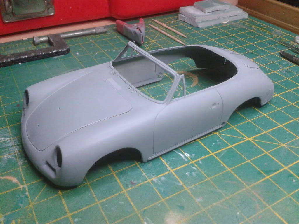

Won this on eBay, it finally arrived this morning, with the windshield frame broken, I'm pleased that it wasn't as bad as the 911 I built not long ago, but still a PITA, but a bit of cyano' and after it had dried up sanded it and reshaped the frame and re-did the panel line in the trim that will be done in BMF after the body has been painted.
Windshield Frame Repaired
The body was covered in mold lines, on top of the front wings, around the rear wings and along to front panel, I spent around 30 minutes with a coarse sanding stick, floowed by a medium foam sanding block, I finally got them sorted
Body sorted

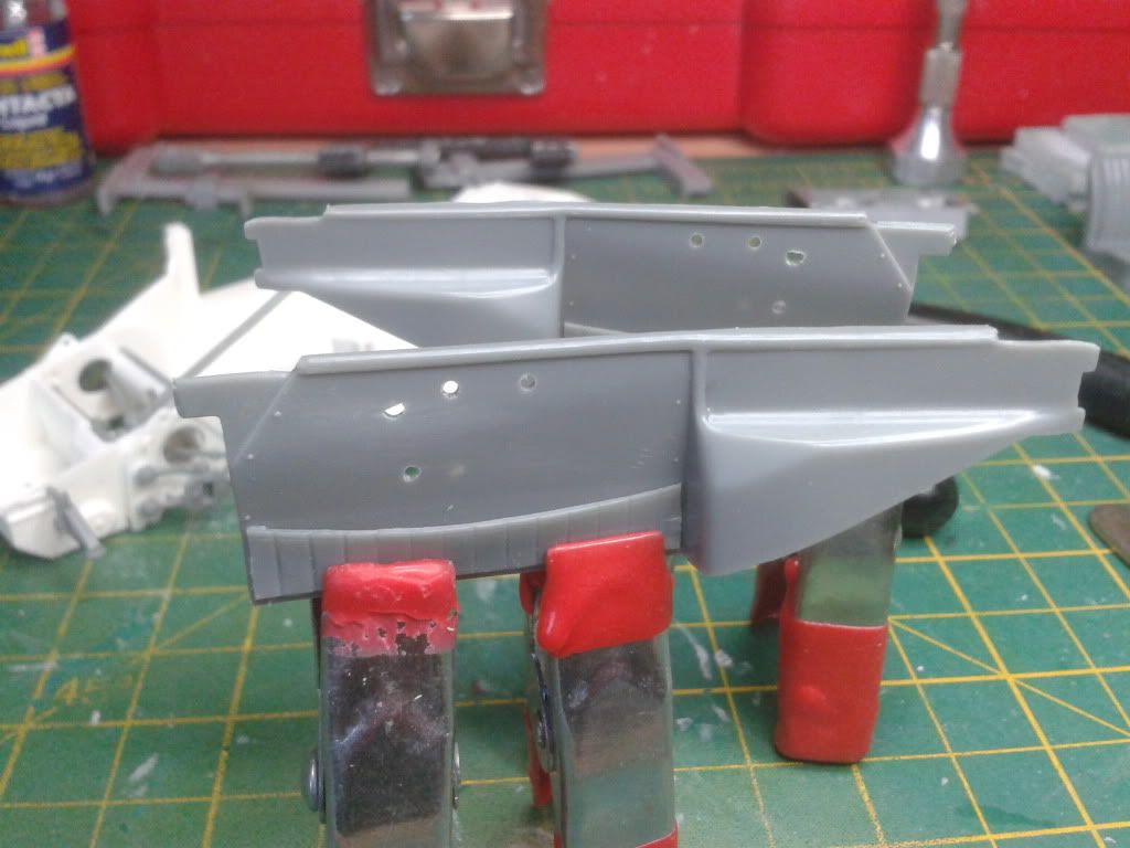

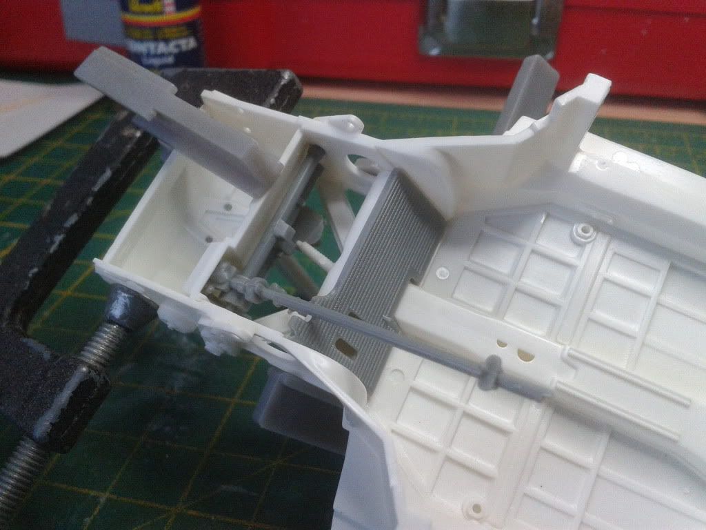

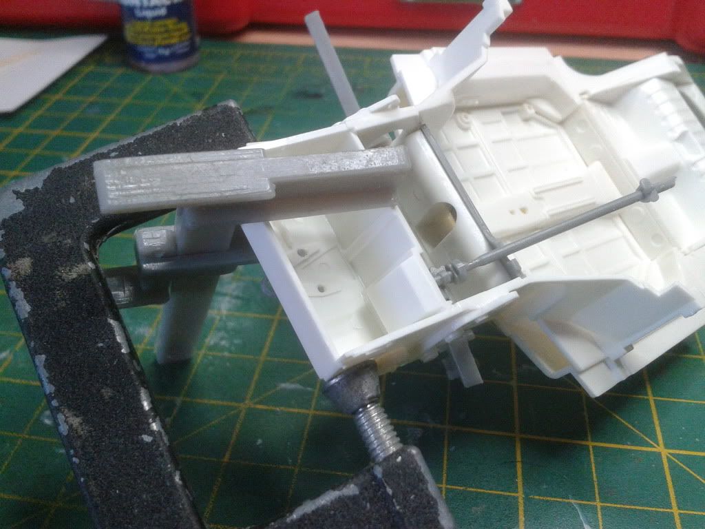

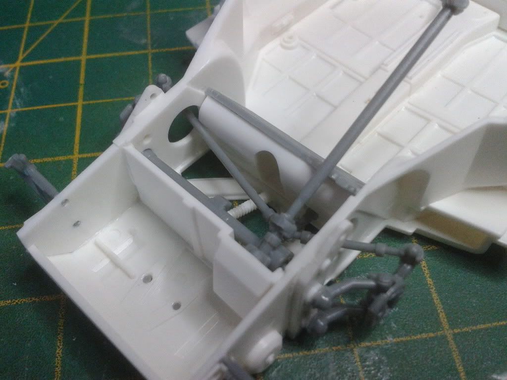

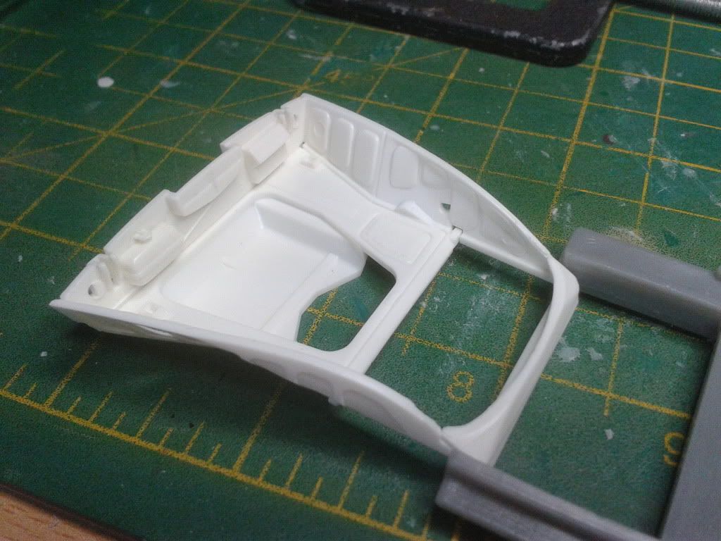

The build starts with the floorpan, and side panels, pretty much like building the real thing, there's a lot of parts in the kit, way more than the Fujimi 911 kit, but I'm sure I'll get though them all ...
It is all clamped up and will be left overnight to dry out ....

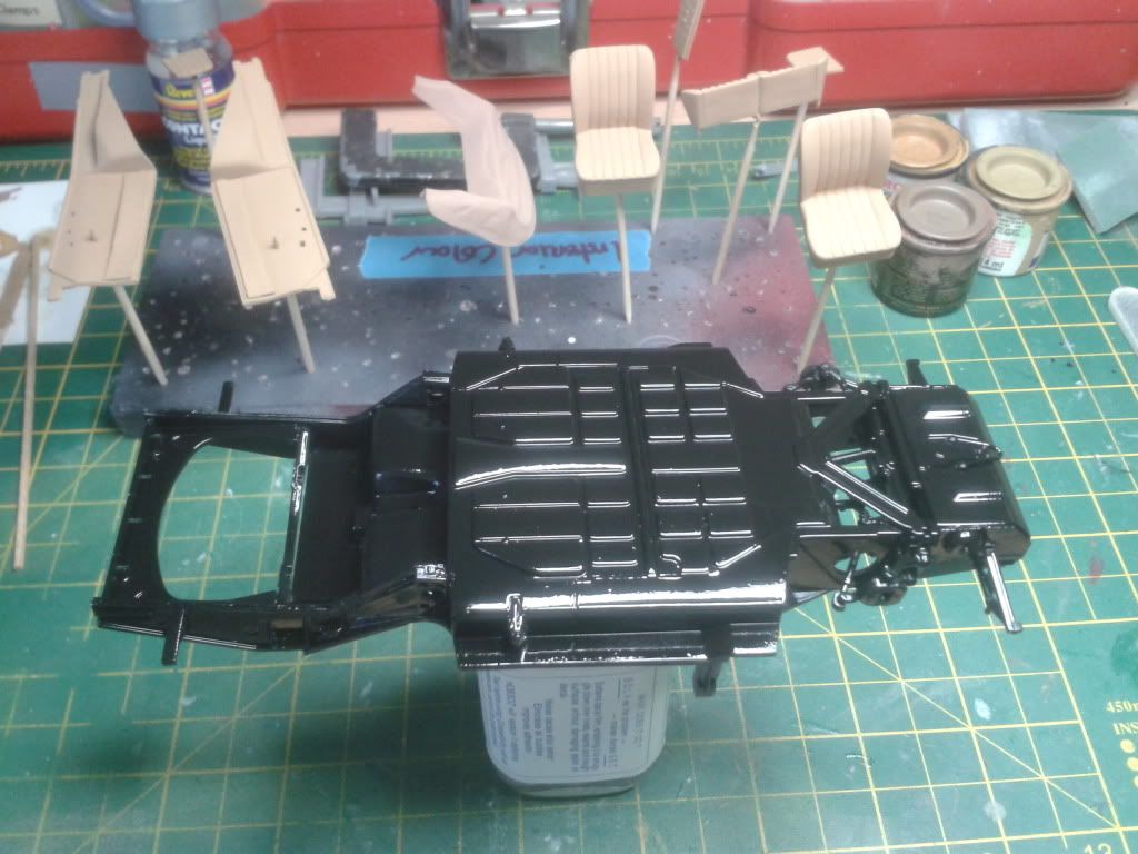

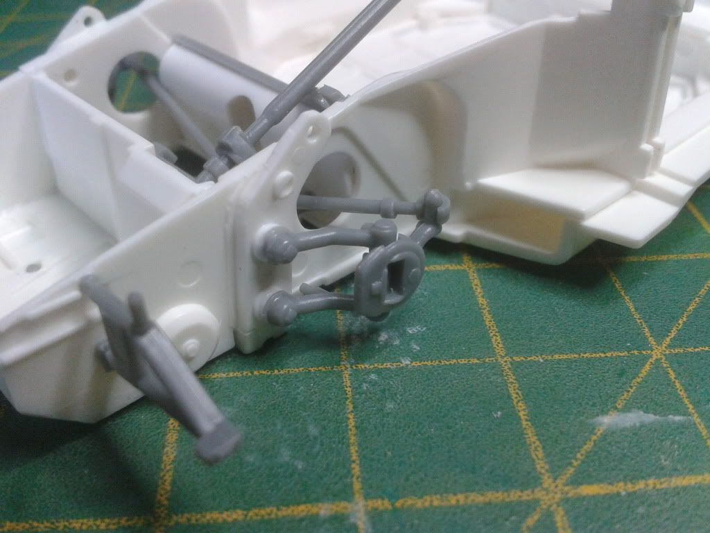

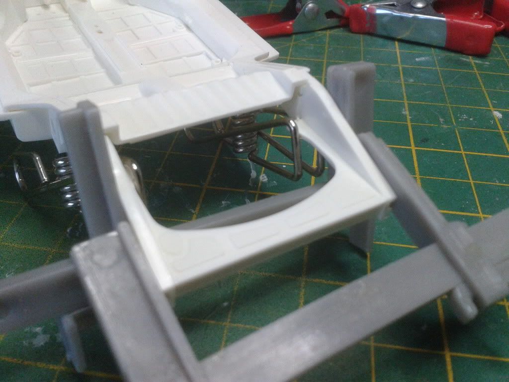

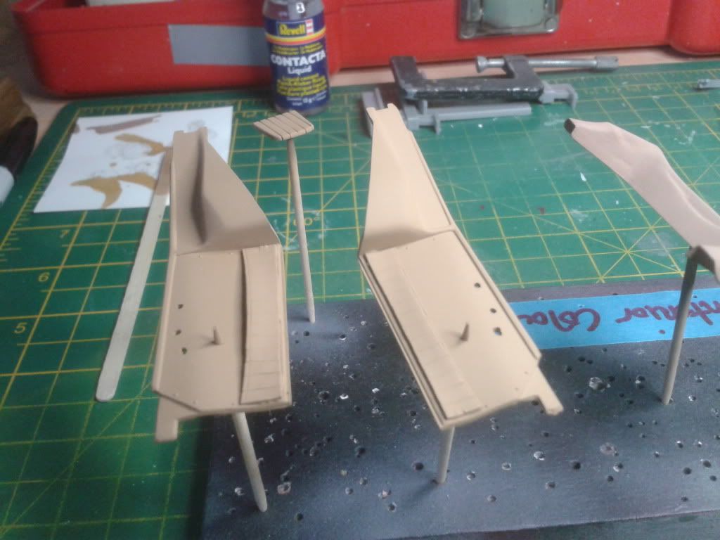

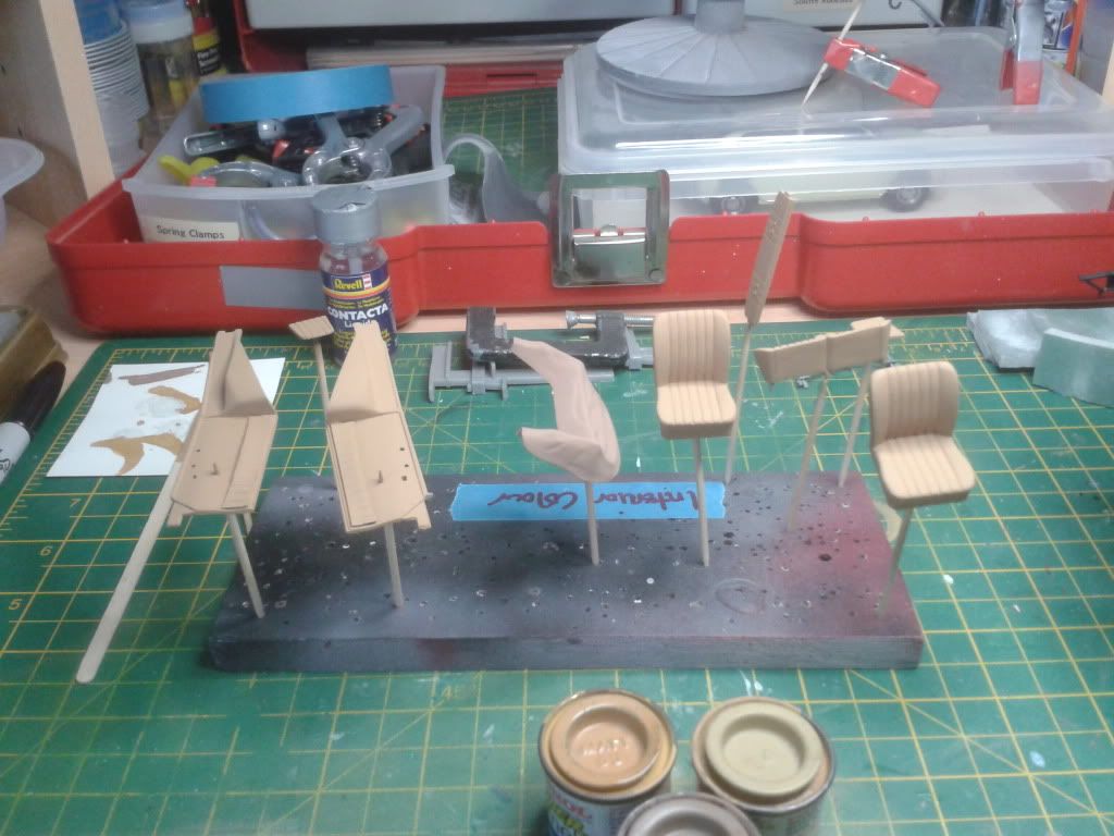

I got quite a bit done to this yesterday, so far the parts fit is very good, it's a good job I have a good supply of spring clamps ...

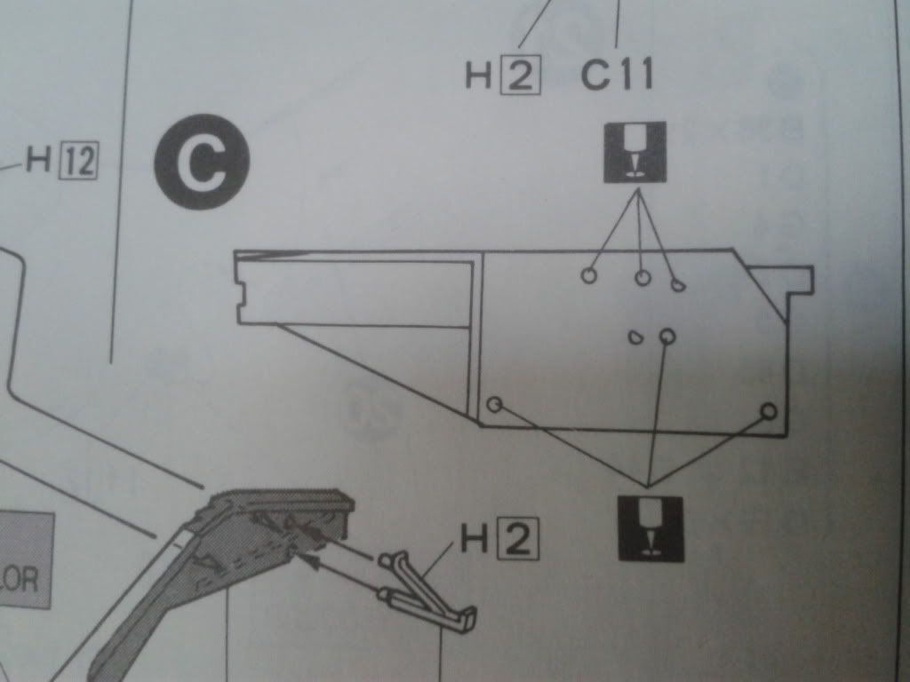

The door panels need to be drilled out for the door handles and window winder handles, as they use the same parts for the Speedster model, which doesn't have winding windows or even a pull handle fitted

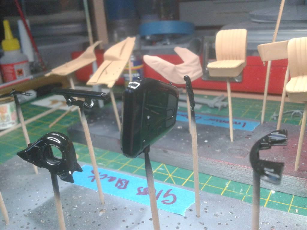

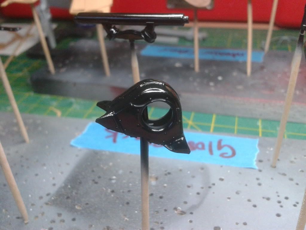

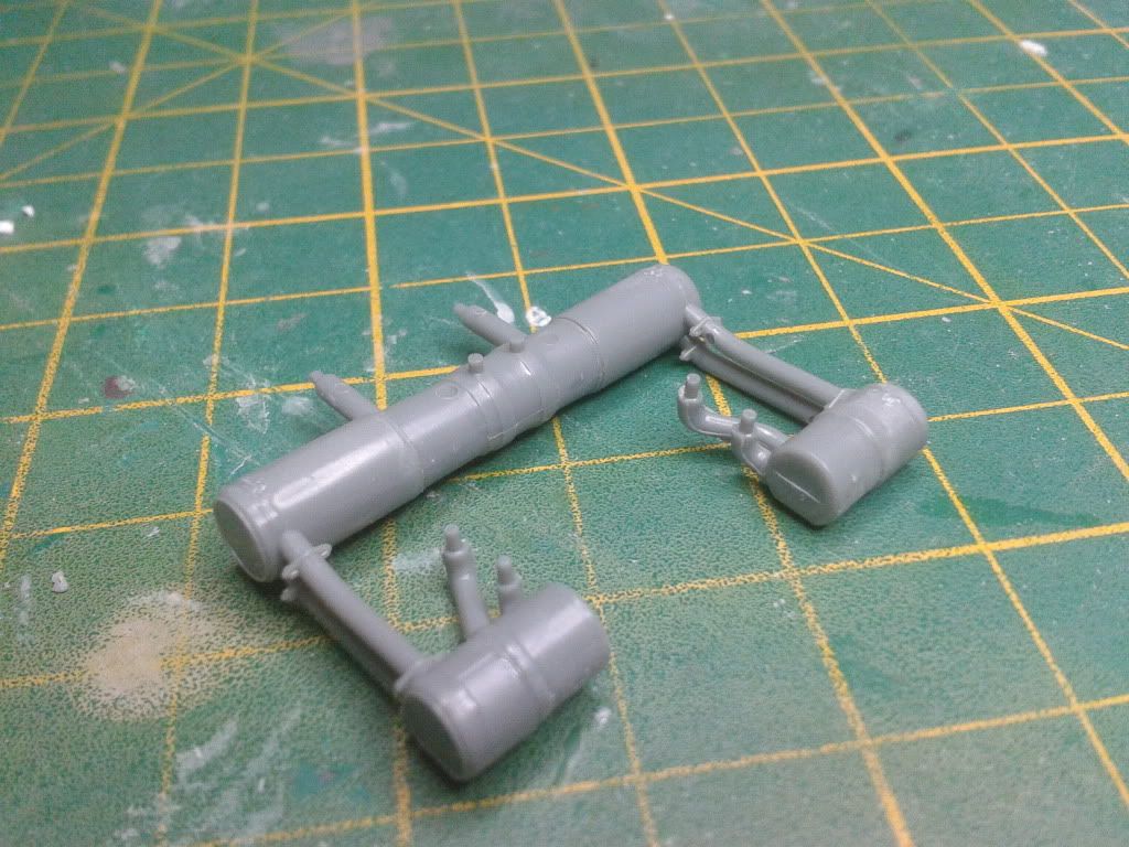

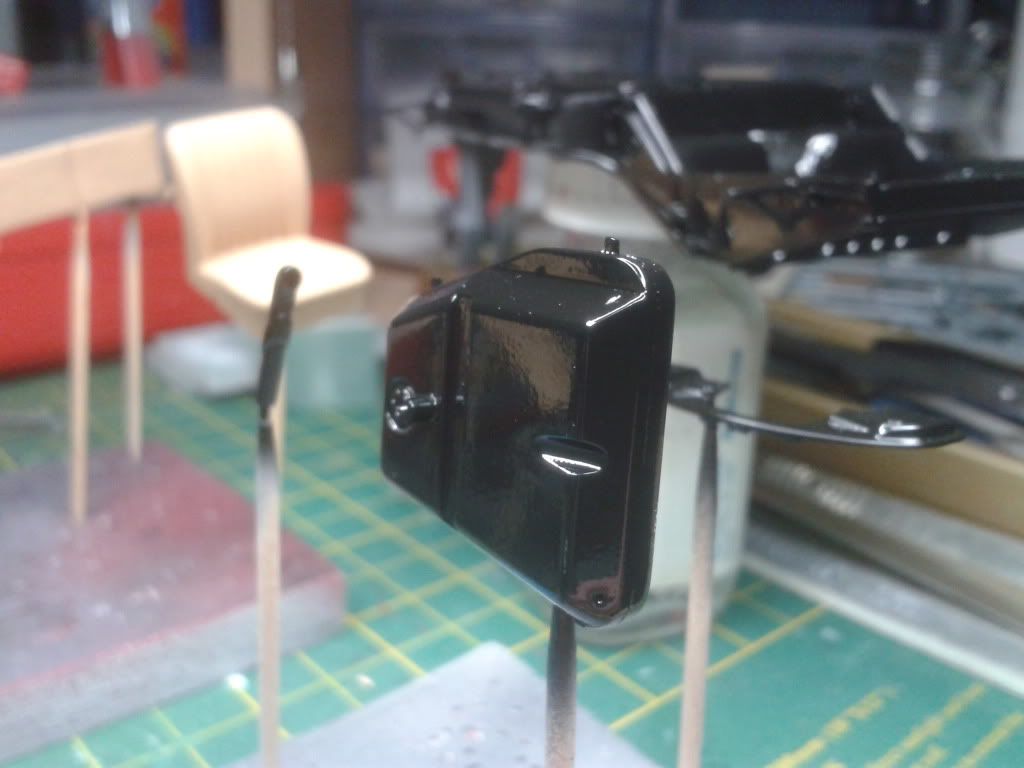

The instructions tell you to put the fuel tank in at this stage, but it will left out until it is painted, as the interior of the luggage compartment needs to be done in satin black, while the tank needs to be done in gloss black.

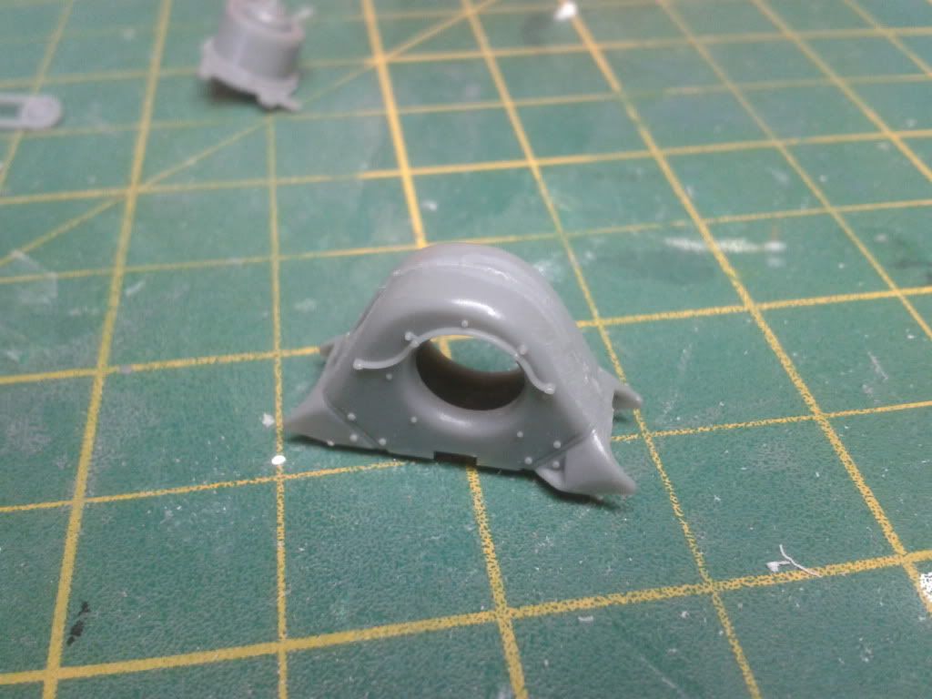

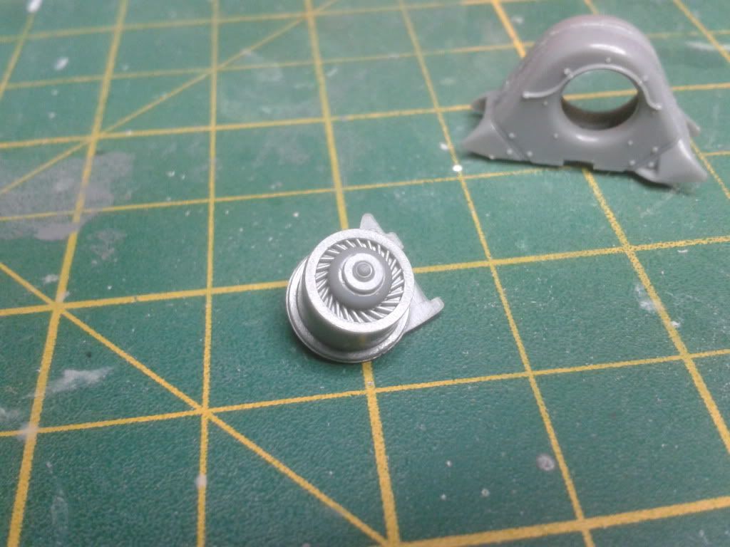

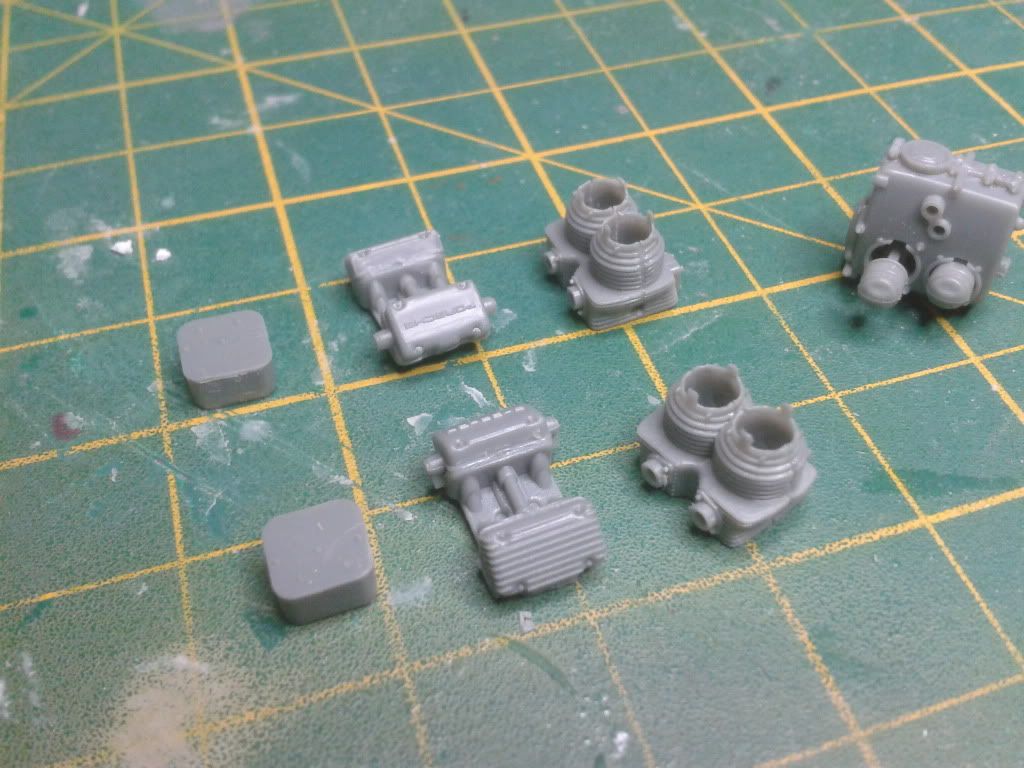

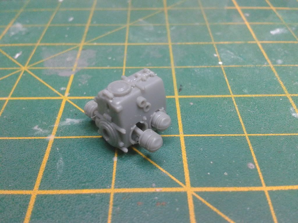

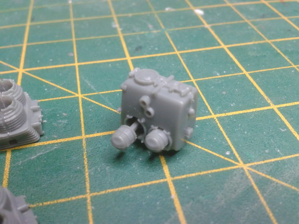

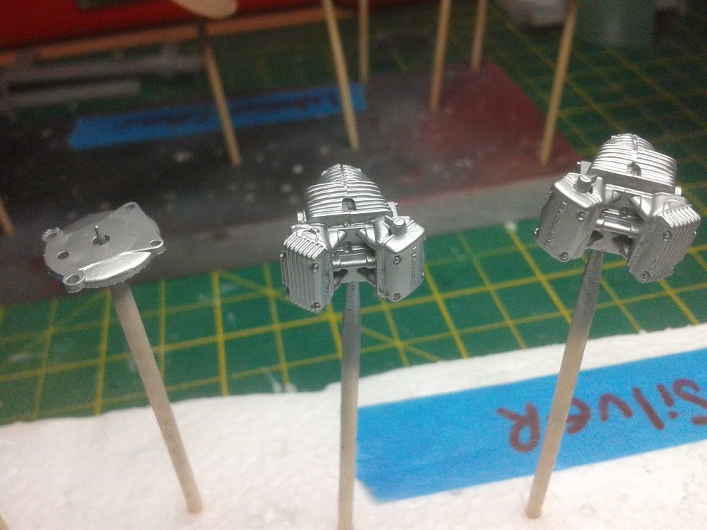

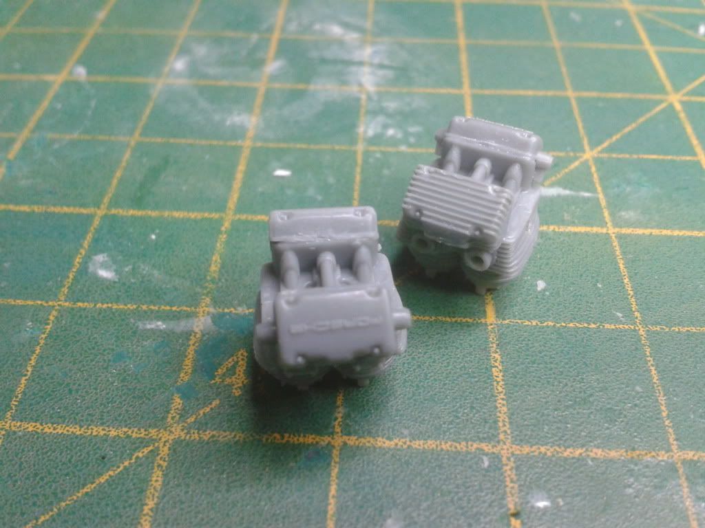

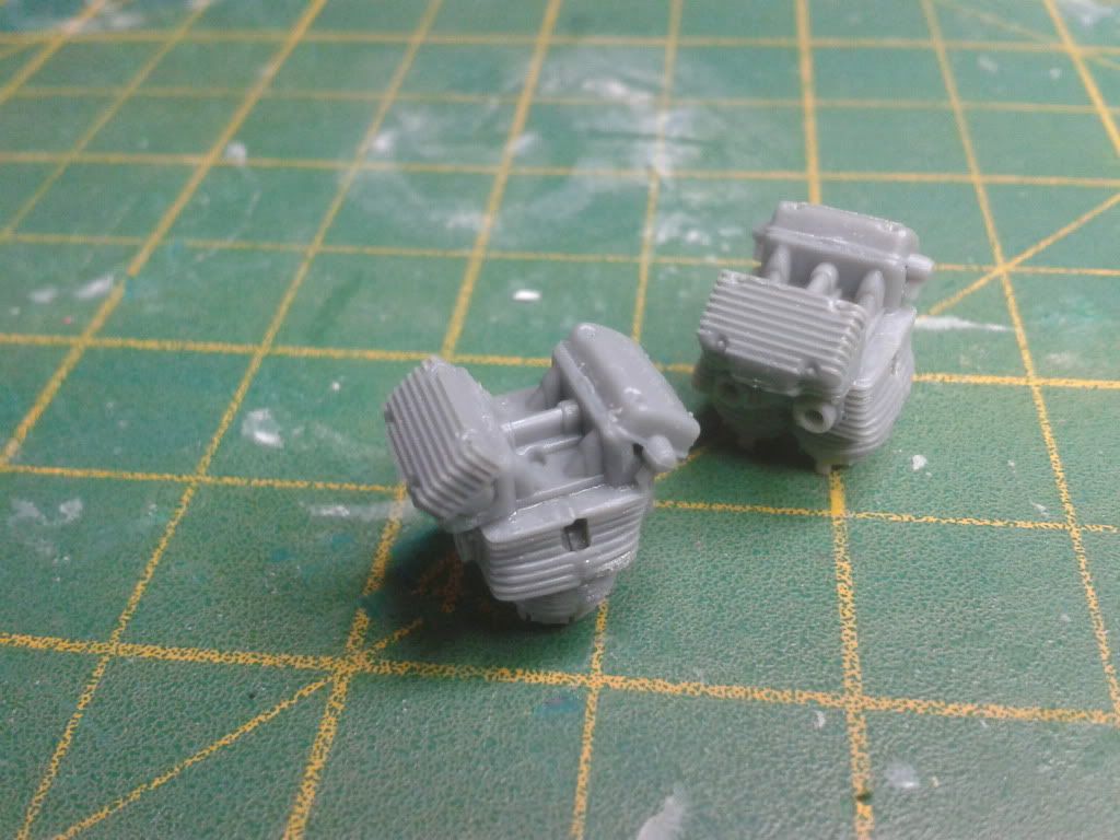

Got a bit more done today, this is the first model I have built that comes with a crankshaft and piston to be fitted, the parts will be airbrsuhed in different shades of gloss black, silver and steel before they are all fitted together

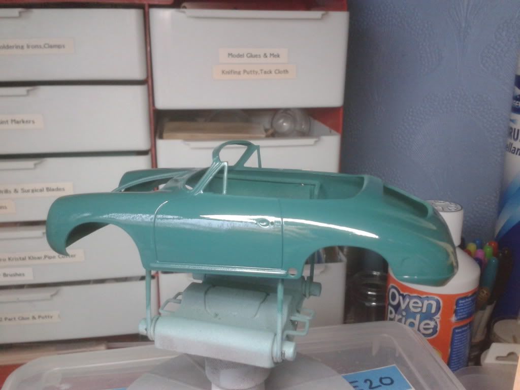

Got the body, engine cover and luggage compartment in primer, and chassis in gloss black and quite a few of the smaller bit painted in alclad aluminium,

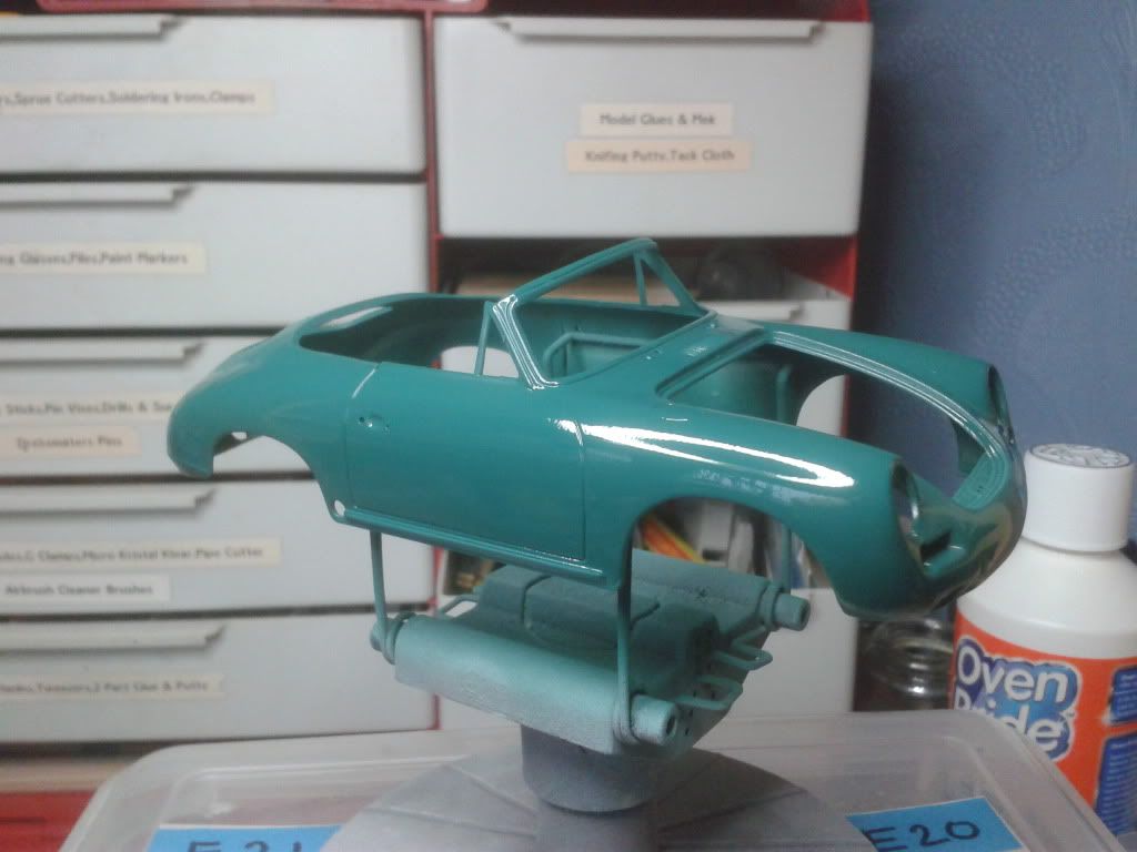

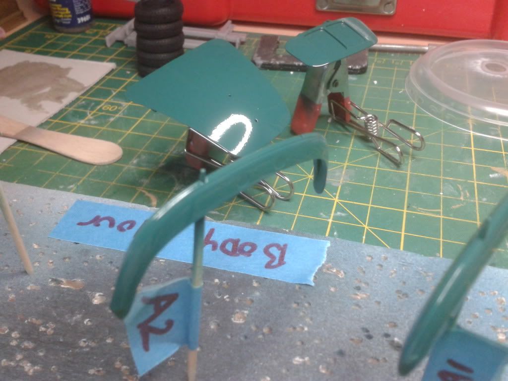

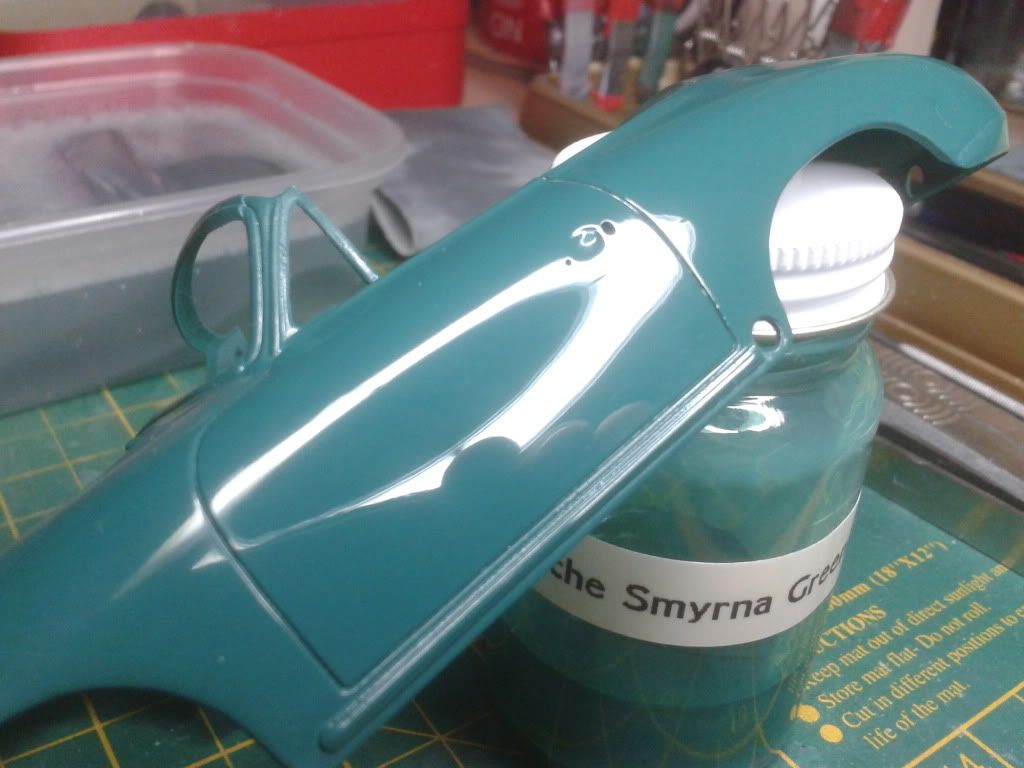

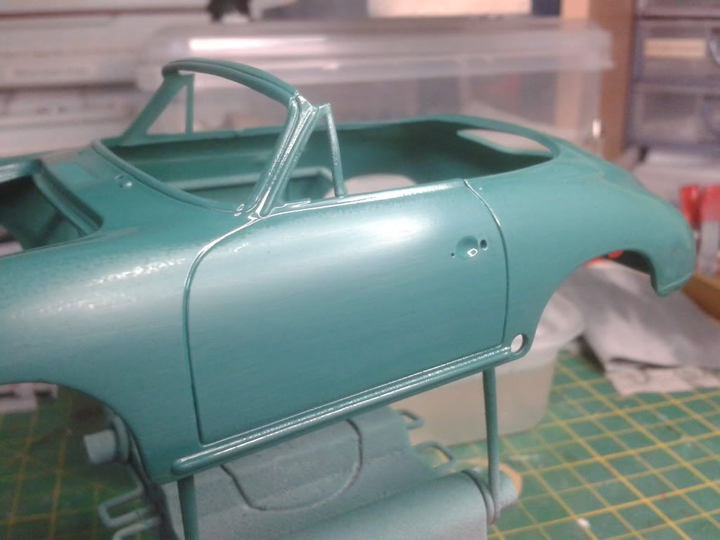

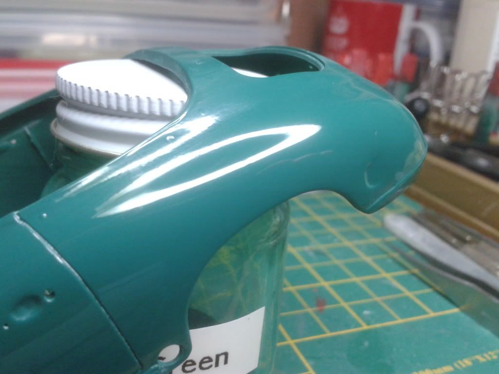

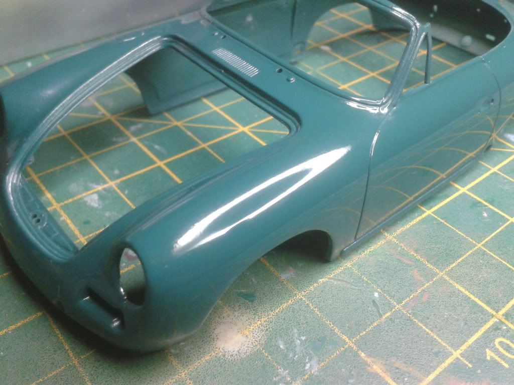

The paint for the body arrived this morning, so it was straight in the hobby room for me, usually when I paint my bodies, I use my Paasche H airbrush, but I have had the VL-S in my toolbox for a few years now and never got round to using it, however I had heard that I would get a better finish on my bodies using the VL, and they were not wrong, using the #3 needle set up the paint went on a lot smoother, and doesn't need too much wet sanding.
Body being wet sanded
Edited by GeeBee

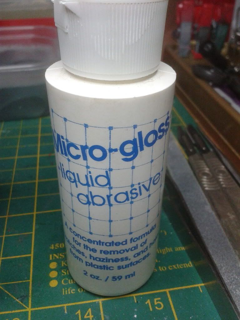

After wet sanding with 3600, 4000 and 6000 grade wet & dry, the polishing started with Micro Gloss liquid abrasive, it will now been polished using various auto polishes
Beautiful paint Geoff! You're doing a MUCH better job of building and painting this than I attempted years ago with this kit!
The paint turned out real nice this time, I really should have used my Paasche VL-S ages ago ....
