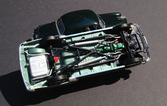

During the website shotdown I took the suggestion to finish my project. I am showing my near finished 1950 fastback resin I got from Tom Coolidge at Promolite.
I reshaped the back window and the taper of the trunk. I added the Ertl front bumper and grille, added material to the front edge of the hood and peaked both front fenders all in keeping with my 1 to 1 car.
The car is #11 Alder Green right from my local paint store. I painted this car 3 times before I got it right. (had to buy a cheap air brush kit).
The white wall tires I got directly from Revell as I told them they we not in the kit as described on box. They had white paper rings that would not conform to the tire. I took material off the back of the small hubcaps and cut off the lower headlight buckets and fitted them into the fender like the real car.

I did the interior dark and light gray with a darker gray floor and foiled the door trim and handles. This shot isn't too good but I'll try to take some more. On my top view of both cars on the original post you can see the steering wheel etc.
