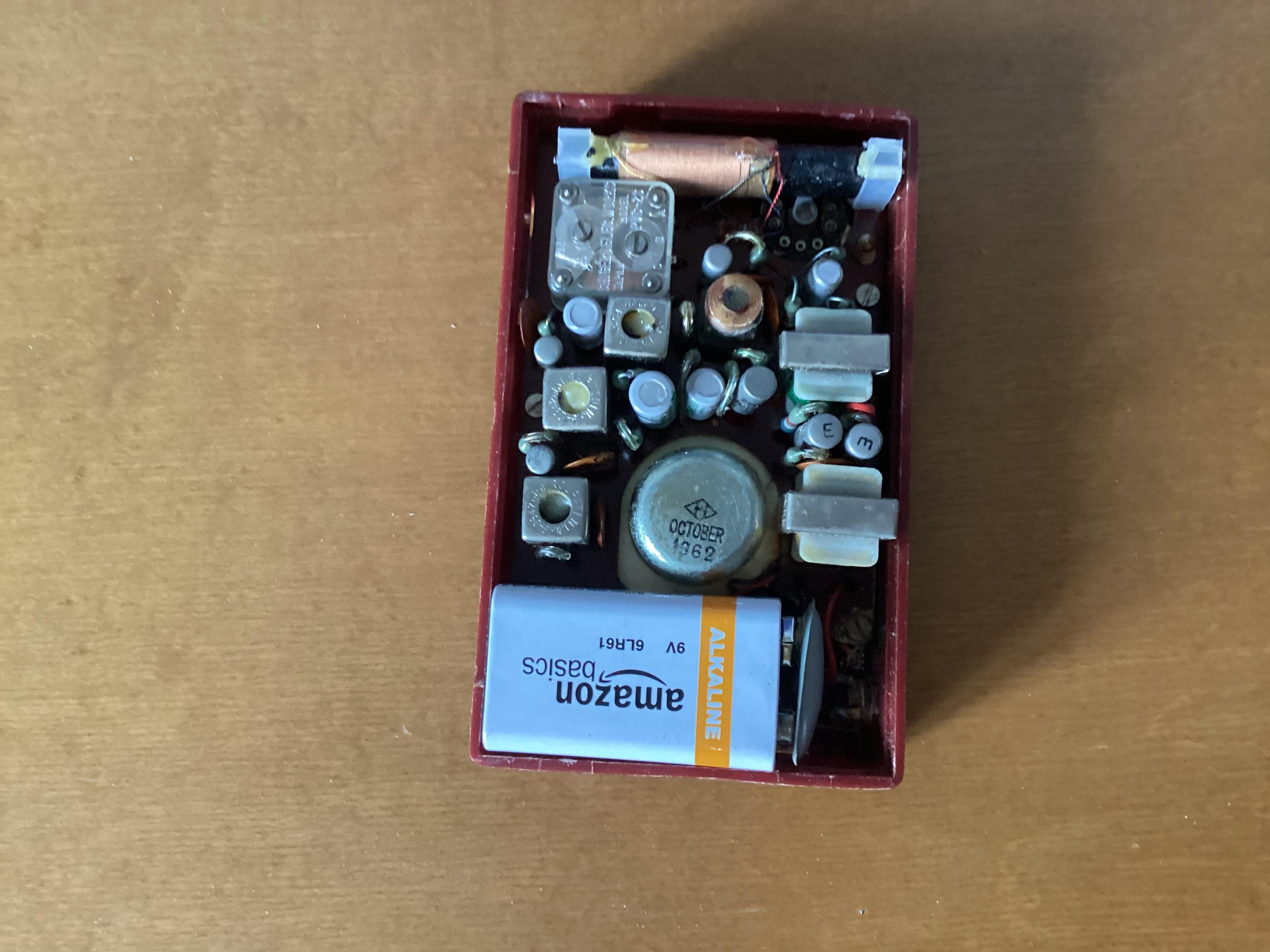

peteski Posted 17 hours ago Posted 17 hours ago On 5/10/2025 at 9:07 AM, Falcon Ranchero said: It is a transistor; this is the inside of it Going by the date on the speaker, that thing is older than I am.  I assume you cleaned the battery contacts. The variable capacitor used for tuning is the large transparent cube in the upper left corner. Since there aren't any contacts in those, they shouldn't need cleaning, but you might want to quickly spin the tuning knob fast few times from one end of the dial to the other . The on/off and volume control potentiometer is the black circular item with three rivets located in the upper right side under the ferrite antenna. That might need a spritz of tuner cleaner. With a new battery does the speaker make any sound (like crackling) when you quickly change the volume from min to max? The electrolytic capacitors could have dried up, but I would have expected this to happen gradually, not suddenly. Those are the cylinders with heat-shrink sleeve over them. I guess one of the transistors could have died. Those are the cylindrical metal components with no heat-shrink. rest of the components (ceramic disc caps, inductors, transformers) are pretty much bullet-proof but I guess maybe there might be a cold solder joint somewhere. If you have an old-fashion TV/radio electronic repair shop or a Ham operators club nearby, they might be able to look at it and maybe fix it, but electronic repair shops and skilled techs familiar with old technology are getting rare. 1
Falcon Ranchero Posted 17 hours ago Posted 17 hours ago 7 minutes ago, peteski said: Â With a new battery does the speaker make any sound (like crackling) when you quickly change the volume from min to max? Thanks for all the pointers; I do have yet to clean the battery contacts, though when I did put in the new battery, and squeezed it against the contacts while turning the volume, I did get louder crackling. Though I will attempt to clean and service all those parts you mentioned. If it still doesn't work after that, I know my dad says he knows some guy who is like a whiz with this sort of thing, so I may be able to have it fixed. But it's wierd the problem happend just suddenly, as it was working perfectly.
peteski Posted 16 hours ago Posted 16 hours ago 37 minutes ago, Falcon Ranchero said: Thanks for all the pointers; I do have yet to clean the battery contacts, though when I did put in the new battery, and squeezed it against the contacts while turning the volume, I did get louder crackling. Though I will attempt to clean and service all those parts you mentioned. If it still doesn't work after that, I know my dad says he knows some guy who is like a whiz with this sort of thing, so I may be able to have it fixed. But it's wierd the problem happend just suddenly, as it was working perfectly. Good luck with it. Old electronic gadgets are fun! 1
