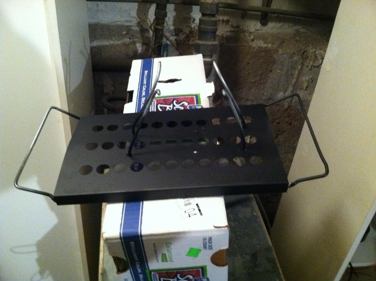

FASTBACK340 Posted January 8, 2014 Posted January 8, 2014 This is the lid from a factory-shipped air bag container. They are shipped as explosives and must be inside a metal container. I take the lids and find other uses for them. Here I grabbed two lengths of steel rod I found in the scrap and bent them into "U"'s. I bent the tips outward and MIG welded them inside the lid. I then bent handles and welded them on either end. Now I have a new paint stand. 1

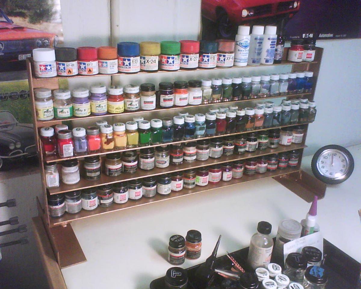

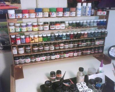

fat50 Posted November 10, 2014 Posted November 10, 2014 This doesn't fall under tool, but it has made life easier. Instead of picking through a drawer, looking at only the tops of the jars, never grabbing the right one the first time. I cut apart an old bed frame, fired up the MIG welder and now have a nice paint rack at $0 cost. I've since made 2 more for holding brushes, files, glues, solvents, etc....
