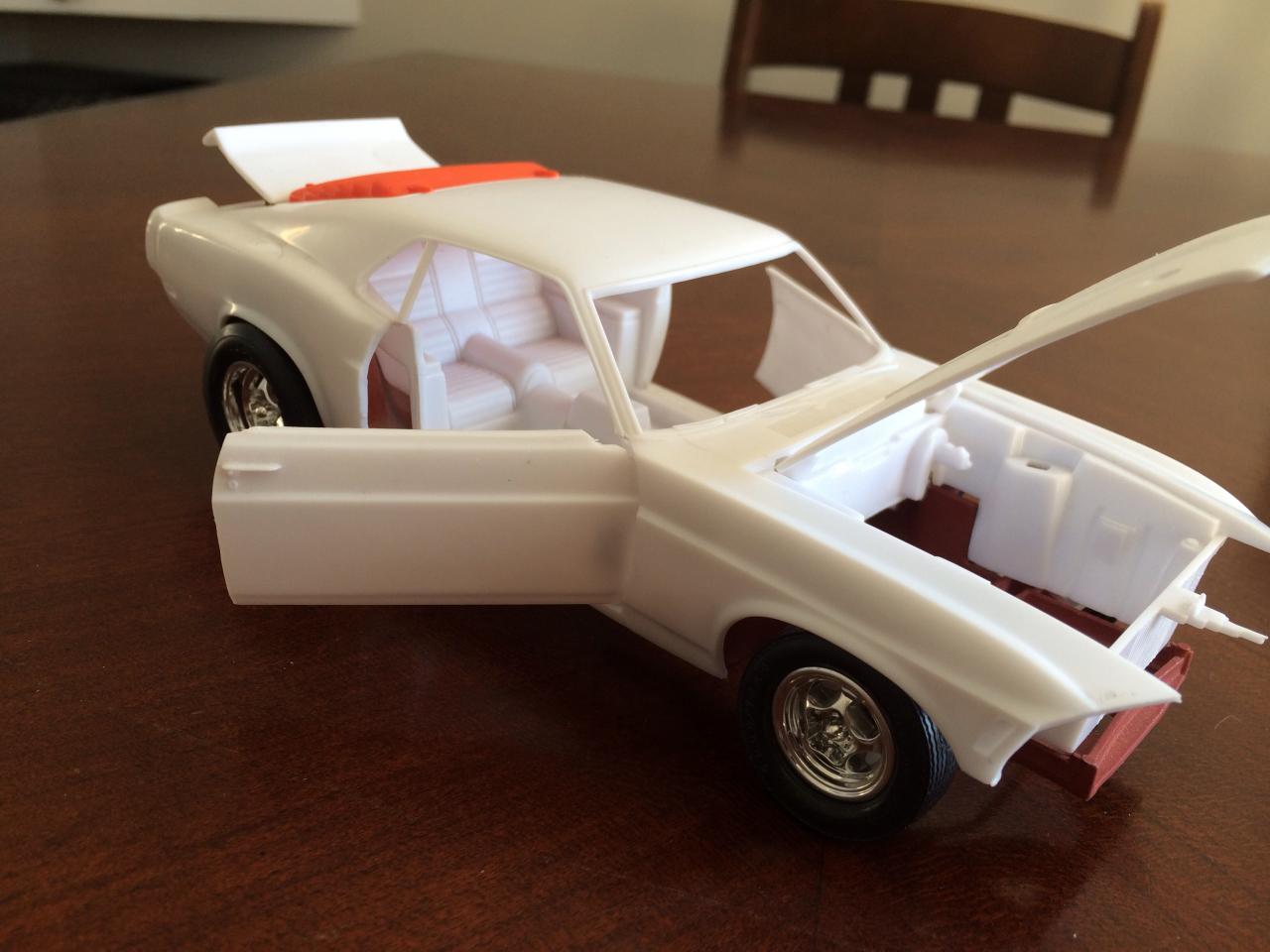

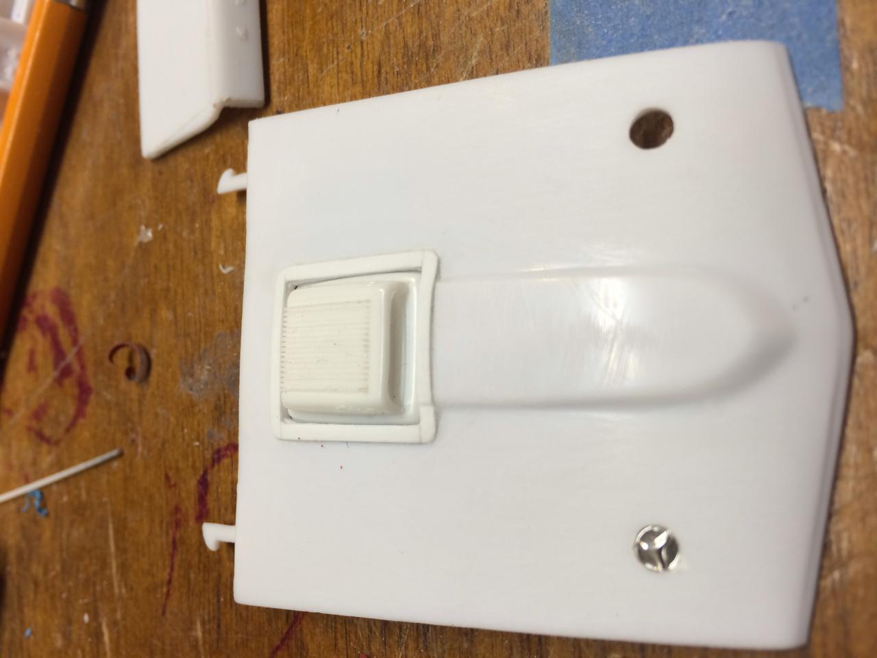

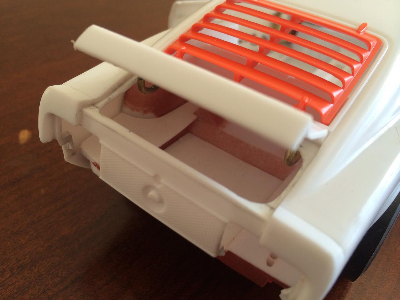

Hey guys. I have decided to build a mustang since I have not done one in a while. It's a replica of one of the 96 twister specials built. They were all grabber orange with black interior. They were all supposed to be 428 cobra jets but only 48 were. This one is one of the 428 4 speed super cobra jet cars. I opened the doors and trunk. All cars had shaker hoods so I started with a flat boss 302 hood and made one along with the twist locks. I also modified the rear valence for the rectangular tips these hadpost-8987-0-20327900-1392682825_thumb.jppost-8987-0-25091500-1392682856_thumb.jppost-8987-0-16943700-1392682897_thumb.jp
Edited by freakshow12
Real nice start Fred, looking forward to this. I've toyed with the idea of doing a Twister as well, someday. Where are you sourcing the 428 from?
I am taking the 428 from the 69 cj kit. It's a tad small but once it is detailed out I won't look too bad. I could have went the easy route and just done a shaker on the Cleveland as the other 48 cars had that. I like to do things the hard way. Like the lawman that will be coming soon...

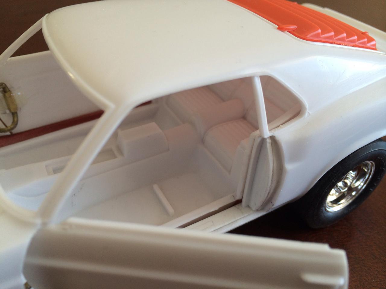

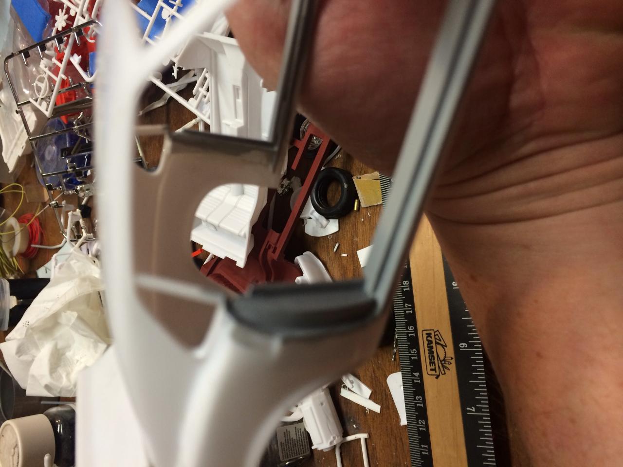

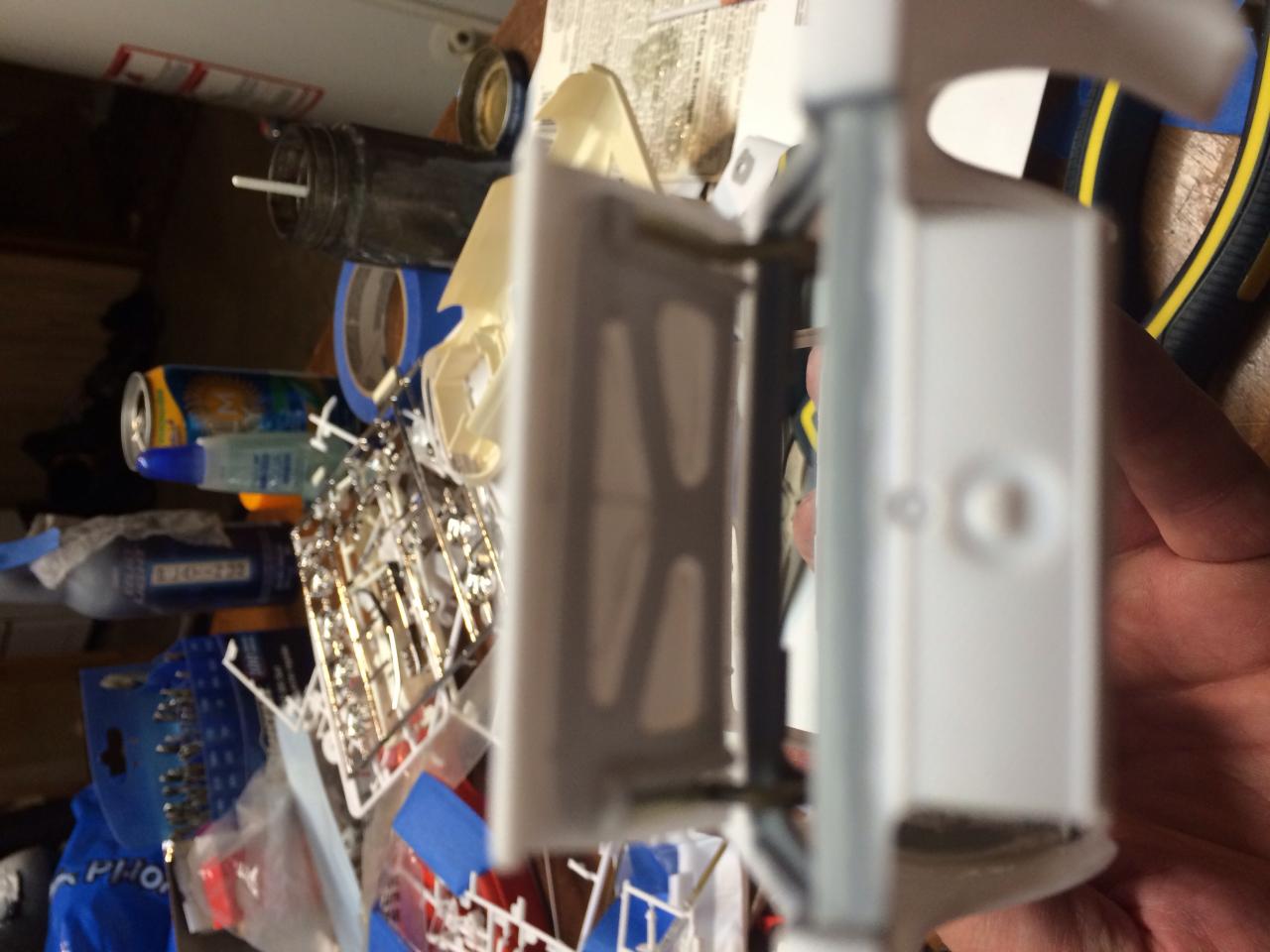

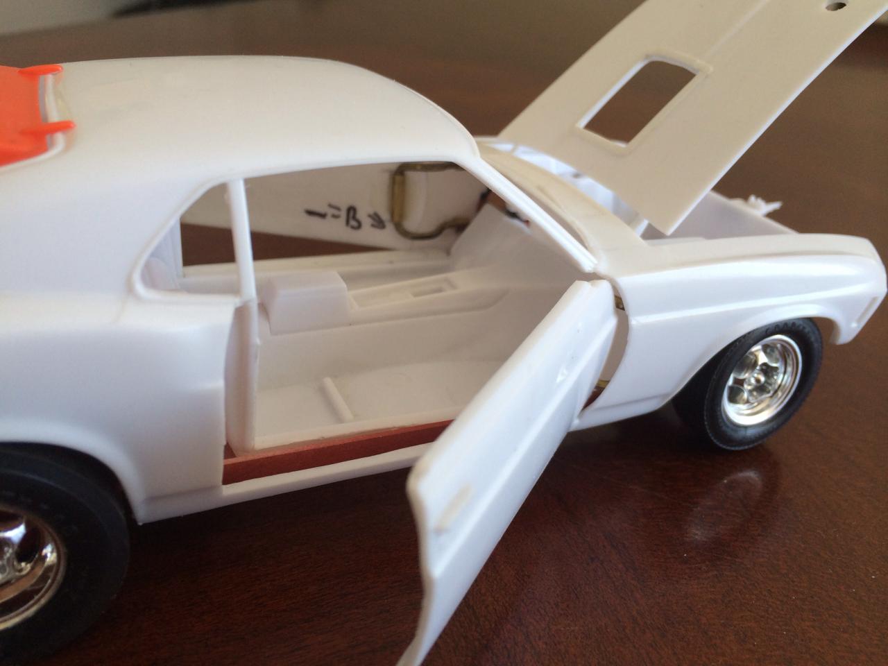

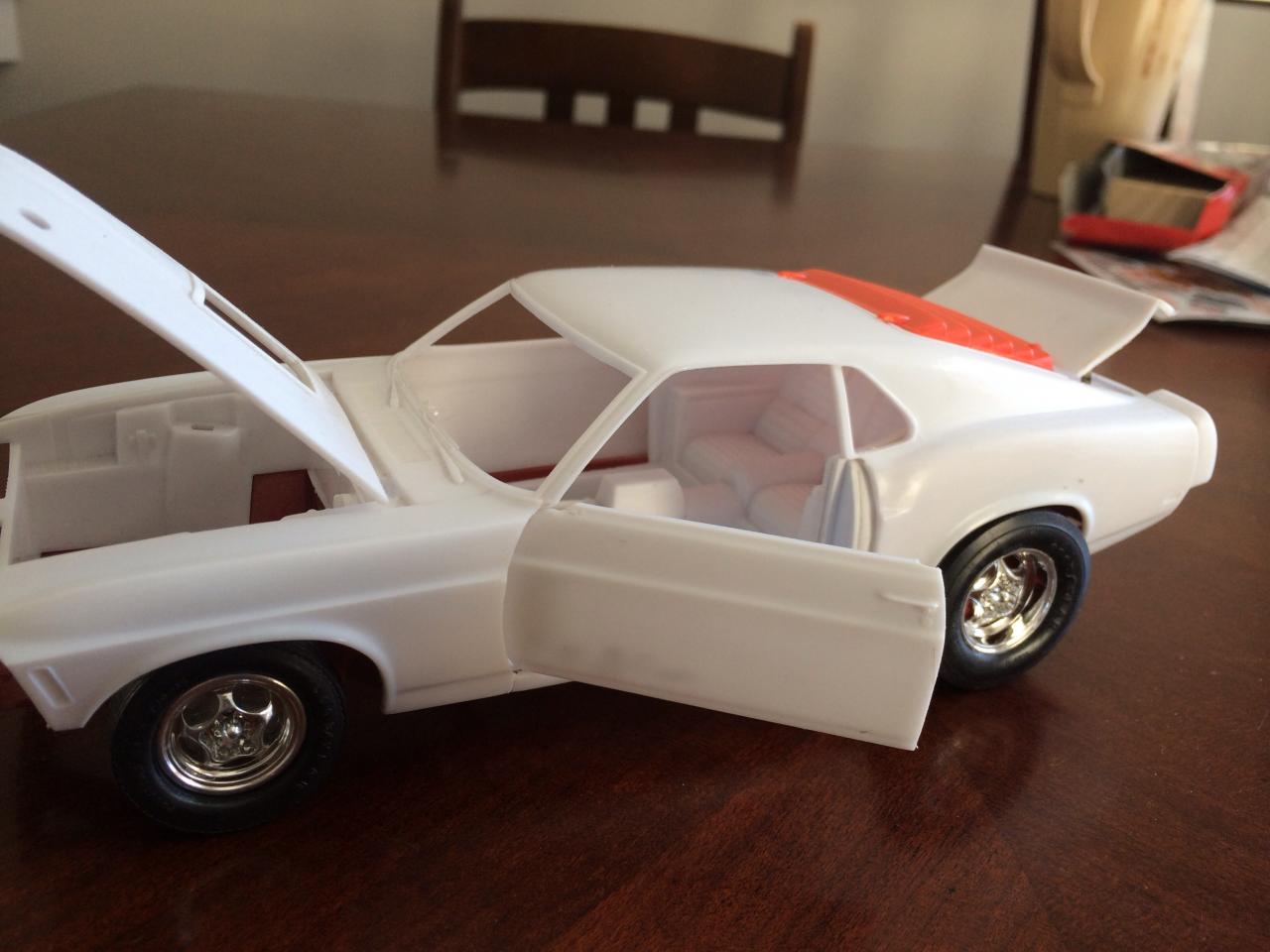

Got a bit more done. Everything opens! Don't mind the wheel and tire combo. That's for a lawman project but were handy! One door jamb coming along. Comments good or bad welcomepost-8987-0-36940700-1393709191_thumb.jppost-8987-0-89380600-1393709284_thumb.jppost-8987-0-05320600-1393709333_thumb.jppost-8987-0-02590900-1393709370_thumb.jppost-8987-0-57997300-1393709408_thumb.jp
Lookin good so far. Thank you for hinging the doors correctly. So many people swing them straight out instead of the leading edge dipping into the body, which makes them look goofy and more diecast/toy like. Yours is done right and will be tougher to tell the difference from the real deal. Watching this one with earnest.

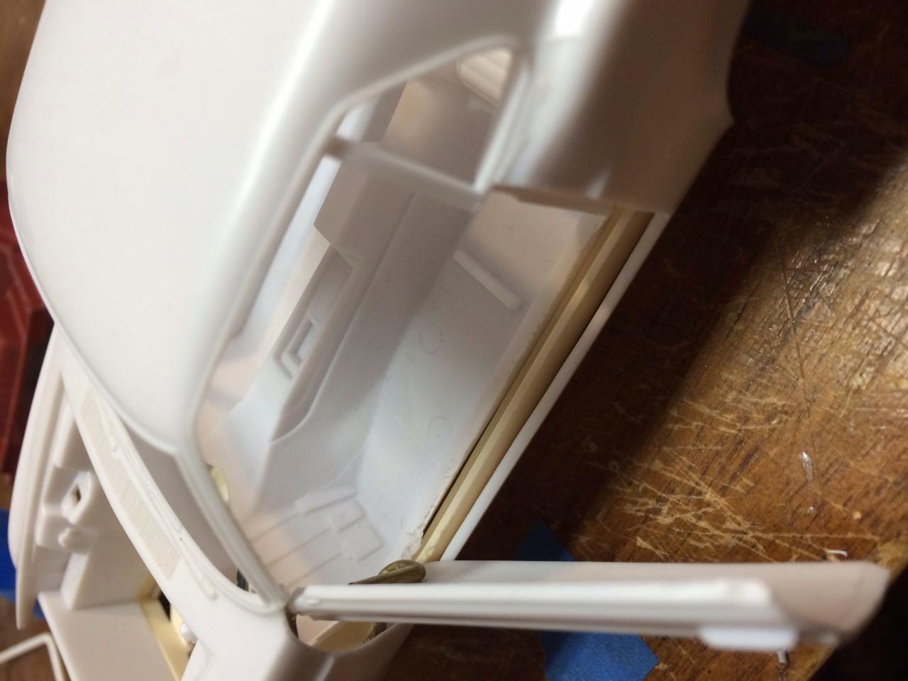

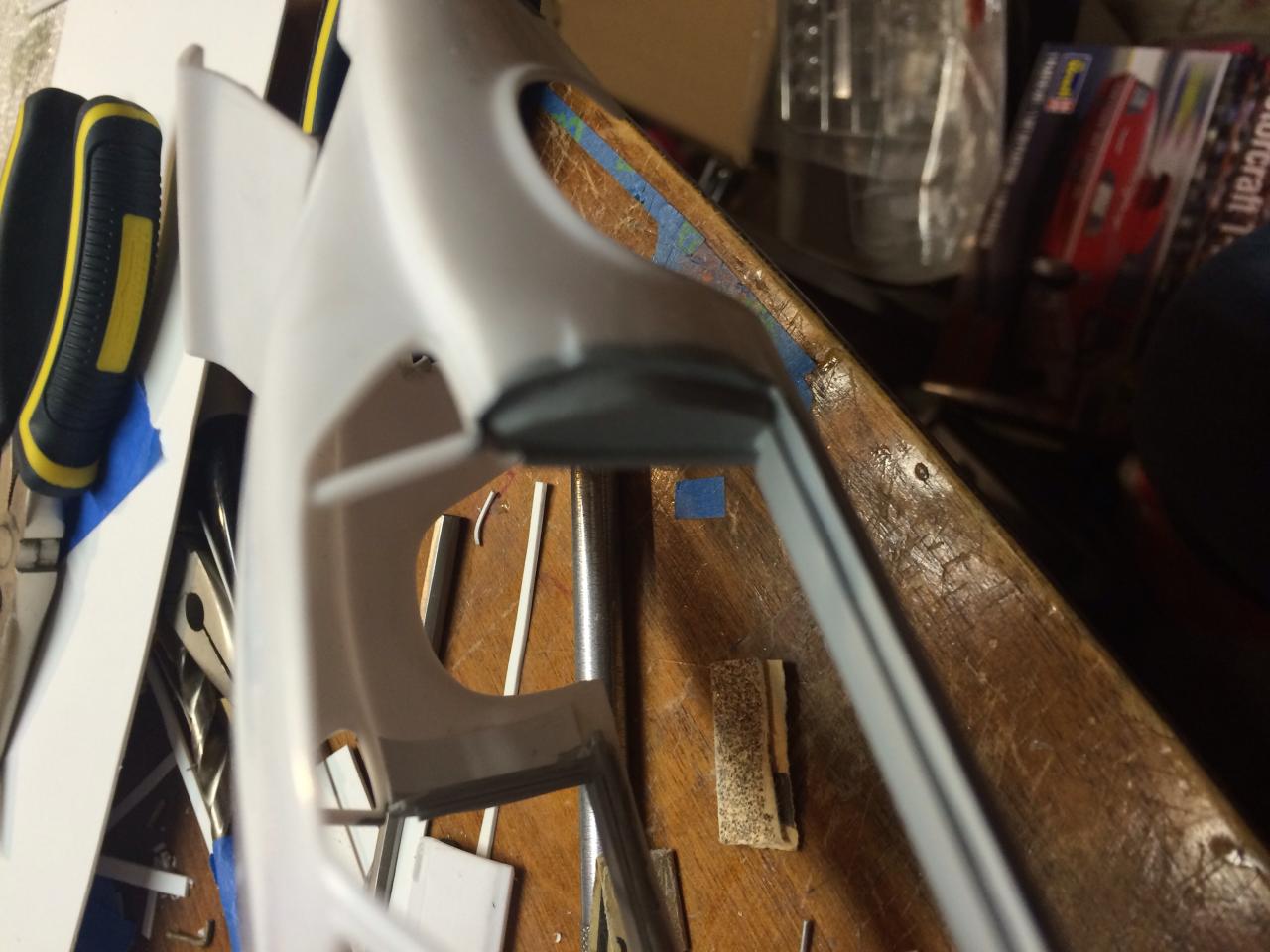

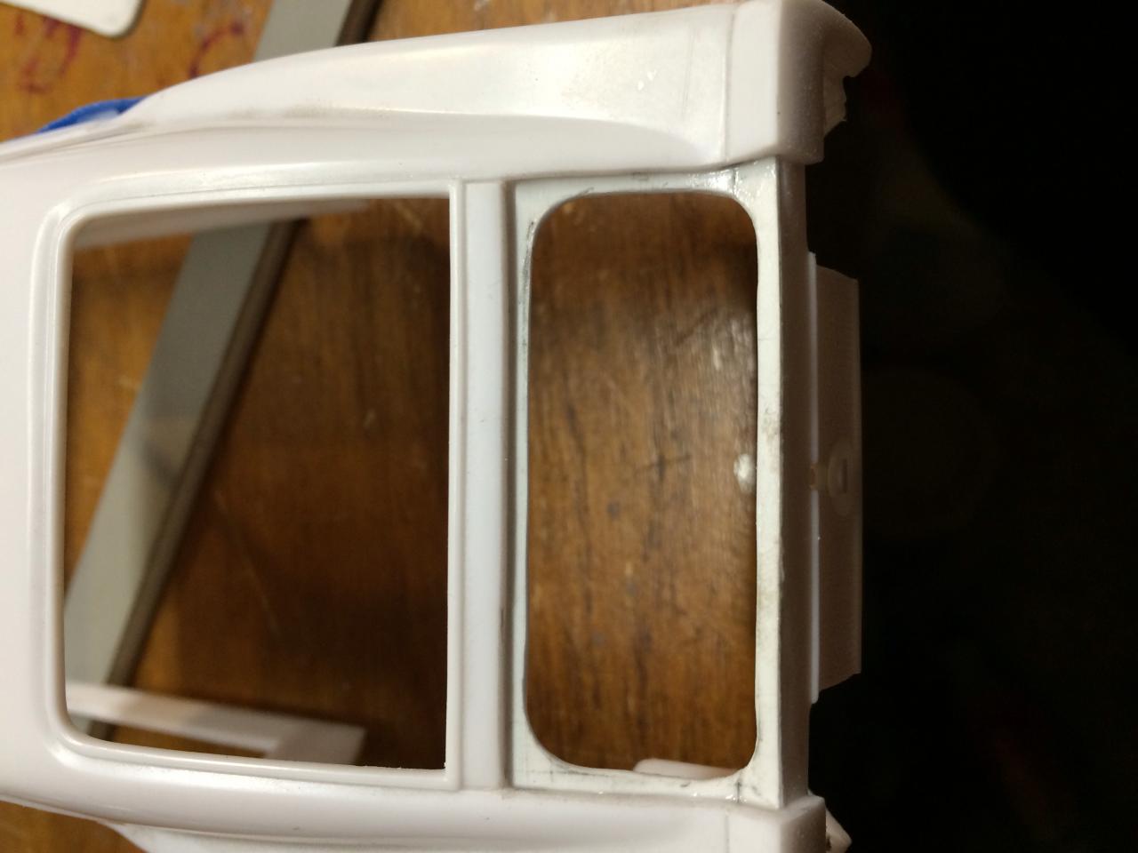

Managed to get a little more in on this. Jambs all match up to interior now. Couple little things to do on them. I got some primer on them and they look ok to me. Trunk underside details are in at this point as wellpost-8987-0-26852500-1394979577_thumb.jppost-8987-0-25811000-1394979597_thumb.jppost-8987-0-48203800-1394979623_thumb.jp
