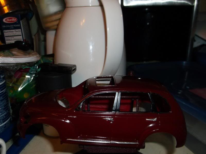

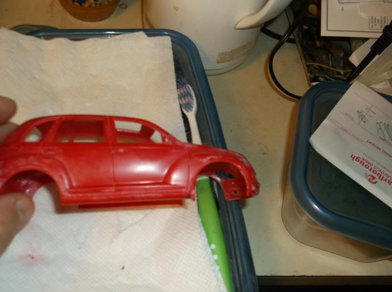

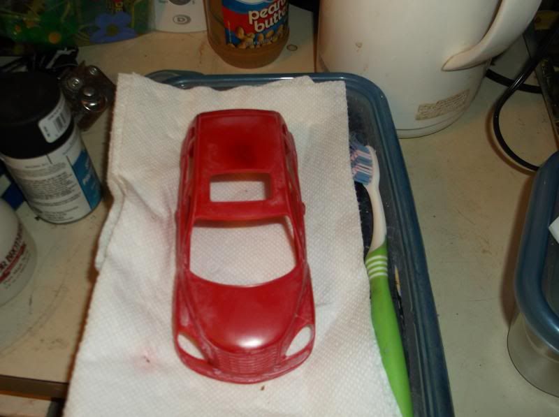

Today has been very slow-motion. Things like that happen, I suppose.
This is the body, post-strip and wash-down. There's a little bit of paint that's being stubborn. Hopefully, it won't cause problems when I apply color again; this is almost mandating primer now. I think, for the safety of this really horrid, cheap plastic, I'm going to blow the dough and get the Model Master lacquer primer and paint, because I don't want this getting buggered on me.
The areas where a lot of the bubbles that occurred are still paint bubbles, but they're coming off with my fingernail. I suppose that's a good thing. The big spot on the top, though, doesn't seem to want to budge much, so I'll leave it rather than risk more problems.
As it's supposed to rain, I'll be painting in the basement with the door open to vent.

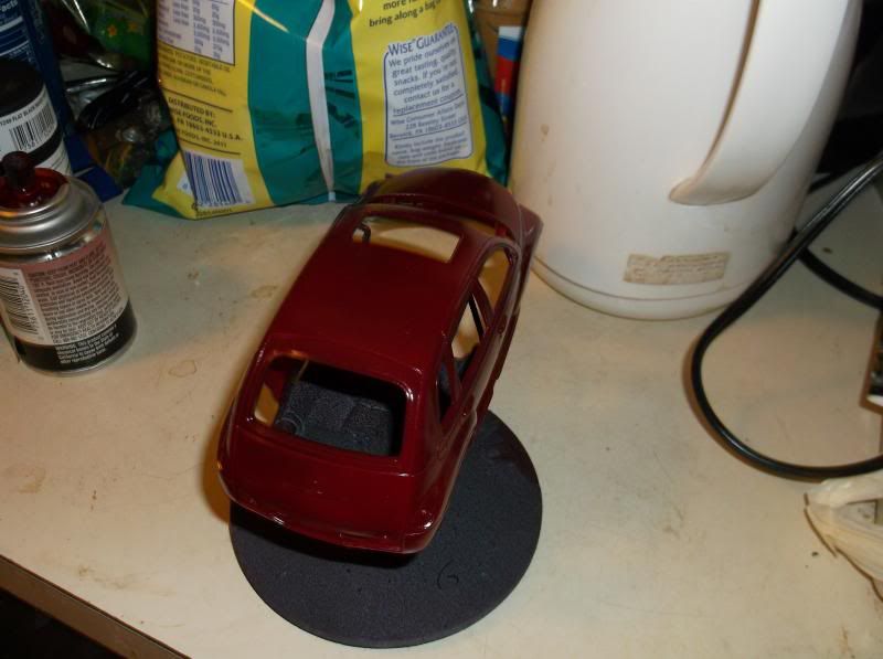

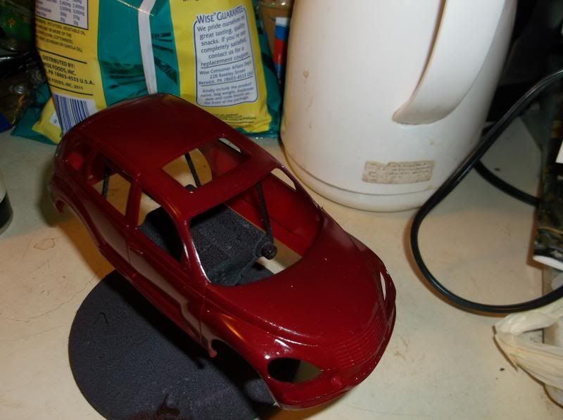

Well...as the post title suggests, we now have paint.
It'll probably need one more light coat, followed by a polishing, but we're definitely in the money now.
I ended up going with Tamiya TS-11 Maroon, as experience has shown Tamiya spray lacquer does work well on plastic directly and it's almost idiot-proofed.
I now bring you the results....

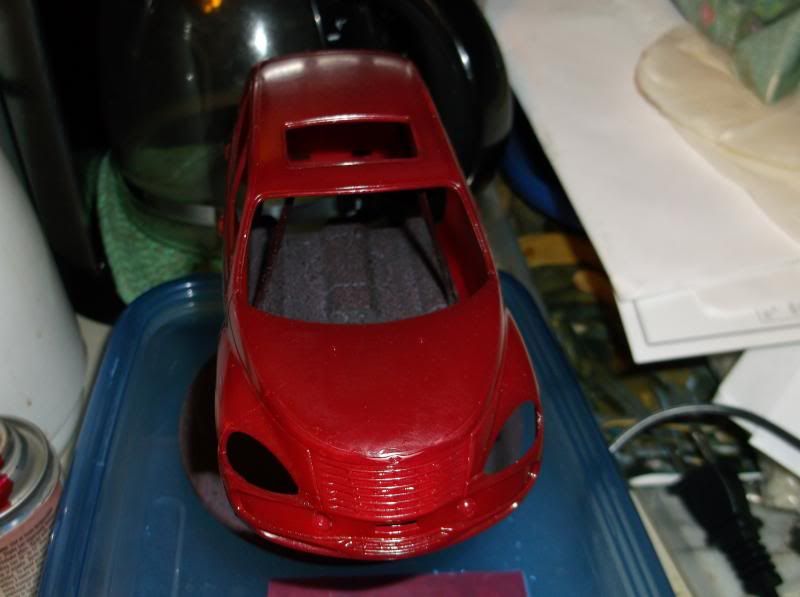

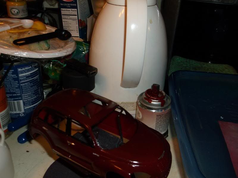

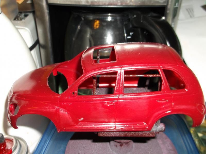

I just hit the paint. I must say, Tamiya spray lacquer polishes out nicely, even with 600-grit paper. There was enough schmutz in the paint (dust and such) that I needed to start out a bit more aggressively. As also suspected, I will need 1-2 more coats of paint. This paint is incredibly thin. Quite impressed.
After the next coat or two dries, mostly to cover a couple of spots I missed due to tuck-under and to provide a little extra depth, final polish, a probable clear coat for a little extra depth and then assembly.
It's raining here, although painting in the basement shouldn't create too much trouble.
Post-polish pictures below.

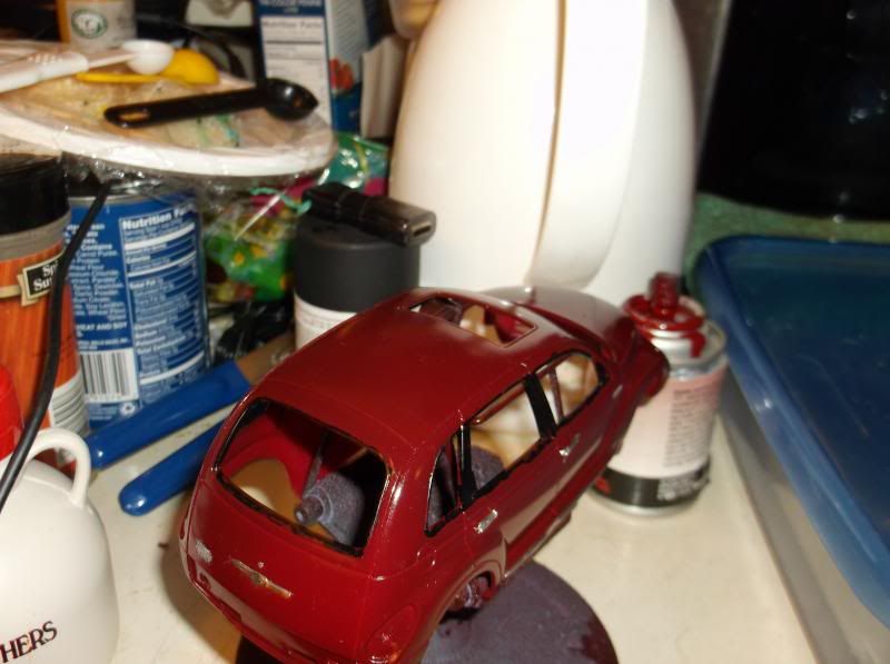

Charlie that is looking great. You're a brave man to spray a lacquer paint on bare plastic without a primer/sealer.
I know a couple of people who have done this with the Tamiya lacquers, because they're not "lacquer" a'la DuPont, PPG, et al, but some sort of weird synthetic lacquer. I don't know what it is, but they stink to high heaven- enough so that I wear my paint mask with them, otherwise I feel like I'm turning green.
I wouldn't have believed it either if I hadn't seen the models myself. So far, I'm not at all disappointed,
Coats three and four just went on, with four being a light mist coat. The paint is now drying. A final sand and clear tonight, followed by some detail painting and foiling, then assembly. Worst case, I might do final assembly and decals when I get to Jersey, but I think it'll all be done before I hit the road Friday morning.

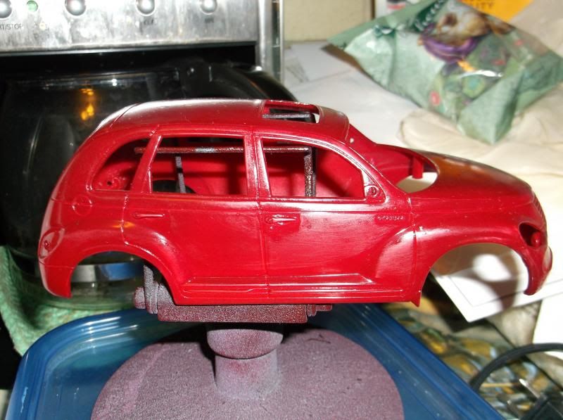

I now see why they generally recommend a fresh blade for BMF.

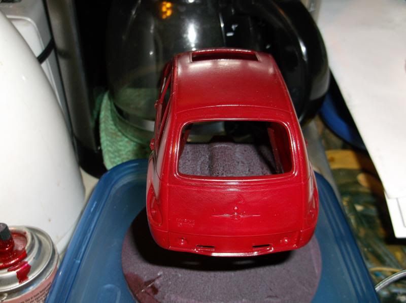

The good news is the small amount of foil the PT needs is done. The paint looks really good. Although It doesn't absolutely need a clear-coat, I'm probably going to shoot one on it anyway because I think I ended up with one of BMF's periodic "not quite" envelopes. Not a huge deal.
This first picture does a pretty good job of showing the true color.
Here are a couple of more.
