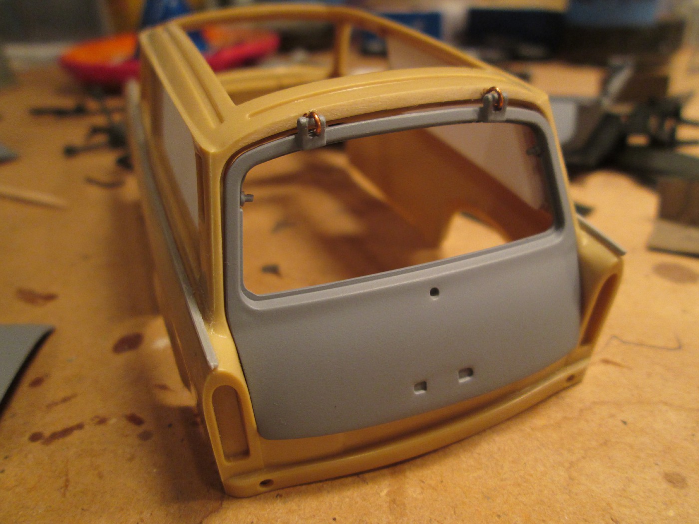

The other issue I had was the fit of the rear hatch. The kit gives you two sets of the gas struts, one extended to position the hatch up and one short to position the hatch closed. My kit had the two hinge pieces broken at the top of the body, so I made new ones from brass. The roof isn't glued on, that's why it appears high in the photo. As I'm doing the van, I am not using the rear seat and made myself a deck from ribbed Evergreen sheet, the same sheet I used in my Caravan CV build.

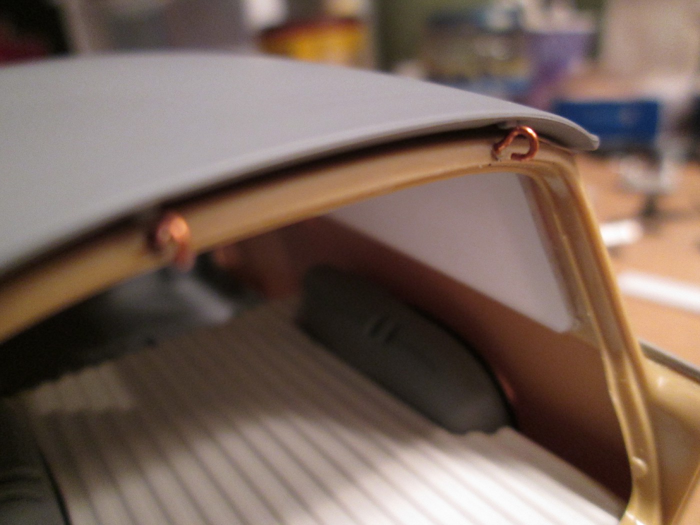

Here's the hinge up close. They are model ship building supplies. I bought a pack of these tiny brass eyelets that are used for sailing ship rigging. The hinge on the hatch fits in here fine, when I do my final assembly I'll squeeze these in a bit around the plastic hatch hinges to keep them in place.
One last shot of the hinge for Erik since he was curious as to how I was going to work out this problem.

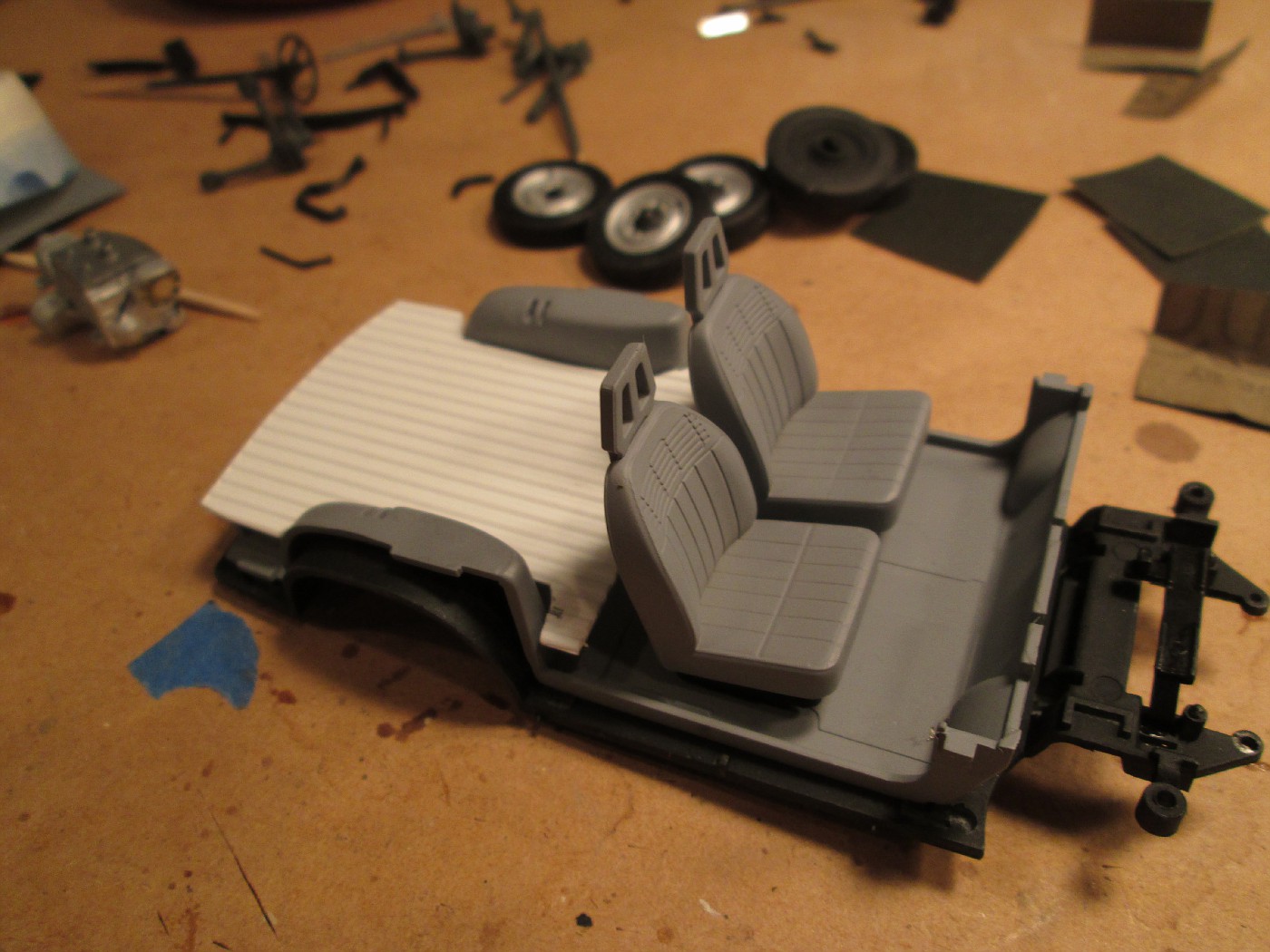

Here's the interior, a platform that sits nicely on the chassis. The factory bucket seats are very nicely done and sit on separate bases. Again you can see my van floor. The van interior gets the spare tire standing up against the left side close to the hatch.
