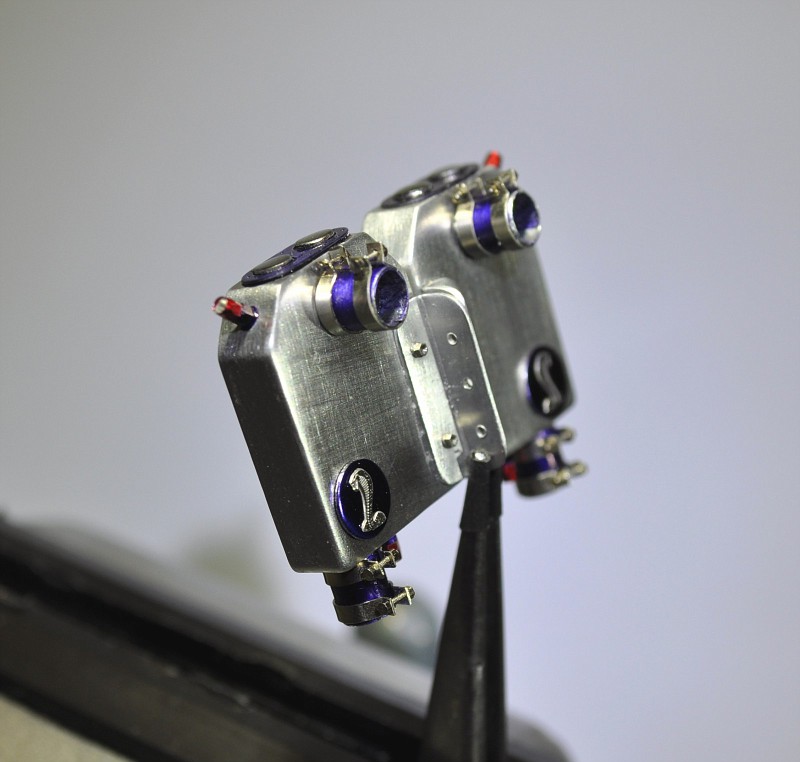

Codi Posted August 23, 2014 Author Posted August 23, 2014 Thanks Stan I'm glad you like it. Here are some pics of the inlet pop-off valve (each vane was punched out, drilled and glued onto a stainless steel tube...the hex looking base is an RB motion Hex fitting that I was able to craft into the base) The twin dry ice intercoolers are made from solid alum. stock with various PE fittings, alum. tube, RB A/N fittings and the scratchbuilt clamps again. The clamps are secured using the .5mm nuts/bolts. I had to slice the tubing that slips over the inlet pipes ever so slightly to be able to slip them on. The bottom tube of each inter takes the air from the turbo and the top pipe goes to the top of the intake plenum.
