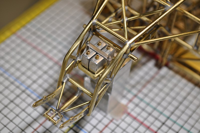

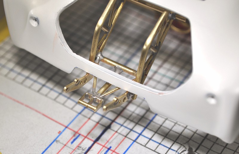

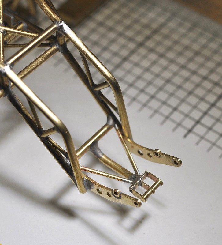

Codi Posted June 26, 2015 Author Posted June 26, 2015 Michael & Dave, thank you very much for the sentiments and interest in the car. Today I got the chute bracket and braces done. Sure enough I got all of it made and on the car and the last joint (even with umpteen gazillion heatsinks attached....this thing looked like a porcupine) the dual chute bracket on the very end came off........these spaces are tiny.....but I got it back on and all straight and pretty. I'm slowly creeping up on getting the back half done. Next I'll clean up the ugly joints and add a few more braces and bars that are required. Then it'll be mock-up time again but this time with all hte bells and whistles I've made to see the whole picture. Comments welcome as always. Cheers, Tim
bobthehobbyguy Posted June 26, 2015 Posted June 26, 2015 Beautiful work. What is your process for cleaning up the solder joints? Most of your joints look pretty good you don't seem to end up with a lot of excess.
Jeepxj Posted June 27, 2015 Posted June 27, 2015 Wow what a wild car so far.Incredible detailing,to say the least.Great job.
Petetrucker07 Posted June 27, 2015 Posted June 27, 2015 (edited) Looks great man. Your attention to detail is out of control, in good way. I don't know if you've answered this before or not. But, how do you clean up the joints? I'm trying to gather some info so I can prepare for the build off road truck build I have in mind. Edited June 27, 2015 by Petetrucker07
Codi Posted June 27, 2015 Author Posted June 27, 2015 Thank you fellas. Bob & Clayton, on page 27 of this thread I covered joint clean-up to some degree. I think it might be of some help but if you have more specific questions, please let me know. Cheers, Tim
10thumbs Posted June 27, 2015 Posted June 27, 2015 Tim, those are some finicky areas you've soldered there, good work. Question; is this a setup for dual chutes? Are you making the chutes scratch? As always it's fun having a look at the progress. Michael
Codi Posted June 27, 2015 Author Posted June 27, 2015 Hey Michael, Dave (comp1839) pointed out twin chutes are mandatory for any car over 200mph......so.........dual it is. I'll be making them from scratch, the cording I have is from after market model rocket chutes that I picked up cheap. I'll use medical tape for the outside material of the chutes. I made one up already and it looks very realistic. But I'm not quite ready to share pics yet. Cheers

Cesar Bossolani Posted July 4, 2015 Posted July 4, 2015 Impressive work! How do you cut tubes so perfect? Thanks!

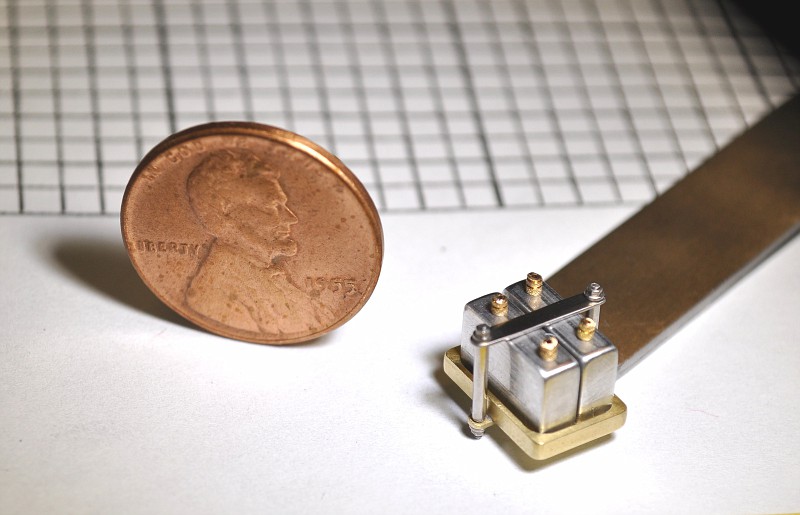

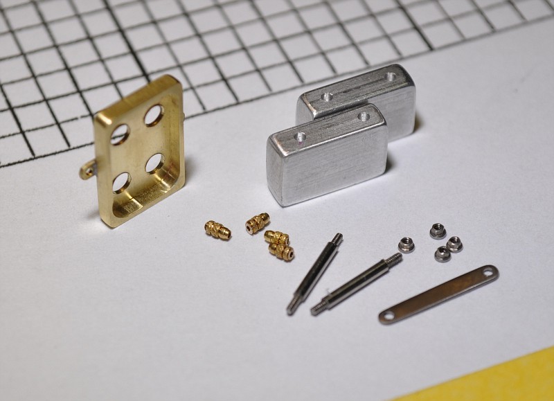

Codi Posted July 7, 2015 Author Posted July 7, 2015 Hey Jeremy it's good to hear from you and that you're still following along. Tell your dad I said "hi"... The Braille batteries and tray are done. The batteries are made of aluminum, the posts are s/steel, the tray I machined from brass and the top strap is titanium ( I drilled it with 3 small "lightening" holes after I took these pics) . The terminals are brass knurled electrical connectors, bolts and threaded rod are from T2M. Just decals and wiring to complete them. Cheers, Tim A pic of the real deal.
Mooneyzs Posted July 7, 2015 Posted July 7, 2015 Tim... Those batteries are unbelievable. Very Impressive. You continue to raise that bar with every update. Looks like the real deal. Job well done Sir!!
gasser59 Posted July 8, 2015 Posted July 8, 2015 Are you flipping kidding me?!? Those batteries and tray are a show stopper. What are the plans for the decals? Do you have them already done up?
