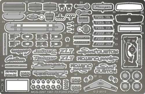

mk11 Posted June 26, 2016 Posted June 26, 2016 (edited) Danny is a good man and makes great products.does anyone make a good dana 70 and the badges for f250 or f350 in 24th,25th scales?........Chris Model Car Garage has the F100/250/350 badges on their photoetch sheet... mike Edited June 26, 2016 by mk11

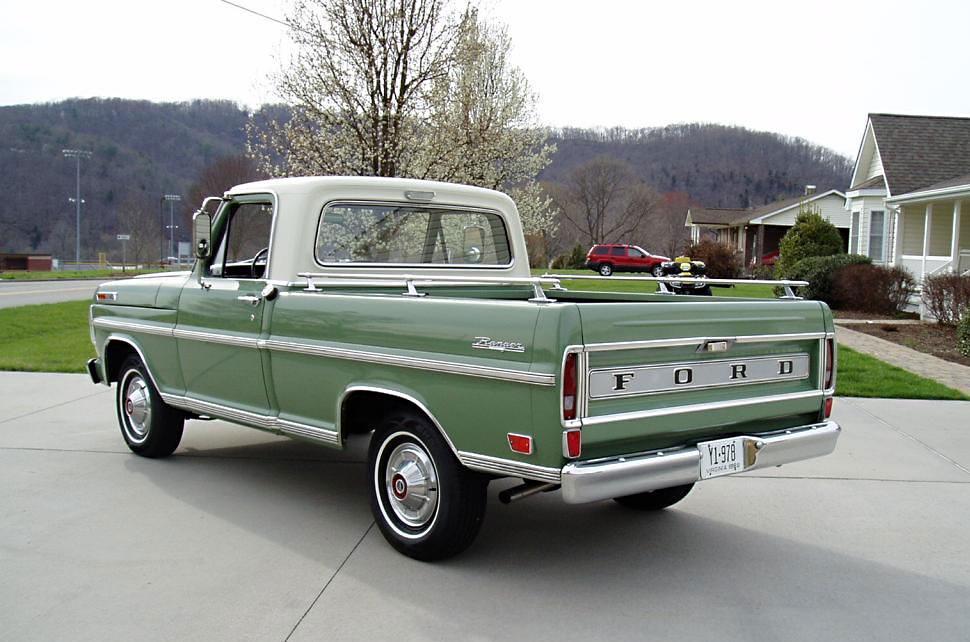

Travis T Posted June 28, 2016 Posted June 28, 2016 The 72 should have the same steering wheel as the 71. It is also a little annoying the box art shows the trim correct (there is a piece behind the rear wheels) but the box truck and the kit are missing this piece. Oh well, I guess it gives me an excuse to start minor resin casting. I needed a long bed 72 anyway so I guess I will buy another 71.

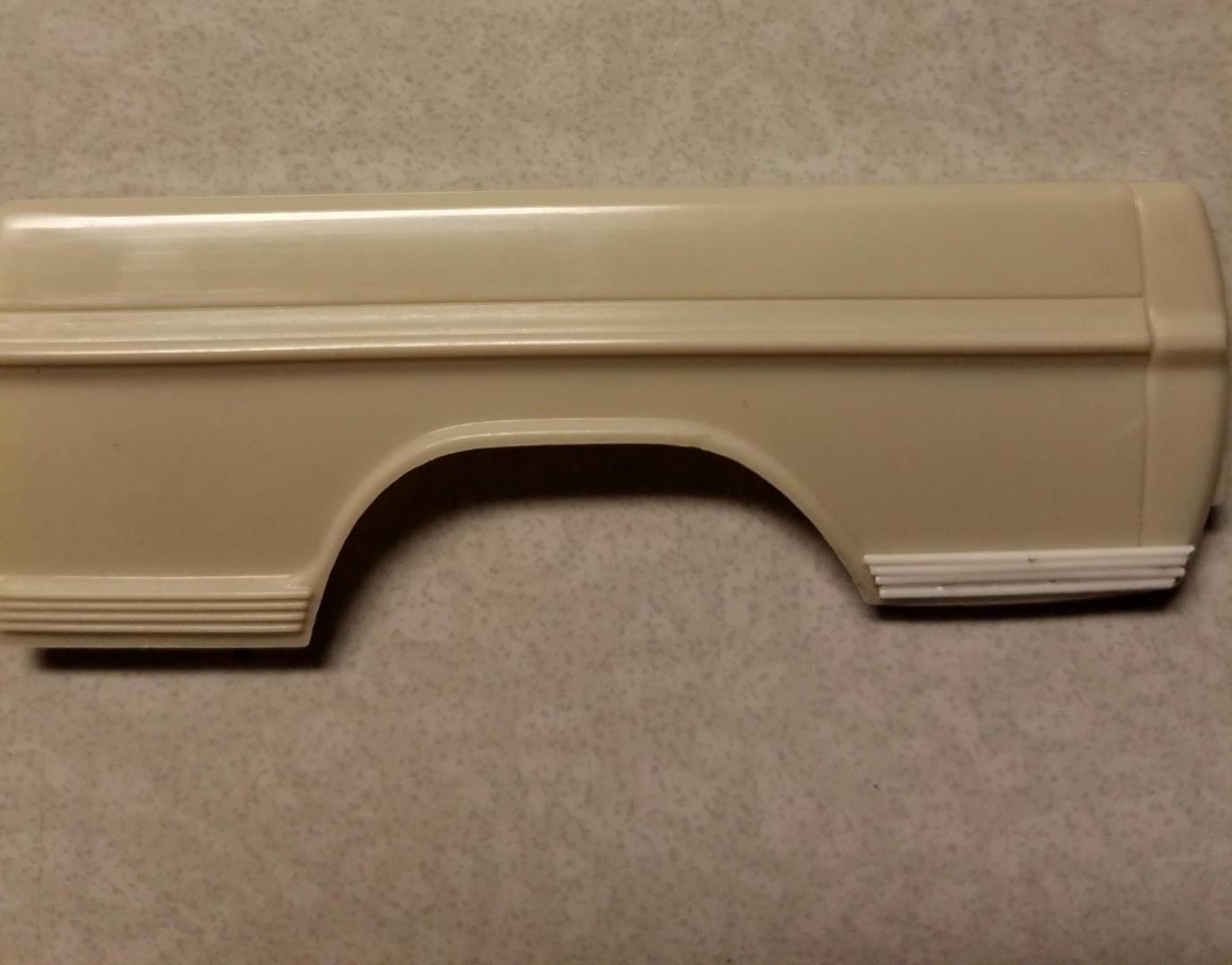

bob b Posted June 29, 2016 Posted June 29, 2016 The 72 should have the same steering wheel as the 71. It is also a little annoying the box art shows the trim correct (there is a piece behind the rear wheels) but the box truck and the kit are missing this piece. Oh well, I guess it gives me an excuse to start minor resin casting. I needed a long bed 72 anyway so I guess I will buy another 71.Has anyone tried to scratch build the trim that should be behind the rear wheels? I've been looking at it maybe a sheet of styrene, then scoring it? Just not sure if there is anything thin enough...I'm going to try a couple things... if it looks half decent I'll post pics..

bob b Posted June 30, 2016 Posted June 30, 2016 Might be an option to fix the rear if you want to keep the trim and have it correct..... a quick mockup using white glue and .020 round (the round looks better than the square IMO) I need to spend more time with it but i figure it is close... maybe some better cut
bob b Posted June 30, 2016 Posted June 30, 2016 Cut myself off..... but with some better cutting, a little more time with the spacing... sanding and filing i think its gonna be very close once painted or foiled

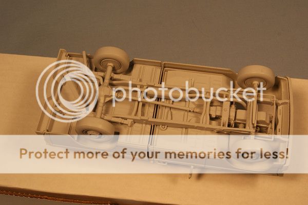

dodgefever Posted June 30, 2016 Posted June 30, 2016 Looks like they have a dana mastered...The chassis and running gear seems to have been mostly derived from the old AMT F350. That would explain why the Moebius test shots had a Dana axle, the front suspension radius arms mounting outboard of the frame rails the same way as the AMT (should be inboard) and the near-identical parts breakdown and patterns of the FE engine and transmission.
