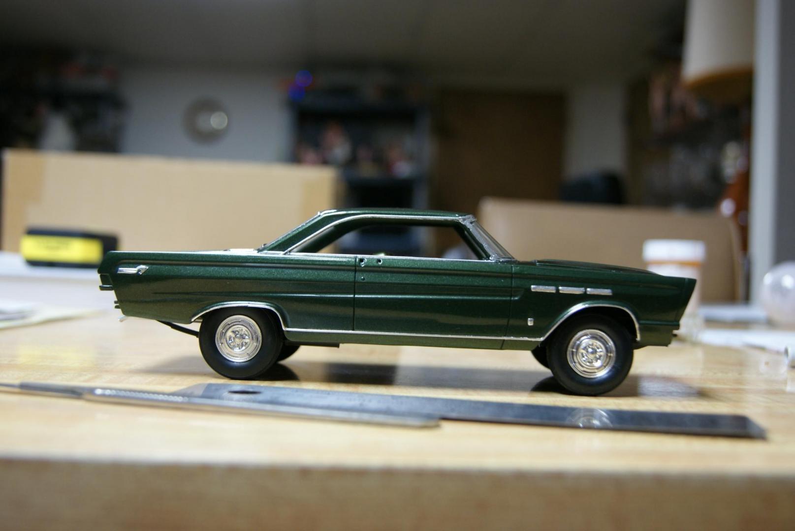

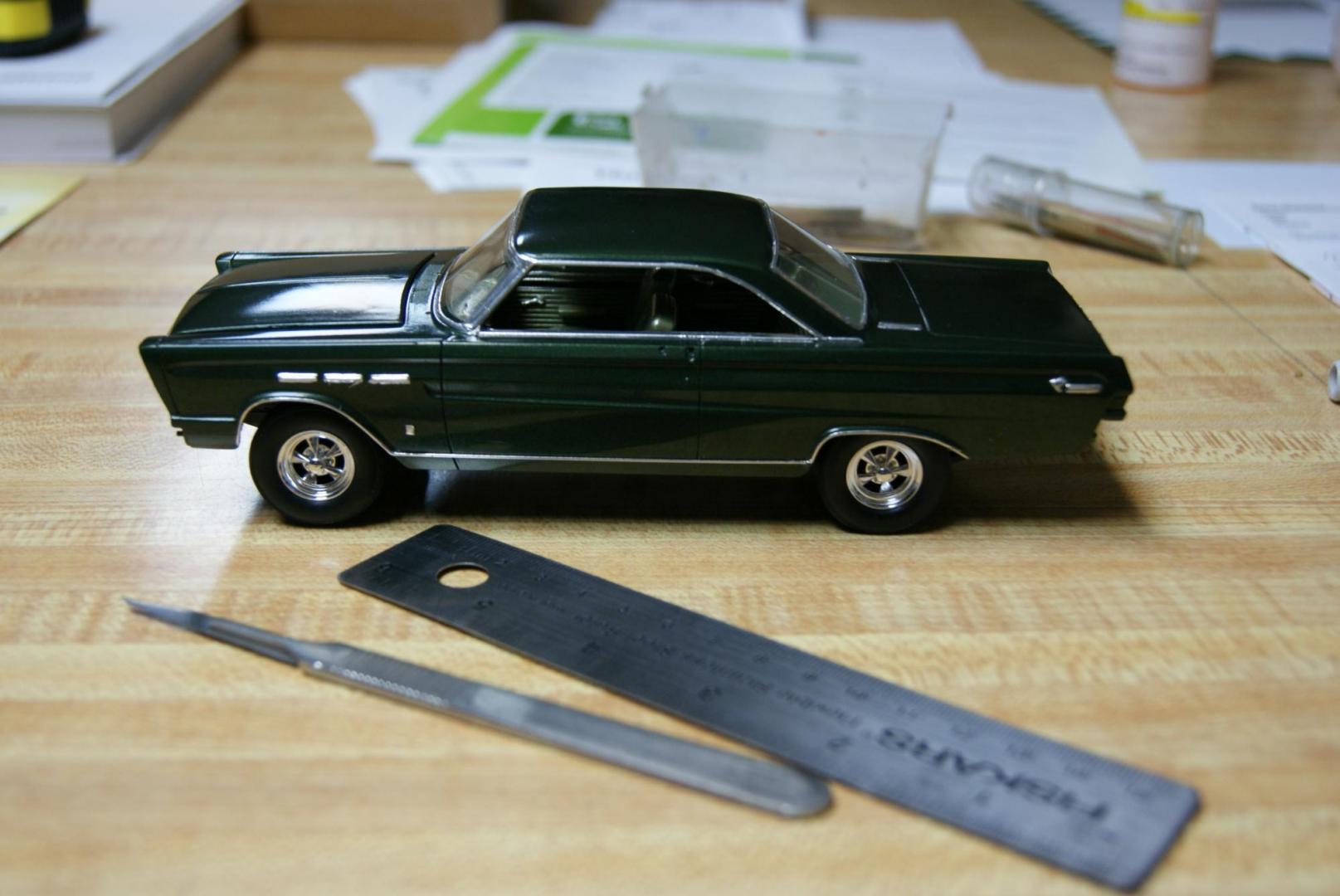

Nova-ss Posted April 18, 2016 Posted April 18, 2016 Yep It's Olive Mist. thanks to Bob's paints for the paint.. I just finished Bare metal foil... plenty of details to foil - but not the worst I've had to do. Some minor fit issues seem to show up when I actually get one all painted and do the final assembly... I'll be sending a few notes and photos to the factory to clean up a couple minor items,,, Kit will have both sets of wheels. Flat hood only on street car... This is a second test shot, when it's done it should work just fine for box side and instruction sheet photos.. Did some digging the other day for engine colors - seems that Cyclone's 289 4V had black block, heads and intake with silver or chrome valve covers and air-cleaner. Caliente 2V motor has yellow valve covers and air-cleaner.. Need to finish the engine, shoot some photos for instruction sheet and get this thing wrapped up Thank you Dave,can't wait to make a couple street cars and factory cars.its looks great and a blast just like the others before it.again thank you and Moebuis for help making scale modeling so fun again.....Chris

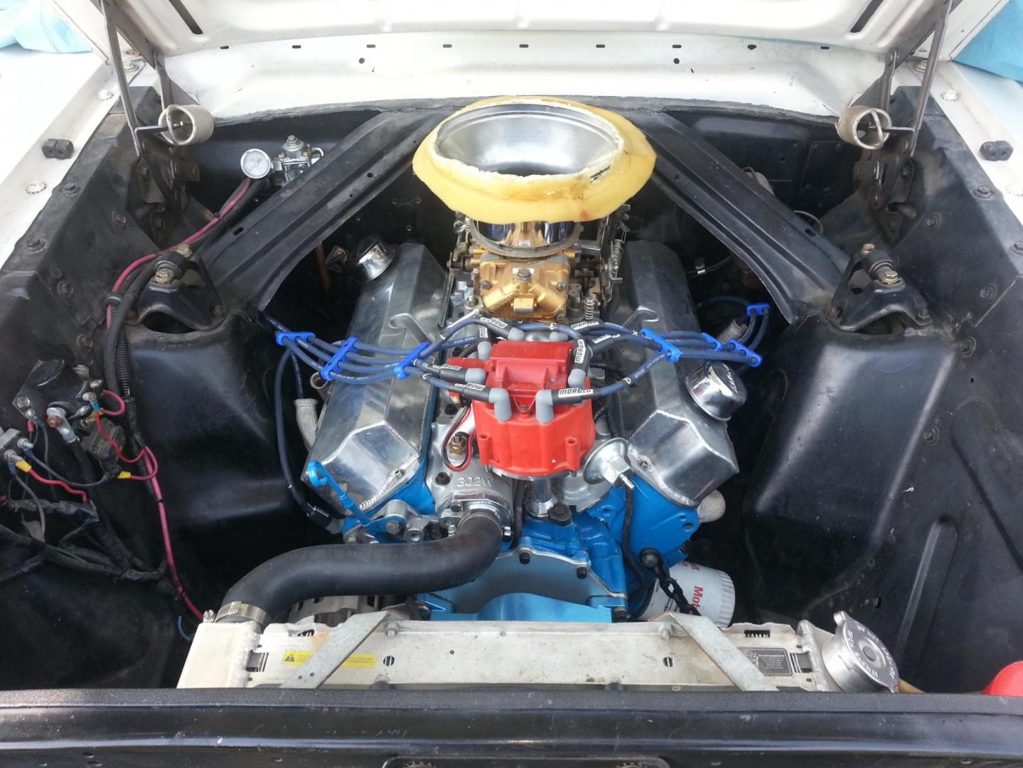

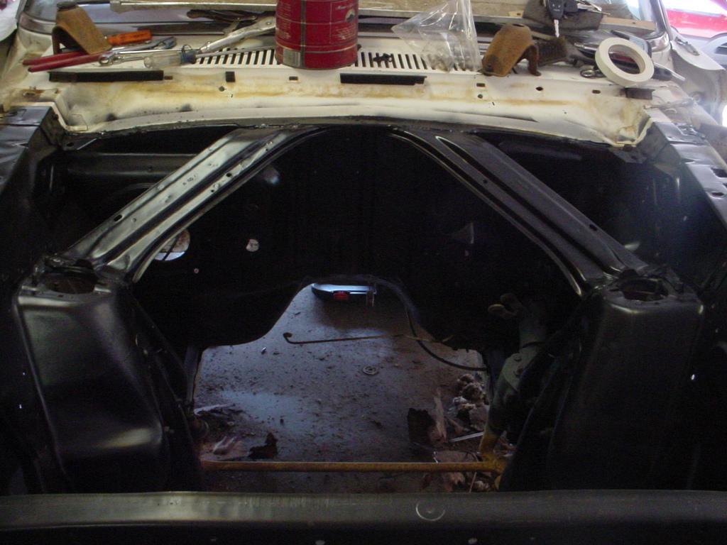

Reeves Racing Posted April 19, 2016 Posted April 19, 2016 (edited) The shock tower braces are a bit off on the model too. On Mustangs they were a bolt on part but on the Comets they were welded in place. Edited April 19, 2016 by Reeves Racing

Maindrian Pace Posted April 20, 2016 Posted April 20, 2016 (edited) The shock tower braces are a bit off on the model too. On Mustangs they were a bolt on part but on the Comets they were welded in place. True, but I didn't mention that because that style export brace was offered for the '64-'65 Falcon and Comet when the cars were new - and you can source reproductions from the parts vendors. Here is one installed above the stock braces, but most owners cut the original braces out to use the new brace. Edited April 20, 2016 by Maindrian Pace

Reeves Racing Posted April 20, 2016 Posted April 20, 2016 True, but I didn't mention that because that style export brace was offered for the '64-'65 Falcon and Comet when the cars were new - and you can source reproductions from the parts vendors. Here is one installed above the stock braces, but most owners cut the original braces out to use the new brace. If the kit is going to have the skinny bolt in brace it should have both brace styles then. A stock "from the factory" car would of had the wider welded braces. As you said most owners cut out the welded ones. The bolt in brace was a rare option that was mostly available to re-brace the towers for the big block 427 cars since that engine wouldn't fit with the welded braces.
'70 Grande Posted April 20, 2016 Posted April 20, 2016 Looks to me that using some of those welded shock tower brace photos already seen in this post, it wouldn't be too hard to scratchbuild the welded brace pieces for a factory stock build.
