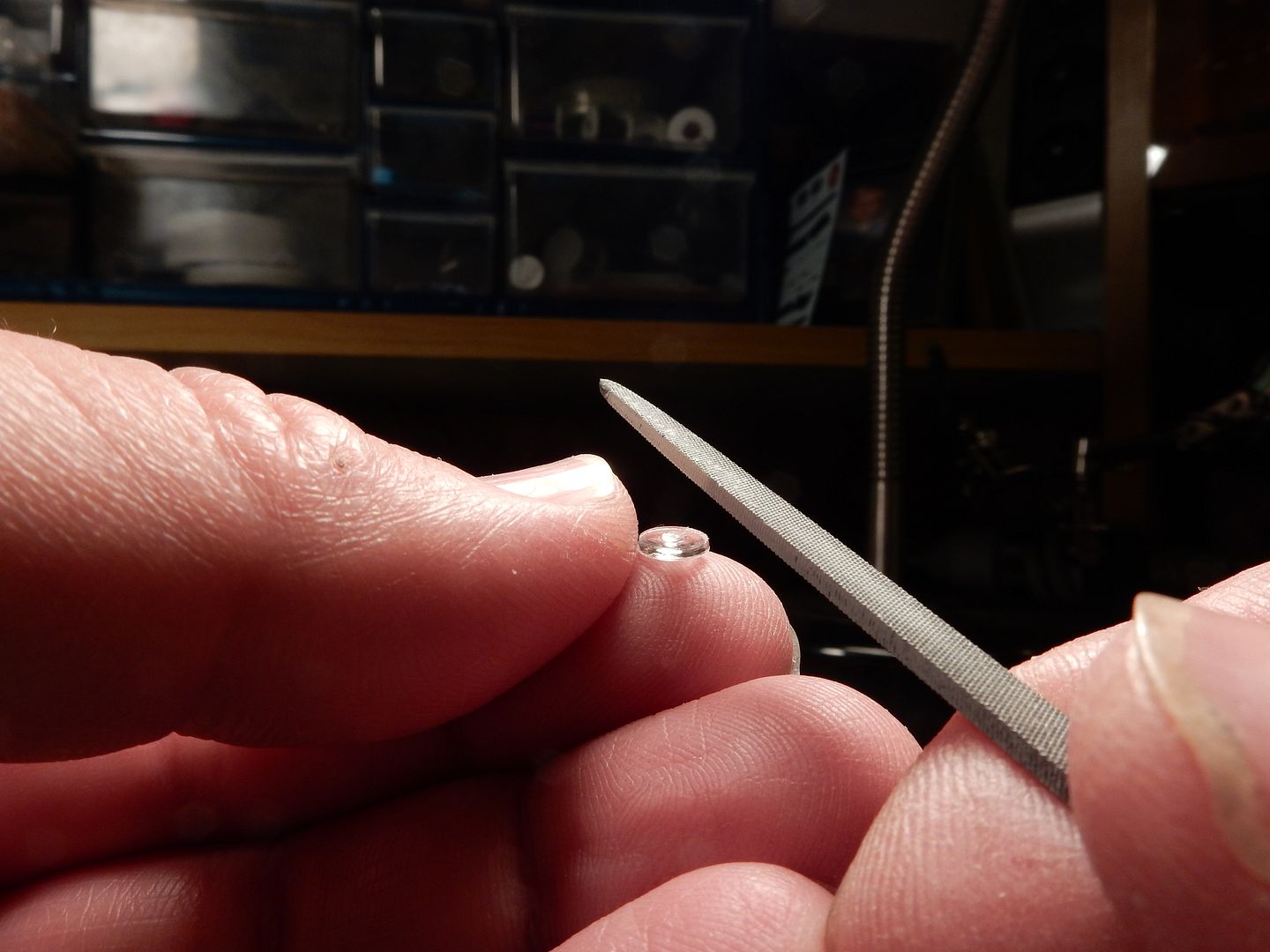

mustang1989 Posted February 24, 2015 Author Posted February 24, 2015 Ok there Carl I've put it together. First I started with ate up headlamp-exhibit A: Then cut the post off: After that I broke out a small file to get rid of all traces of the post from the lens: To get started I held it between my thumb and index finger because the initial cutting of plastic is pretty rough and I needed to be able to hold it while filing lightly. You need light pressure initially to keep the lens from being pushed out of your fingers. After you get it somewhat smoothed out to where the file will slide easier on the plastic you just sand it with it pressed into your finger by the constant downward pressure from filing. until it looks fogged over and the post completely removed. then you sand it with flexible sanding sticks working from 2800 grit all the way to like 12000 grit..... and end up here. After that you simply turn it over and apply a good coat of Future to the outside of the lens and it's a done deal. Hope this helped you out Carl.
