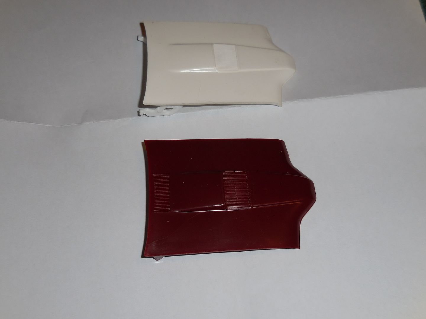

Here are the two hoods. Sorry but the burgundy is hard to photograph.
70 hoods have cowl vents in the hood, 71 hoods do not. This is actually true to the real cars also.

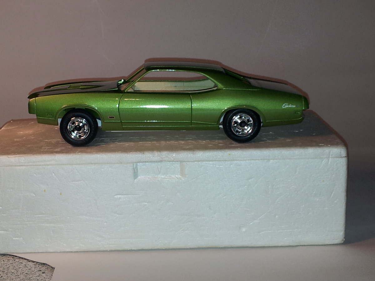

This is the current status of my build:
Wheelbase and front ride height need to be corrected.
Stock engine from the Torino. Interior is resin, I forgot about that ;) Since I started this project I aquired several other 70/71 Cyclones, that got me confused...
I had to remove a lot of resin from the rear of the interior. Also, at the firewall you can see where I cut for lowering the body on the chassis/engine bay.
The hood is from the NASCAR-model, just as the body. I cut a hole into the hood for the scoop screen and bashed one in from the parts box. The raised portion behind that hole is built up with a sheet of plastic filed to fit. As the NASCAR doesn't have a cowl vent my model is a 71 ;) Emblems are decals from Keith Marks.
Side markers are cut by hand. GT side trim is made of evergreen strips.71Cyclone_12_resize-vi.jpg
Edited by JS23U

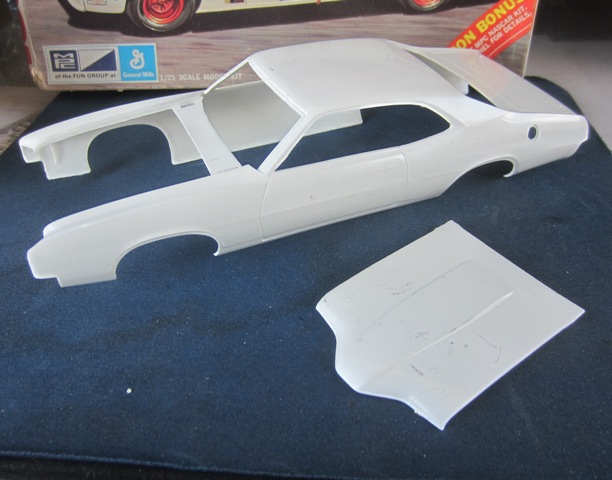

Bob, my hood (and body) looked like this, found this pic in the net:
As I said, I cut the hood open to add the ribbed grille.
Then I added plastic sheet to the center section of the hood between that hole and the trailing edge, in front of the windshield, to raise that portion. The center section is higher behind the scoop than in front of it, that's what needed to be raised. I scribed the surrounding little groove with a dentists tool. Was easier than I thought.
All this hassle isn't neccessessary of course with a resin hood. Either Motor City Resin or Missing Link had a Cyclone resin kit back a while. I managed to get the interior there but not the rest of the car. Hence my decision of modifying the NASCAR body and hood.
