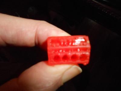

my66s55 Posted December 26, 2014 Author Posted December 26, 2014 No. It's the color of the resin. The resin is uv light cured. This is not done on a filliment printer.

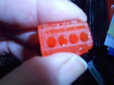

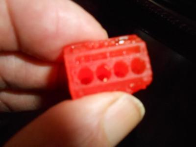

my66s55 Posted December 26, 2014 Author Posted December 26, 2014 On 12/26/2014 at 9:47 PM, sjordan2 said: So, what's your candid opinion of the result? The pictures don't do the print justice. The detail is incredible. This is the same type printer as a B9 Creator. Jewelers are using the B9 to make jewelry.
my80malibu Posted December 26, 2014 Posted December 26, 2014 Your correct about the pictures not doing justice. Could you dust it with a little aluminum paint to help bring out the detail some. From the small amount that I can focus on, it does look Good.

Ace-Garageguy Posted December 27, 2014 Posted December 27, 2014 Gorgeous. The shot with the scale in the background looks every bit as crisp (at least!) as injection-molded styrene. What is the cycle time to print a part this size?

Mooneyzs Posted December 27, 2014 Posted December 27, 2014 Very nice. What was the brand and model number of this printer? I would be interested in looking at the resolution. I know makerbots are 100 microns... formlabs printers are 25 microns. And this part looks way better than a makerbot printed part.
my66s55 Posted December 27, 2014 Author Posted December 27, 2014 On 12/27/2014 at 12:49 AM, Lownslow said: Got any info on this machine? All DLP 3d printers are based on open source development from this blog: http://www.instructables.com/id/DIY-high-resolution-3D-DLP-printer-3D-printer/step1/Basic-design-properties/. Mine, which I built, the B9 Creater, etc. The software, Creation Workshop, was developed by Steve Hernandez. Steve started this forum: http://www.buildyourownsla.com/forum/ last December. You should be able to answer any inquiries by resourcing this info.

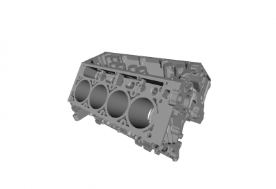

my66s55 Posted December 27, 2014 Author Posted December 27, 2014 On 12/27/2014 at 1:15 AM, Ace-Garageguy said: Gorgeous. The shot with the scale in the background looks every bit as crisp (at least!) as injection-molded styrene. What is the cycle time to print a part this size? Believe me or not Bill, It took 40 minutes for the software to slice 169 layers @ 100 microns and took 39.19 minutes to print it.
Ace-Garageguy Posted December 27, 2014 Posted December 27, 2014 (edited) Thanks very much for the infolinks. The very first 3D printer I saw in action was a photolith machine, doing a copy of a newly discovered pre-humam primate skull for study. I assumed the UV-laser curing of the liquid media would make its accessibility to mere mortals way off in the future. Then the filament machines started coming on, and I forgot about the liquid-media alternative, and stupidly assumed it had dead-ended. Wow. This machine you've built just blows many of my wrong-headed assumptions out of the water. You may have changed my life. Thanks again. Edited December 27, 2014 by Ace-Garageguy

my66s55 Posted December 27, 2014 Author Posted December 27, 2014 On 12/27/2014 at 1:36 AM, Mooneyzs said: Very nice. What was the brand and model number of this printer? I would be interested in looking at the resolution. I know makerbots are 100 microns... formlabs printers are 25 microns. And this part looks way better than a makerbot printed part. Chris, I built the printer. I have less than 1k in it. The most expensive purchase was the Acer 6510db dlp projector. It ran $607, but is considered one of,if not, the best. Makerbots are filament layering printers like my diy Prussa I3 in my avatar. Not really something you would not want to consider. Formlabs1 is an sla printer. That is, it uses a laser to cure the same uv resins that the dlp beam does. The B9 creator will go to 25-30 microns. Where it can get confusing is understanding 3d printing and these numbers. I may very well get to a 10 micron layer height, but that isn't really needed unless you like to wait a long time to print something. My engine block was printed at 100 microns layer height. The height is the z axis. x & y are the side to side and front to back axis. A filament printer uses all three. The laser printer uses all three. that is what creates a non smooth surface. It is also very time consuming. A dlp printer projects a beam of uv light that cures an entire layer in 3 to 6 seconds. There is only an x axis that moves. It took 39 minutes to print this engine block. I could easily add 3 to 5 more on the build platform and print 4 to 6 engine blocks in the same 39 minutes.
