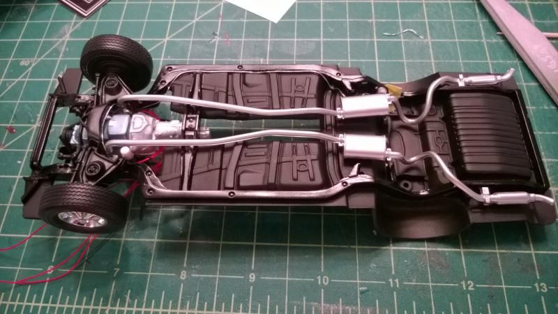

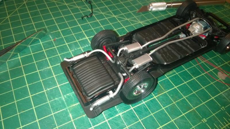

Belugawrx Posted December 31, 2014 Posted December 31, 2014 Hey.. I like the body work you did on this ! That chassis looks spot on as well,...a little something I do to black chassis is rub it down with graphite powder,... makes it really pop Scribing trunk lines, ...after it's been painted,.... mmmm ,... you need to straight edge and GENTLY run a new #11 exacto.. Gently....did I say gently ....to start a line where you want it. then after 3-4 passes, turn the blade around to the backside and GENTLY scribe again 3-4 times Well you will need to repaint, but don't strip it ,...it will soften all the filler.

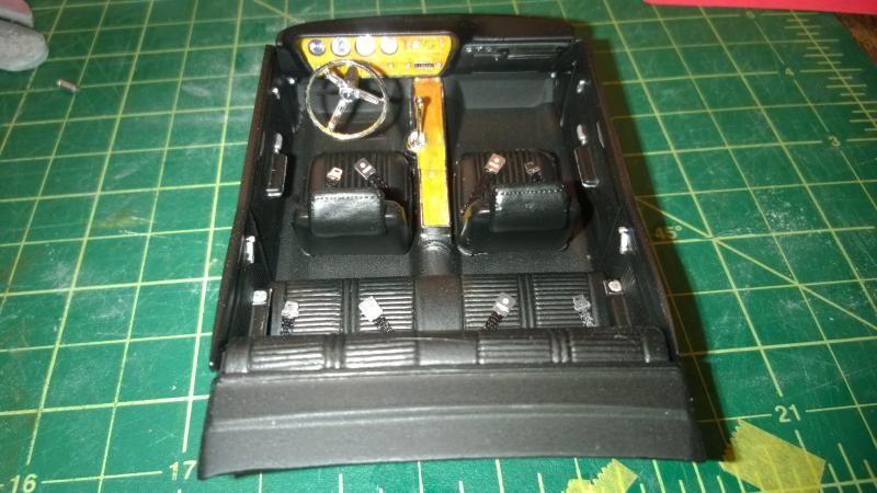

Tony_B Posted December 31, 2014 Posted December 31, 2014 Nice details on the interior...that's what I am trying to learn about for myself...and the chassis is awesome!

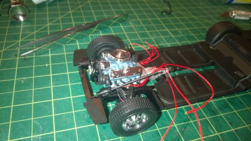

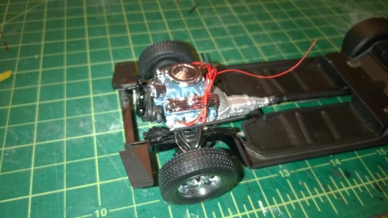

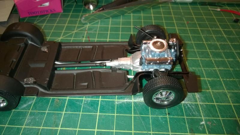

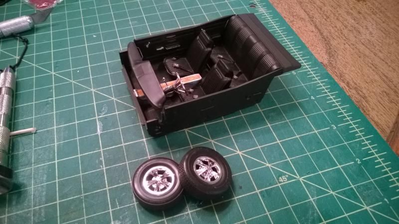

heptoman Posted December 31, 2014 Author Posted December 31, 2014 Thanks for the comments, everyone. Got the rear suspension in last night. I used some left over battery cable for the springs. Flipped over. Engine. I'm redoing the distributor and spark plug wires today.
Johnny1973 Posted December 31, 2014 Posted December 31, 2014 Nice work on the chassis and the interior

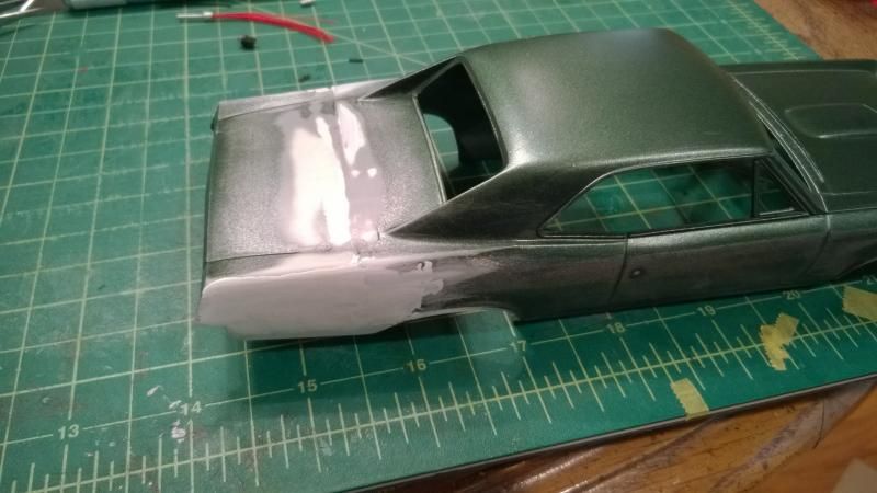

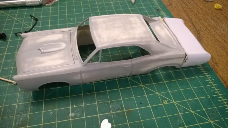

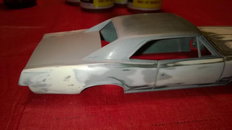

heptoman Posted December 31, 2014 Author Posted December 31, 2014 I decided to sand down where I had filler and make it a bit more even. The green paint magnified the tiny bump so I'm adding more. I will also resand down the rest of the exterior. Here's a pic of progress - before sanding. Okay, distributor and wiring removed, ready for the kit. And - another view of the interior. I forgot that I didn't show the dashboard! (The flash sort of covers the gauges but they're there - accurate for a '67).

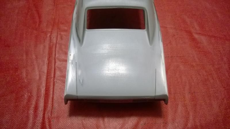

horsepower Posted December 31, 2014 Posted December 31, 2014 Your pictures weren't really close enough to see how bad the misalignment in the rear clip is but it looks like making a single saw cut from back to front on each side of the lock assembly might take just enough material out to realign the rear lines.

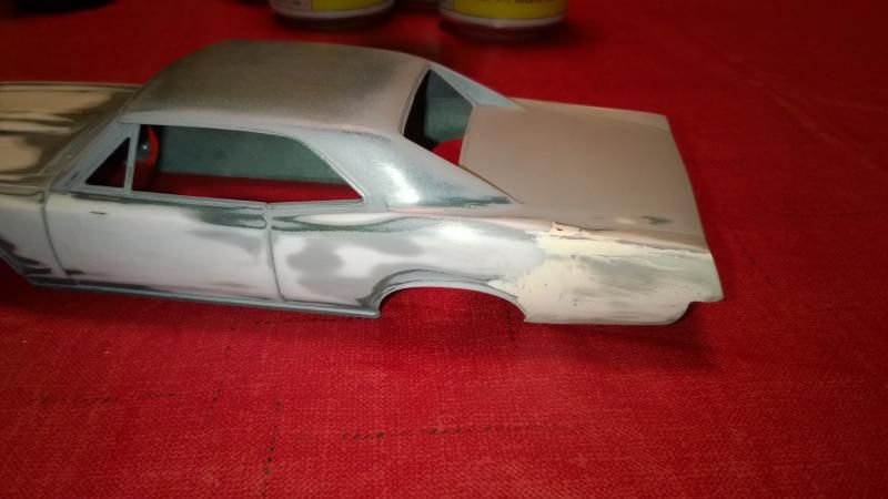

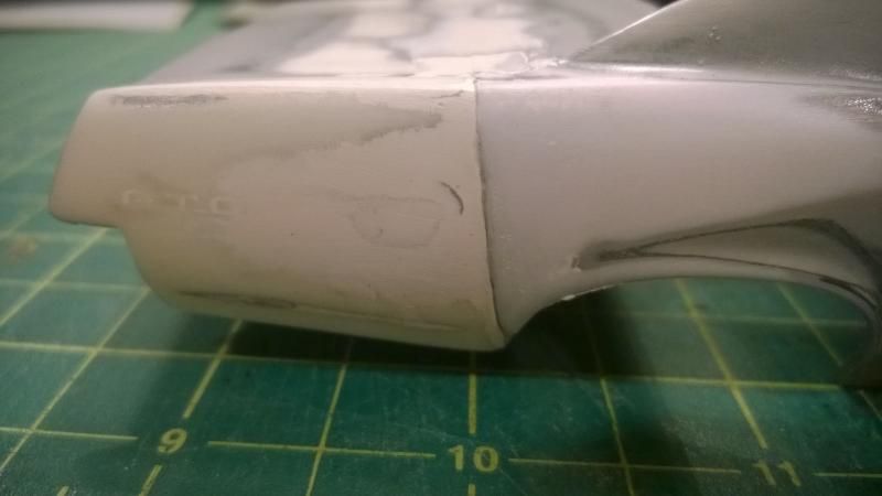

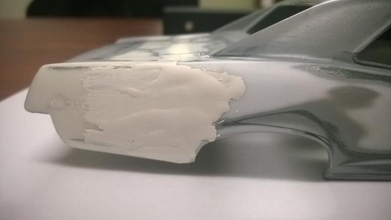

heptoman Posted January 1, 2015 Author Posted January 1, 2015 New distributor and ignition wiring. Real pain. I'm going to reroute the wires tomorrow once the glue sets. Close up of left rear on the body. Still a bit of levelling to do, but it's manageable and it's getting closer to where I want it. Right rear fender. This still needs a lot of work. That's all for today. Happy New Year everyone.
kruleworld Posted January 1, 2015 Posted January 1, 2015 nice work so far. i'm surprised you cut it across the center of the trunk, rather than closer to the rear. but, you're doing it. rub it down with graphite powder,... makes it really pop. IE grab a pencil

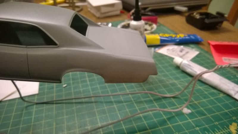

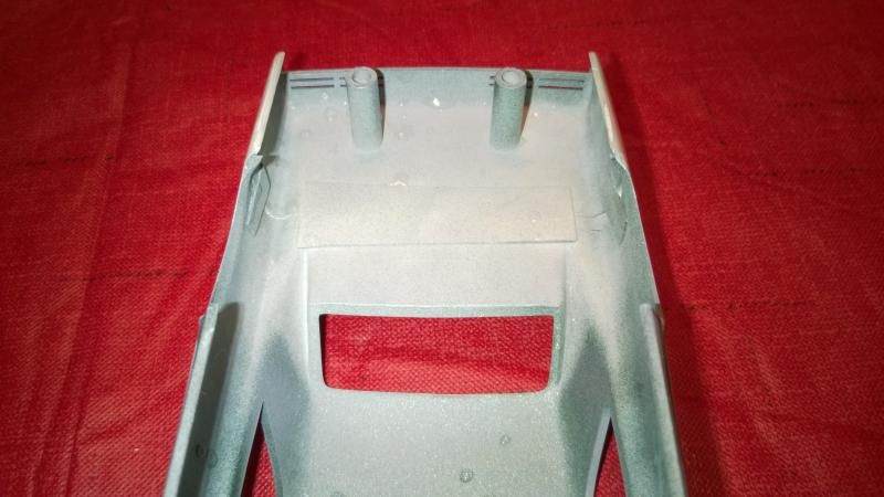

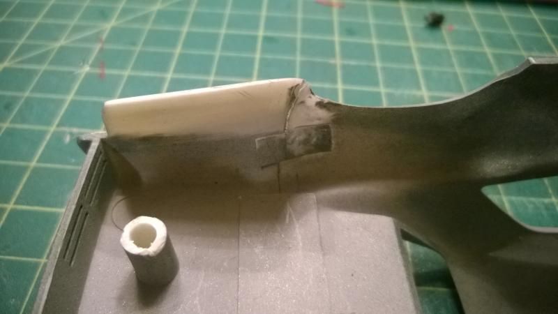

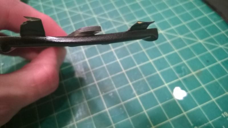

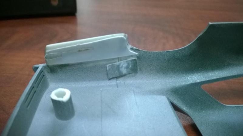

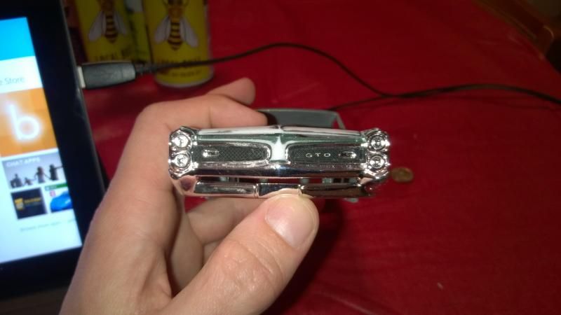

heptoman Posted January 1, 2015 Author Posted January 1, 2015 Again, thank for the comments everyone. I can't get the quotes to work, so I'll answer everyone's questions. I decided to cut along the back end of the rear wheel wells because it seemed to me the best place to rescribe the trunk line, match up the panels, and give me enough room to get small pieces of reinforcing styrene on the inside (which I forgot to take picks of). I also decided to put the '67 end on the '66 body because overall, the '66 body was far superior to the '67 (as Art mentioned - vast year difference between the two kits!). The '66 front end is minutely different than the '67 but I'm not going to worry about it. I also took the grill inserts from the MPC with the angled grill and sanded them down super thin and inserted them into the '66 front fender. The '66s had a horiz/vert pattern to the grill, the '67s had angled, so I wanted to get that at least correct. The only things from the MPC kit that I'm using are the rear bumper, rear deck, and grills. Everything else is the '66 - so the chassis and interior will definitely fit, even with the '67 tail. I'm going to try to post more pictures but my wife and I are at my parents' ranch, limited internet/tech availability. I'm sure I'll find some way to make it work.

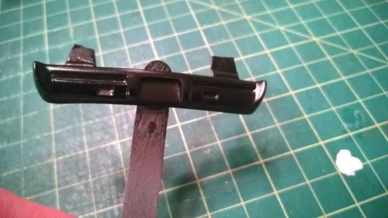

heptoman Posted January 1, 2015 Author Posted January 1, 2015 Ok everyone, I was able to pull pictures from my phone onto my tablet. Here is the '66 bumper with the '67 grill inserts. And the rear trunk deck. Still some smoothing to do. I'm holding off on the trunk line... And here's the inside of the rear showing my styrene joints. This helped me IMMENSELY. The injector pin molding doesn't get in the way of anything in the '66 kit. Passenger side, more sanding, flattening. It's going to need a bit more body filler - there is the TINIEST of bumps! And the other side. I know it doesn't quite look like it, but I believe this side is ready to go. Very smooth, if I do say so myself. That's all for now - waiting for the wetsand to dry completely before another shot of primer and filler. Getting pretty close now, though. Also - you might have noticed I haven't been paying much attention to the roof - that's because I'm going to put on a black vinyl top to match what my dad had on his. That will be a whole other adventure.

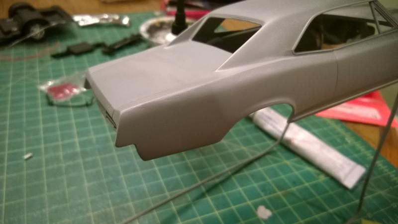

heptoman Posted January 2, 2015 Author Posted January 2, 2015 Another update - and picture of the source of my "frustrating" challenge. In these first two shots, you don't see much issues. Yet, change the angle of the reflection and you can still see the tiny seam between the two parts. Granted - it's getting smaller but I'm having a heck of a time perfecting it. Part of me wants to shoot primer on it and see if it shows up but I have a limited amount of primer left here in the middle of nowhere.

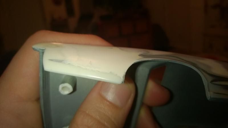

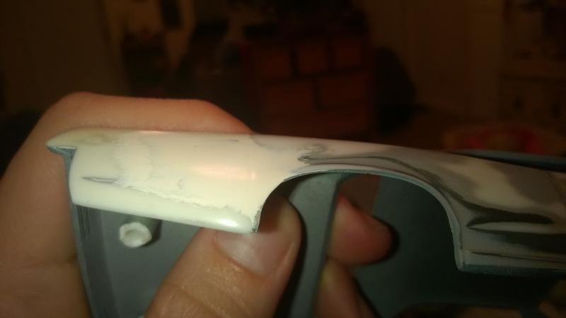

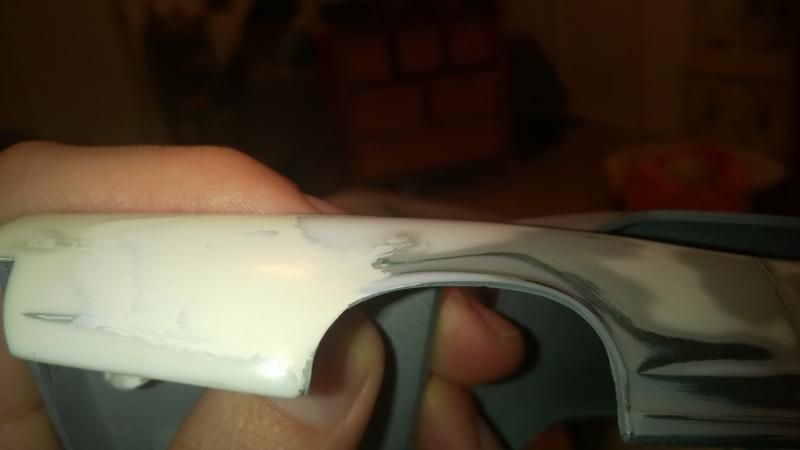

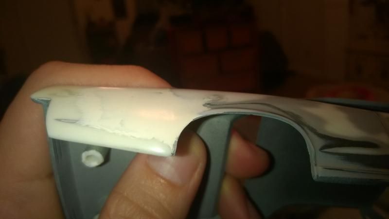

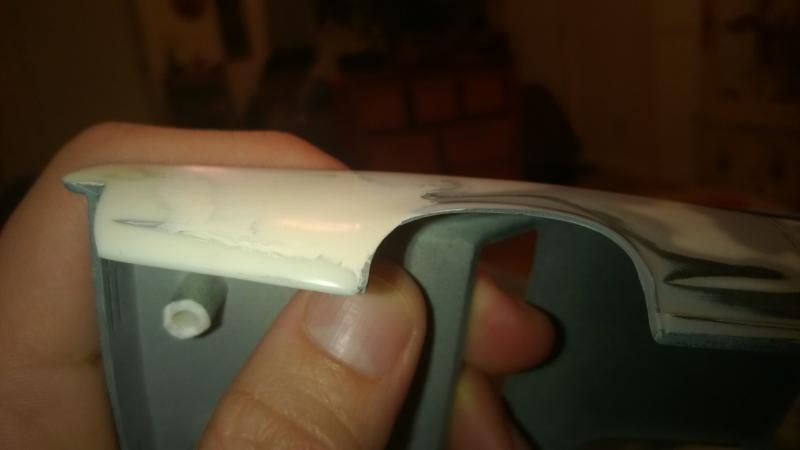

heptoman Posted January 10, 2015 Author Posted January 10, 2015 (edited) Hey everyone, I'm still working on this rear passenger fender. I was really unhappy with how it was turning out. I'd add putty, sand it down, and I kept getting a ridge. So I decided to strip down almost all of the putty and start over. When I did that, I noticed that the seam was still pretty bad, so I added some more strip styrene to the inside to reinforce it better. Before: After: The weird flaky substance on the styrene is cement leftover from the binder clips I used while the cement cured. Easy to sand off. And the next (and hopefully last) layer of putty laid down. Currently waiting to dry/cure, then sanding, prime, body color (finally!!!) Pretty soon I'm going to start on my own Christmas presents. To finish matching the real garage: Then the future 1:1 restoration project with my dad: And then to continue my Lambo collection: And also there's a Tamiya 1/24 Countach restoration also, so plenty of work for me! Edited January 10, 2015 by heptoman

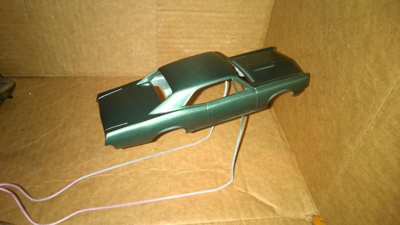

heptoman Posted January 20, 2015 Author Posted January 20, 2015 Still working, sorry for lack of updates. I am STILL trying to smooth out that rear fender, but I think I finally have it this time. More pics later - here are some other things with the car. Now that I have an airbrush (fun!), I stripped the chrome off of this puppy and am going to Alclad it. I need to micro mesh sand it, it's not as smooth as I want, but it's getting there. This is with Alclad gloss black base. Another view. Here's where I need to smooth it out and perhaps lay down another coat. More pics later tonight - body is primed for next inspection.
wrenchr Posted January 21, 2015 Posted January 21, 2015 Just a suggestion on where the two body parts meet, create a trough or a v channel where the two meet on the outside and extend the filler more onto the body, not thick though and this should help blend the two parts together.
heptoman Posted January 22, 2015 Author Posted January 22, 2015 Wrench - if this next go-round isn't successful then that's something I might try. Otherwise...???
wrenchr Posted January 22, 2015 Posted January 22, 2015 Are you going to use sealer? You might get ghosting lines if not.
