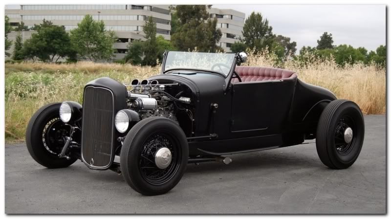

tim boyd Posted March 23, 2015 Posted March 23, 2015 (edited) Dave...yes, a '26/'27 T of any kind (roadster, sedan, touring..) on '32 rails is feasible, and in fact many have been built as shown in Bill's follow-up post to your comment. A '27T on '32 rails won the America's most beautiful roadster award (a Roy Brizio build) a couple of years ago, too. That one would be a great place to start as a style guide for this type of model build. I did a '27T Roaster Pickup on '32 rails about 12 years ago, using a Tim's Resin Rods body on the Revell '32 Ford frame. The challenge, though, in both 1/1 and 1/25th scale, is that a stock '32 frame is too wide for the T bodies. So it has to be narrowed - not a job stopper, but not a slam dunk either. I did this project in the other magazine, I think it was in their Contest Annual around 2004 o4 2005 (I can look it up if need be). I'll also check my Fotki site and see if I previously posted pictures there.... Just more of the many, many cool ideas this kit will enable...TIM Edited March 23, 2015 by tim boyd

Bernard Kron Posted March 23, 2015 Posted March 23, 2015 (edited) The details of the forthcoming A-bone release will lend themselves well to a traditional style 27T roadster on Deuce rails. I completed a just such a project last Fall. If you're using any Deuce chassis you need to narrow the width in two areas, under the passenger cab, and then narrowed some more under the turtle deck. In my version I z'd the chassis as well, which actually lent itself more readily to narrowing the turtle deck area because the rails tucked up into the body work at that point. Here's a link to the build thread which shows the chassis work as part of the initial post: http://www.modelcarsmag.com/forums/index.php?showtopic=91554&hl= . Here are a couple of build pics: And the final result: Edited March 23, 2015 by Bernard Kron
