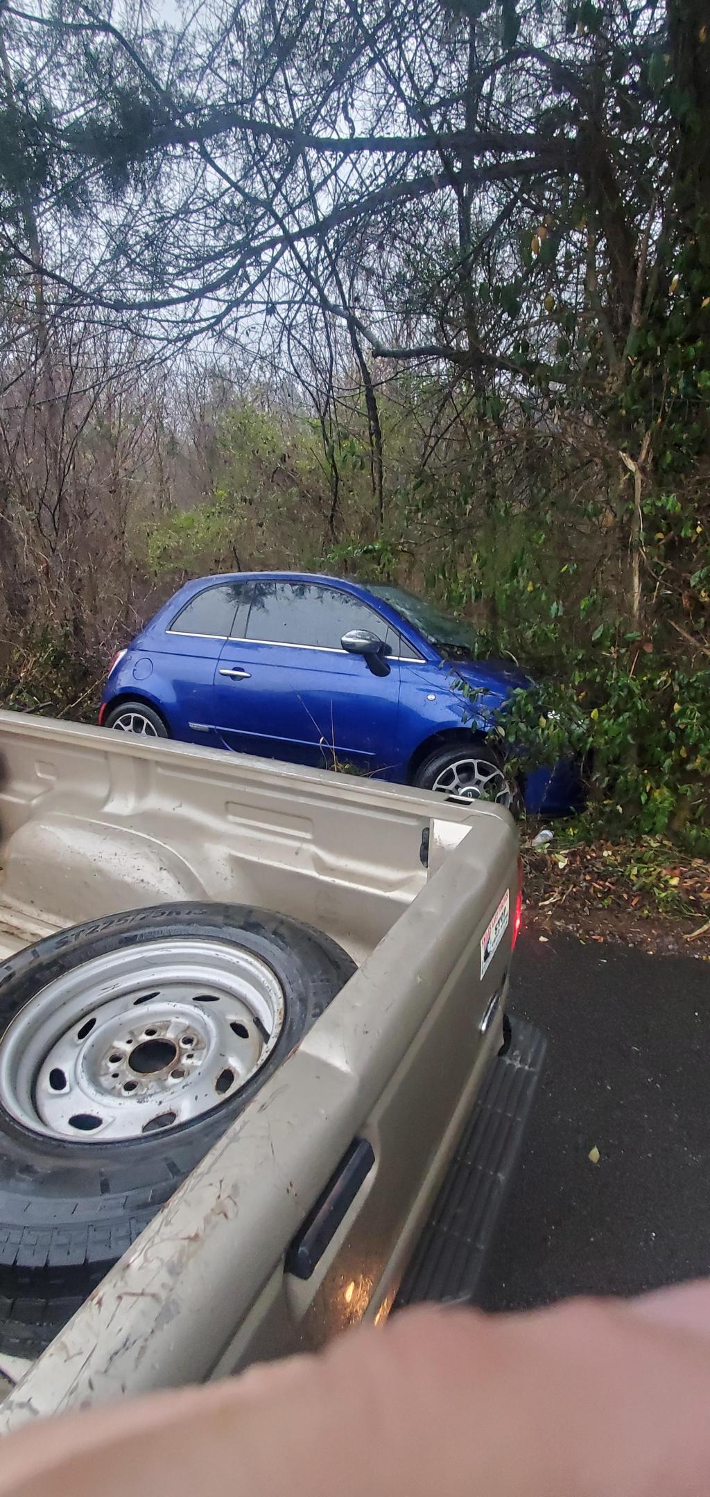

Day before yesterday I came home from work to find this little guy in the tree line at the bottom of my driveway. It obviously didn't quite make the sharp turn in the rain. It was left unoccupied. So, naturally I called the county dispatch to inform them that someone may be hurt in the area. It seemed unlikely but I've seen it before where someone gets out walks and collapses later from internal or head injuries. I live on a small rural road. So, as I'm setting cones around the corner to alert any traffic to my and the vehicles presence a car pulls up and a mangy looking old man comes out of the driver side and says it's his car and that he was ran off the road in the turn. I ask him if he is ok as my neighbor who is a retired Fireman/EMT comes walking down with his kit. The man says he is fine... so we offer to help him pull the car out to avoid a tow bill. So as I'm accessing the damage and best way to pull the car, I start clearing broken T post's/ barb wire and branches while my neighbor positions his truck and gets his chain ready. The police finally arrive, and start questioning us about the situation and help in directing traffic. These little fiats suck for tow hook placement in the rear... there is one crossemeber that is way under there. So I lay on the wet ground and hook it up, we finally get it pulled out without any more damage and he starts it up to drive away as I notice the passenger wheel is knocked back and rubbing the fender well too much to be driven any distance. Then I notice the pile of beer cans right under where the driver door was. The Officer smelled the alcohol already but hadn't said anything... he let the guy get in the car and start to drive away before pulling him over for DUI... he was arrested. He didn't get ran off the road, he was drunk, on bald tires in the rain. I felt like a jackass for pulling him out, and now my entire left arm is eaten up with poison oak! I'm pissed! ? I can't work on models because my left (dominant) hand is a fiery/itching balloon! Trying to be a nice guy did not pay off this time! -

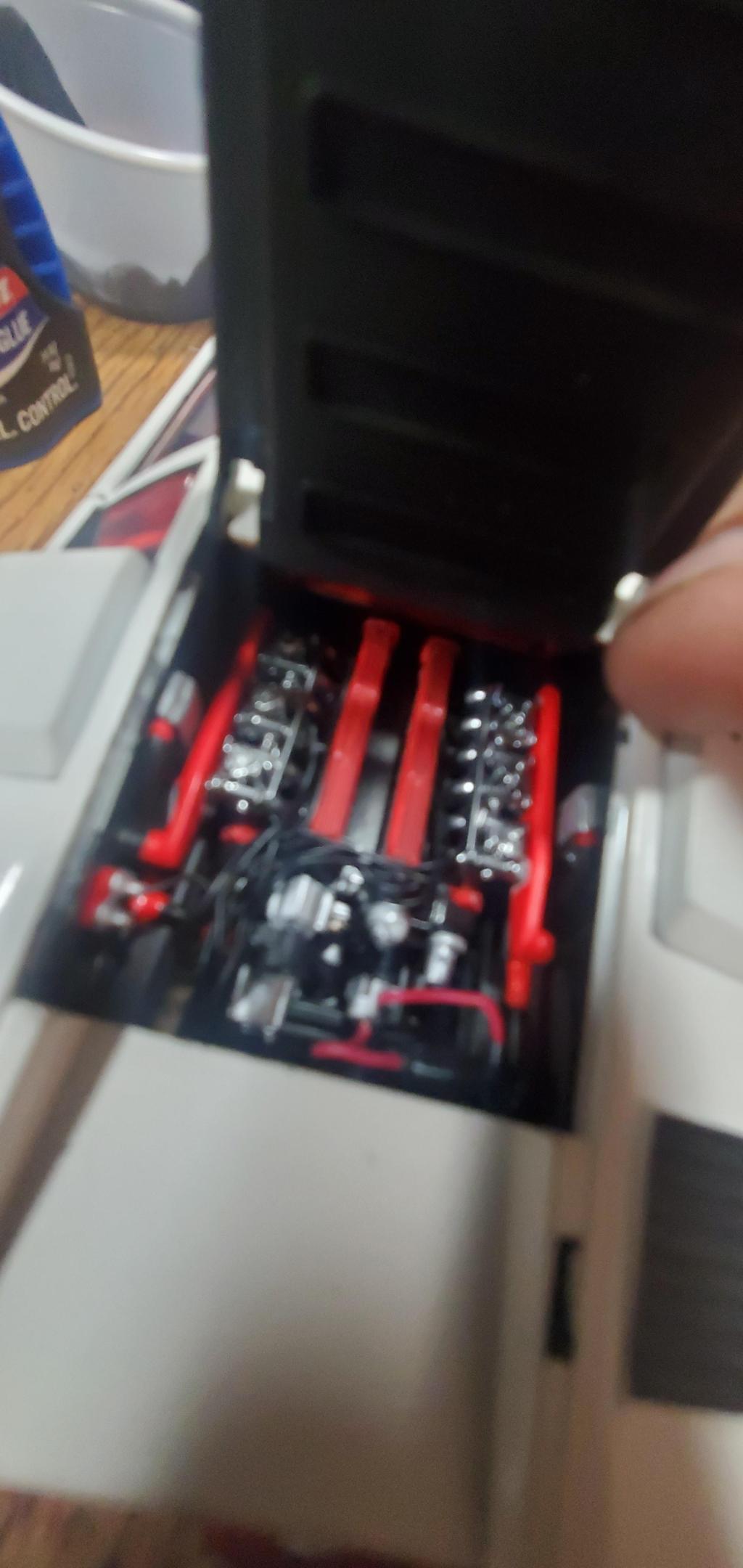

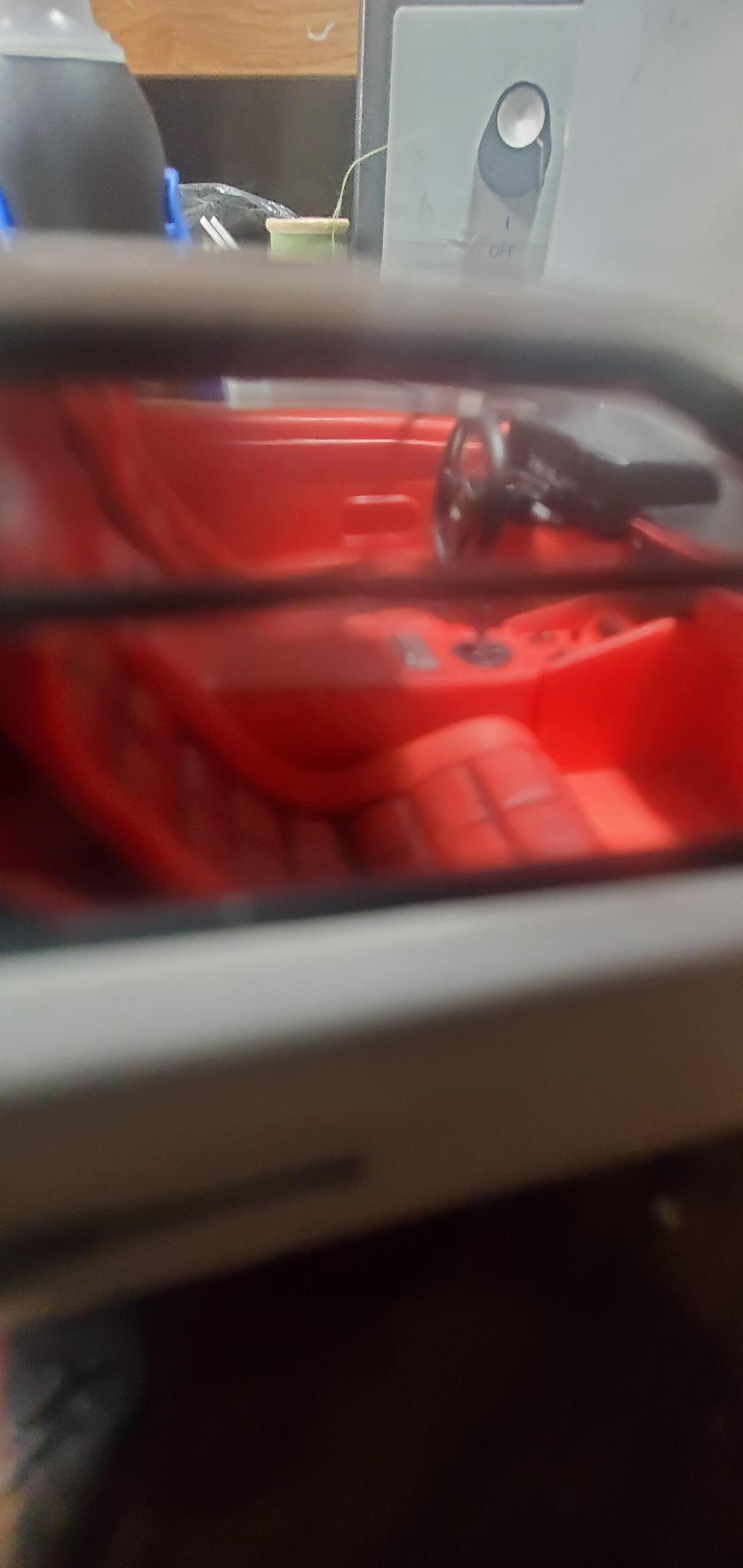

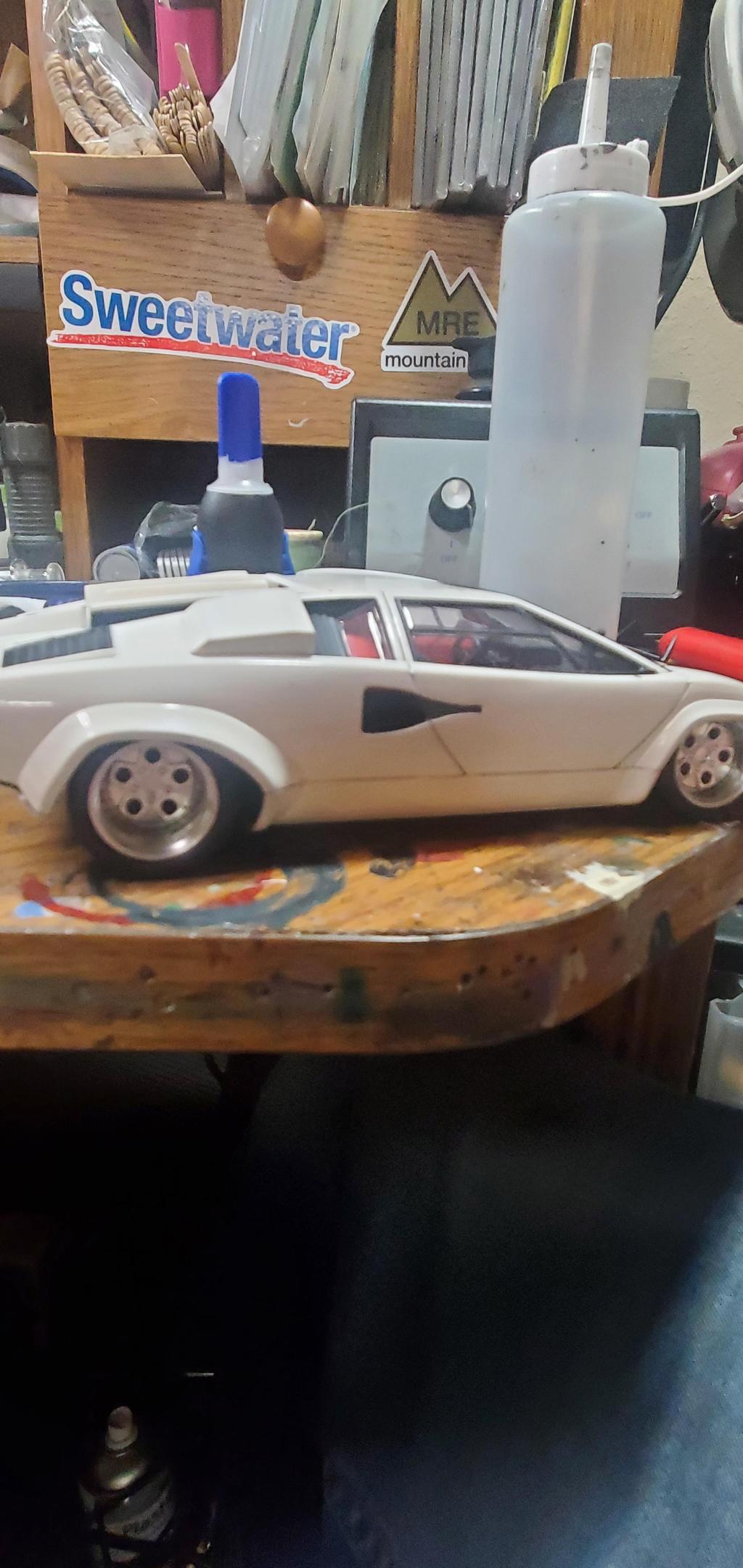

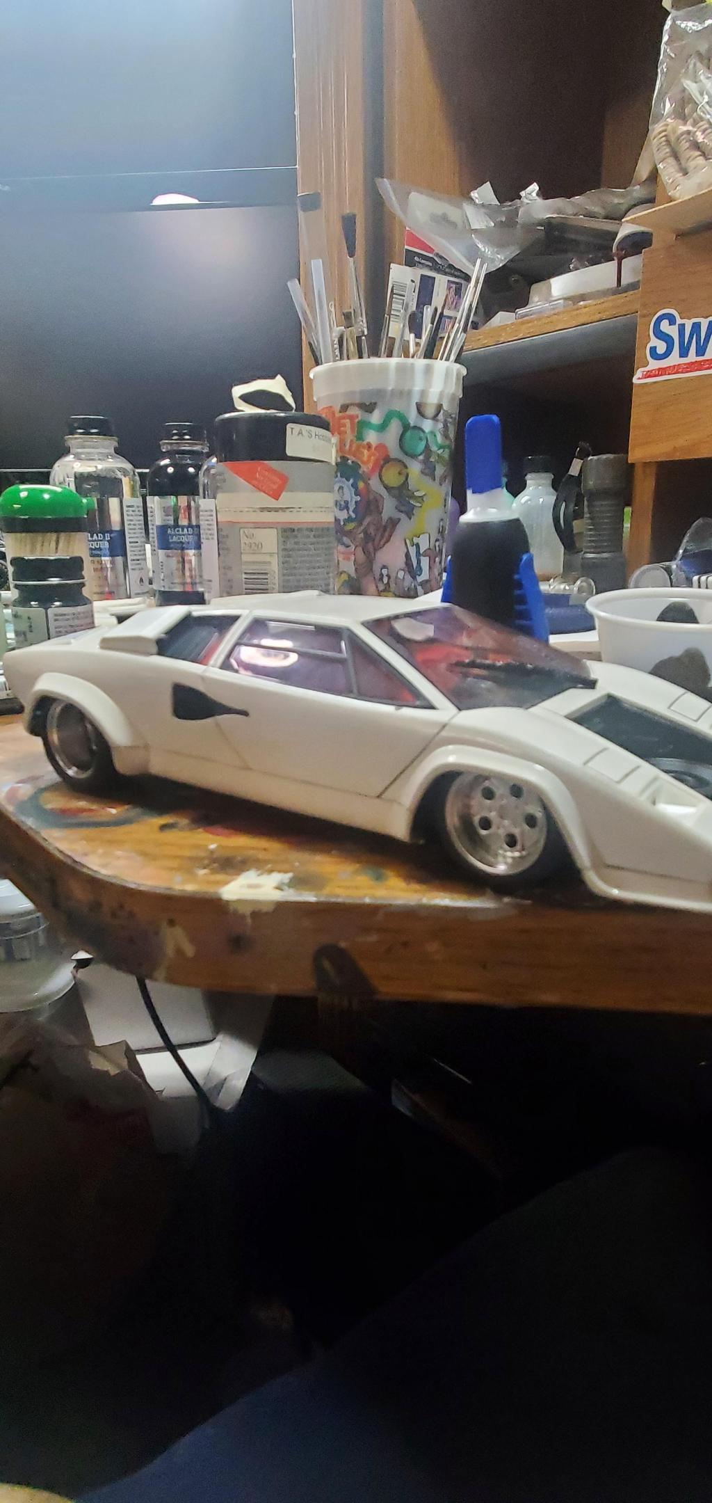

Probably the last update on this one... I've not set my photo booth up yet, so pics are still lame... I've got a few things left to do.. like mounting the wing, and mirrors and a few other odds and ends. It's basically finished though. Gotta put it away for another project. Thanks for looking. I doubt I'll post it in the complete section...

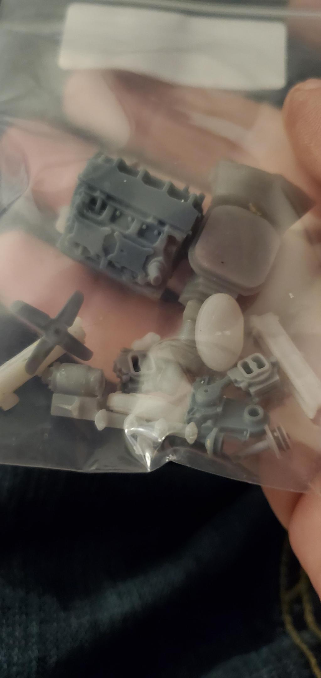

Got this awsome Golden Commando and correct trans for my Christine project... from my66s55. Very nice piece. Also picked these up today while Christmas shopping.
