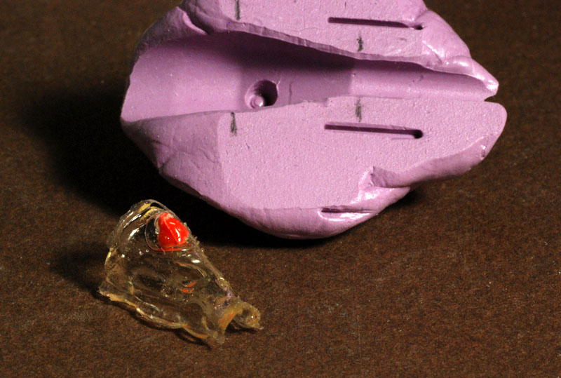

Foxer Posted November 5, 2015 Author Share Posted November 5, 2015 (edited) I needed to cast a couple GMC logos from a mold off the grill of the A-Team Van ... so Bondic to the rescue in 10 minutes total. Edited July 30, 2017 by Foxer Quote Link to comment Share on other sites More sharing options...
