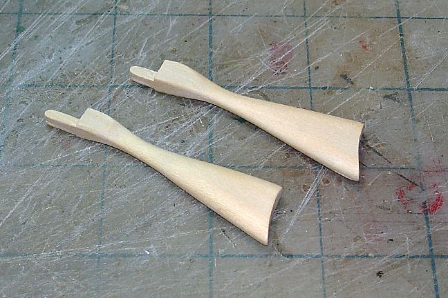

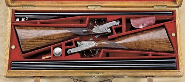

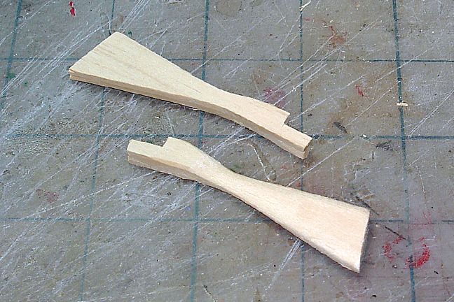

The stocks were cut from basswood with a sharp X-acto blade, and the rough shaping was done with said knife... raw piece on the top, lower piece with the beginnings of the shape carved...
Once I had both stocks roughed in, I used a sanding drum chucked up in my Dremel to quickly get closer to the final contours, using the photos Skip supplied as my reference. Finally I went to hand sanding to get the contours right. No real secret to doing this, it's just a matter of patience. Always easier to remove wood than to replace wood. After about an hour of very pleasurable work (I love woodworking), I was pretty much ready for stain...

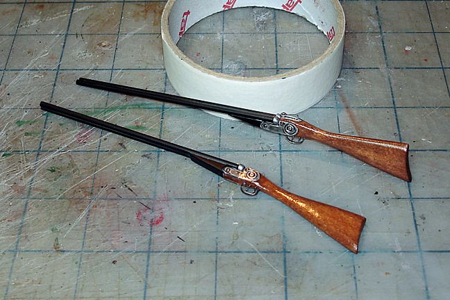

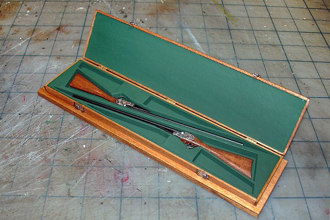

Anywho... back to land-based vehicles. :D  After several hours of building. I now have a matched pair of English hunting shotguns for my woody. This is a first for me... in all my years of building scale models, i have never built a model gun  And now I've built two!
I stained the stocks and sprayed them with several coats of gloss clear acrylic. The barrels are styrene tube, and various small detail parts are made of bits of styrene rod, tube, and sheet. The "metal" side plates were cut from aluminum duct tape, and the triggers and trigger guards are soft silver wire that I flattened with pliers and bent to shape (I found the wire in the jewelry aisle of Hobby Lobby... it's a little harder than solder, a little softer than aluminum rod). The guns scale out to 48" long (30" barrels). They aren't 100% super accurate, but they will do the job representing period-correct shotguns in my woody. I think they turned out pretty well. B)

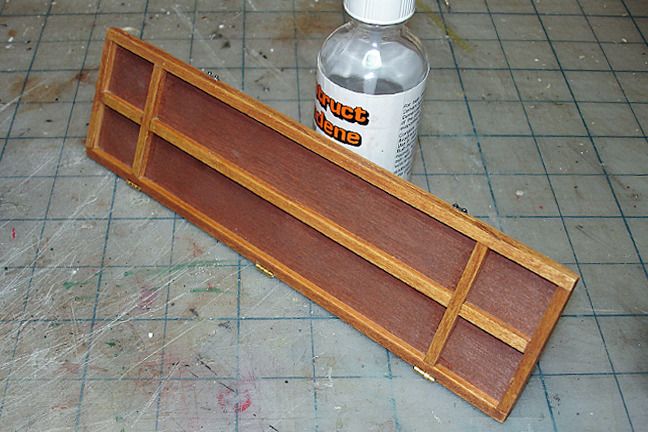

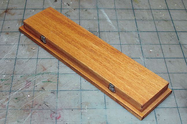

OK... use your imagination and picture the tailgate actually installed on the car... because it isn't yet... :P
Tailgate closed...
Tailgate open...
And finally... gun case cover open...
I'm thinking of adding a few details to fill the open storage spots... maybe a hunting knife or two, a couple of boxes of shotgun shells, etc.

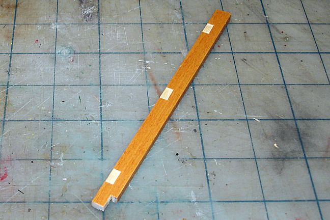

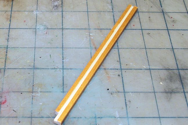

The first step was to solidly define the actual door openings by adding the wooden pieces over the A-pilllars, and building the rear side panels of the body (the side panels behind the rear doors). The center door post, to which the doors will be hinged, was then cut to size and the mortises for the six hinges (three for the front door, three for the rear door) were formed. Here is the "hinge side" of the rear post of the left front door... the post that will be hinged to that center door post. The exact positions of the mortises on the center post were transferred to this piece, and the corresponding mortises were cut out. Also, I notched the inside bottom of this piece, to clear the floor when the door is closed...
Oops... I just realized that this is rear post of the right side front door. But you get the idea... left side is just a mirror image.
