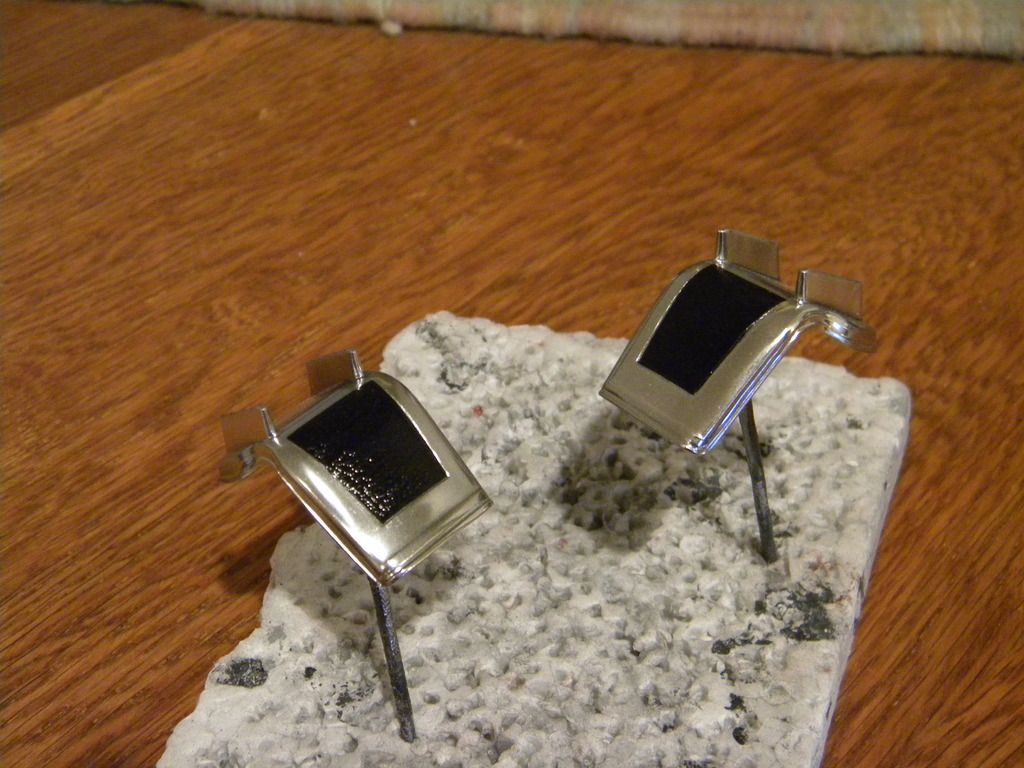

MrObsessive Posted March 27, 2016 Steve, I was a little reluctant to answer your question because I know that I used Alclad on an '05's 'Vette's wheels years ago, and I do remember clearcoating them. In agreement with what Gerry said, it wasn't Alclad's clear, it was I believe Future Floor Wax I used which is an acrylic. Here are a couple pics to show......... I didn't care for the super bright chrome the wheels were done on the chrome tree. I had stripped them, airbrushed Alclad's black enamel on the wheels, and then airbrush very light coats of their chrome on. Afterwards, I brushed the Future on which to me didn't seem to dull the finish. The wheels look more like polished aluminum than that super bright chrome which to me doesn't look right on this gen Corvette. As always, you might want to test it out on some spoons or something. You know how things change, and it was close to 10 years ago when I built this. Quote Share this post Link to post Share on other sites

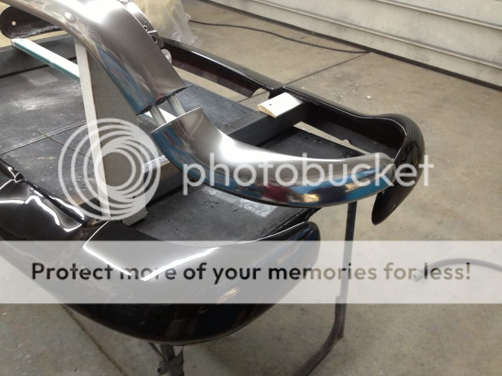

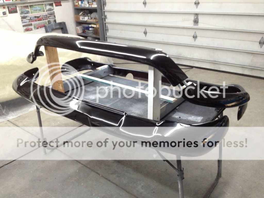

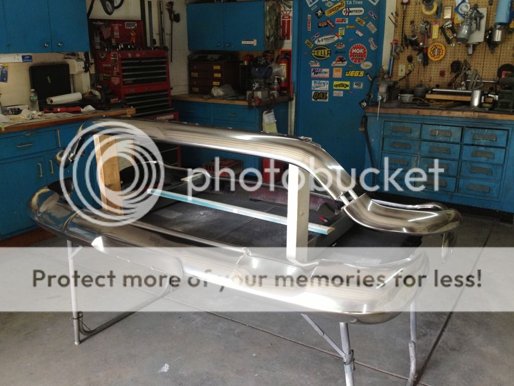

Impalow Posted March 28, 2016 (edited) I have some experience with both alclad chrome and the Alsa "mirrachrome" on some 1:1 projects... I can confidently say any type of clear on top will cause some dulling of the chrome effect. While working on the 1:1 scale Alsa stuff I spent many hours on the phone with their customer service, and an engineer...Ill share a little insight of what they told me, now this has been a few years so some details may be lost, but I think the concept is still accurate for all of these faux chrome paints. The sprayable chrome paint is really microscopic metallic particles suspended in a acetone like substance. The acetone is meant to lightly etch the high gloss black base surface and allow these little particles to stick to the black base. The harder your basecoat, the less durable your finish will be. I have had good luck with the rattle can Dulpi-color Enamel Clear over a black base before spraying the Alclad. In the 1:1 world this clear is awful, and not durable at all.. but it seems to be just soft enough to allow that acetone to do its job. Another trick I've been using, is to spray the alclad within 10 minutes of spraying the clear on the black parts.. this ensures the clear is still soft. I have found this to be pretty durable for handling, much more than I was expecting. Now to the reason why you shouldn't use the a clear top coat... These tiny particles are designed to lay onto the shiny black surface in a somewhat uniform pattern, (supposedly microscopic diamond shapes that interlock) they work kinda like a 2 way mirror, and reflect the black surface back through them to create the chrome effect. Any top coat will make these little flakes float upward into the clear, which increases the distance between the particles, allows more of the black to show and ruins the chrome effect. At the time I was working with this, Alsa had been trying to formulate a clear that didn't do this with no real luck. So a quick less nerdy recap.... use a soft base coat, don't clear over-top, handle minimally and you should be fine. Here are some photos of my 1:1 faux chrome experience... a learning experience to say the least. Gloss black base Alsa Mirrachrome - No clear And since this was a real car and needed protection... after clear... ugh.. still looks okay, but much more like a stainless steel than chrome. (the car is my dads 1953 Oldsmobile 88, it has been in the family almost 20 years, had monochrome red bumpers for a long time.. painting this way was a fraction of the price of traditional re-chroming... so we gave it a shot) Edited March 28, 2016 by Impalow Quote Share this post Link to post Share on other sites
