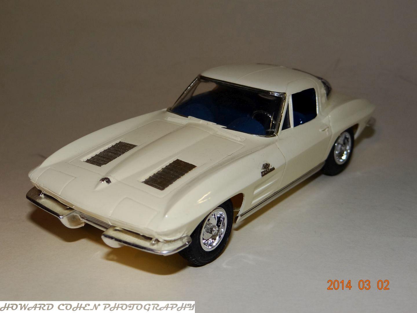

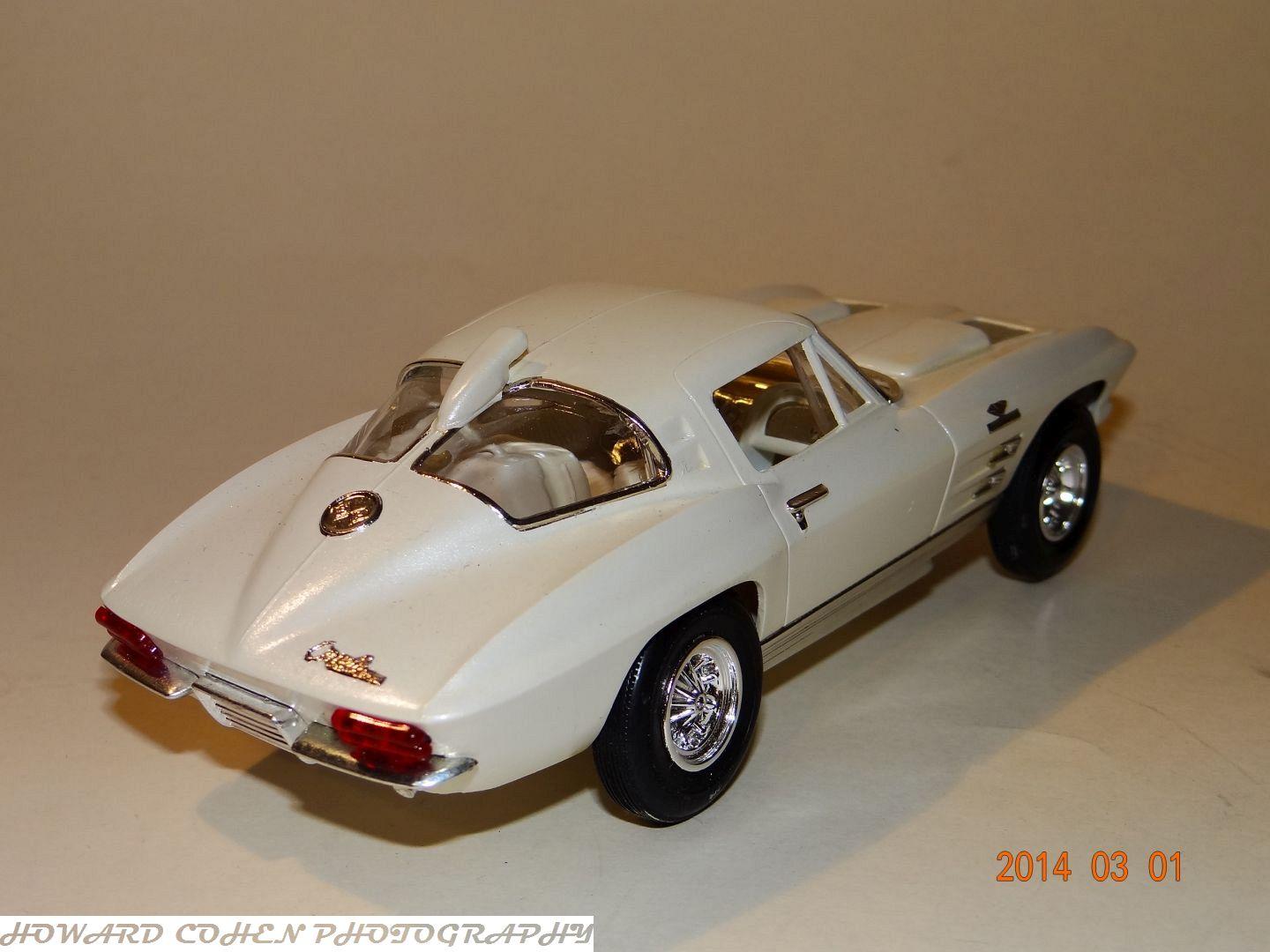

Here are a few tips I have learned about using foil for the past 40 years:
1 - make sure the paint is fully cured, dry is not good enough. Fully cured may be an extra few days or week, depending on the paint you use. If the paint is not fully cured, you may damage it.
2 - apply a coat of non-silicone wax before you foil. It leaves the surface smoother and makes the foil look better, no bumpy or grainy finish.
3 - cut small straight strips and apply them straight. You can trim they easily with a NEW blade. I use stainless steel surgical blades, much higher quality and better edge for cutting.
4 - I always burnish with the flat side of a toothpick or with the side of a small plastic paint dabber.
5 - apply a coat of wax after to add more shine.
6 - This is an original 1963 Corvette and all the foil was done with 1 new blade, a fresh sheet of foil (if it is cracked, use only the smooth bits, never try to smooth the cracks). This is about 4 hours of foiling.
