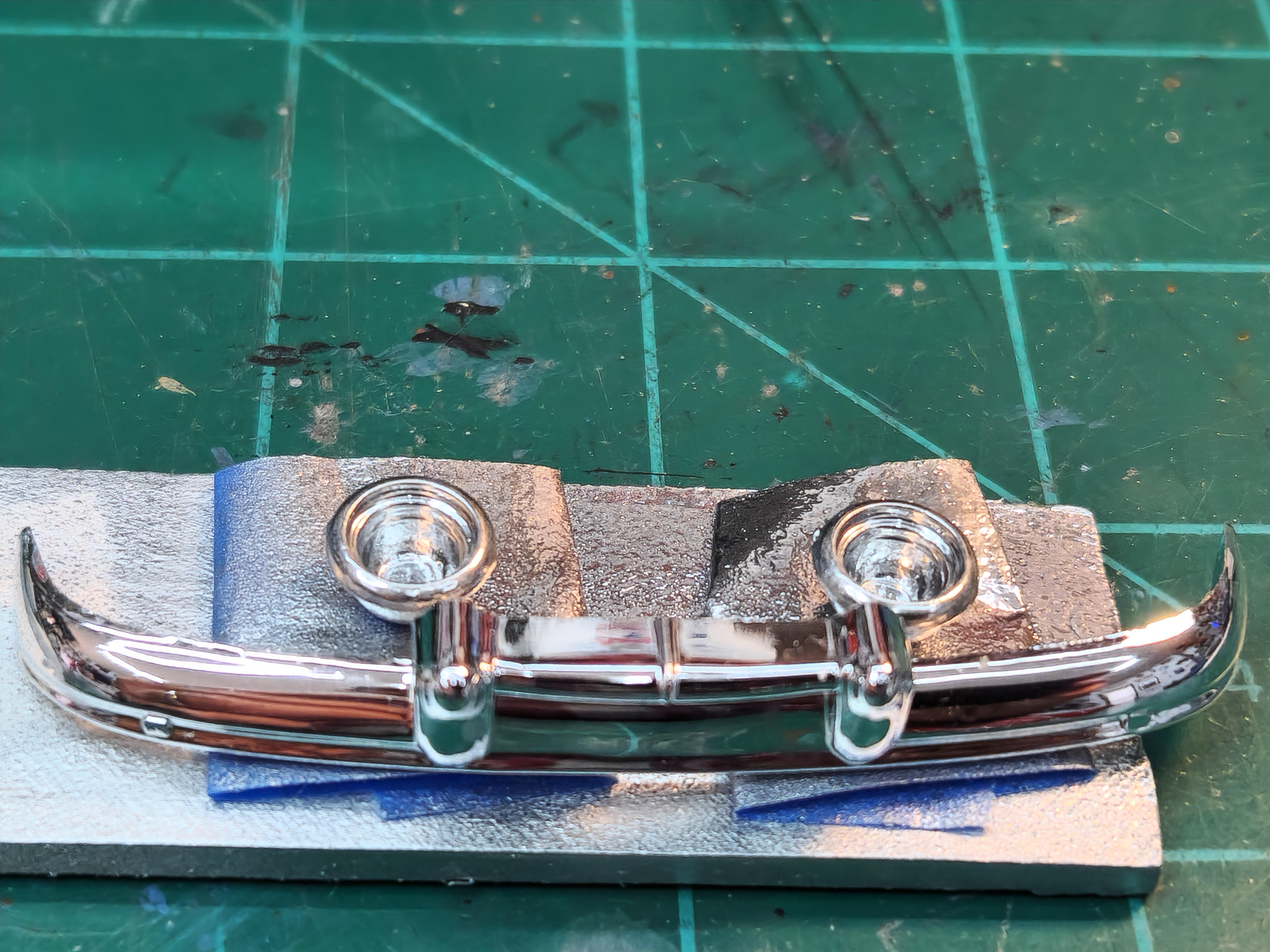

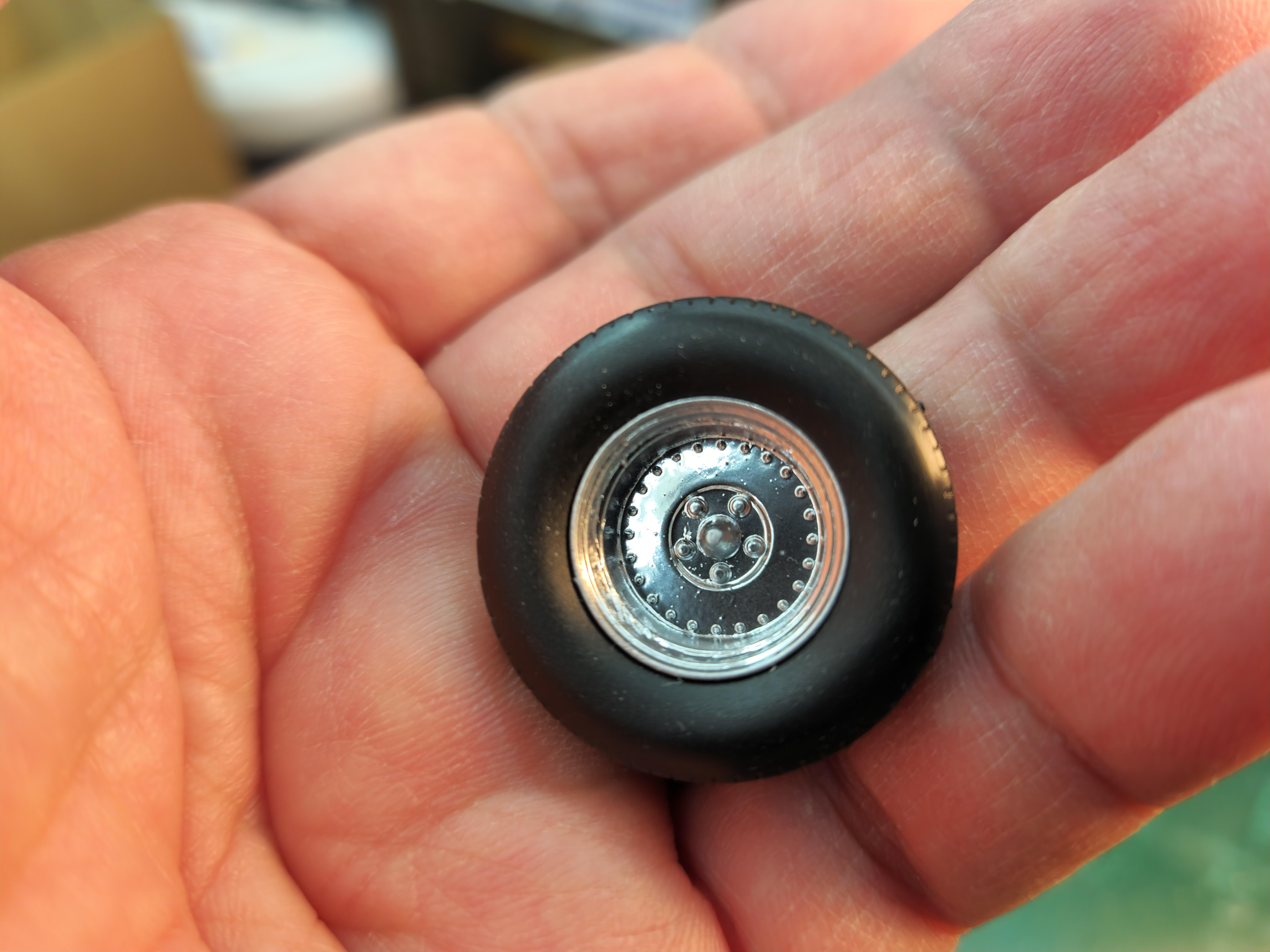

Zippi Posted November 23, 2022 Share Posted November 23, 2022 As someone else mentioned I did a test shooting it through my airbrush at 15 psi and no thinning. The results were much better than anything I've sprayed out of a rattle can. The bumper is kit chrome just for a comparison next to the headlight buckets. 1 Quote Link to comment Share on other sites More sharing options...

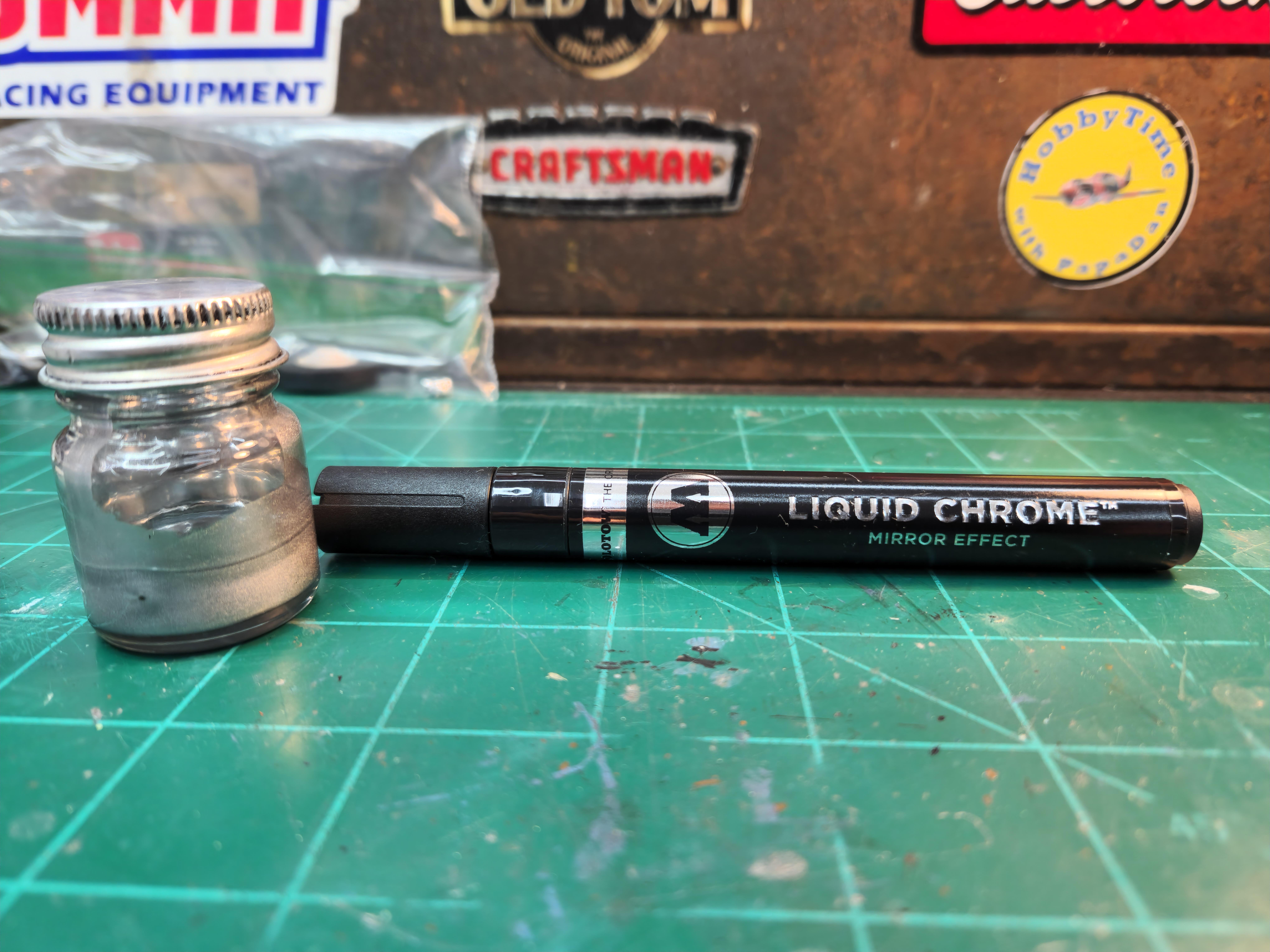

Mr. Metallic Posted November 28, 2022 Share Posted November 28, 2022 On 11/22/2022 at 6:36 PM, Joe Nunes said: Thanks, Leroy. Trouble is that I have never airbrushed anything...can't believe I admitted that!  When I get my spray booth and then vent it to the outdoors I will try out the airbrush. Should be REALLY interesting to say the least. Joe Airbrushing Molotow is not a requirement. I still recommend buying the refill bottle. It can be applied with very convincing results by hand brushing. Keep a wet edge on whatever you're "chroming", and plan to handle it as little as possible afterwards. I usually do my Molotow immediately before the final time i plan to touch that part. Quote Link to comment Share on other sites More sharing options...
StevenGuthmiller Posted November 28, 2022 Share Posted November 28, 2022 1 hour ago, Mr. Metallic said: and plan to handle it as little as possible afterwards. I usually do my Molotow immediately before the final time i plan to touch that part. This is just one of the reasons, (but one of the biggest) why I don’t use Molotow, and why I continue to try to warn people about it’s shortcomings. Personally, I can’t quite figure out how I could ever get the body and window trim chromed with Molotow with almost all of the final assembly finished. The way it is, I generally foil the trim WAY before I ever even get close to installing windows, interior, engine, chassis, etc. I would not only have the trim all smudged and dulled by the time I was finished, but I’d probably have half of it worn completely off!    Steve Quote Link to comment Share on other sites More sharing options...
lordairgtar Posted December 4, 2022 Share Posted December 4, 2022 There is an alternative ink from Flysea. Very similar to Molotow but has a more durable finish. I could handle it after a couple of hours without dulling. Â Quote Link to comment Share on other sites More sharing options...
