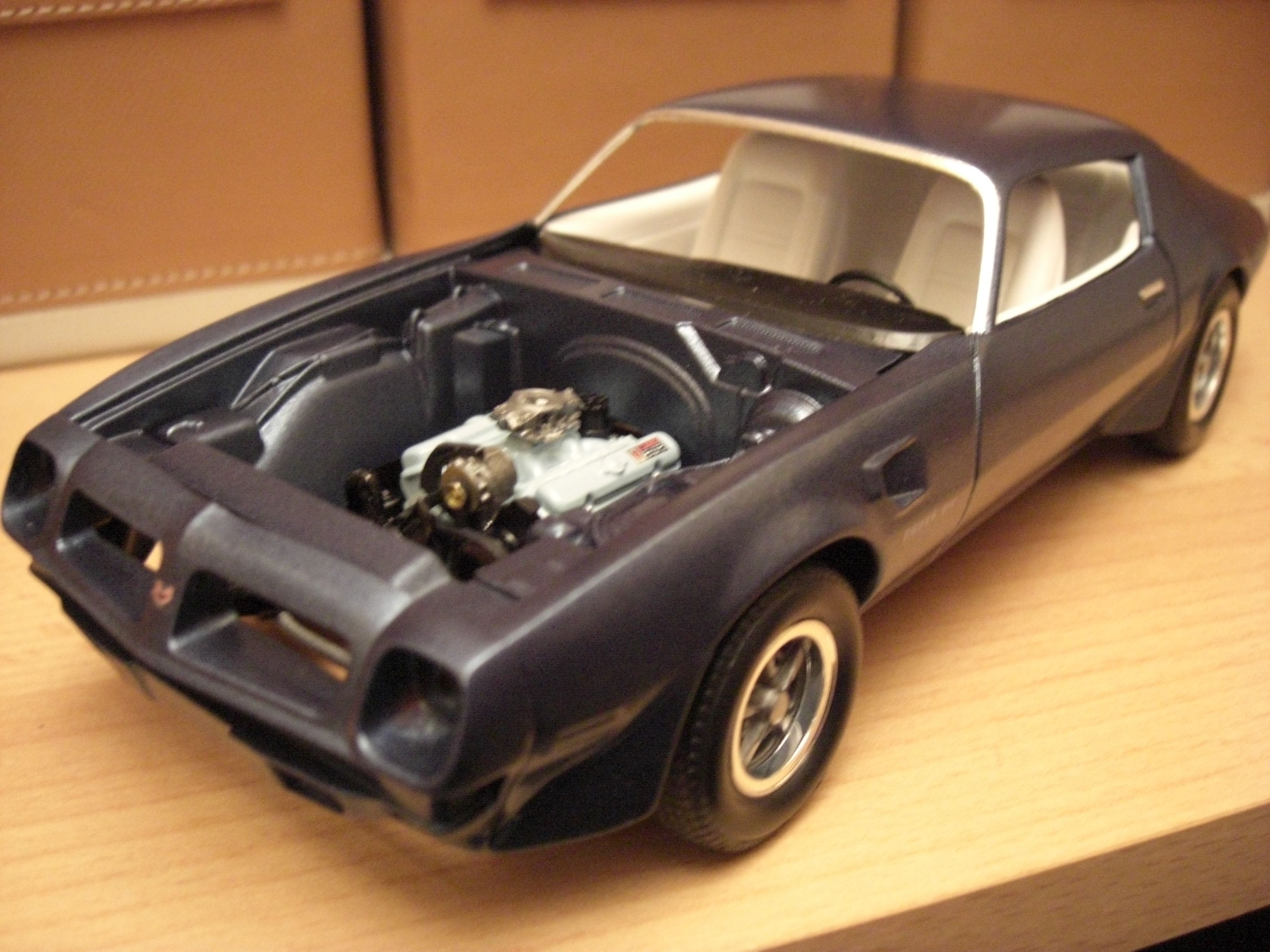

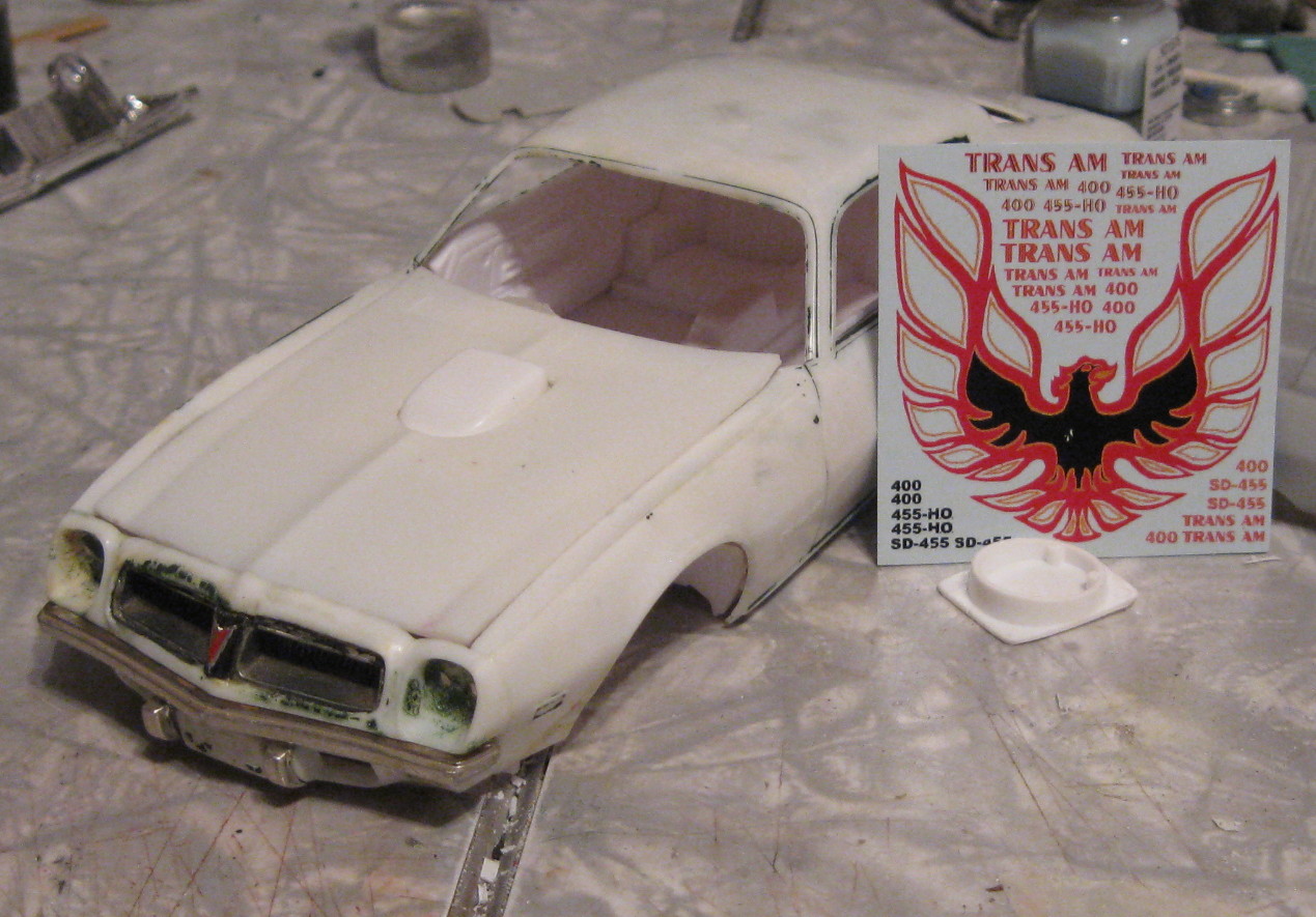

I've started the same kitbash,, almost ,, mine's a '74 but about the same involved.
Revell S&B chassis, etc.
Missing Link hood and scoop.
'74 MPC Firebird body.
I also got a set of decals from Keith Marks.
Only thing is the Revell kit was originally designed as a die-cast so the bottom is flared out a bit more than a plastic kit would be. That means a lot of grinding to get it to fit under the MPC body. I took a bit too much off the sides of mine but that can be easily fixed. The nose is tricky and I see I'll need to grind some off the back of the chassis plate too so the rear pan will fit better.
I really gotta get back to this one. ;)

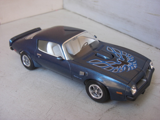

  • 3 years later...
On 12/17/2017 at 8:23 AM, Young iron said:
Here's the 1974 Super-Duty T/A I build years ago. I mixed a 1970 Revell and a 1974 Arii for the front fascia. To create a 1976, you should use most of the 1978 Revell Warbird, including the front bumper.
Missing link Resin also offers Honeycomb wheels.
What did you use or the '74 custom interior seats and door panels?
Link to comment
