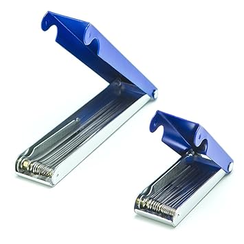

Ace-Garageguy Posted January 28, 2019 Posted January 28, 2019 (edited) Recently I've been doing a lot of model work that requires precisely located holes. Sometimes, being even a few thousandths of an inch off from where a hole needs to be can adversely affect a model's outcome. For this reason, depending on the accuracy required and the size of the hole, I'll often drill a pilot hole under-size, and if the center has drifted, I'll move it back into place with a tiny file, then re-bore it with the final size bit. It's also sometimes necessary to enlarge a molded-in opening in a part, where conventional needle files are too big. I find that oxy-acetylene welding torch tip-cleaner files work beautifully for this. They're made of material that's hard enough to hold up to styrene indefinitely. The one on my model bench is a cheap Chinese piece, with 13 diameters ranging from .018" up to .069". Edited January 28, 2019 by Ace-Garageguy
stitchdup Posted January 28, 2019 Posted January 28, 2019 Great tip, I can see them having other uses too. Thanks for sharing

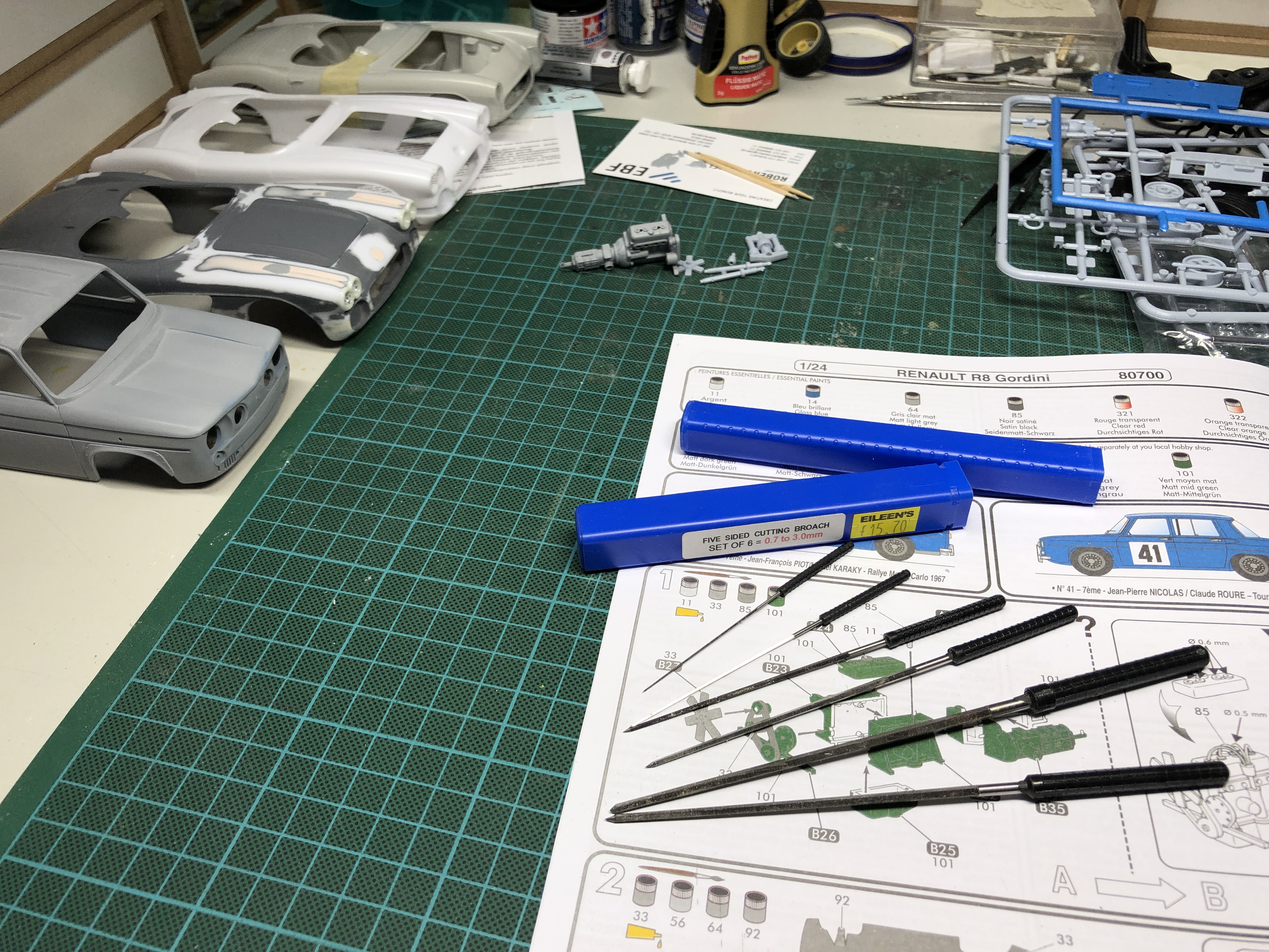

Casey Posted January 28, 2019 Posted January 28, 2019 47 minutes ago, Ace-Garageguy said: It's also sometimes necessary to enlarge a molded-in opening in a part, where conventional needle files are too big. Bead reamers will work for enlarging holes, too, but they have a larger taper than a metal working reamer would: Not sure if there is a such a thing as a micro reamer, similar to needle files?
hguenth2003 Posted January 29, 2019 Posted January 29, 2019 On 28.1.2019 at 7:13 PM, Casey said: Not sure if there is a such a thing as a micro reamer, similar to needle files? There is. I have a set of 6 from 0.7 to 3mm. Bought it long ago from Eileen‘s in UK.
Belugawrx Posted January 29, 2019 Posted January 29, 2019 32 minutes ago, hguenth2003 said: There is. I have a set of 6 from 0.7 to 3mm. Bought it long ago from Eileen‘s in UK. Thanks for the heads up,..I'll check out the jewellers tool sites
Straightliner59 Posted January 29, 2019 Posted January 29, 2019 Good stuff, Bill. I've had a set of those reamers in my drawer for years, for just such purposes. They are great!
Casey Posted January 29, 2019 Posted January 29, 2019 Here's a larger image, showing the reamers up close:
