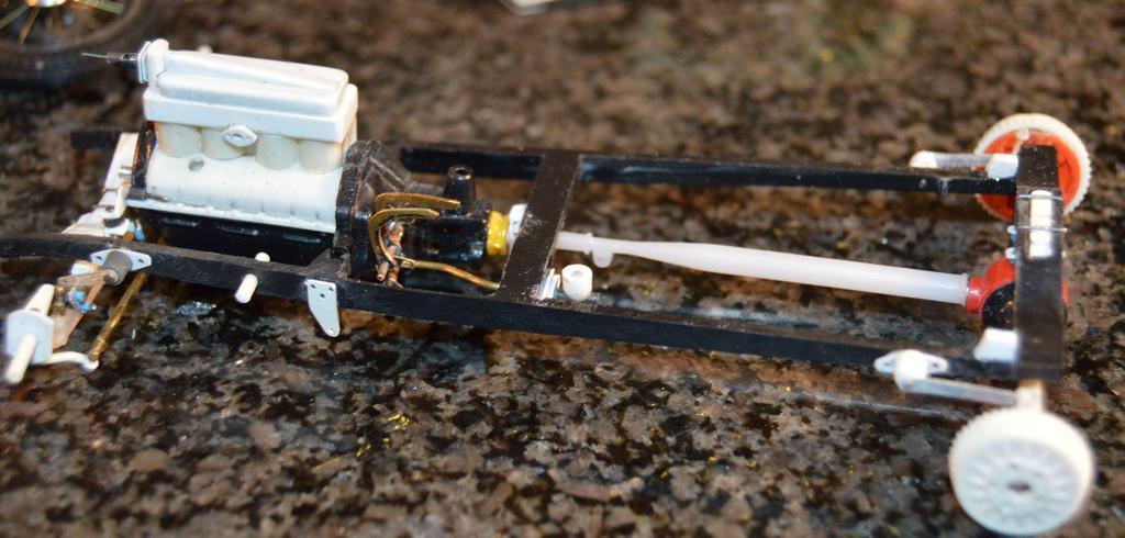

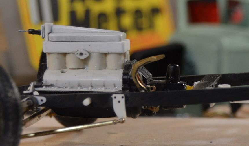

Straightliner59 Posted April 21, 2020 Author Share Posted April 21, 2020 After finishing up the Firebird, I finally got back to work on this. I needed to make sure the pedals and arms and levers, and all that stuff would clear each other, so I white glued it all together, along with the master cylinder and the brake pushrod. It looks like it'll all work, so I can finish tacking the suspension back together. I also need to see if I can find a set of brakes for the front. If I can find some I like, I will use them. Otherwise I'll go suicide style! As always, critiques, questions and comments are always welcome. Thanks for looking! Quote Link to comment Share on other sites More sharing options...

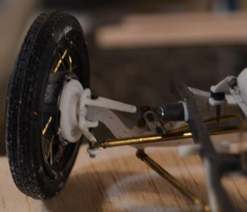

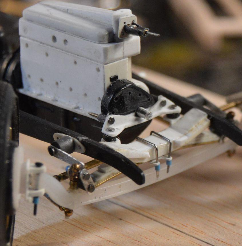

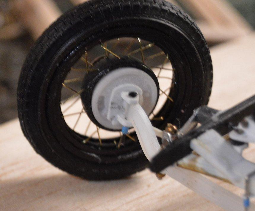

Straightliner59 Posted April 26, 2020 Author Share Posted April 26, 2020 I found some front brake backing plates I really liked--even better than without them. Then, when I was working on them, I messed one up. I'm not sure where they came from, but I am reasonably sure I don't have any more. I ended up fixing one, the making a mold and casting a pair. They can be seen in these photos. They aren't properly oriented, yet, because at some point, this entire assembly will be dismantled. However, i now know that all the major components fit to, and with the chassis. I think that next, I will open a hole in the floor, for the master cylinder cap. It's kinda starting to look like a hot rod! I am kind of leaning toward something like Royal Blue, or Navy Blue for the body, when the time comes, but, definitely not sold on it. As always, thanks for looking! Questions, comments,and critiques are always welcome! Quote Link to comment Share on other sites More sharing options...

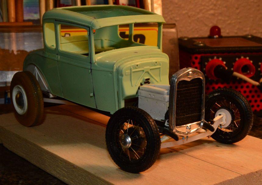

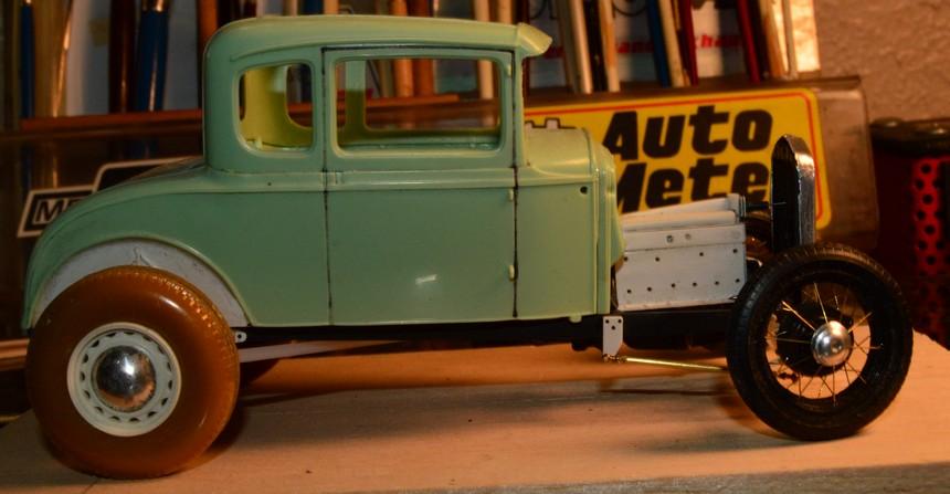

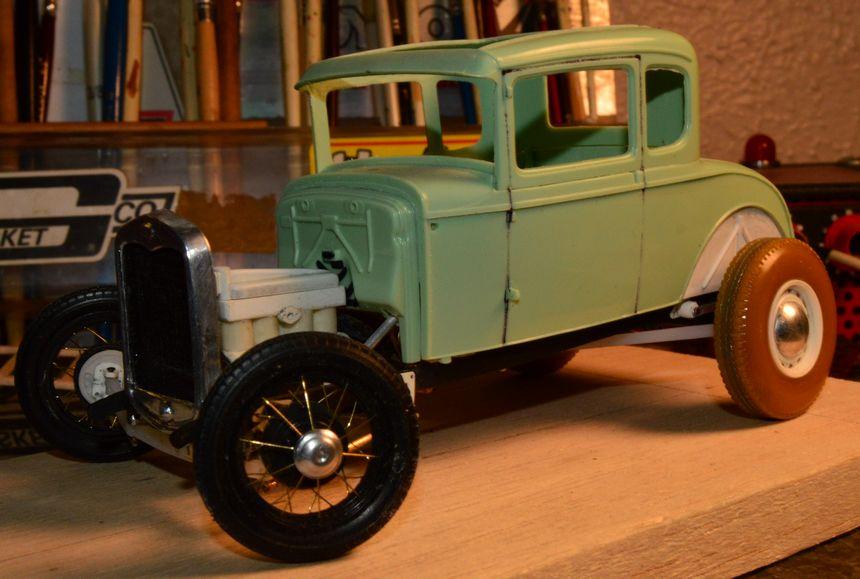

Straightliner59 Posted April 26, 2020 Author Share Posted April 26, 2020 I couldn't help but to see how it looks with the body on, again...the radiator is just tacky-glued into place. Thus, the lean. Quote Link to comment Share on other sites More sharing options...

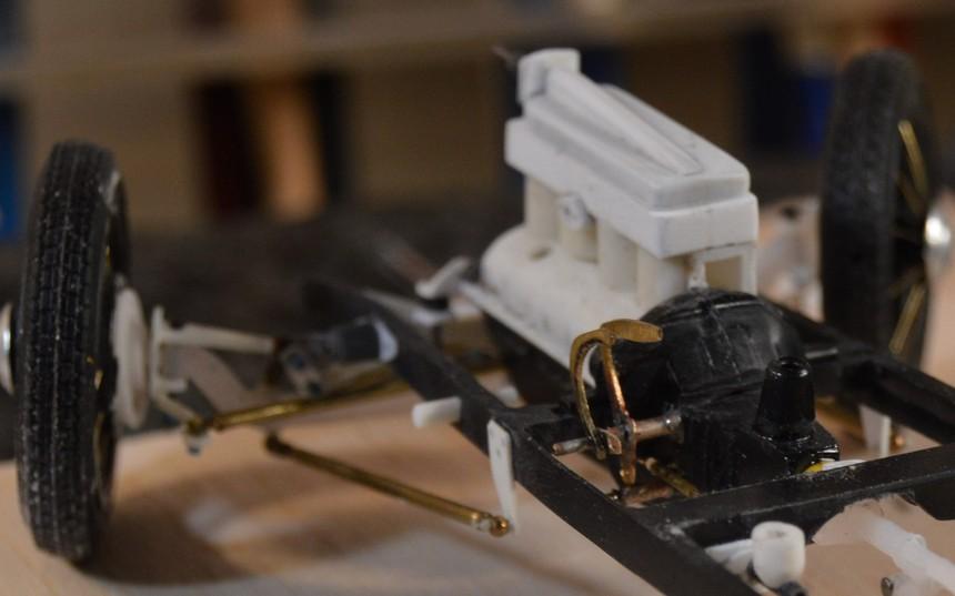

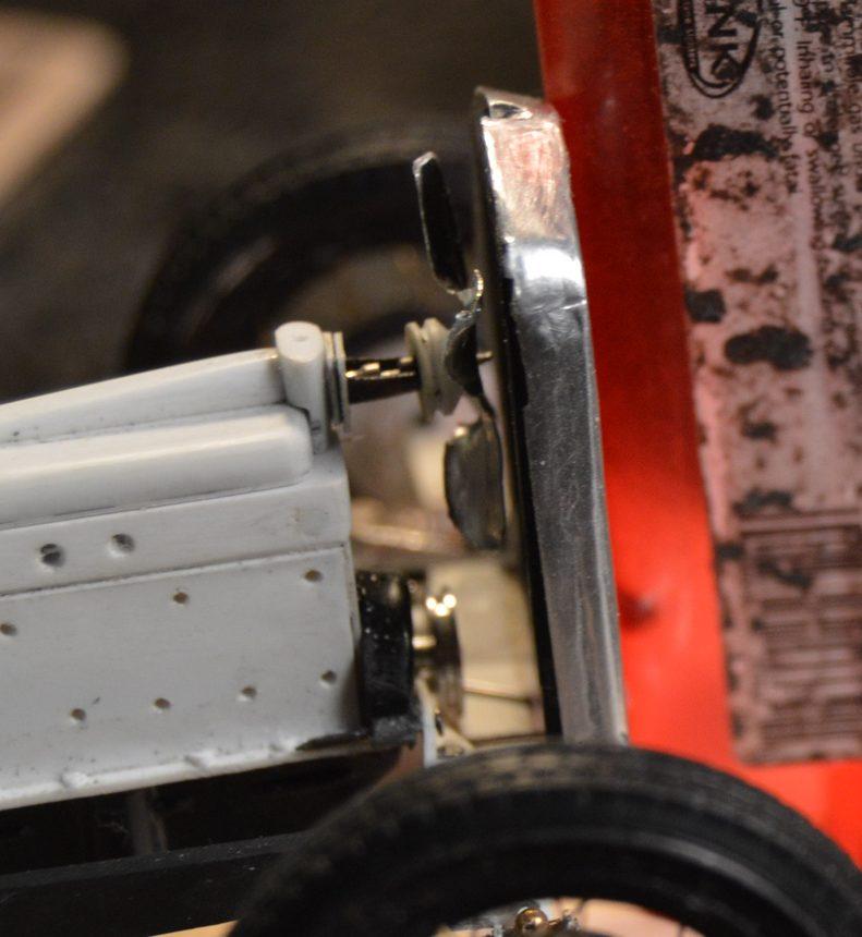

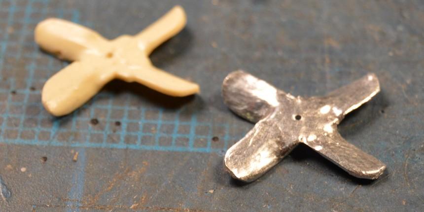

Straightliner59 Posted April 28, 2020 Author Share Posted April 28, 2020 I made a pulley and a fan. The pulley is from Plastruct rod. I made the fan from tooling aluminum. There's still a lot of trimming and cleanup to do on it, but, at least it will be nice and thin. The main reason for making this stuff, is so that I could check clearance between the fan, and the radiator. As can be seen, it's just right! Whew! I was afraid that might be an issue. Quote Link to comment Share on other sites More sharing options...

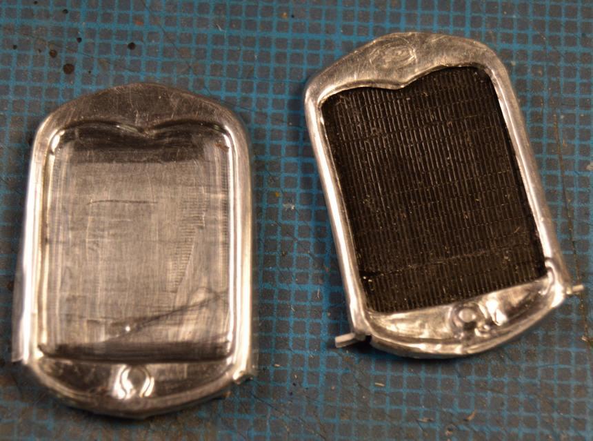

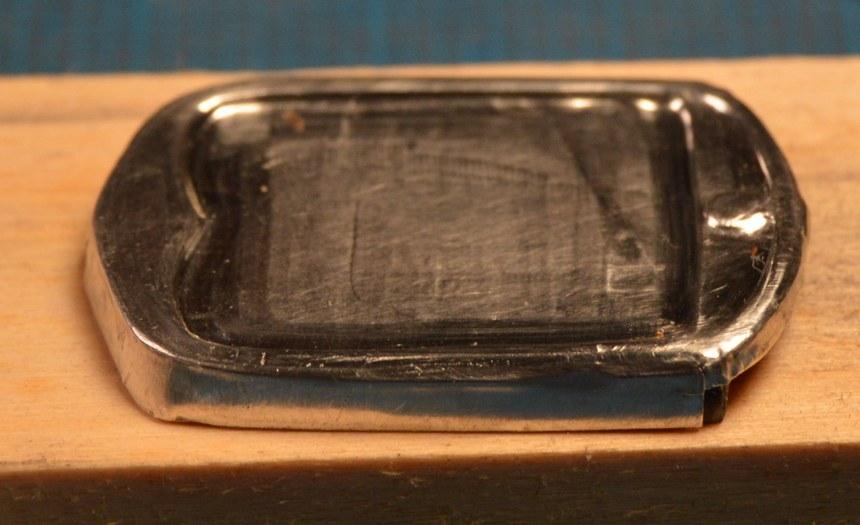

Straightliner59 Posted May 3, 2020 Author Share Posted May 3, 2020 (edited) On 4/28/2020 at 6:09 AM, David G. said: Still watching, still amazed! David G. Thanks, David. Glad you're liking it! On 4/28/2020 at 6:14 AM, James2 said: I quit... There's no need, for that! ? For the last couple of days, I've been playing around, making a new, improved grille shell. I think the new one (the one that isn't opened up, yet) is looking much better than the original. I'm using Maid-O-Metal 36 ga. tooling aluminum, and forming it over the kit piece. I glued some sticks together, to fill the void on the back side of the kit's radiator/grille shell. This time, before beginning the great rub-down, I sanded the Ford badge from the shell. I found some elliptical punches online that will be small enough to use to make a new one, with printed enameling. It's not difficult, at all to do this, it just takes some patience to develop a rapport with the metal. These photos show the old shell and the new one, alongside each other. The lines and details are much crisper, now. I have some of Detail Master's radiator mesh, to sandwich whatever I decide to fill it with. Critiques, questions and comments are always welcome! Thanks for looking! Edited May 3, 2020 by Straightliner59 Quote Link to comment Share on other sites More sharing options...
AmericanMuscleFan Posted May 3, 2020 Share Posted May 3, 2020 Great craftsmanship Daniel! That grille shell is sensational and the utilisation of that unknown product to me (Made-OF-Metal) is pure genius. This is what I love so much on this forum... sharing good tricks and it's a really good one! Can't wait to see it finished but take your time, every update is a treat!!! Quote Link to comment Share on other sites More sharing options...
Straightliner59 Posted May 3, 2020 Author Share Posted May 3, 2020 22 minutes ago, AmericanMuscleFan said: Great craftsmanship Daniel! That grille shell is sensational and the utilisation of that unknown product to me (Made-OF-Metal) is pure genius. This is what I love so much on this forum... sharing good tricks and it's a really good one! Can't wait to see it finished but take your time, every update is a treat!!! Thank you, Francis. I really appreciate it, coming from as fine a craftsman as yourself. I use that tooling aluminum, A LOT! it's very versatile, and easy to work with. Below are a few examples of things I've done with it: This is just a piece of it, rolled around a plastic tube. Of interest, here, is the "weld seam". It was created by using a straightedge to guide a ball-ended stylus over a cutting mat with a harder, pebbled surface, thus creating the texture in the metal. Next is a fan I'm fiddling with for this project. Simply burnished over the kit part, alongside. I made both the front and rear hubcaps for this project. I used various sizes of tubing as dies, to create the contours. I used it to make the splash pans for this '34 coupe. While it's not best suited for it, all but the nose and tail sections of this body is built with Maid-O-Metal. Quote Link to comment Share on other sites More sharing options...

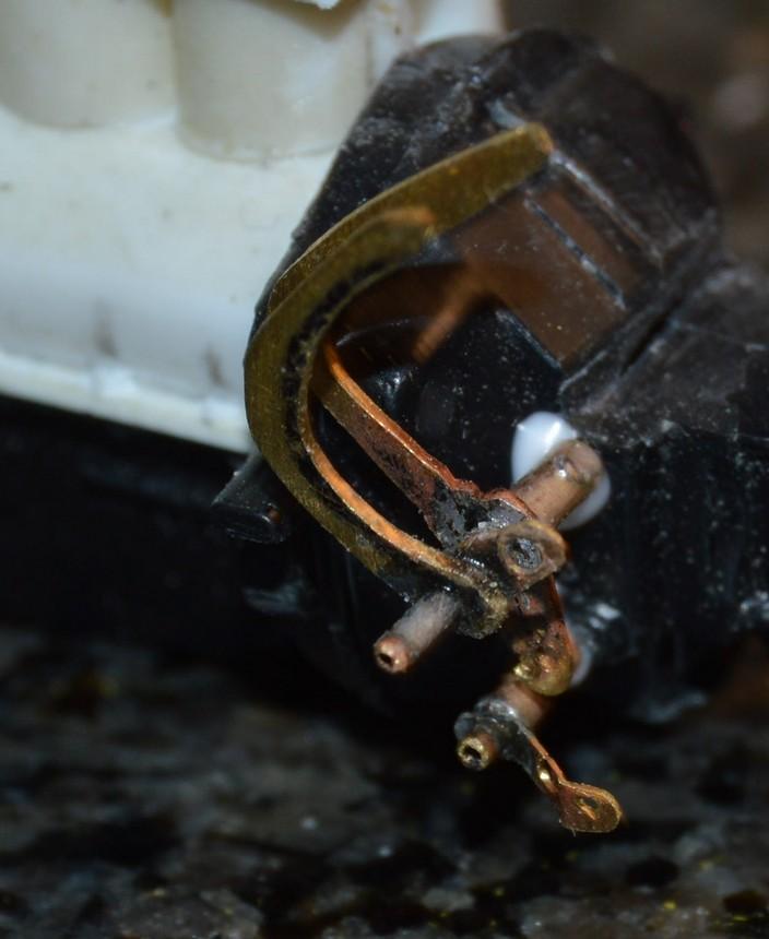

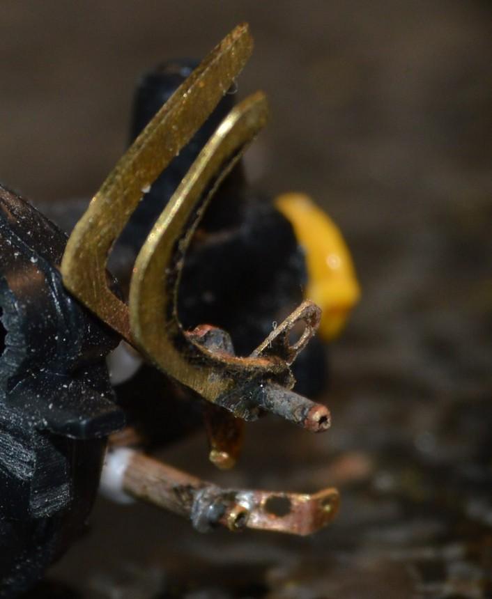

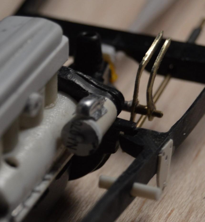

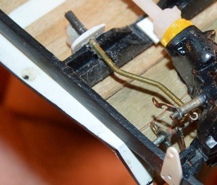

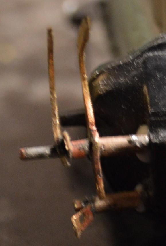

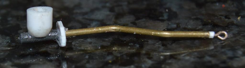

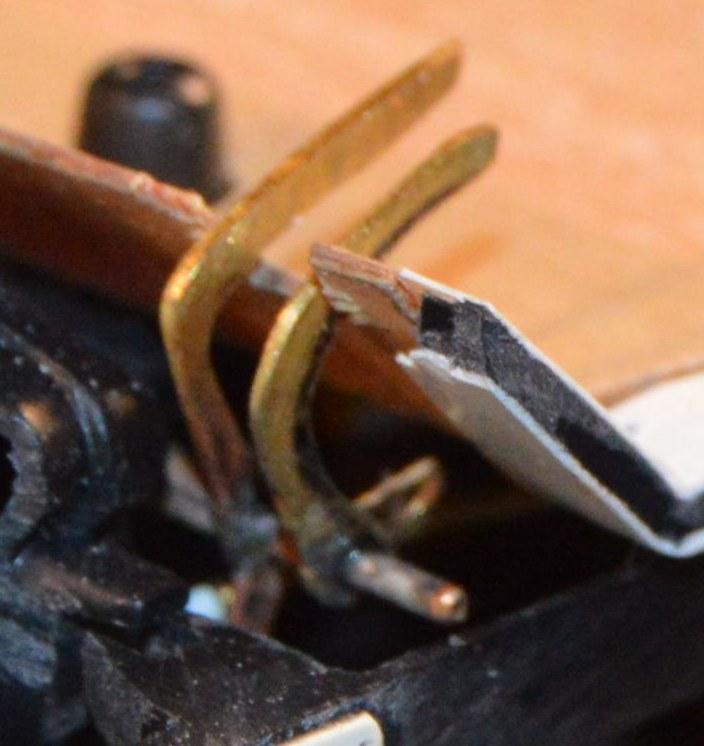

Straightliner59 Posted May 3, 2020 Author Share Posted May 3, 2020 I used parts of two photo-etched hinges to make this gate hinge throttle pedal, and some .040"X.080" Evergreen strip and some nichrome wire to make the arm that would rotate the rod running across the inside of the firewall, where the throttle linkage to the engine would attach. Except, there will only be these pieces, and the linkage running toward the carbs, exiting the firewall, somewhere behind the carbs. I feel like I might be close to the point of taking this all apart, and preparing it for paint and detailing, and reassembly. Quote Link to comment Share on other sites More sharing options...
AmericanMuscleFan Posted May 3, 2020 Share Posted May 3, 2020 Thanks again for sharing Daniel! Do you stick the Maid-O-Metal with epoxy or super glue or you just wrap it around the parts? You're a hell of a builder my friend and you ingenuity seem endless!!! Quote Link to comment Share on other sites More sharing options...
