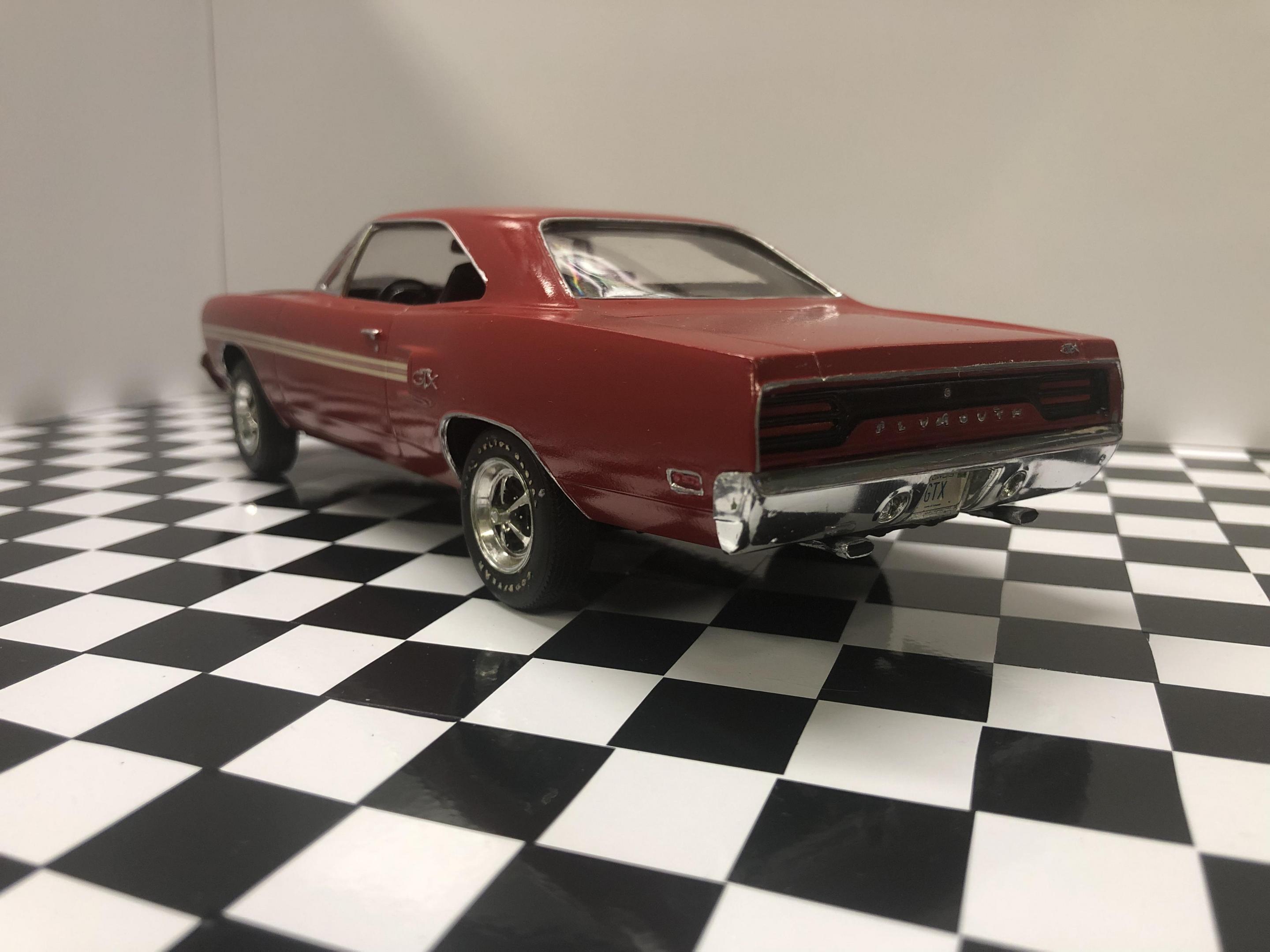

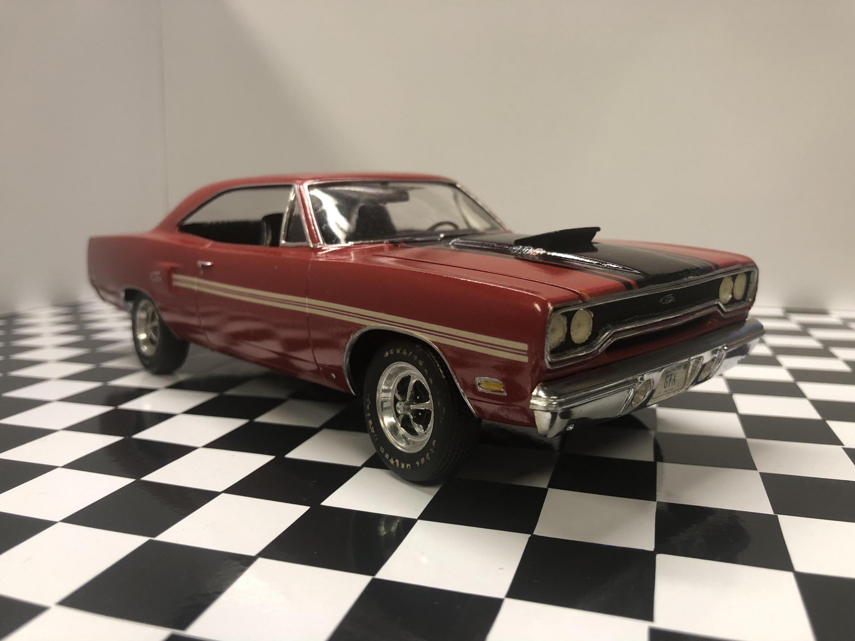

SCRWDRVR Posted January 11, 2020 Share Posted January 11, 2020 I have a 1mm 2mm and 3mm and almost always use the 2mm. I will use the 1mm in corners the 2 is to big for and the 3mm for bumpers and such. This GTX is a rehab of a kit I originally built 20+ years ago, all the chrome on it is from a molotow pen even the bumpers... The wetter you apply it the better it looks and do it last it’s not handling friendly Quote Link to comment Share on other sites More sharing options...
VanSpence Posted January 11, 2020 Share Posted January 11, 2020 11 hours ago, SCRWDRVR said: I have a 1mm 2mm and 3mm and almost always use the 2mm. I will use the 1mm in corners the 2 is to big for and the 3mm for bumpers and such. This GTX is a rehab of a kit I originally built 20+ years ago, all the chrome on it is from a molotow pen even the bumpers... The wetter you apply it the better it looks and do it last it’s not handling friendly Those bumpers look great. Impressive to see what these pens can do. Quote Link to comment Share on other sites More sharing options...
Jiminwatford Posted January 11, 2020 Author Share Posted January 11, 2020 12 hours ago, SCRWDRVR said: I have a 1mm 2mm and 3mm and almost always use the 2mm. I will use the 1mm in corners the 2 is to big for and the 3mm for bumpers and such. This GTX is a rehab of a kit I originally built 20+ years ago, all the chrome on it is from a molotow pen even the bumpers... The wetter you apply it the better it looks and do it last it’s not handling friendly How did you maintain a neat edge? Was it all freehand? Quote Link to comment Share on other sites More sharing options...

SCRWDRVR Posted January 11, 2020 Share Posted January 11, 2020 7 hours ago, Jiminwatford said: How did you maintain a neat edge? Was it all freehand? Yes all free hand, I practiced on some old kits to get used to the tip and the way it flows. Quote Link to comment Share on other sites More sharing options...
