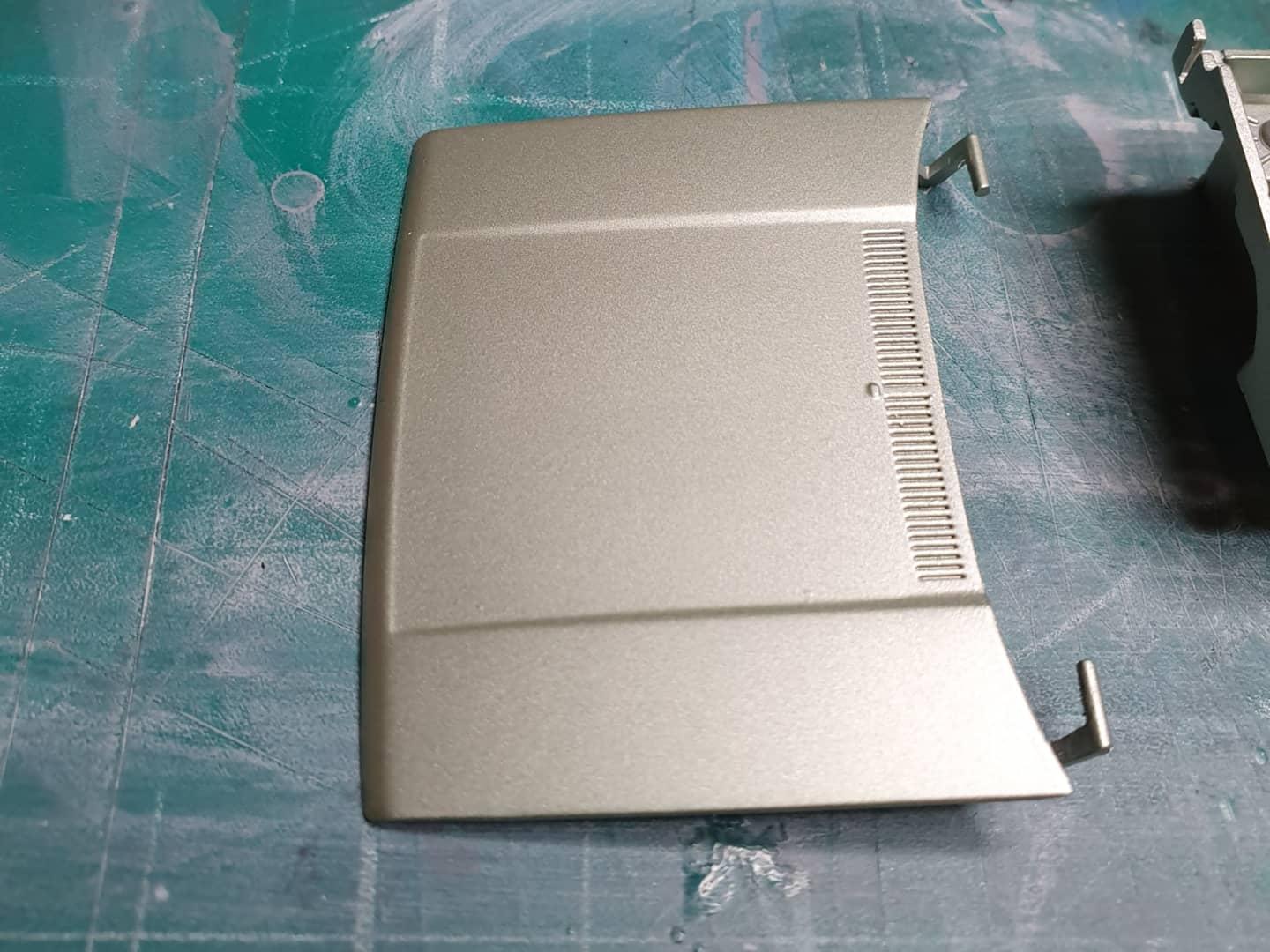

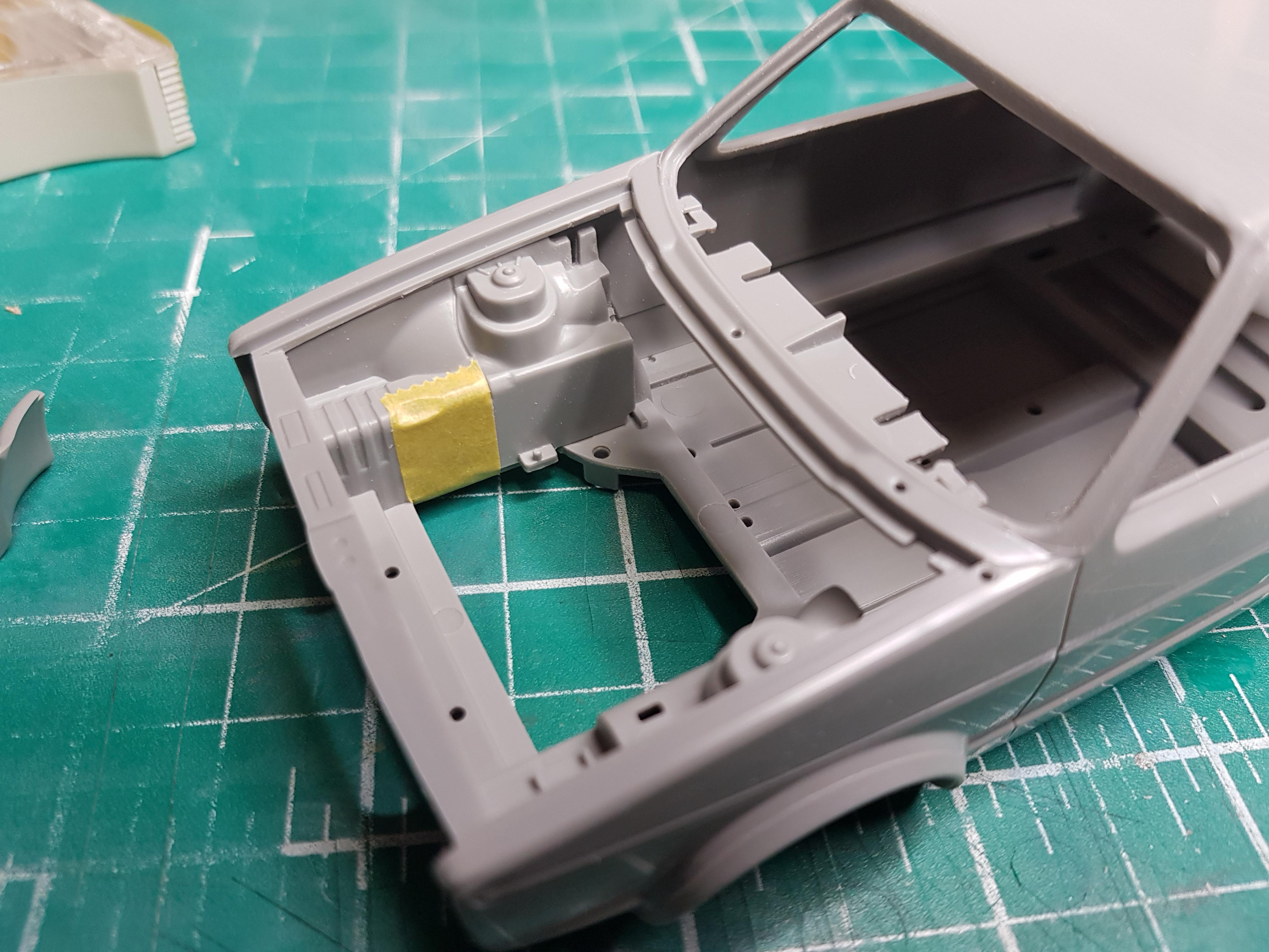

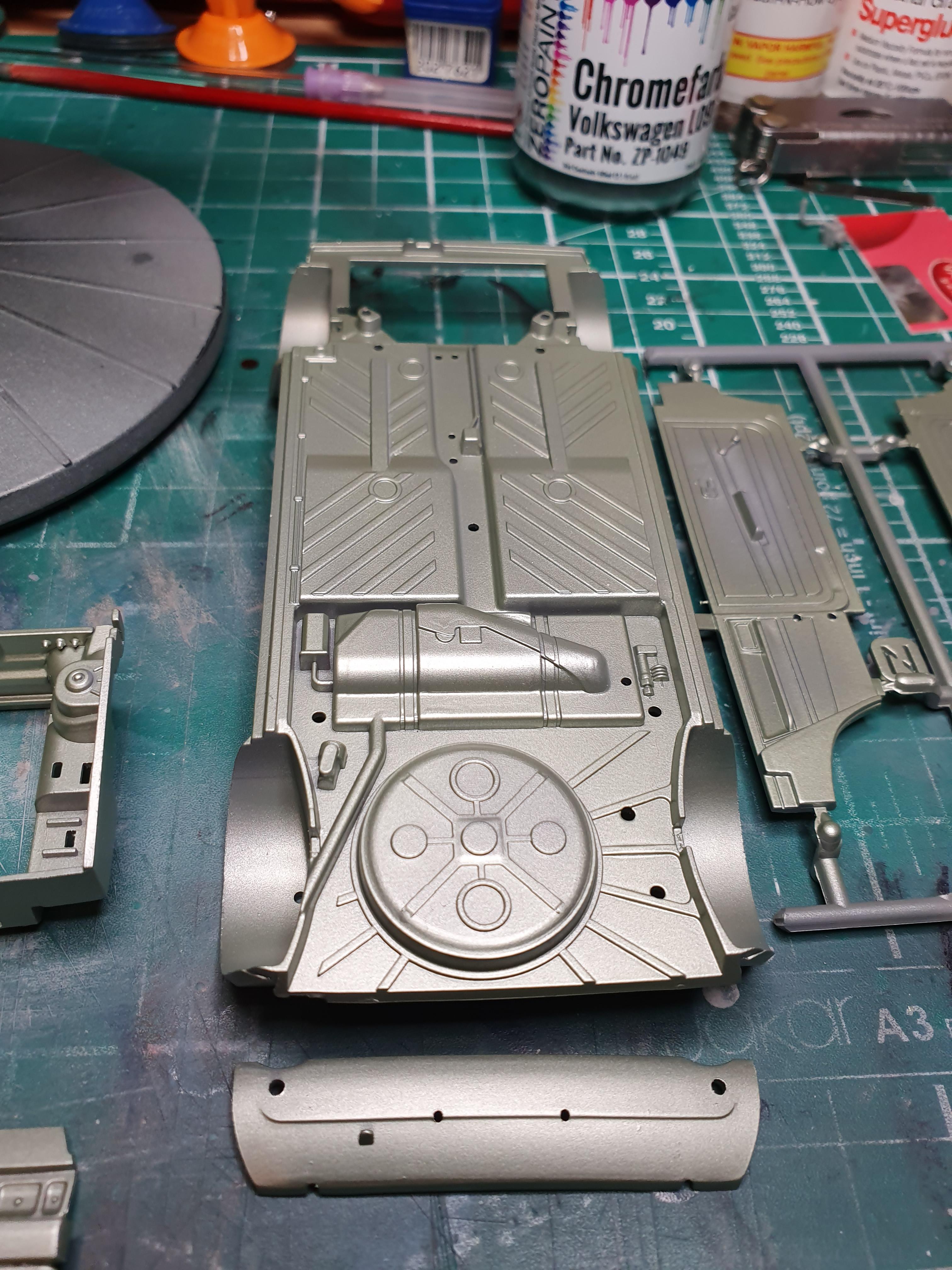

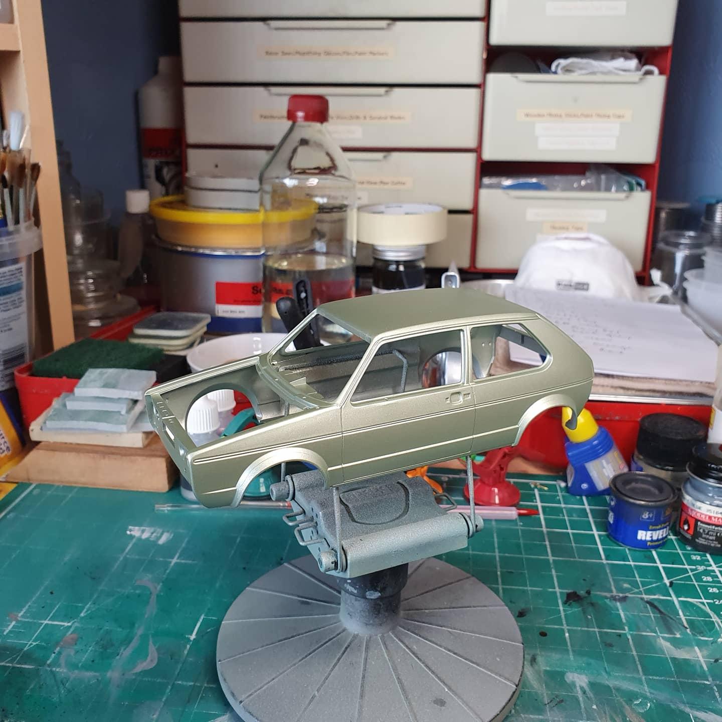

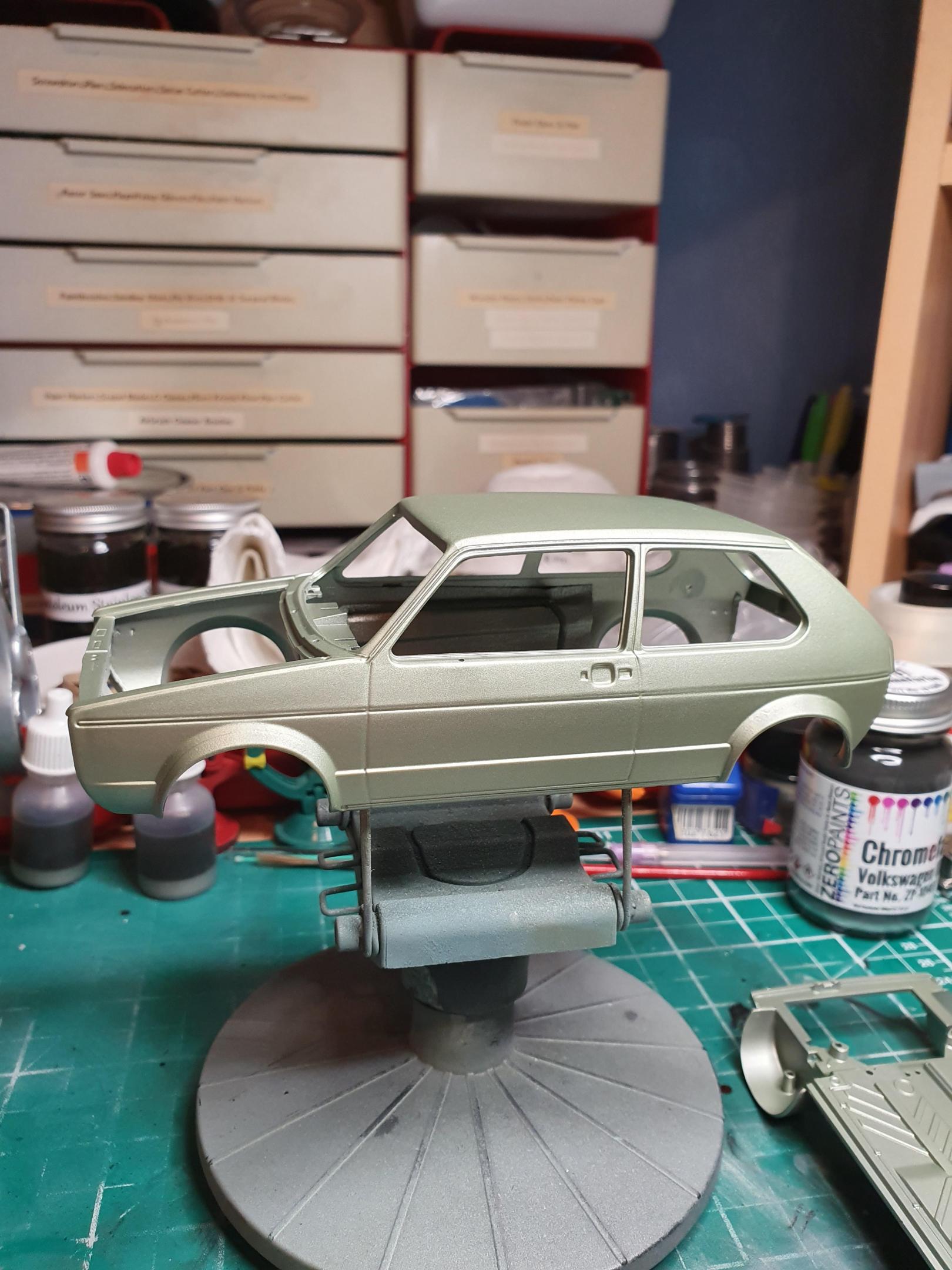

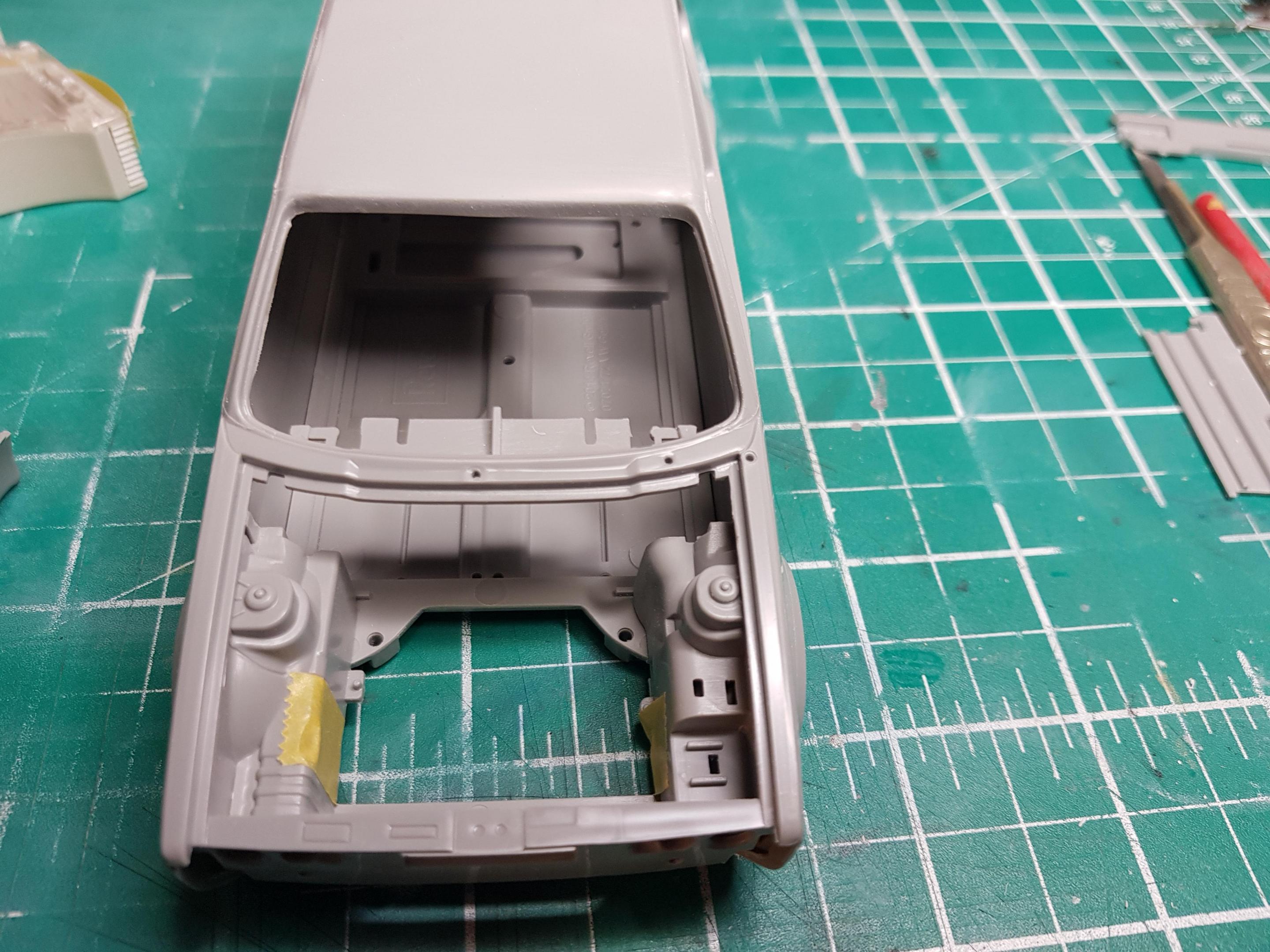

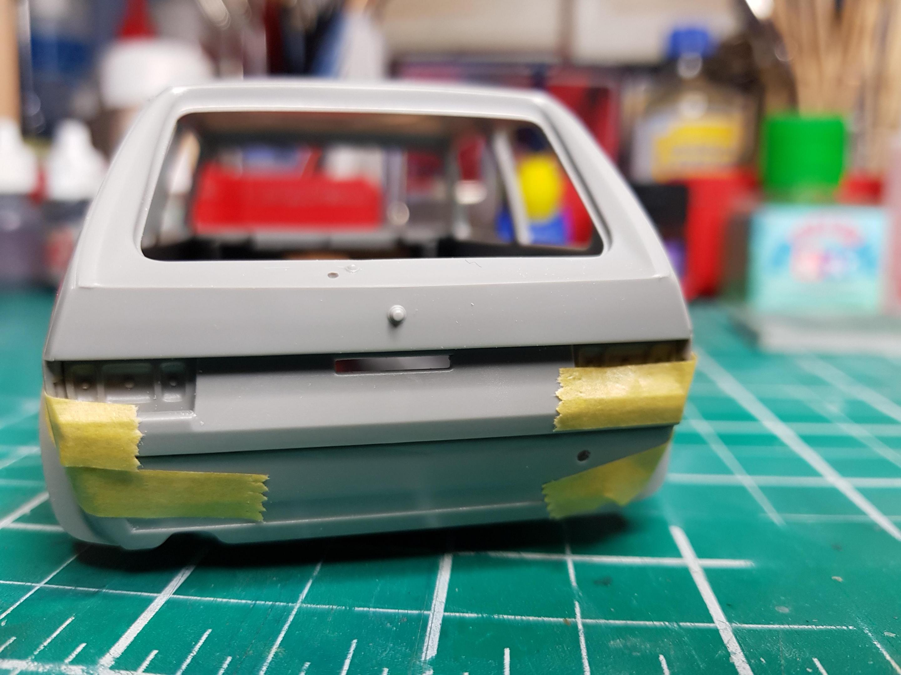

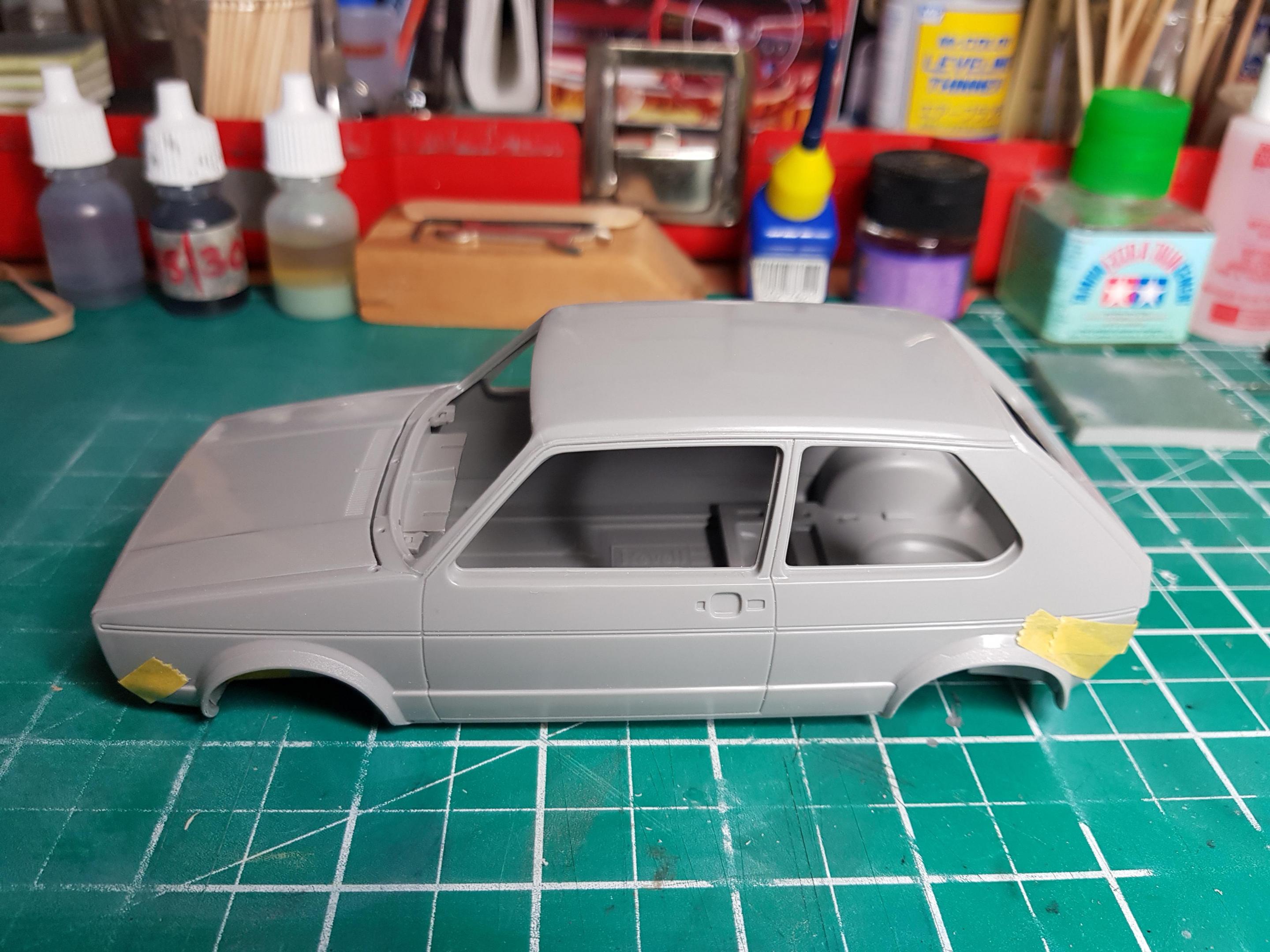

I started this one last year, but work and a move to London took over my life, (Hopefully we'll get back down there very soon) I got as far as getting the body and body parts ready for primer and ordering the paint from Zero paints, most version of this model I've seen built up have all been the most common colours the GTi came in, Black, Mars red or silver, I decided to go with a totally different colour called Inari silver, which looks more of a metallic light green that a silver, so with the country pretty much on lockdown and all my photography work put on hold, I decided yo make a start on this one, the body was primed using my go to primer, grey plastic primer from Hycote, once it had dried out for a few days, it was lightly sanded and the basecoat applied, this is only second time I have used basecoat paints, the first being the Revell Land Rover i'm also building atm.

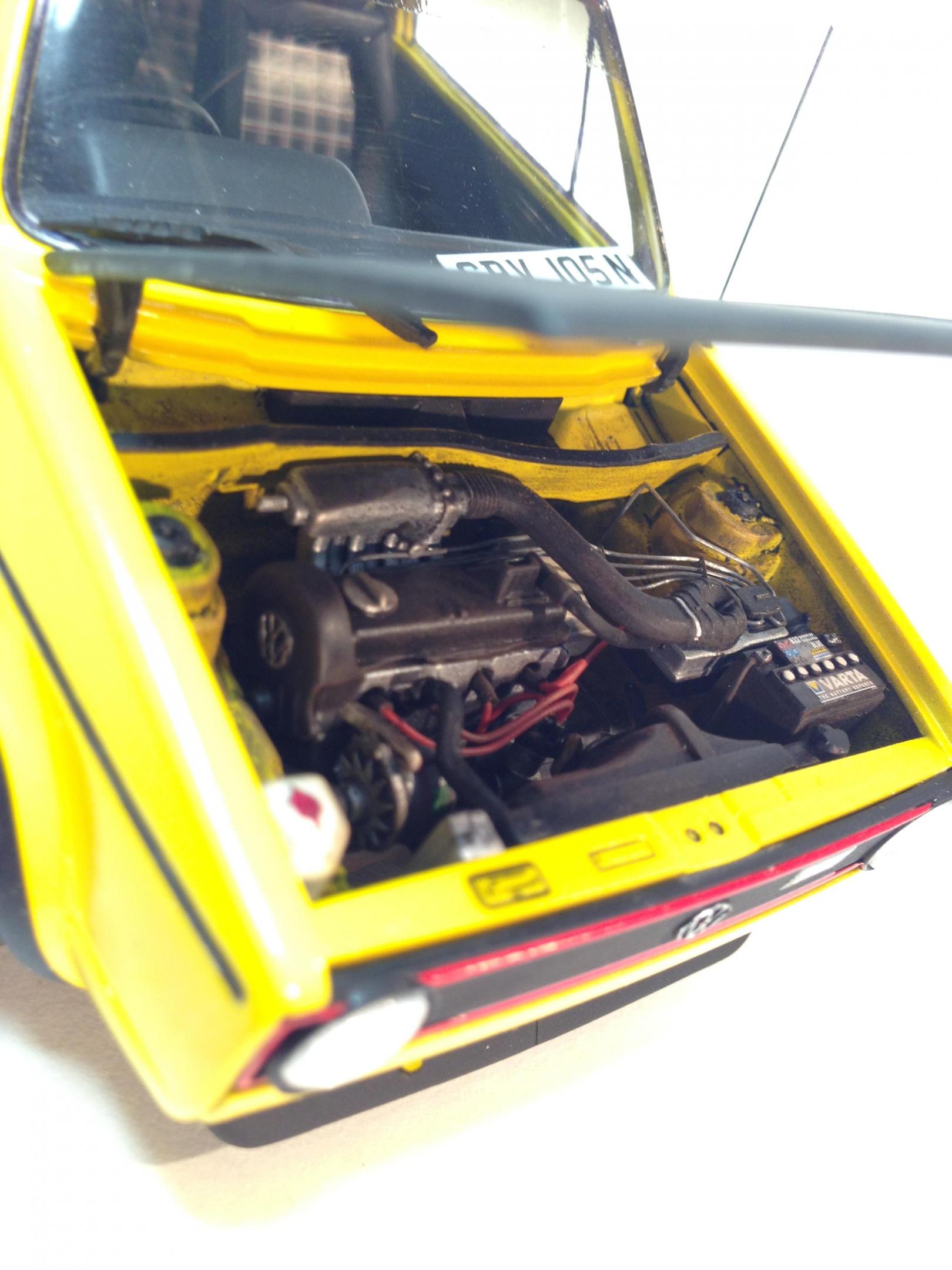

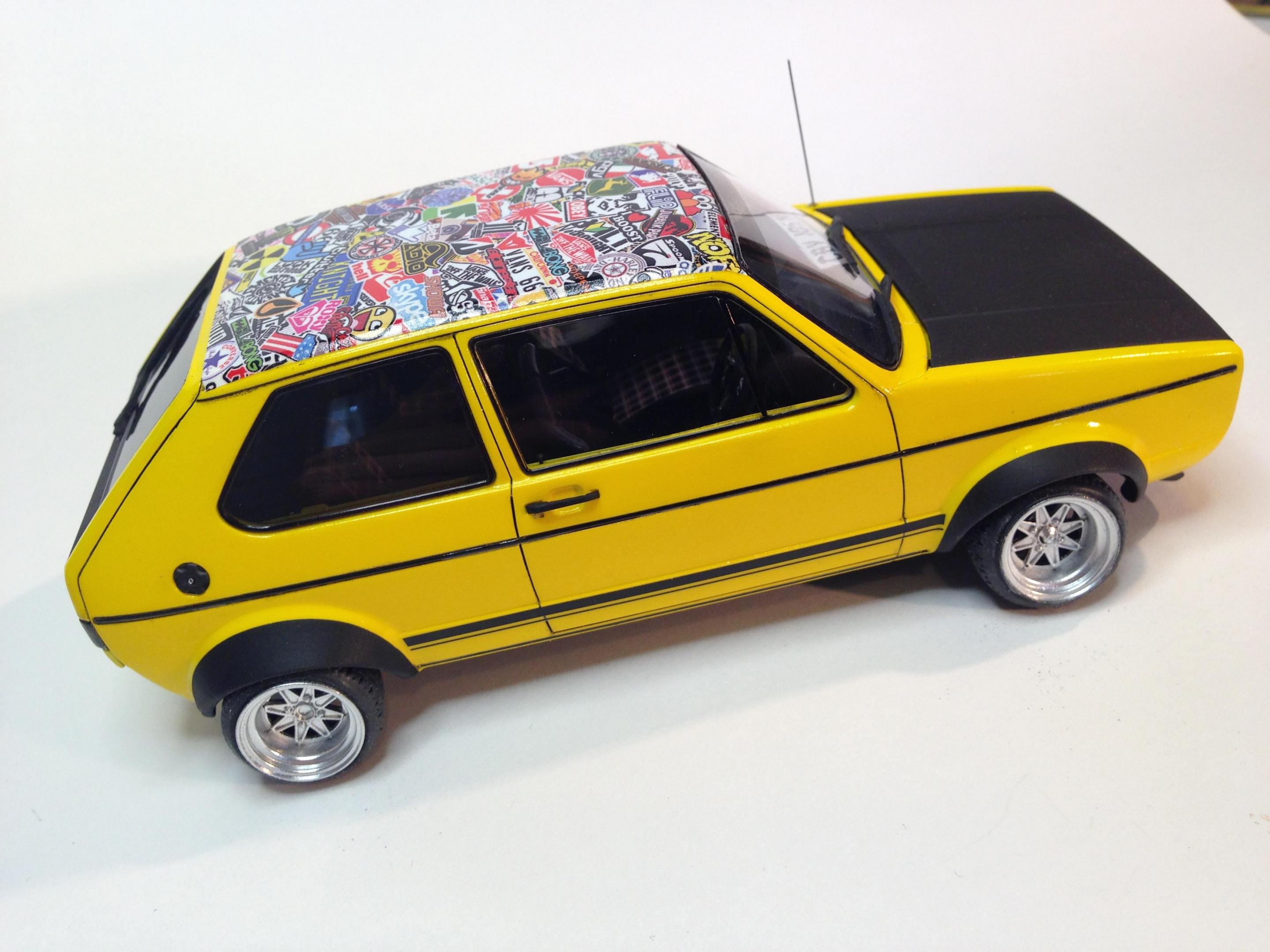

here's my version, with aftermarket wheels and a bit of extra detail

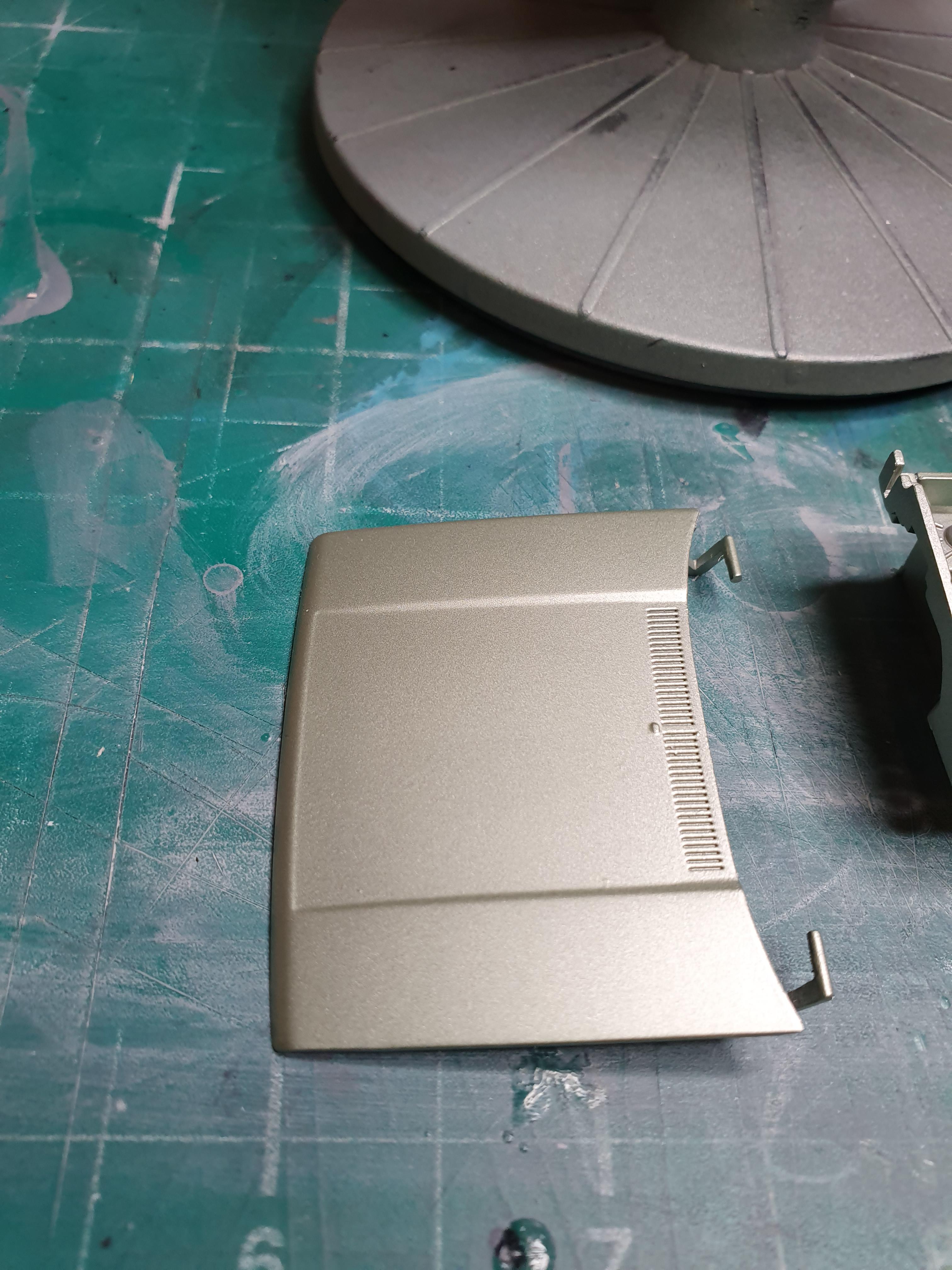

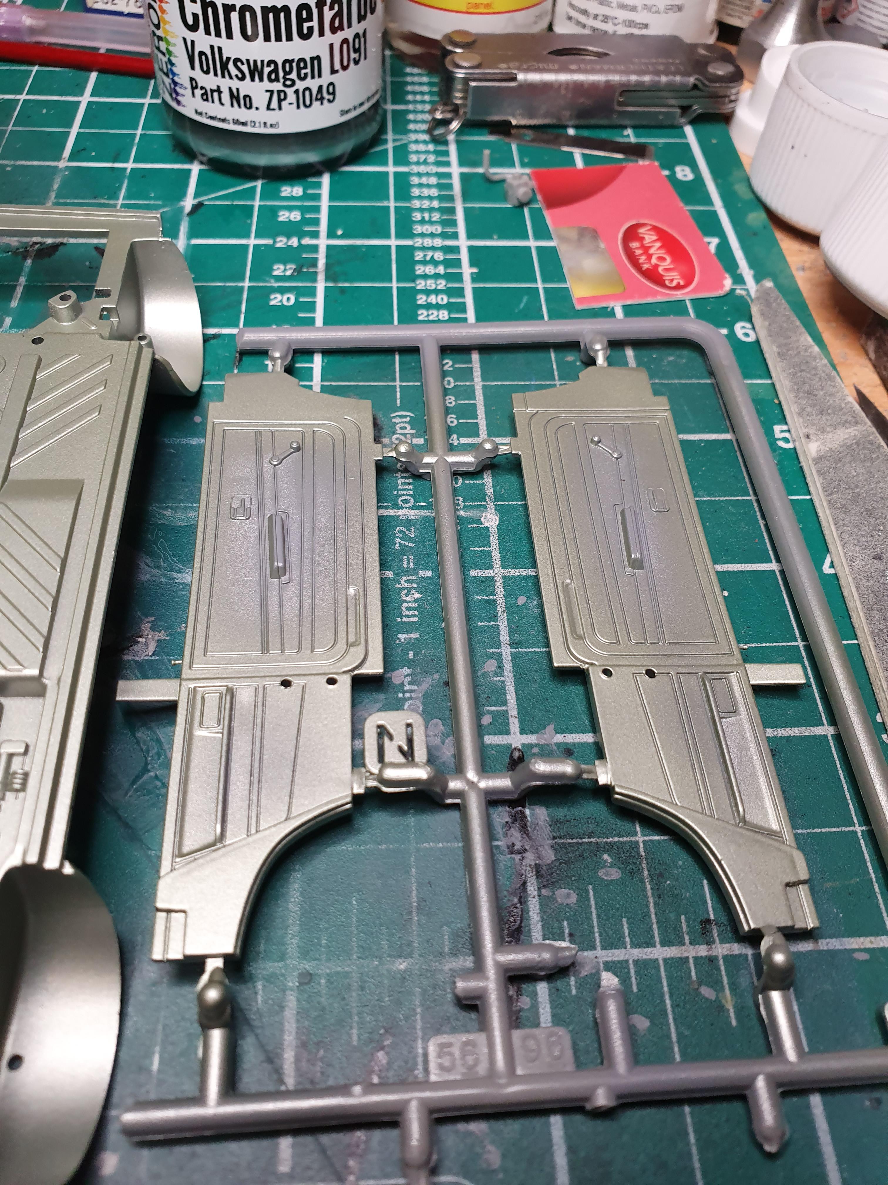

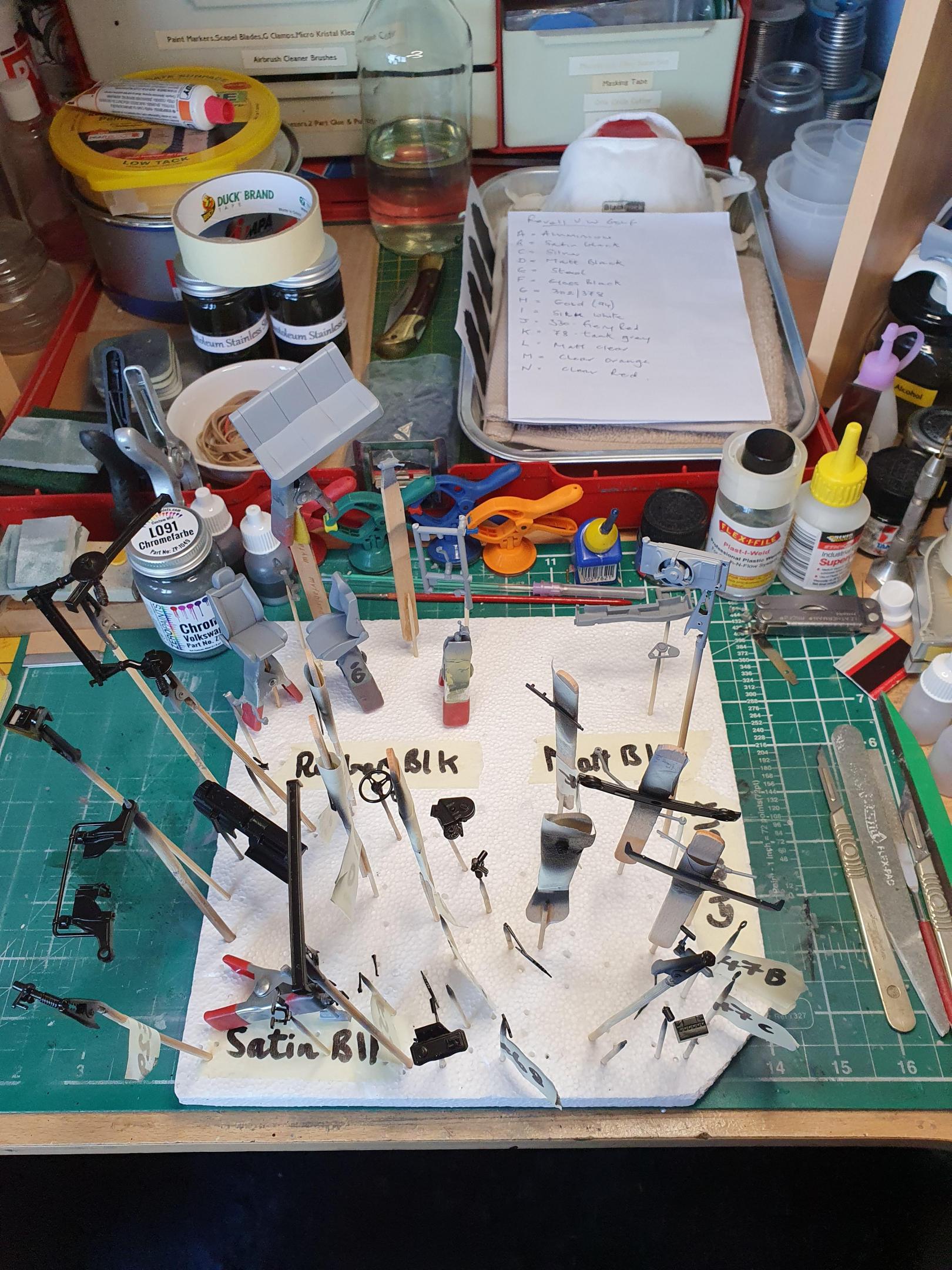

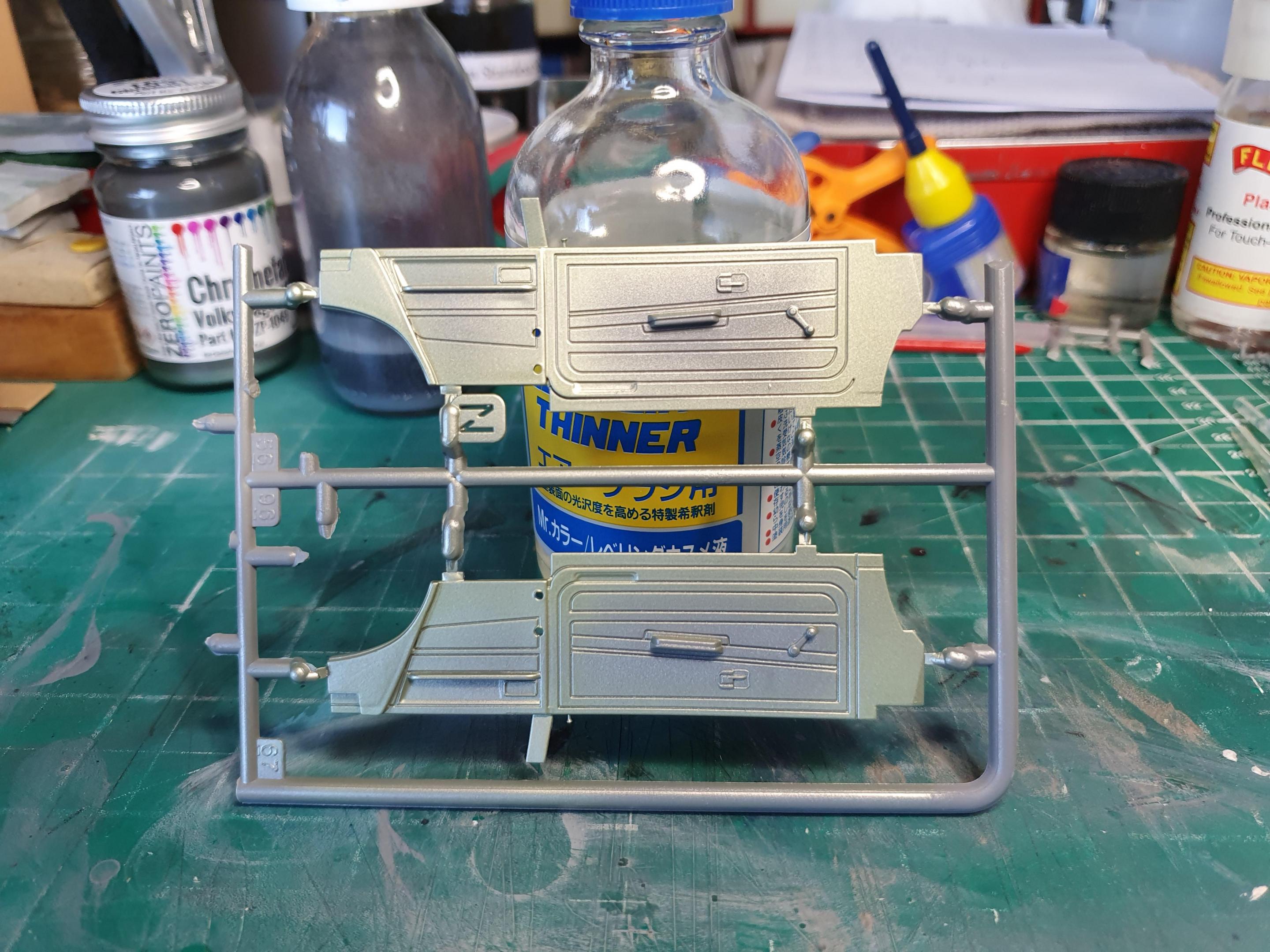

Still too cold in the painting room to get any clearcoat applied, so decided to get the wheels painted for the Golf GTi, VW L091 is the correct colour for VW wheels until 1993, the actual year i stopped working for Volkswagen

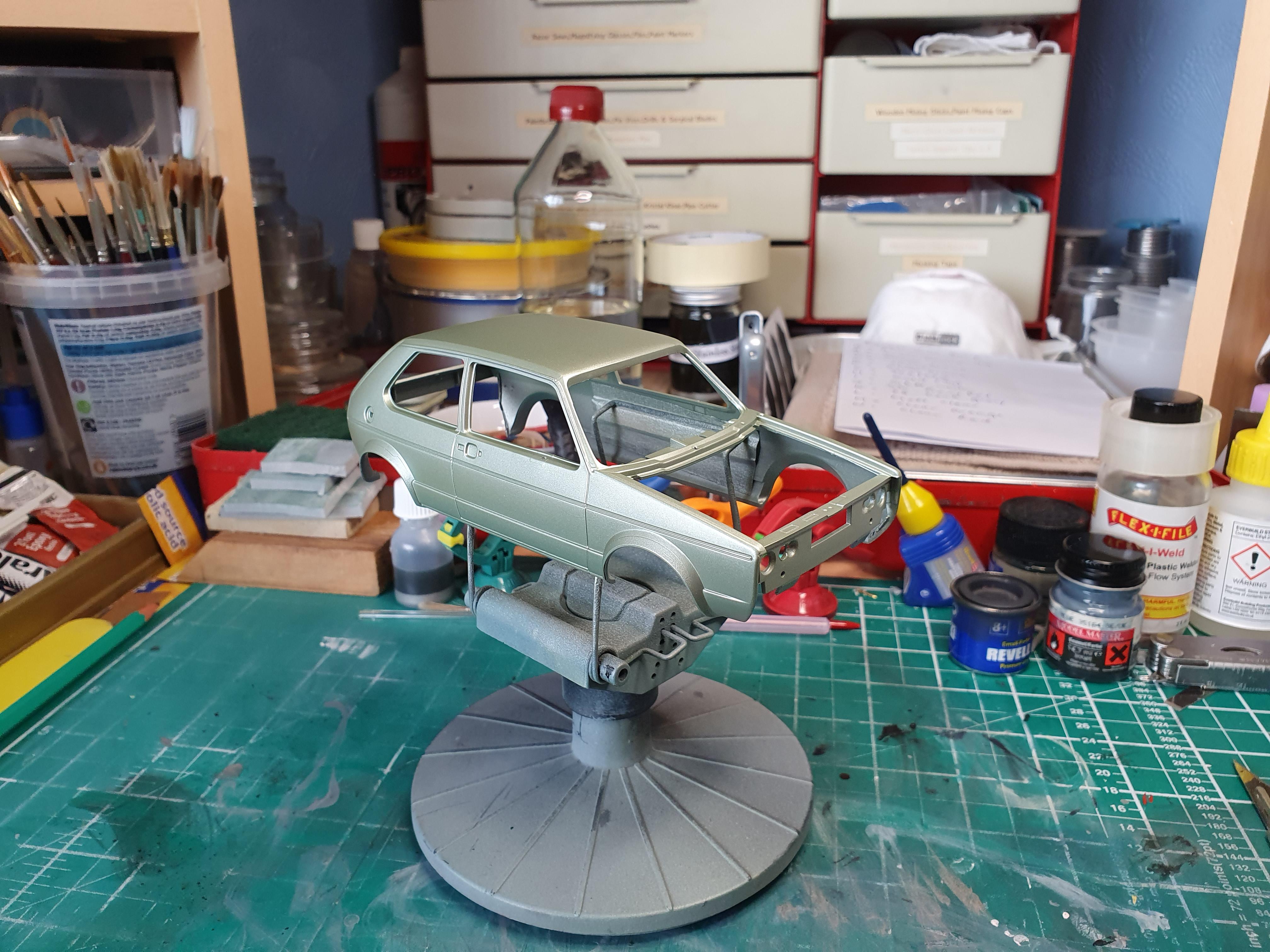

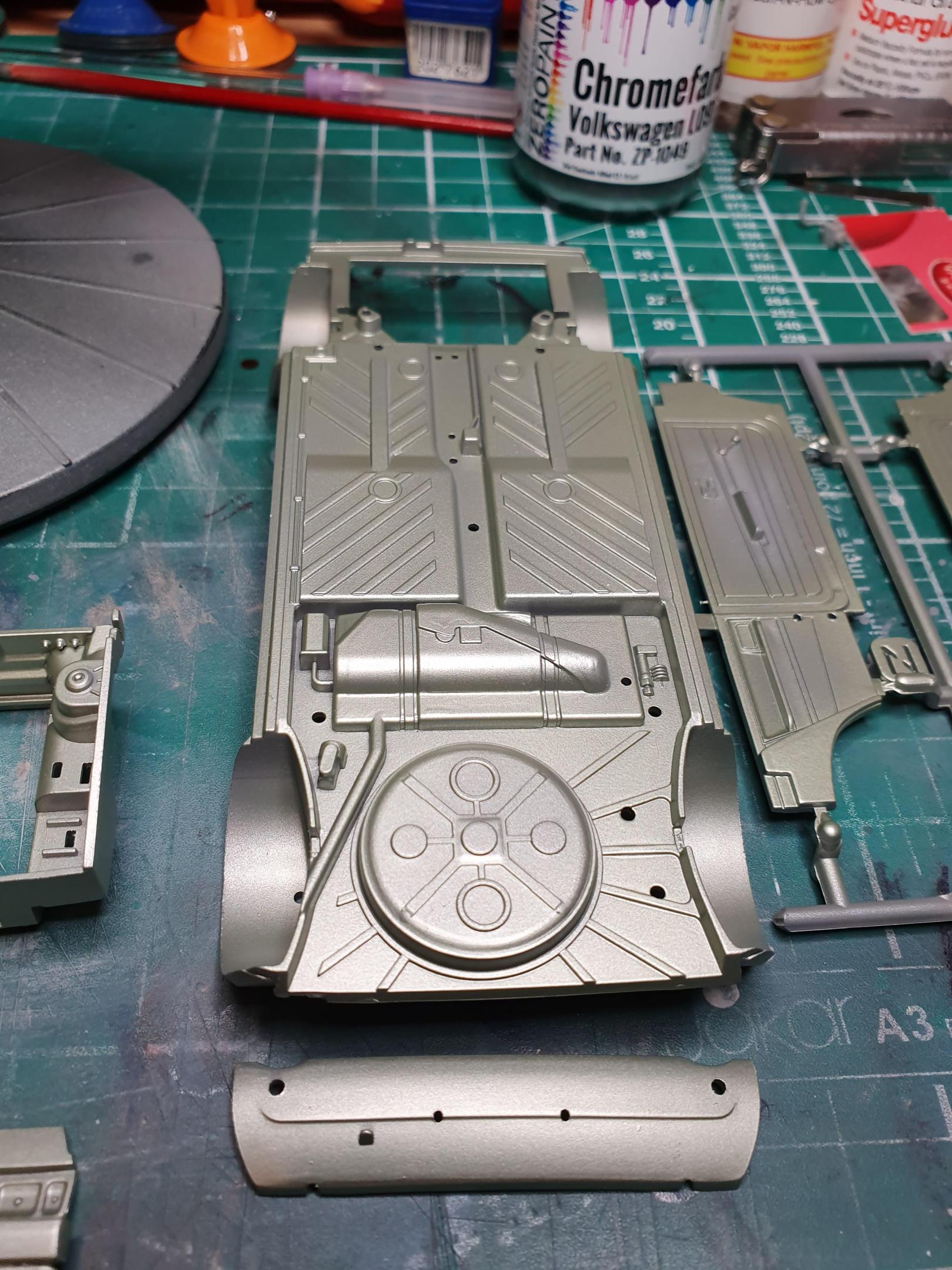

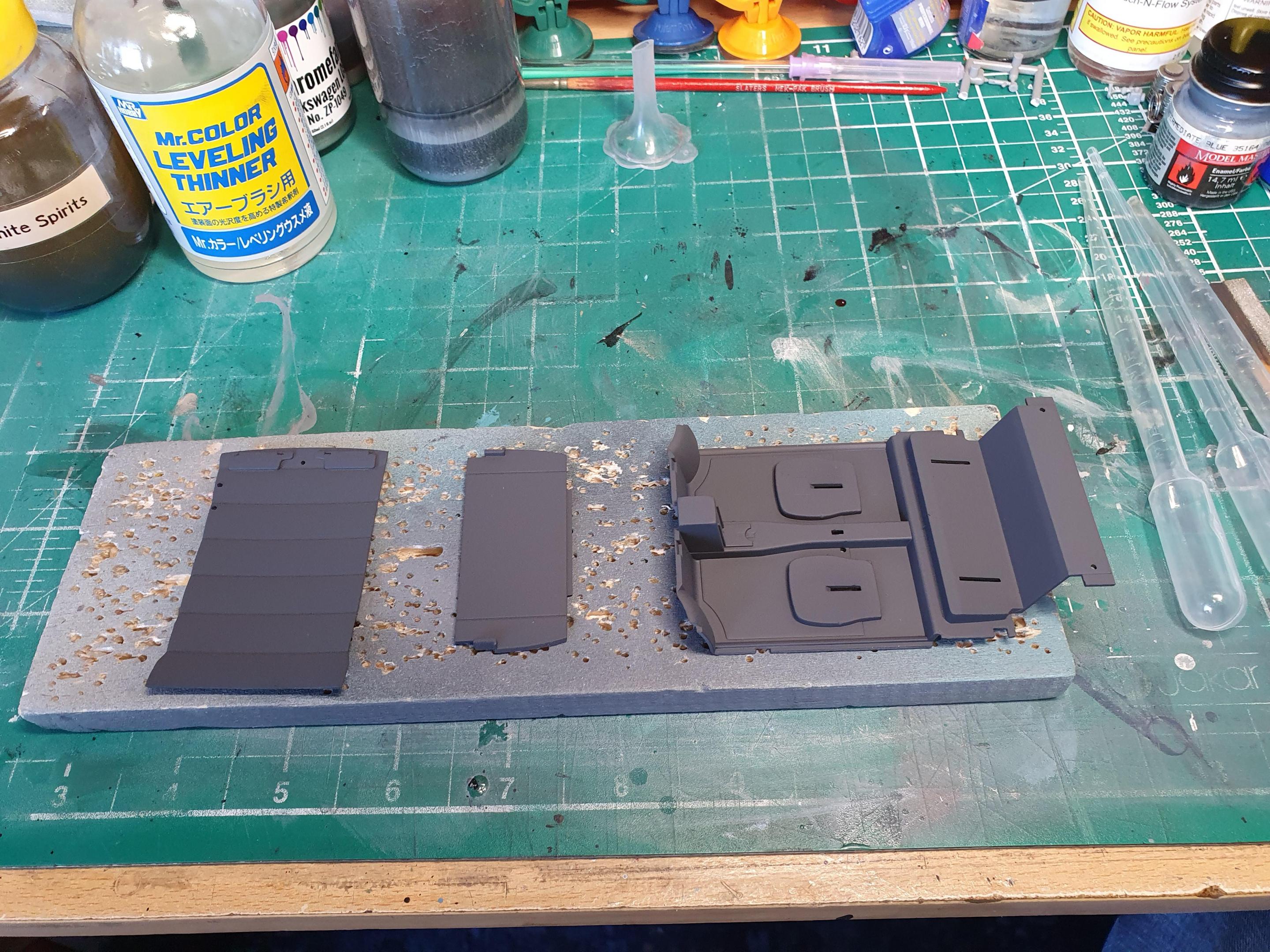

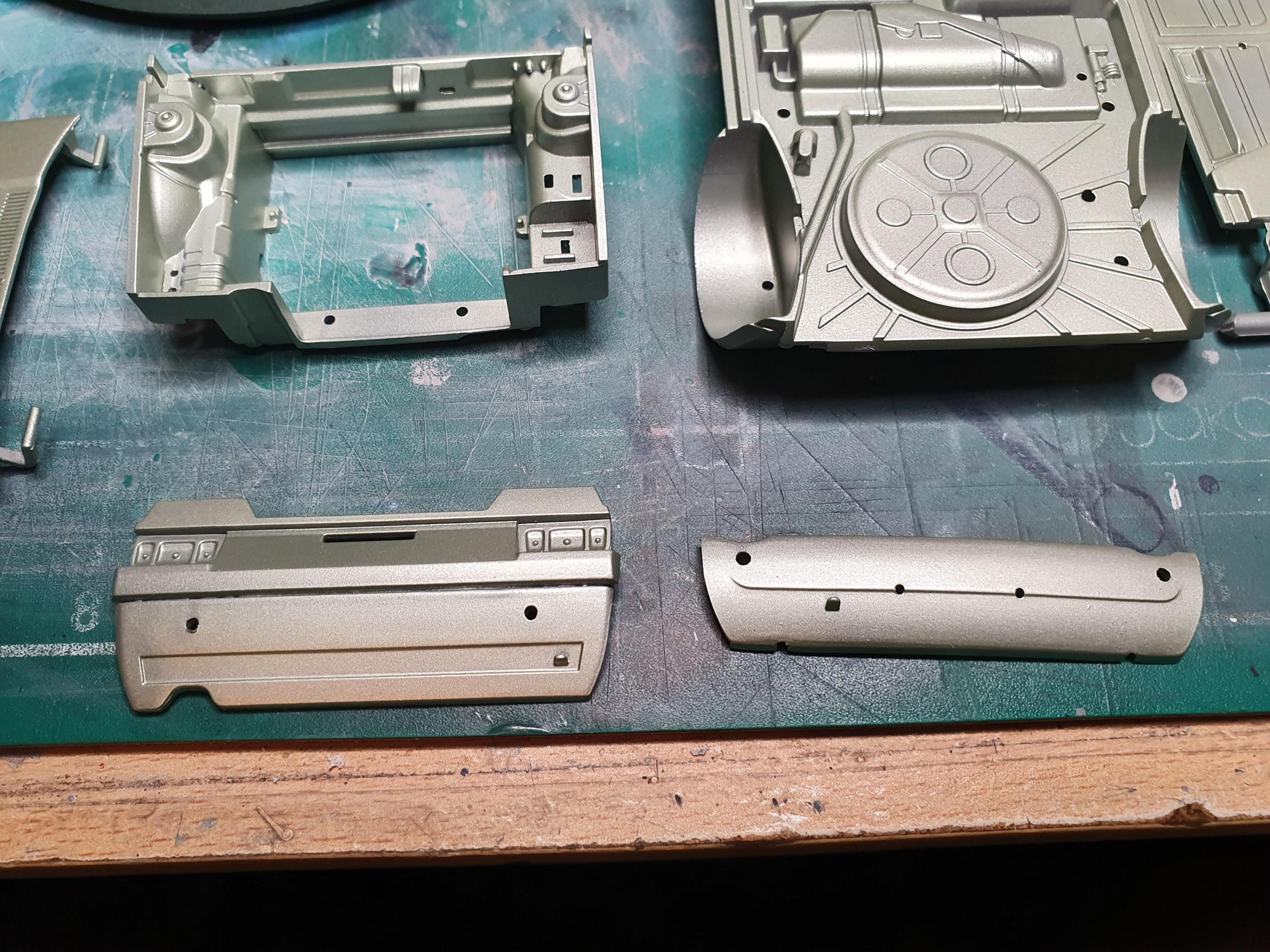

A little more airbrushing done on the Golf GTi, side panels clearcoated where they are body colour, they can be masked once it's dry to paint the door cards black, interior parts painted in Revell Tank grey #78, thinned with lacquer thinners.

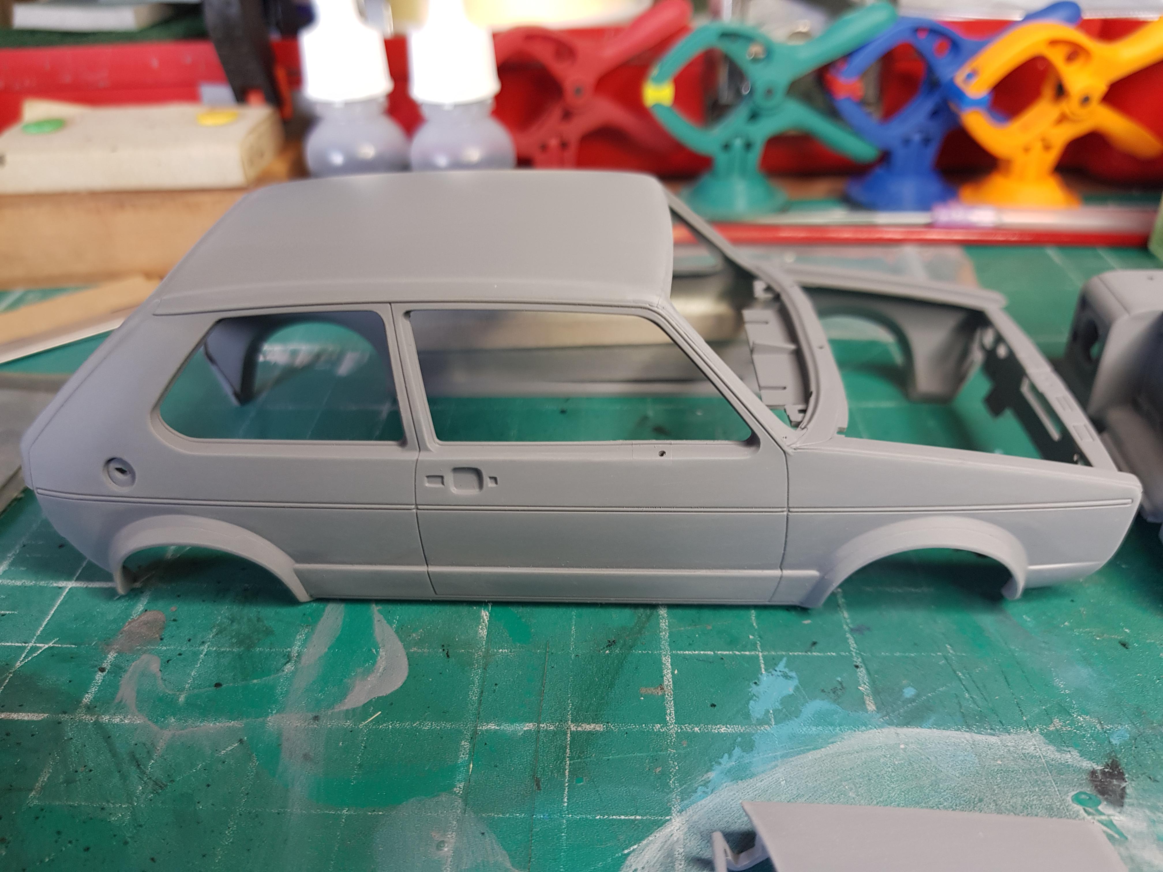

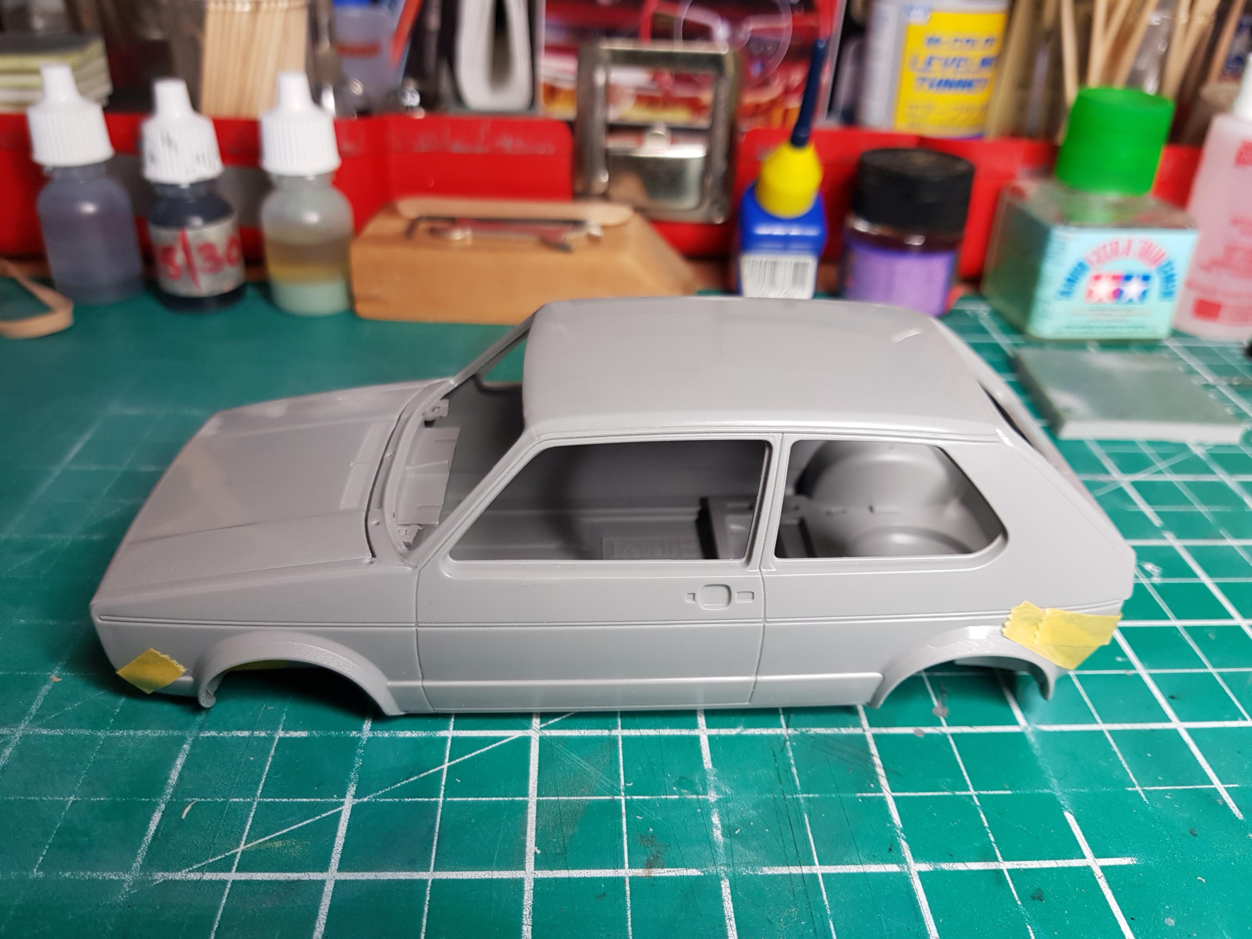

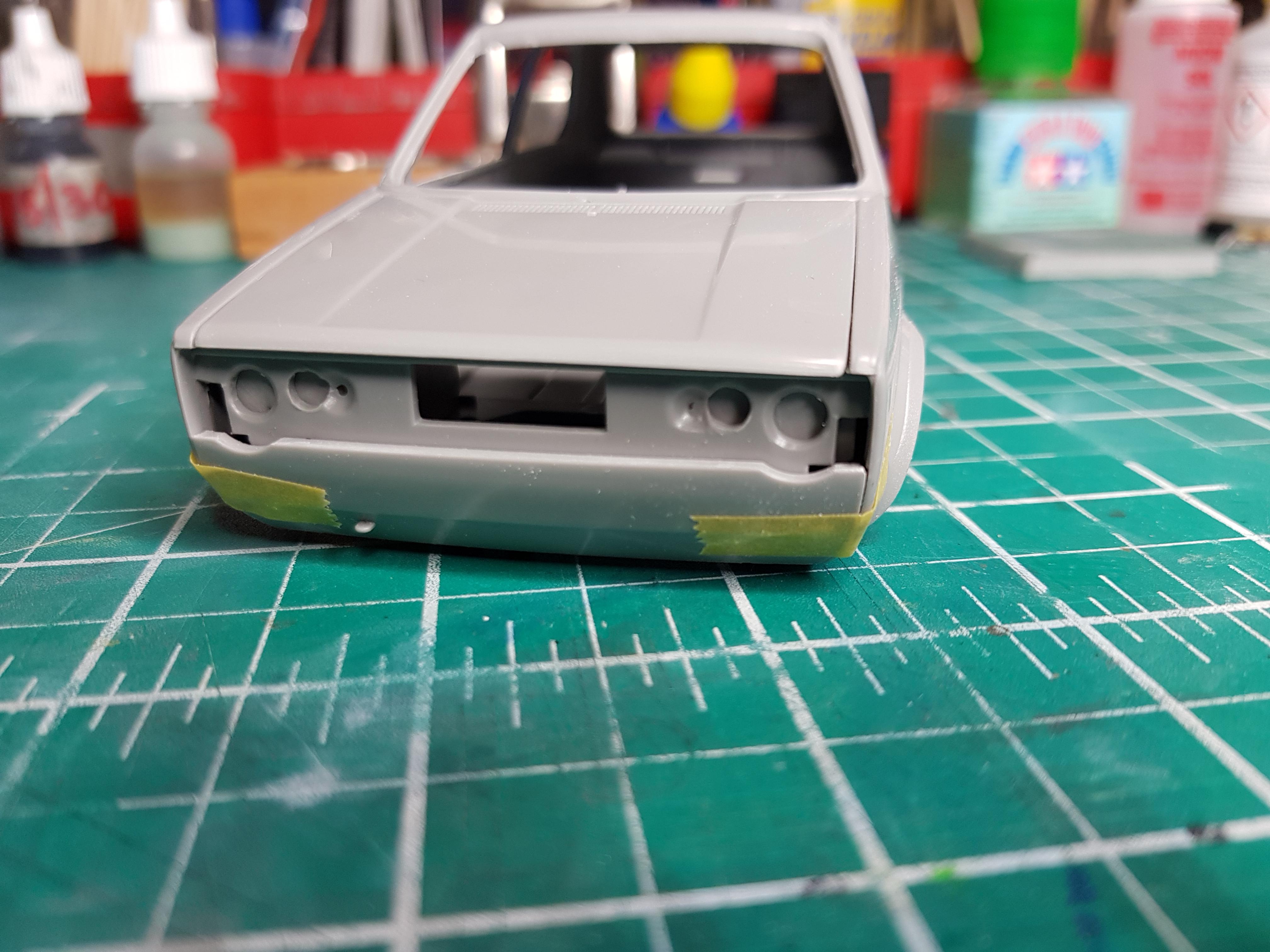

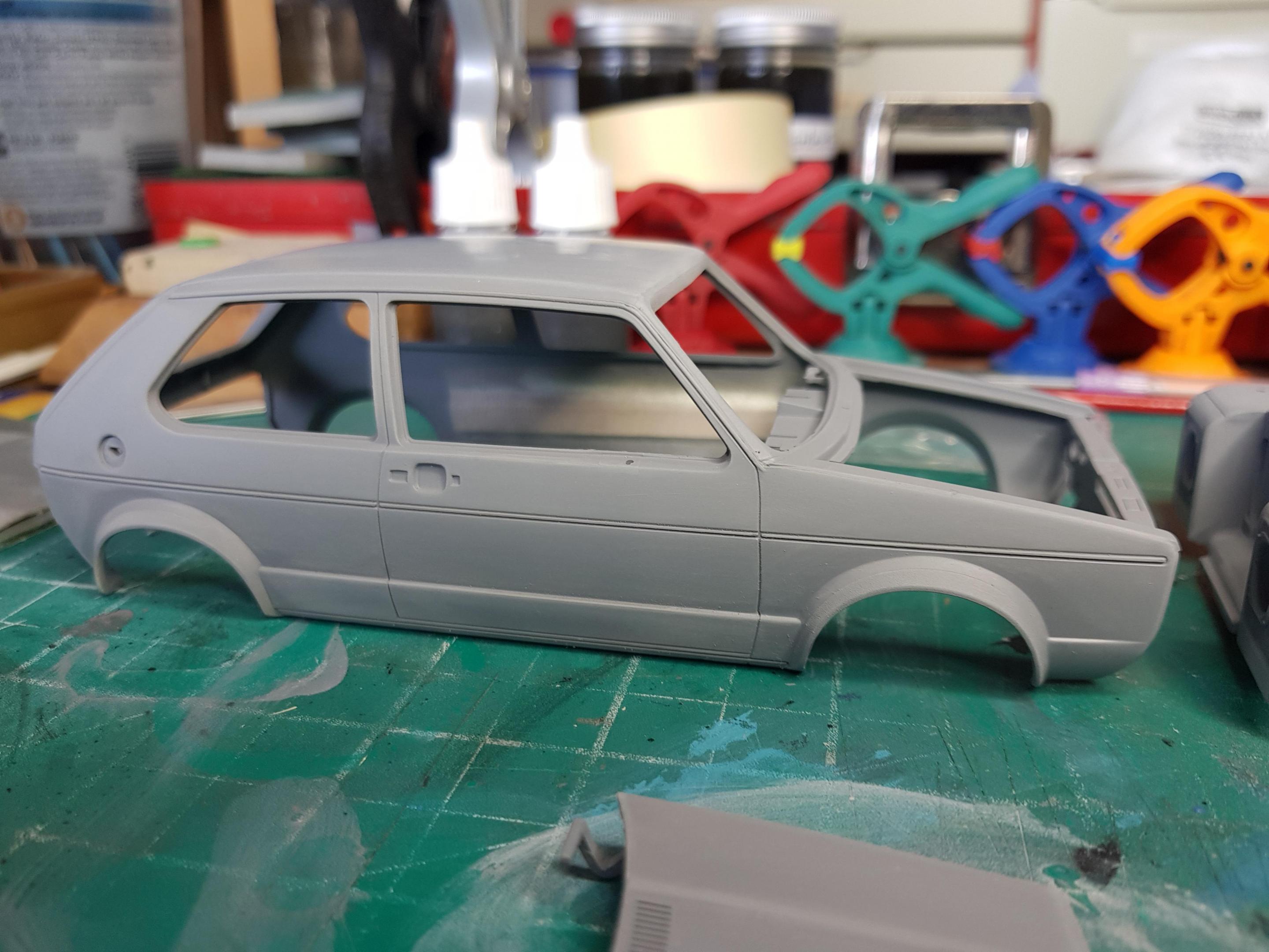

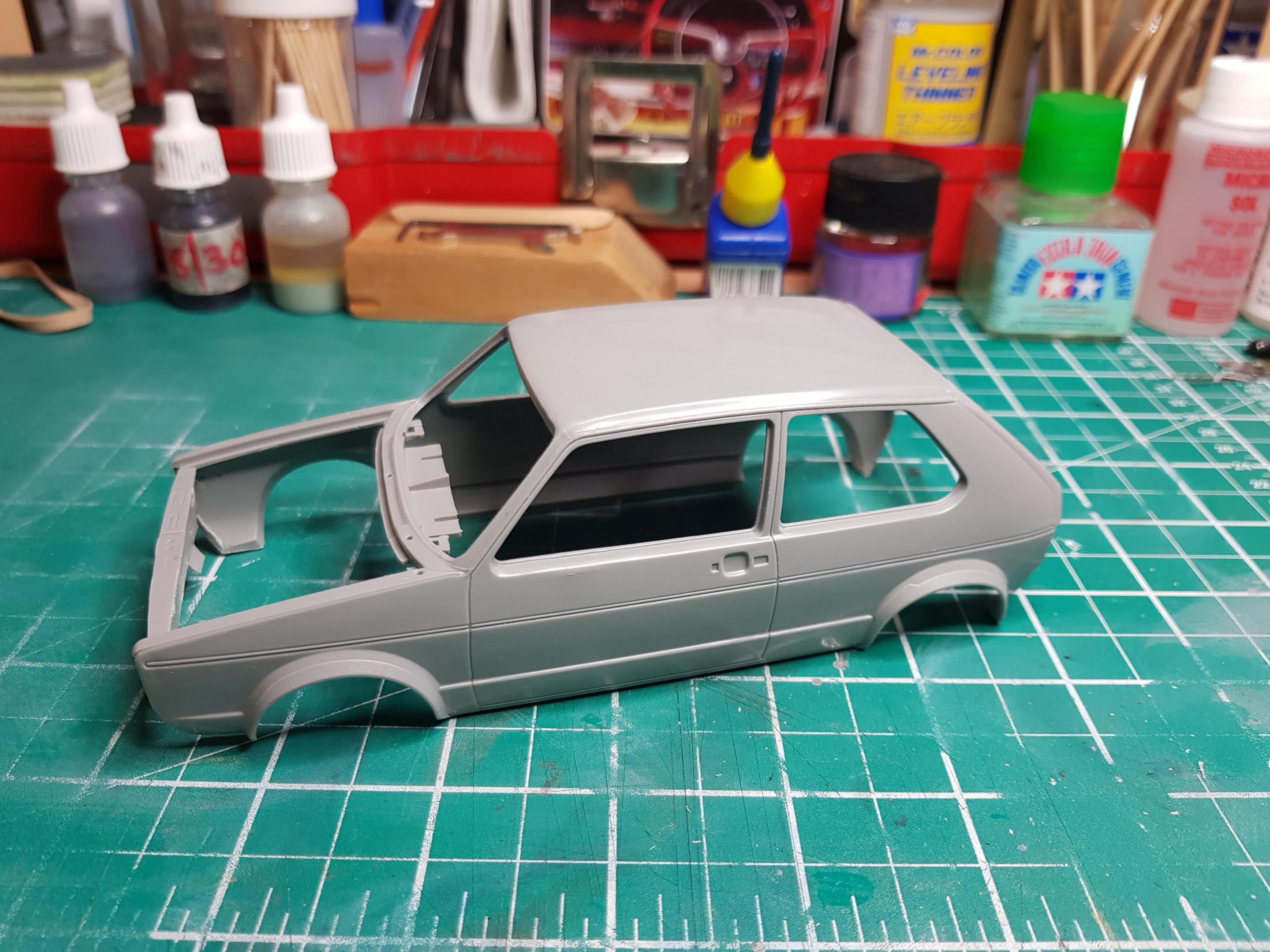

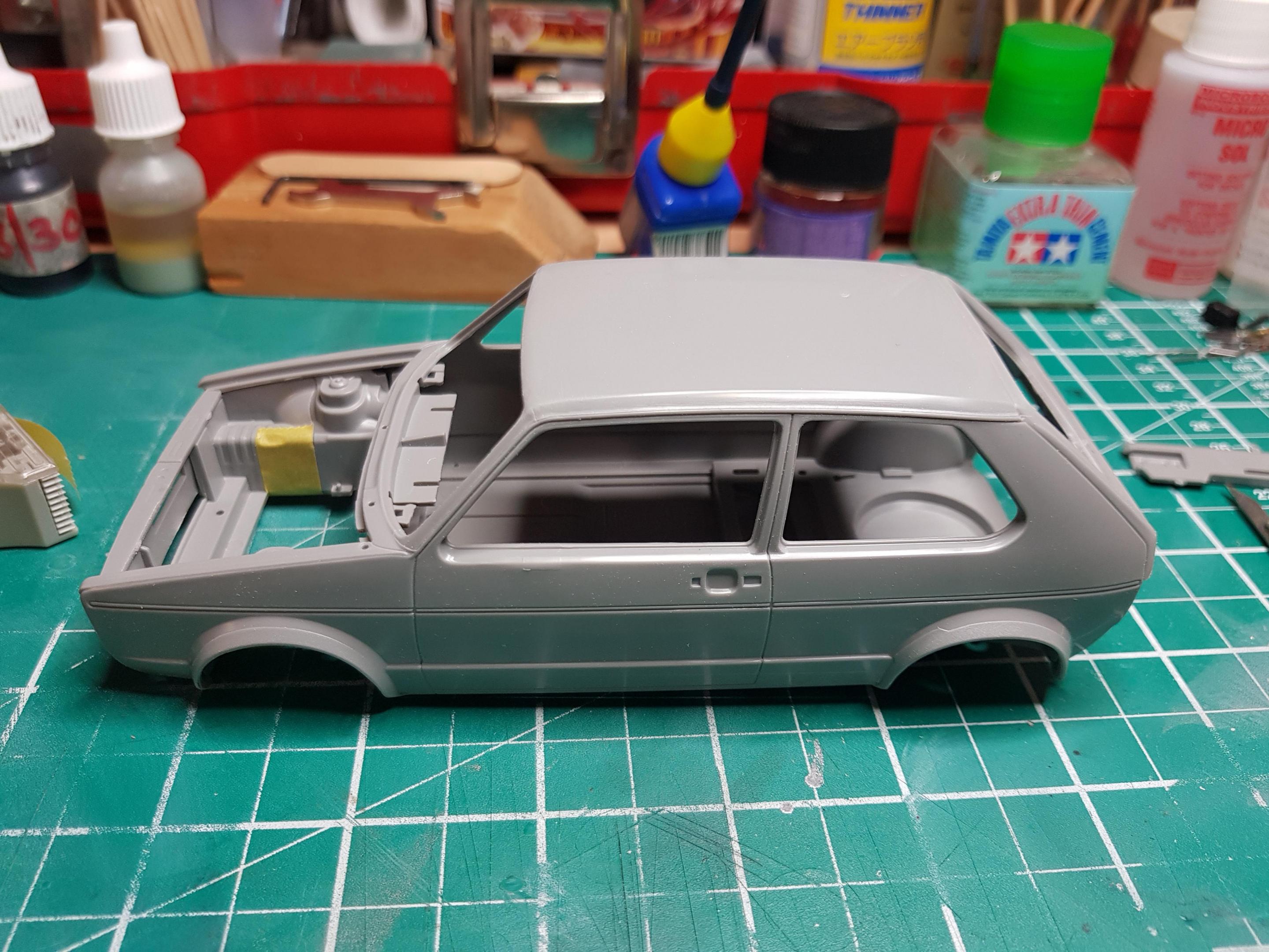

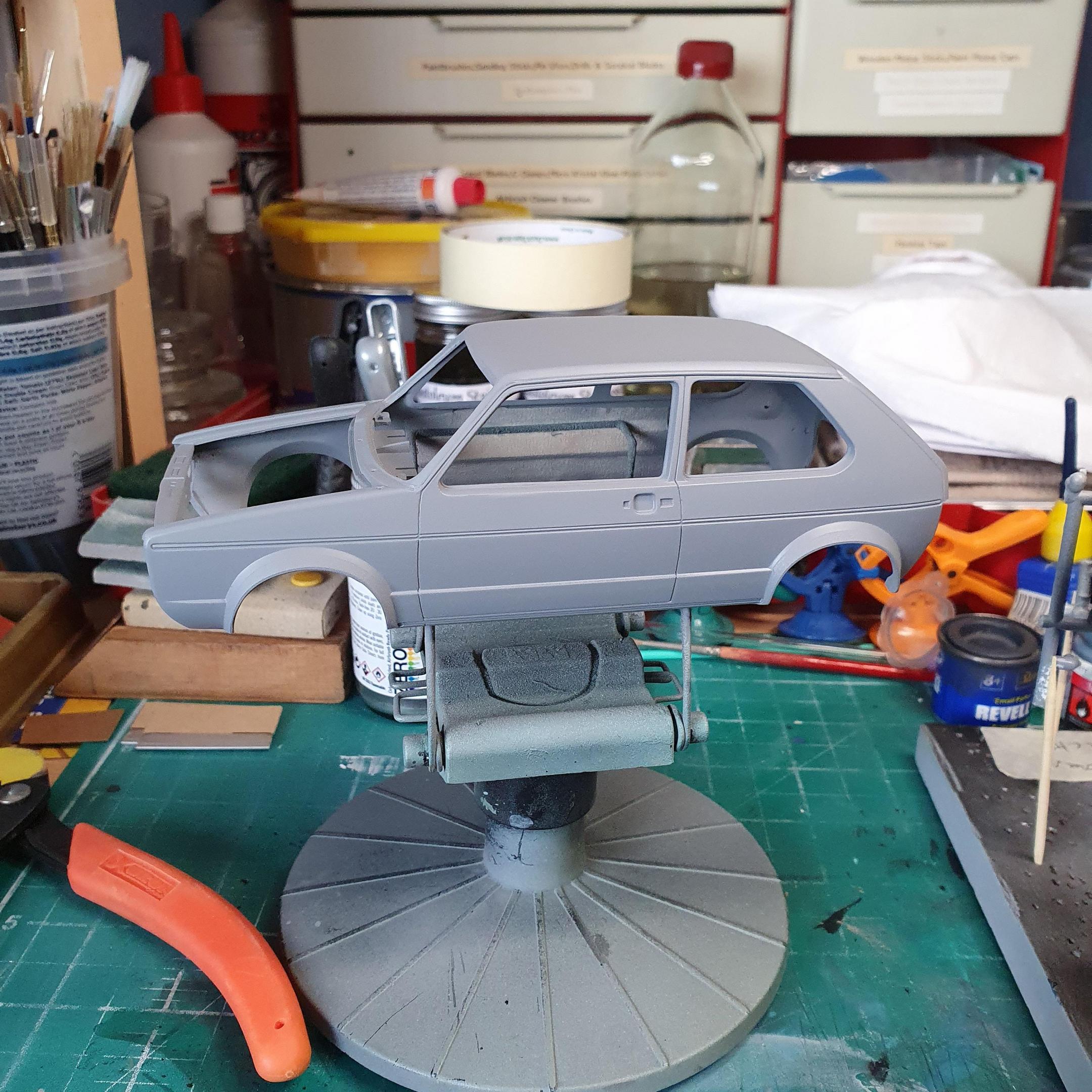

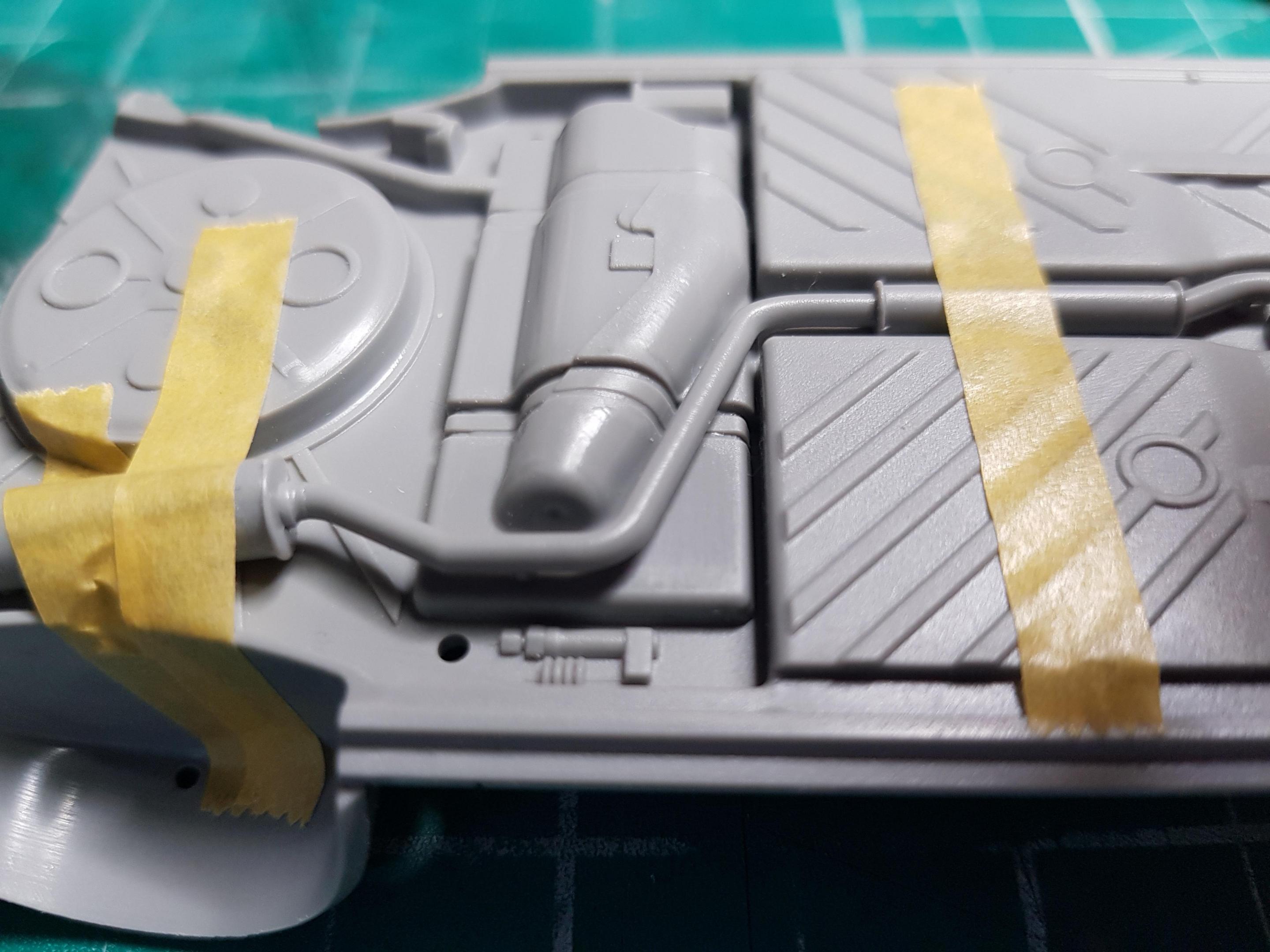

I really wasn't happy with the paint finish on the Revell Golf GTi, so it's been sitting in the stripper, the door panel lines have been re-scribed, and now it's back in primer, hopefully round 2 with the basecoat will get done next week.

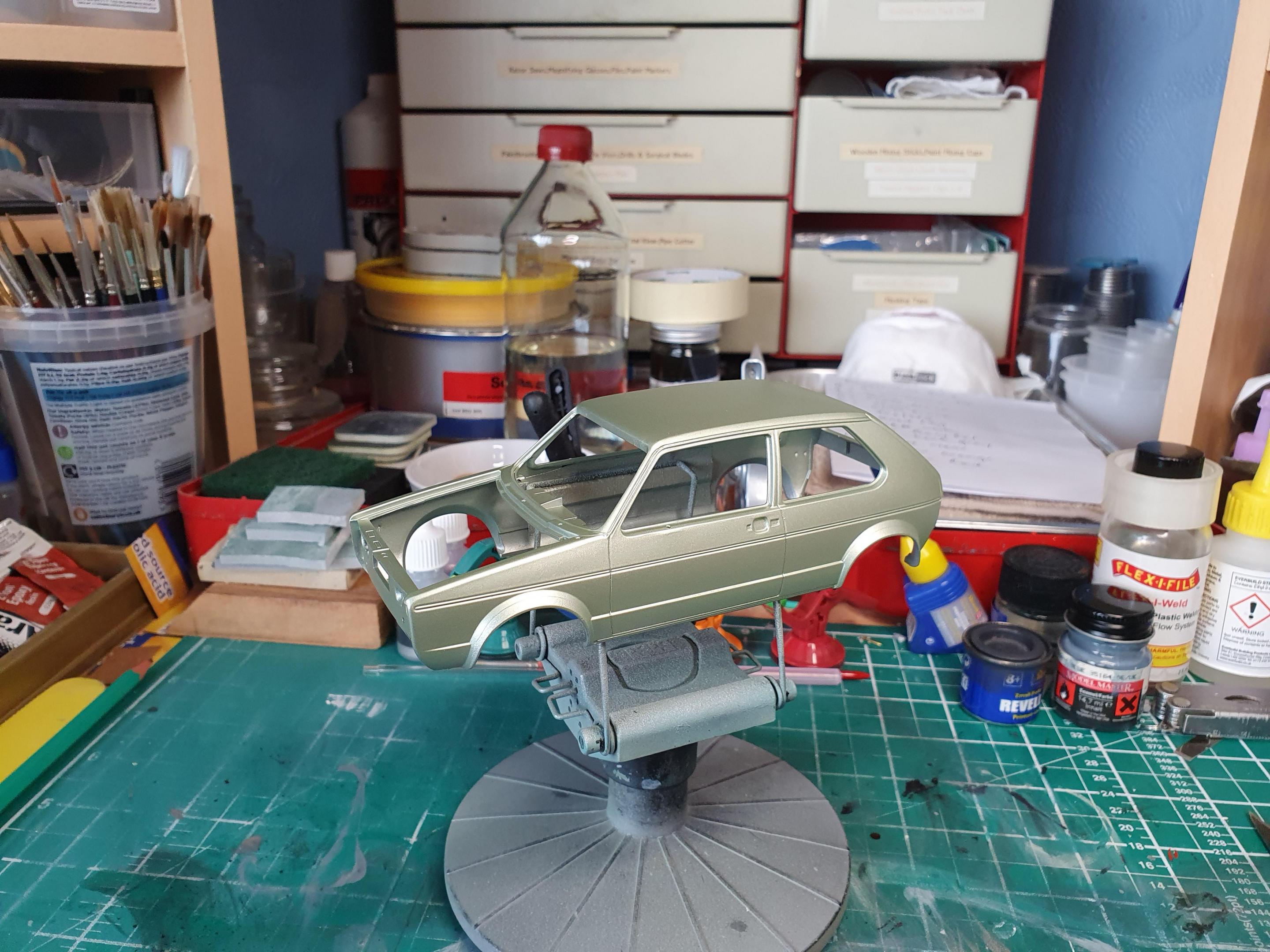

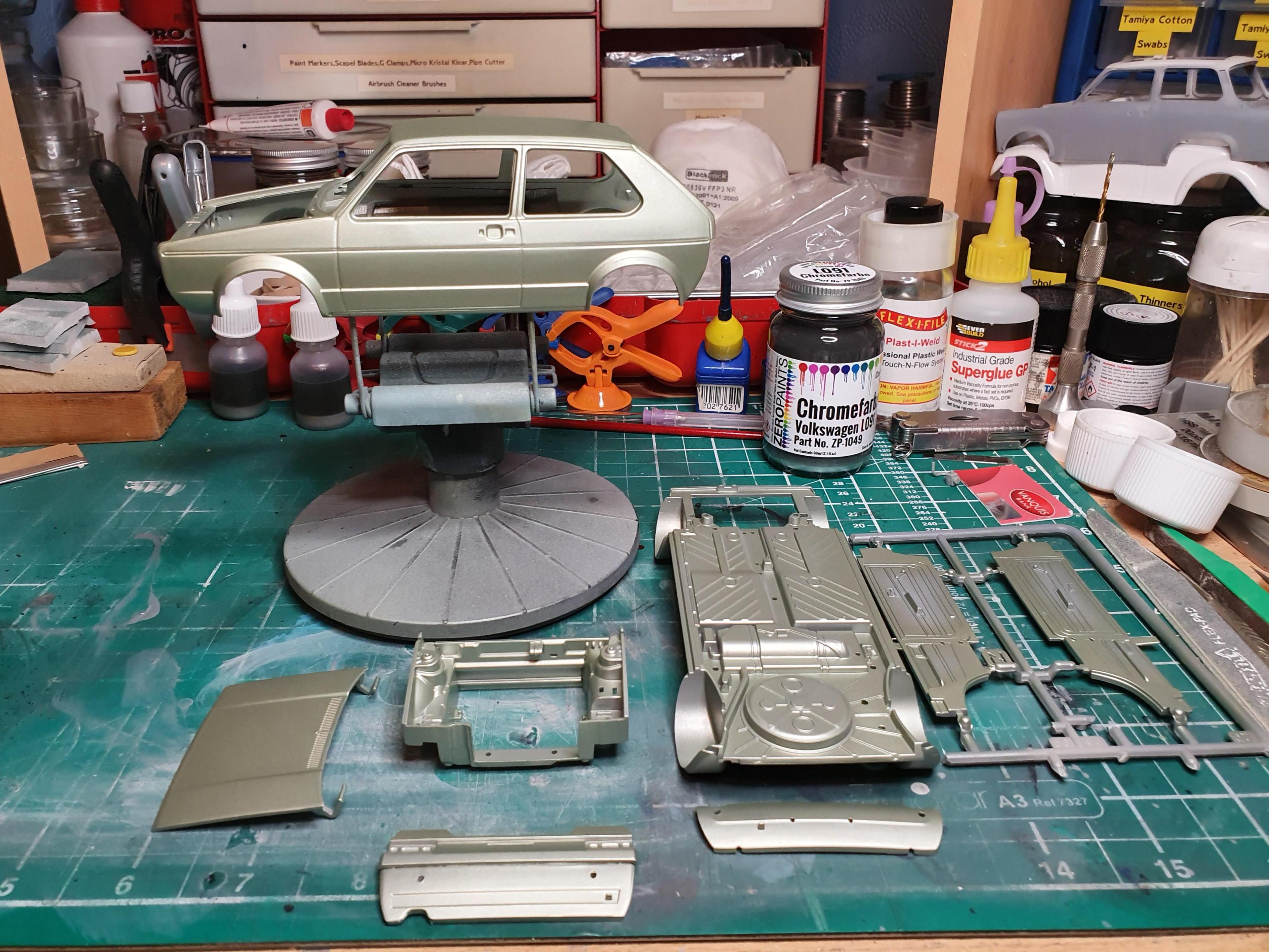

I'm still  getting used to this basecoat paint from Zero, it's the first time I've used their paints, I usually airbrush using cellulose lacquer, or 1K acrylic lacquer and just wet sand and polish, using basecoat and clearcoat  is all new to me, this time i used my Paasche VL airbrush instead of the Badger 200, as I'm sure it gives a much better finer spray pattern.
