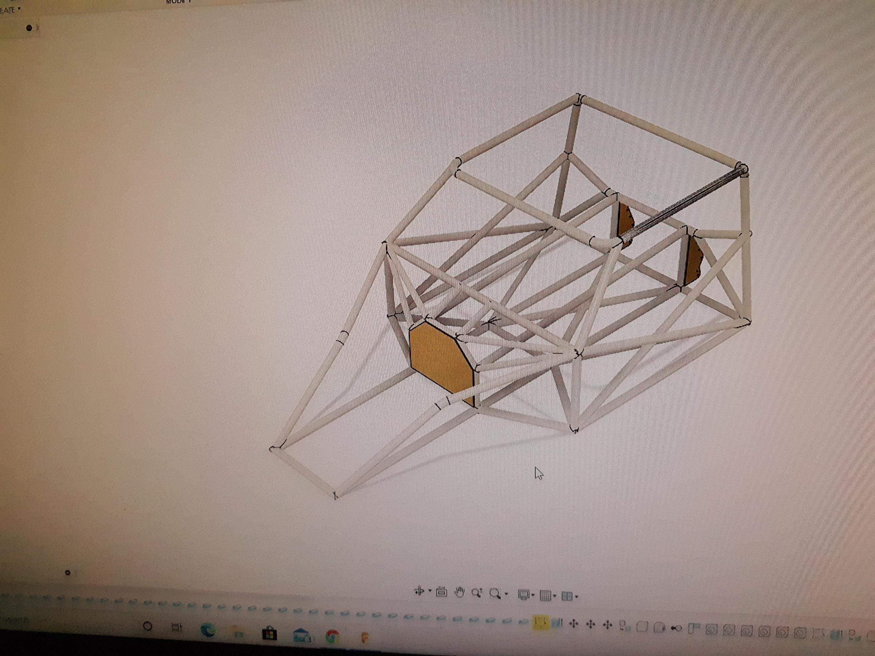

I'm going to build the car in 2 stages. Stage 1 is not going to use any aftermarket parts. I don't think I can learn the fundamentals of scratch building if I just glue a bunch of aftermarket parts into it. I'm using CAD to help me get started, as I've completley tore down and rebuilt the entire chassis 3 times now without it. I still have to cut off and redo a couple of things now, but nothing too much. The suspension is fully functional, as in the chassis separates a full 5mm when rotating the pinion back. The front doesn't work very as of yet because I'm still trying to figure out what fluid I can safely use and properly valve the shocks. Right now the shocks are working on friction for testing. The front struts don't have any pistons in them and it's just sitting on some hard springs to maintain the minimal 3" ride height during construction. I'll shorten the shafts and affix them to the chassis with a more appropriate spring as the build gets closer to completion. I'm going to detail kits small block with the tunnel ram. My 40 Ford coupe deluxe has an old 350 in it with a Wieand tunnel ram. When phase 2 starts I'll pull the engine and reserve it for a future build of it. The transmission is a Reid case M&M turboglide, my first attempt to carve one out of miliput wasn't very convincing.

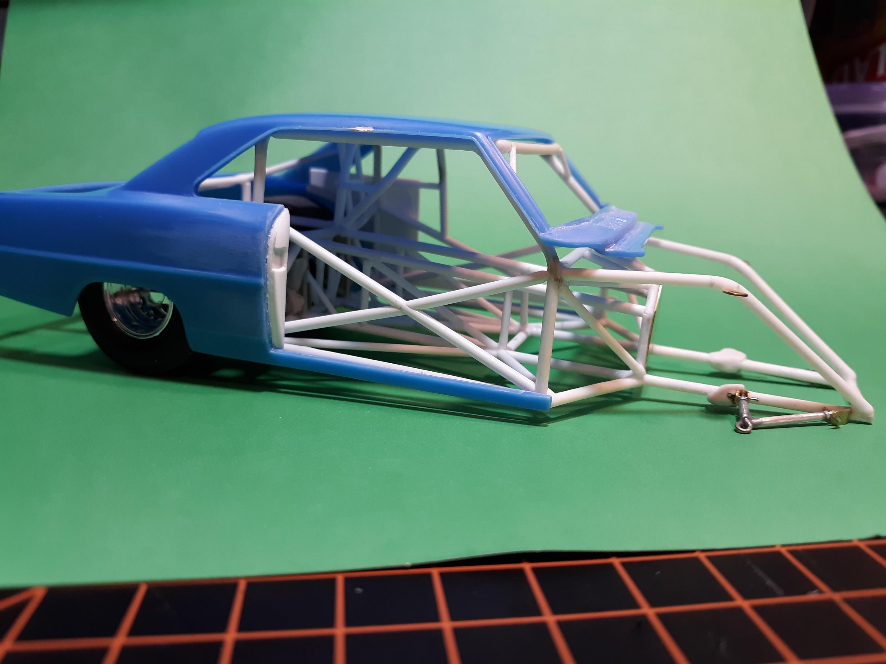

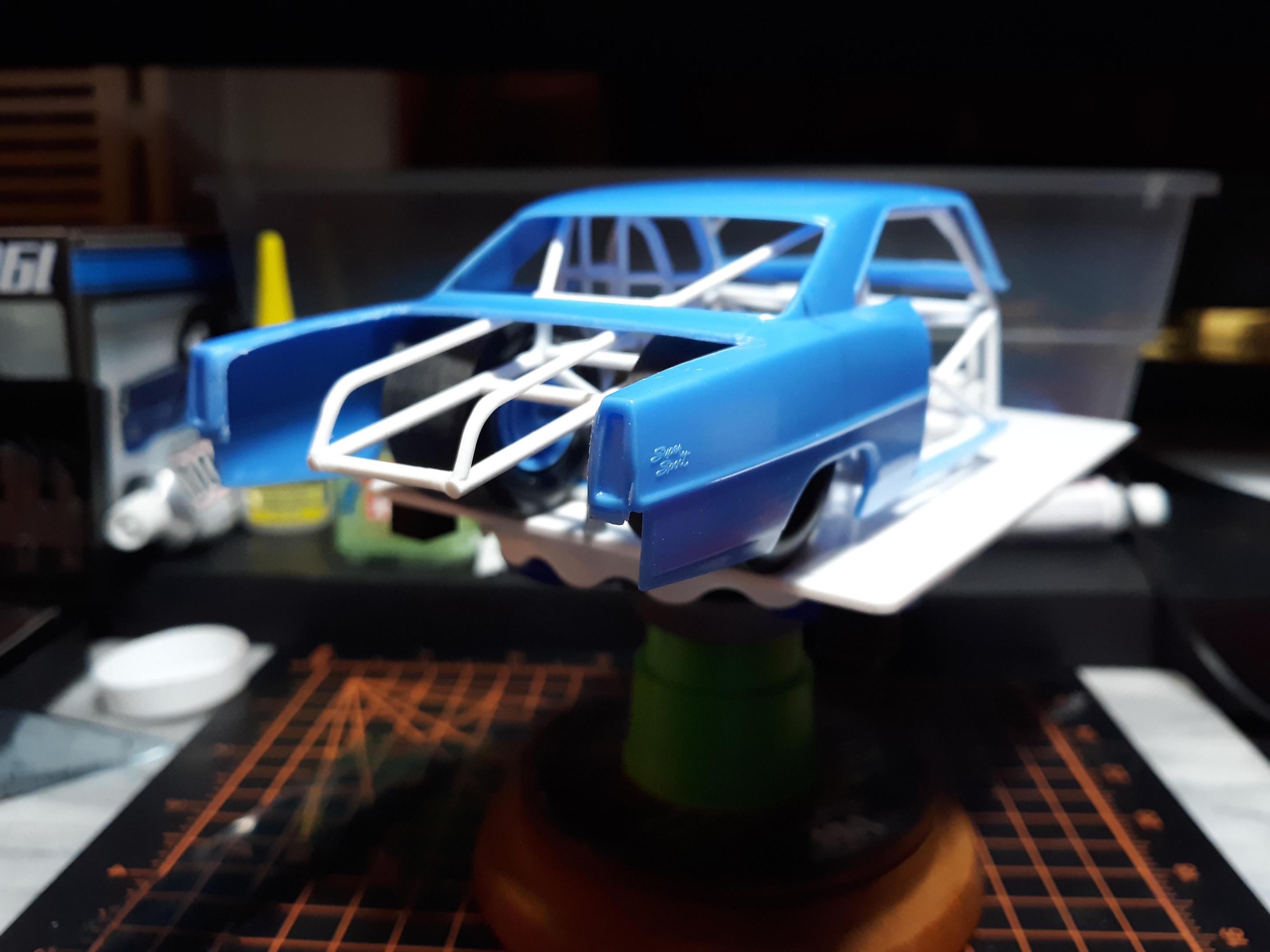

Phase I progress:

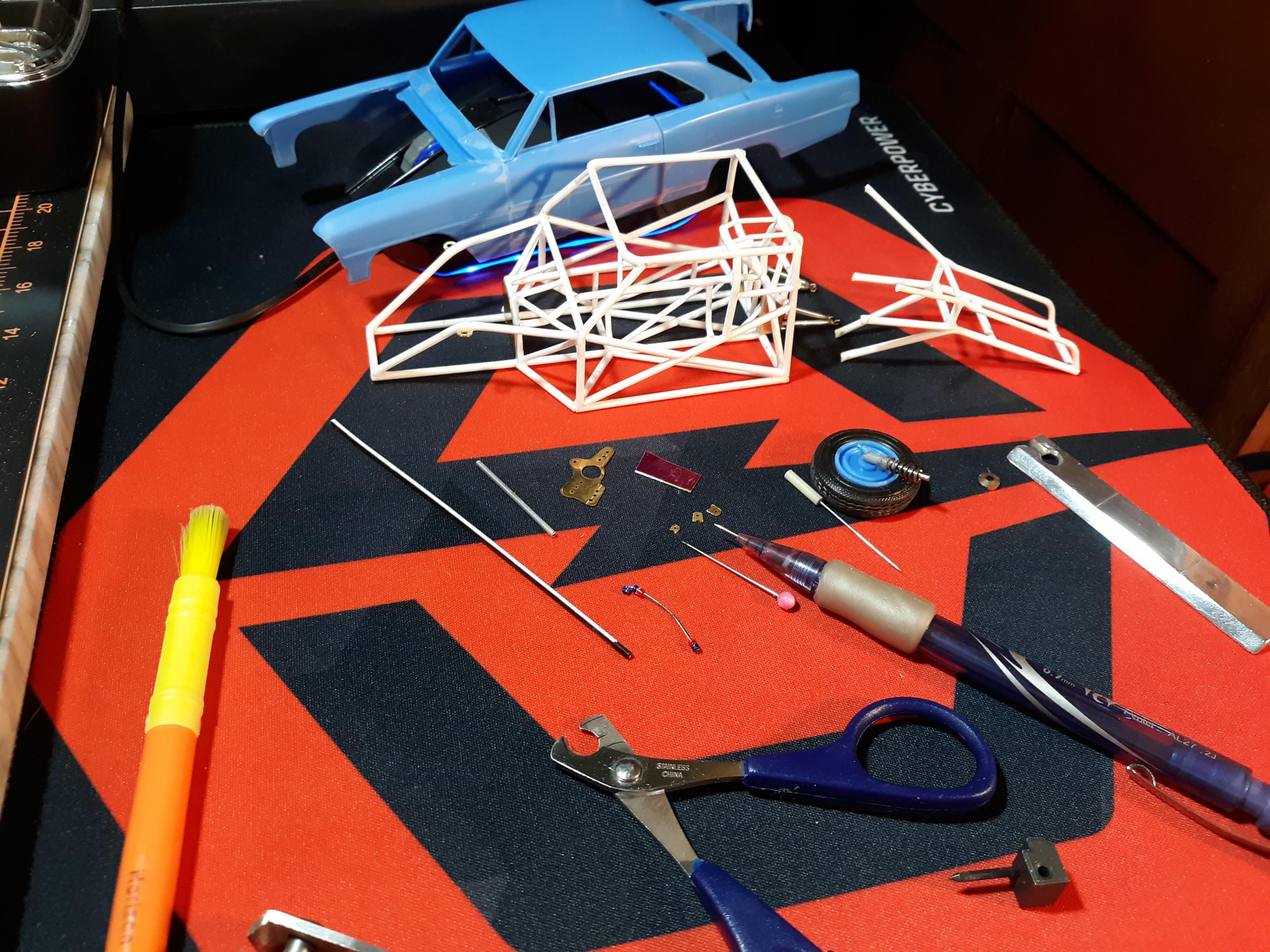

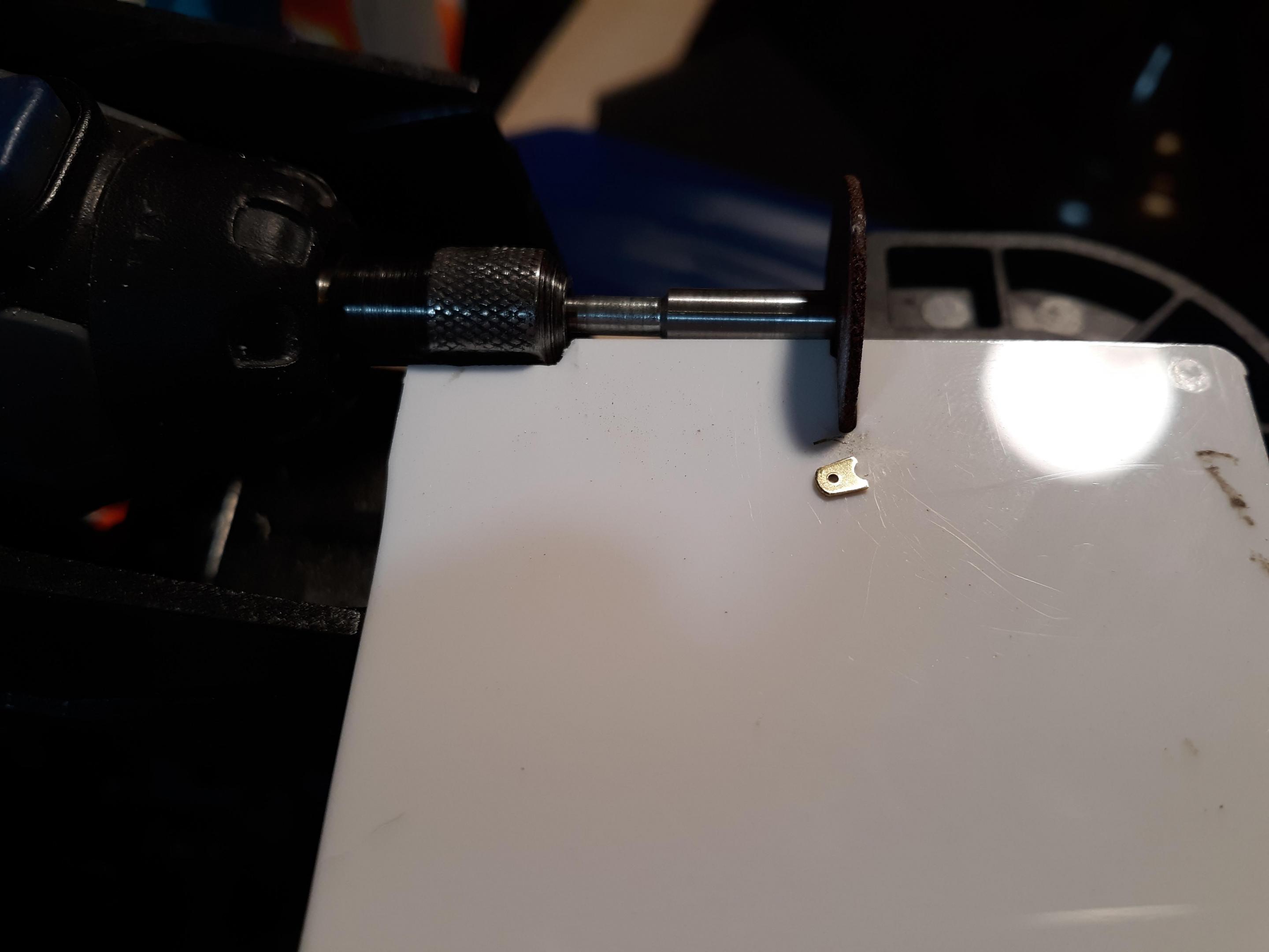

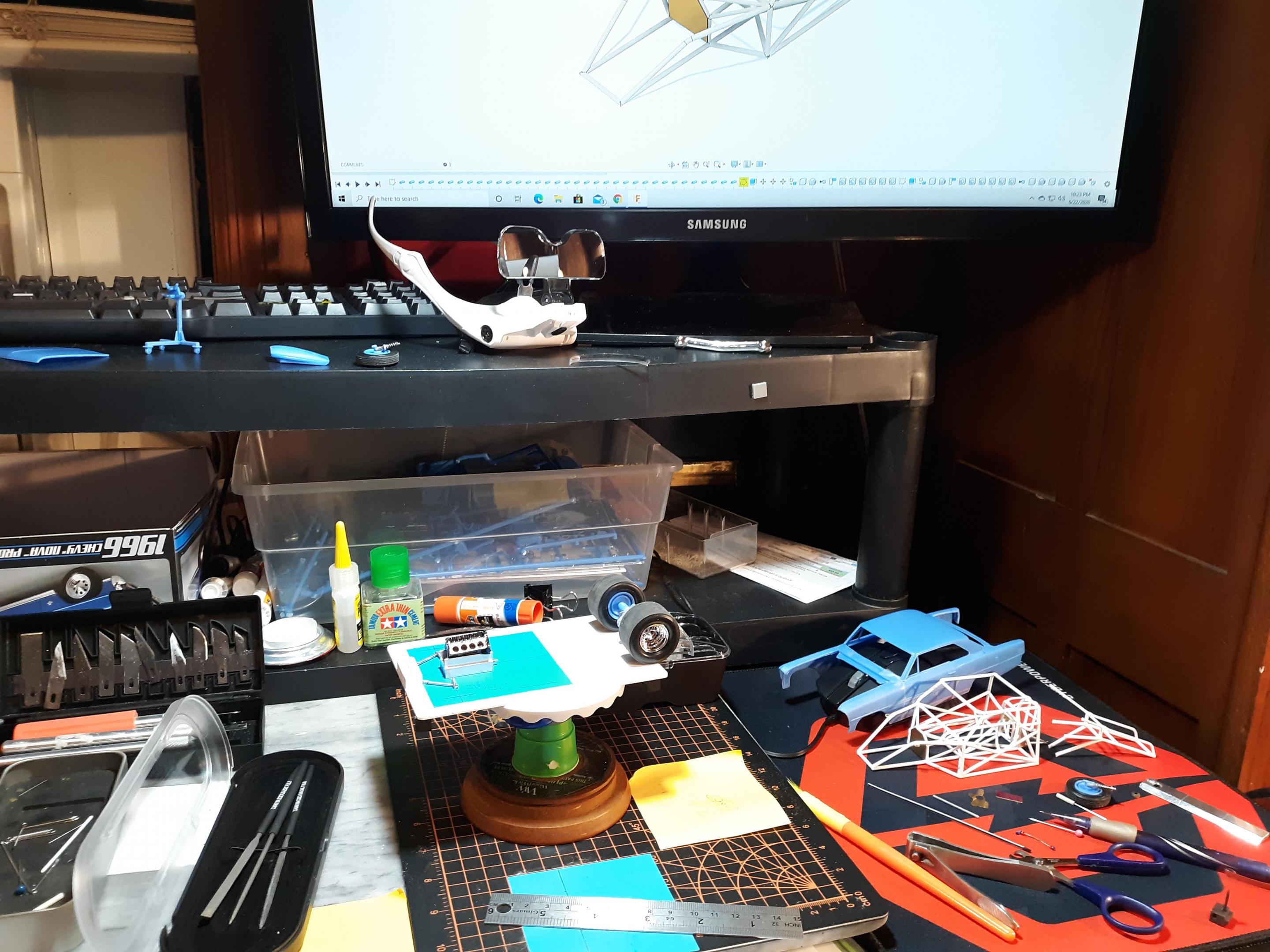

Here's some tools made out of household junk drawer items. I haven't seen any of them on the forum so far, but I'm also new and haven't been able to read much. There's also a lot of old posts with broken links to photos.
Scribing tool made out of a mechanical pencil with a needle in place of the lead.
Tubing and rod cutter using cat toe nail clippers. Just put them on the cut line, apply slight pressure and spin the rod until it cuts free. Quick and perfectly squared off with no cleaning necessary.
Perfect scratch built hex rod for nuts and bolts. Chuck up the desired rod size into your 3 jaw chunk in your pin vice or drill. Use a sharpie to color the entire rod. Turn the chuck until a jaw is at 12 o'clock and file it down slightly until you see a nice flat surface. Spin the chuck until the next jaw is at 12 o'clock and file like the first flat section. Follow the same thing on the third jaw. After that reapply the sharpie to make the tube the same color again. Rotate the chuck until the section between the jaws is at 12 o'clock and file it down until the sharpie goes away as it meets with the two previously filed edges. Rotate the chuck until the space between the next 2 jaws are at 12 o'clock and file  as previously.  Repeat again on the last section and you're done. It looks great in both plastic and aluminum.  I alternated between course sanding a flat, and polishing the next flat on the aluminum to make it stand out more.
A fixture for a Dremel made out of the handle of a broken Kureg coffee maker. I removed the needle from the top jaw, put some screws in the side to hold it in its open position. You  can also just mount your dremel directly to an old folding TV dinner table with a piece of plumber strap and a couple of screws. The platinum  is made from some thin plywood to space out ABS work surface to just above the center line of the grinding disk. This is important because if the surface is below the center, your work will self feed into the grinding disk, too high and your work will try to jump away from the disk. I have a small hole drilled in the corner of the platinum that registers into the hole of little tabs so I can hand file them into final shape.

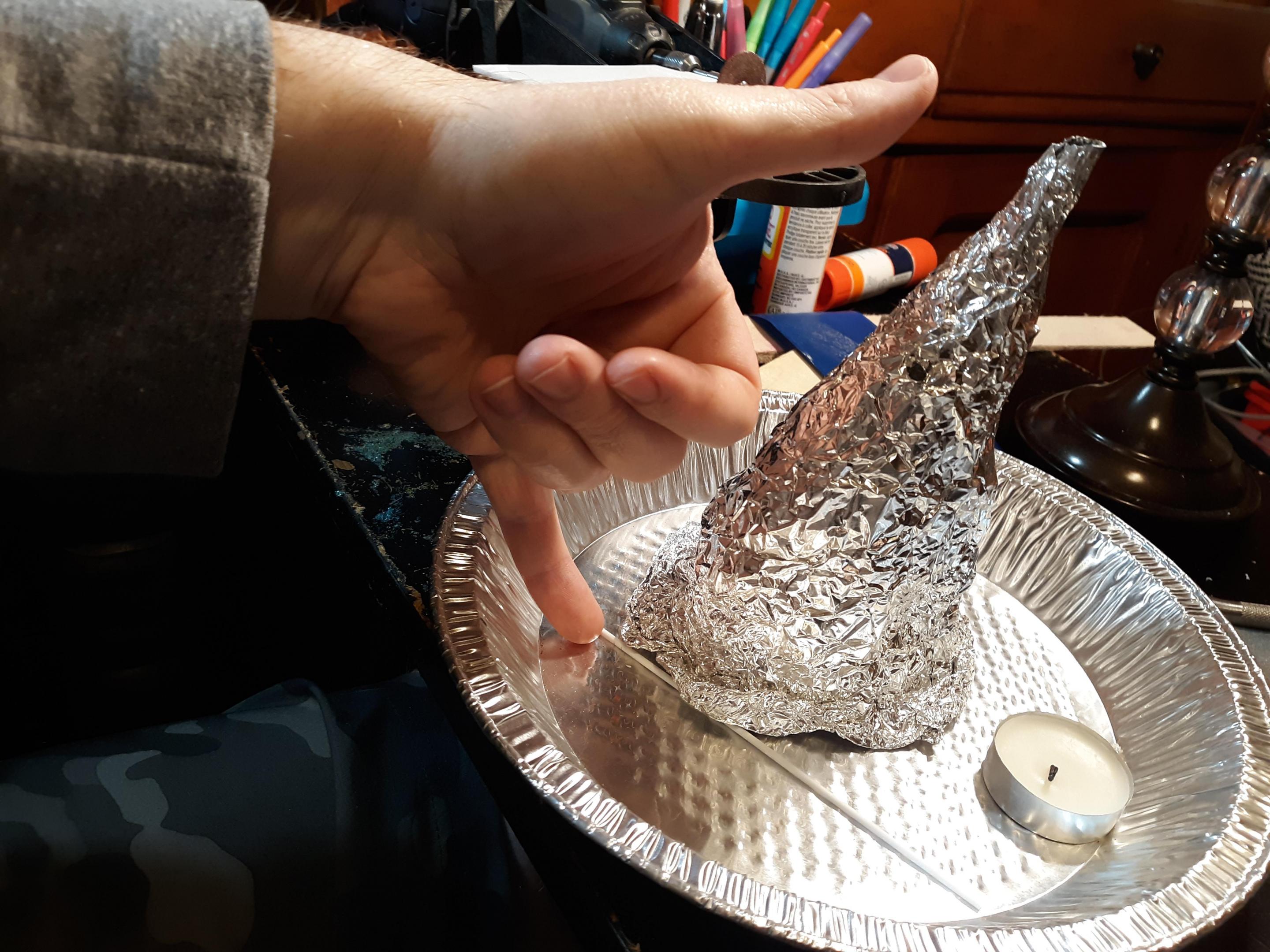

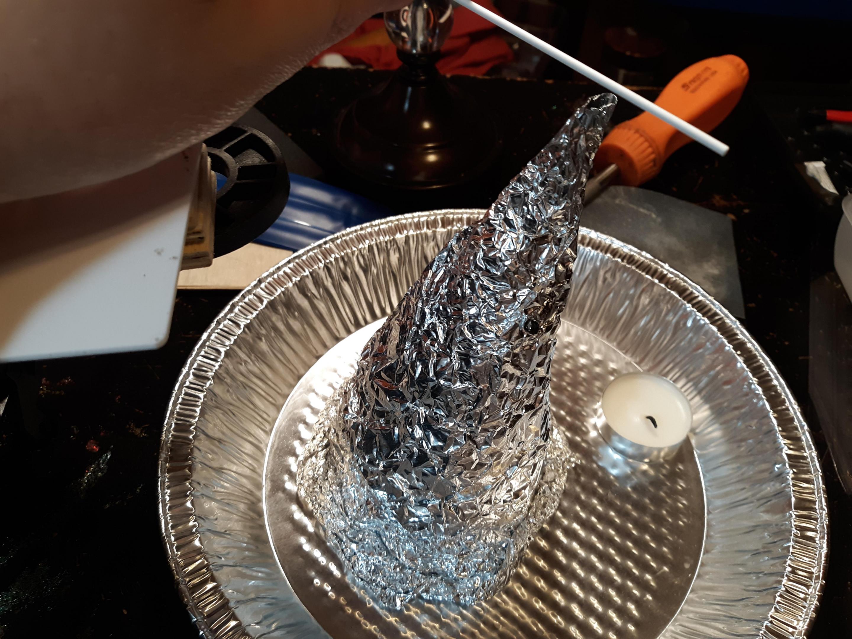

Tubing bender made from a tea candle, pie plate, tin foil. I got sick of black smudges and inconsistent bends because of not being able to put the heat in a small enough area on the rods. If you make the chimney very small like mine you will need to poke a hole into the side to get more air into it to keep the candle from self extinguishing.

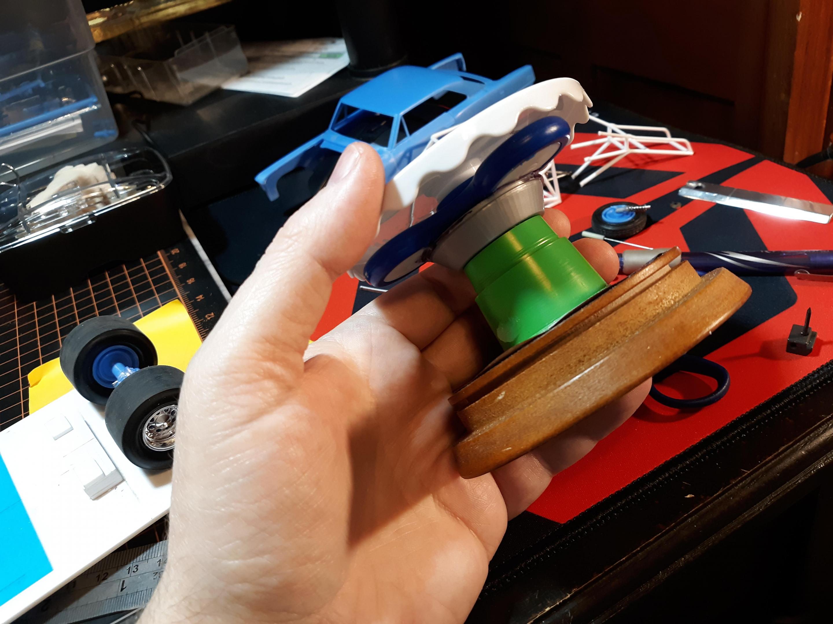

A small lazy suzan made from a heavy candle lid for the base, a stolen rim off my son's RC Bigfoot truck (shhhhh he still hasn't figured it out yet), and I bucked one of his finger widgets when I was rummaging through his toy boy, it has roller scare bearings in it, it might spin a little too easily. The top is a round piece of random plastic, I might have found it in the tool box, I mean toy box as well. Just CA glue the base to the wheel, the wheel to the outside body of the fidget spinner, and the surface plate to the center of the fidget wheel.

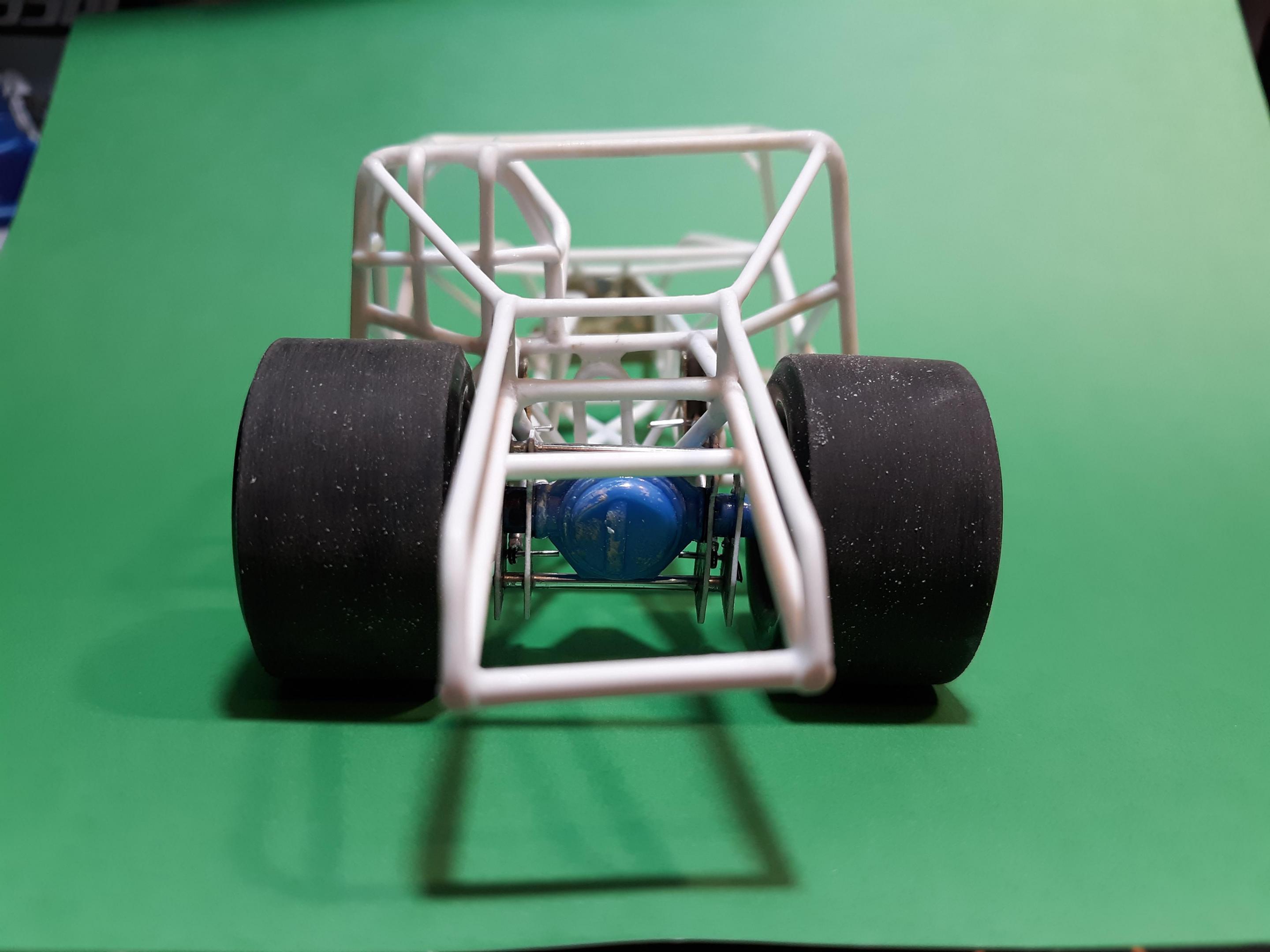

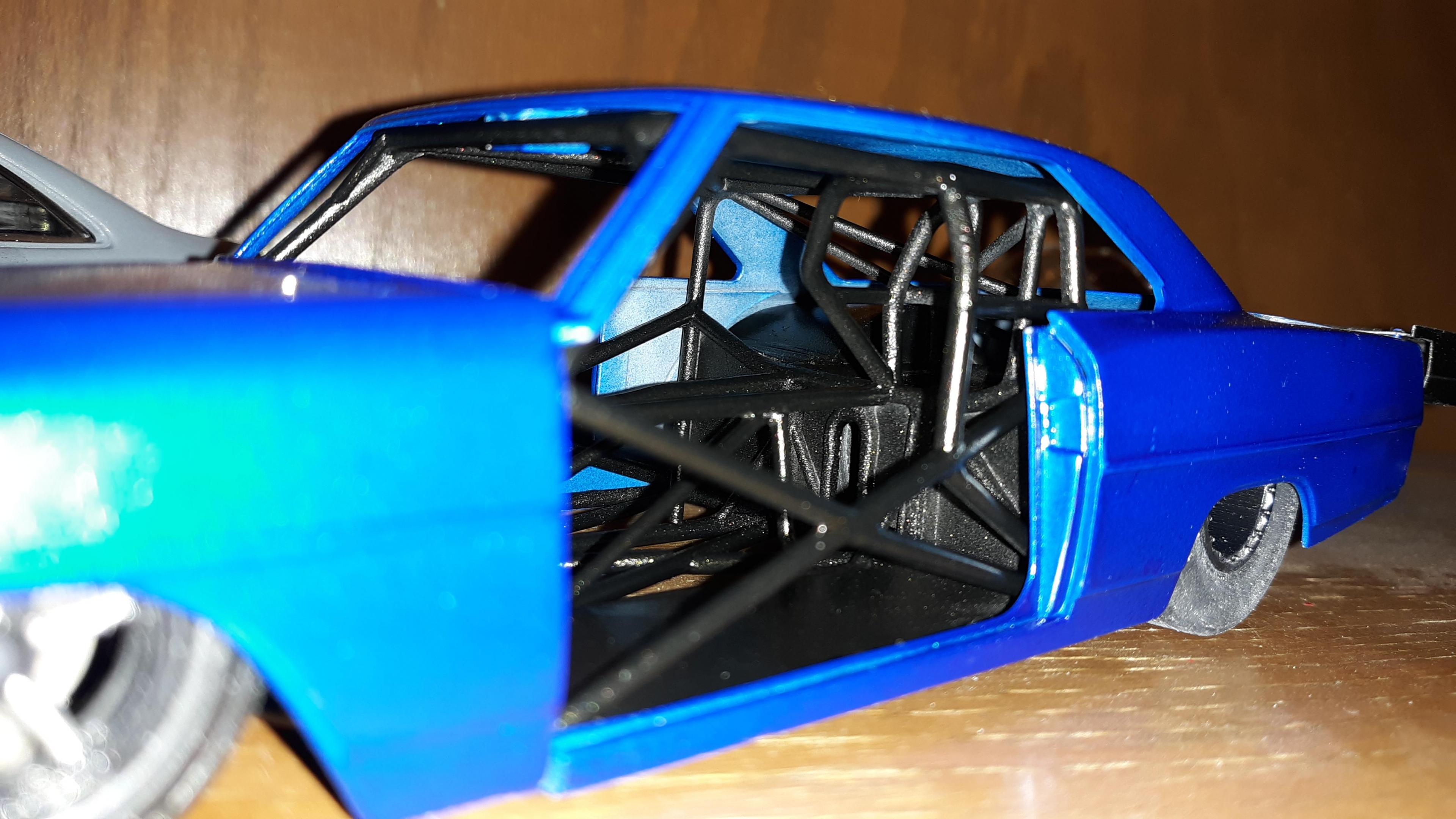

I haven't made much progress this week despite working on it every day. I lost a few chassis tabs that caused a rebuild of my work station. A friend dropped by to show off his new vette when I was in the middle of airbrushing my offsprings AT-ST. I dry sprayed the ever loving mess out of it. It was worth it, it's not everyday someone brings me a new vette to thrash.
I ordered all of the parts needed to finish up today.  My wife loves my new hobby after she found out what I spent. I told her to put some money into checking this morning because I needed some new radials, wheels, and some detail items. She rolled her eyes and shook her head because I failed to mention that it was for the model. Turns out that she still loves me after 15 years of marriage because she put 6 grand in there for me. I spent a few hundred between four vendors, I tried to spread it out as much as I could to help support these guys. I spent way more than I thought I was. My wife called me a few hours after ordering and asked how much I spent. I told her, and she sighed. I knew I was in trouble, but it was a sigh of relief. That's when she told me how much she put in the account. I missed an opportunity to get more Go Faster parts as I shouldn't push my luck. I got some brakes, tabs, levers, and dzeuse tabs from Futurattraction (tried to get a few more items but I couldn't get them into the order basket). I got all my decals, carbon fiber, and more tabs from Ted's Model Marketplace. I got a couple sets of radials from Cheetah. My biggest order was on Shapeways getting a handful of turbos in different sizes, BBC, AJPE Turbo HEMI, wheels, electronics, fire bottles, rear diff with brakes and tabs, and transmissions. Now I'm going to be looking out the window every time a truck drives by until they all get here.
No pictures today as I only have the front suspension tabs mounted on the frame, one coil over finished and a box full of various brass and plastic "practice" parts that I messed up.

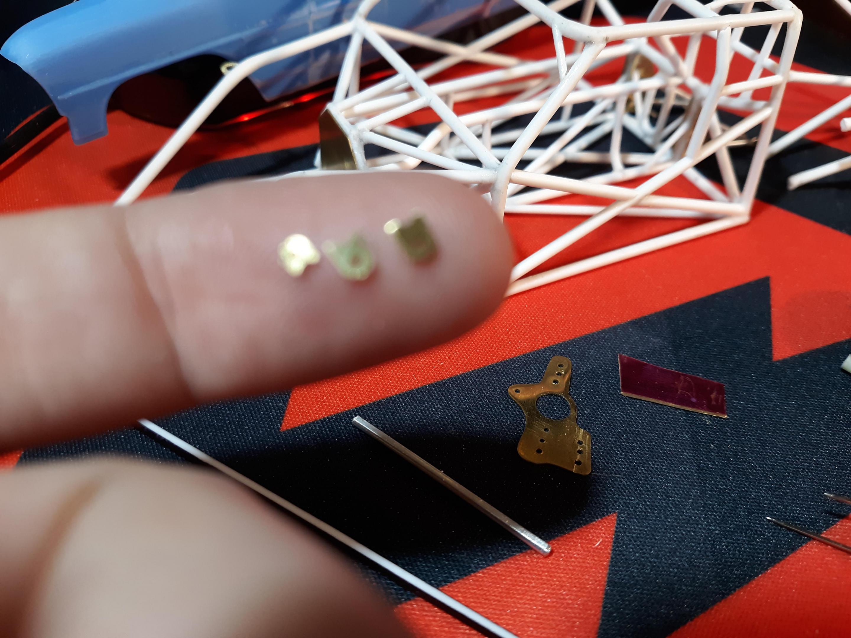

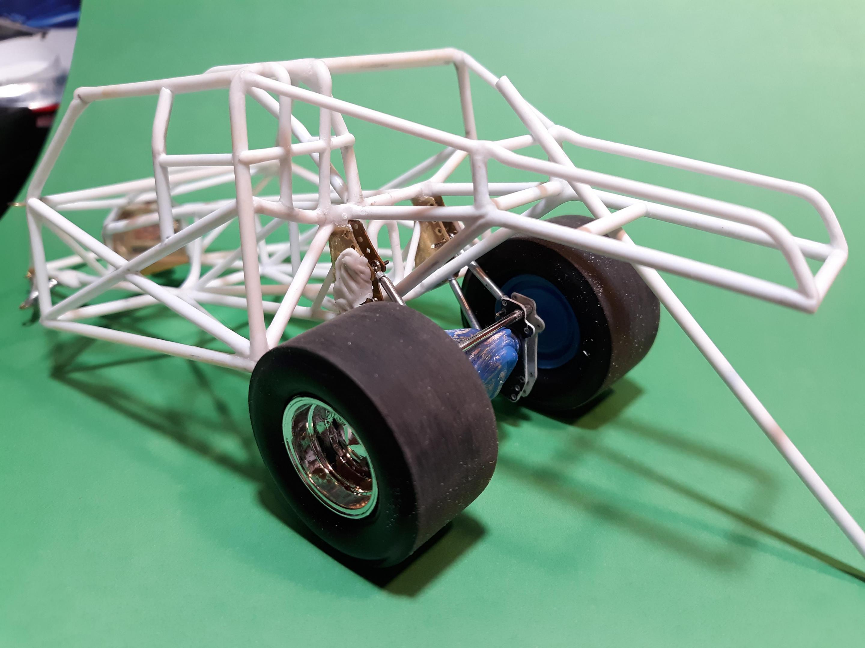

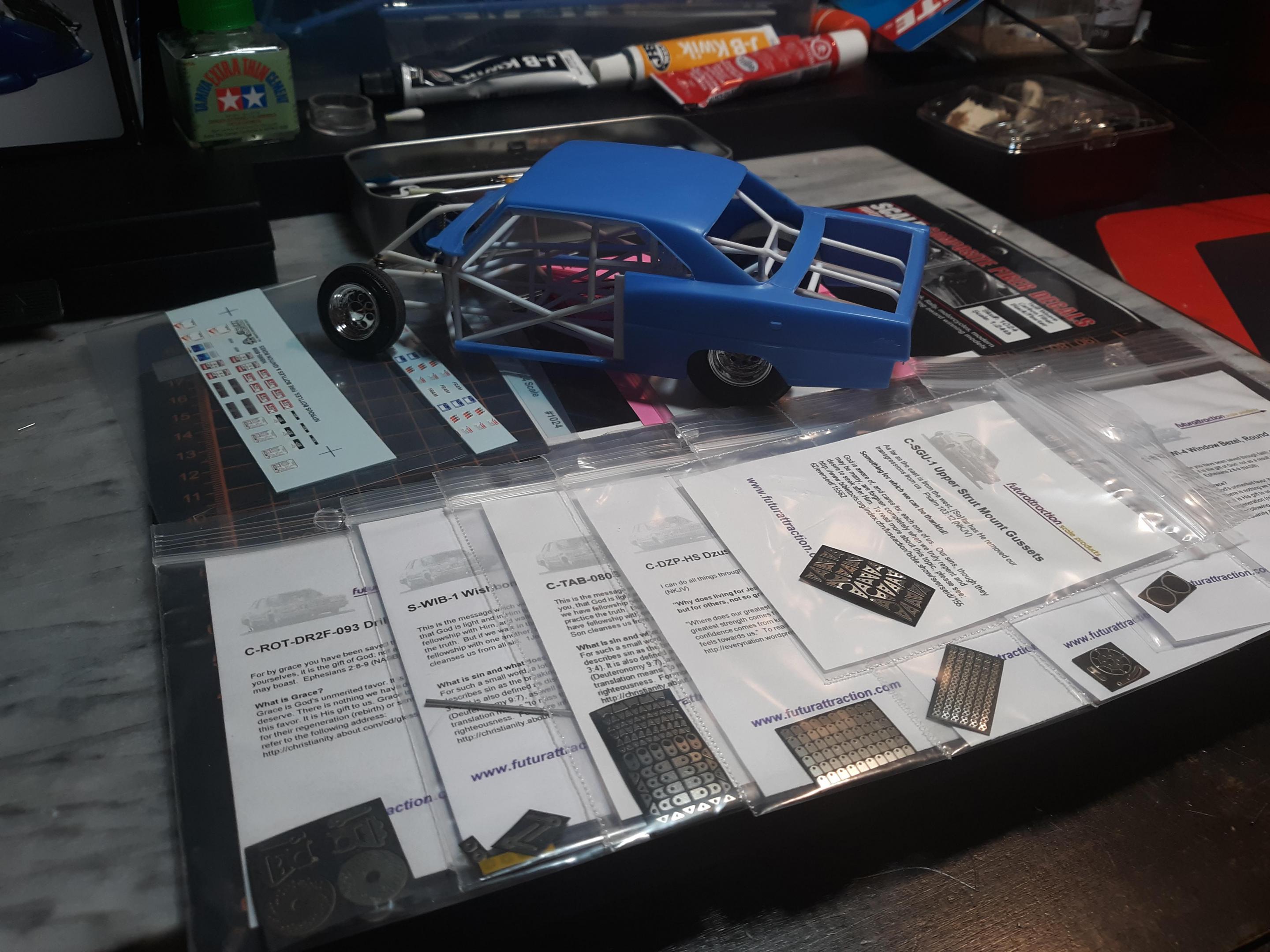

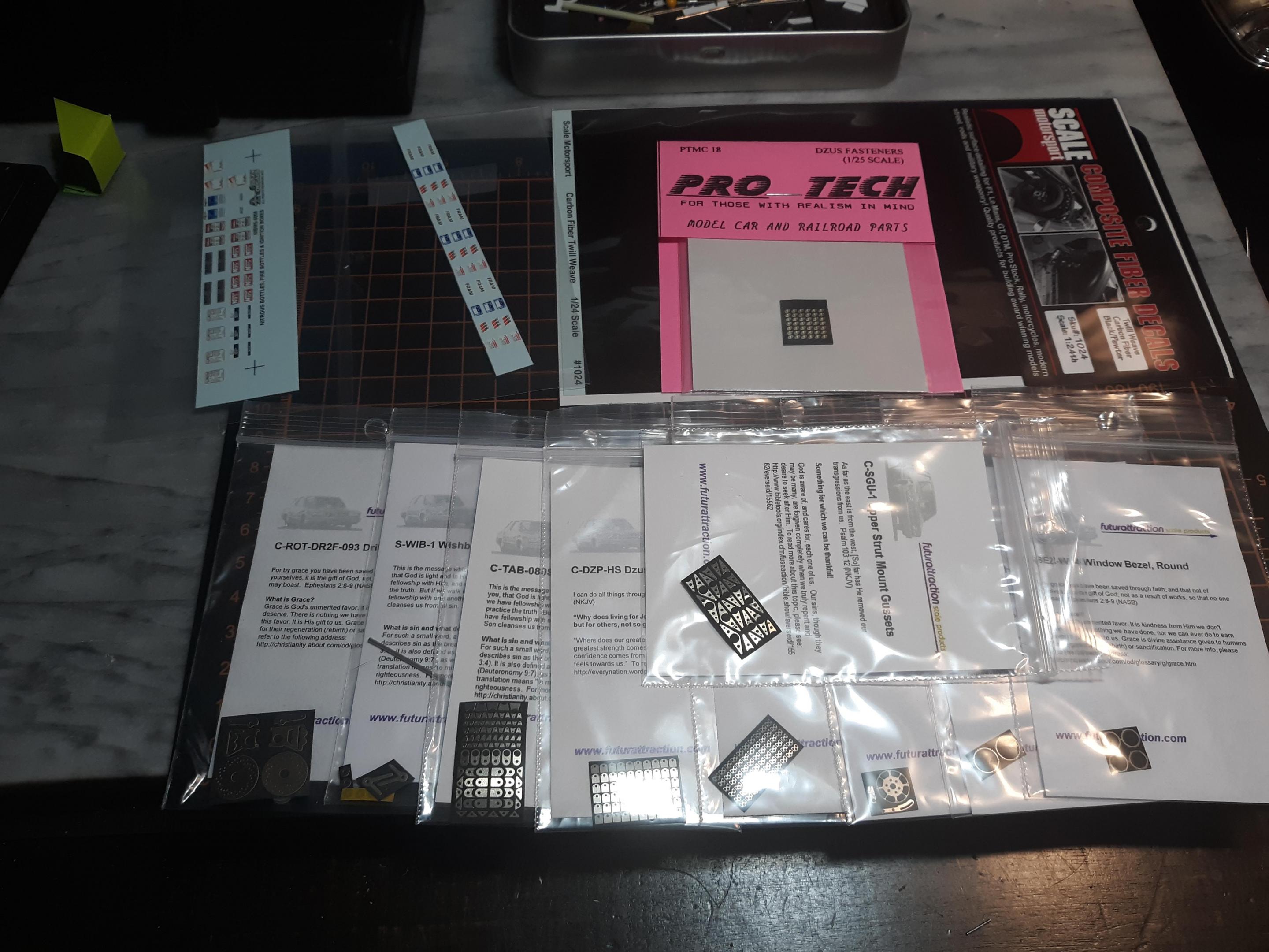

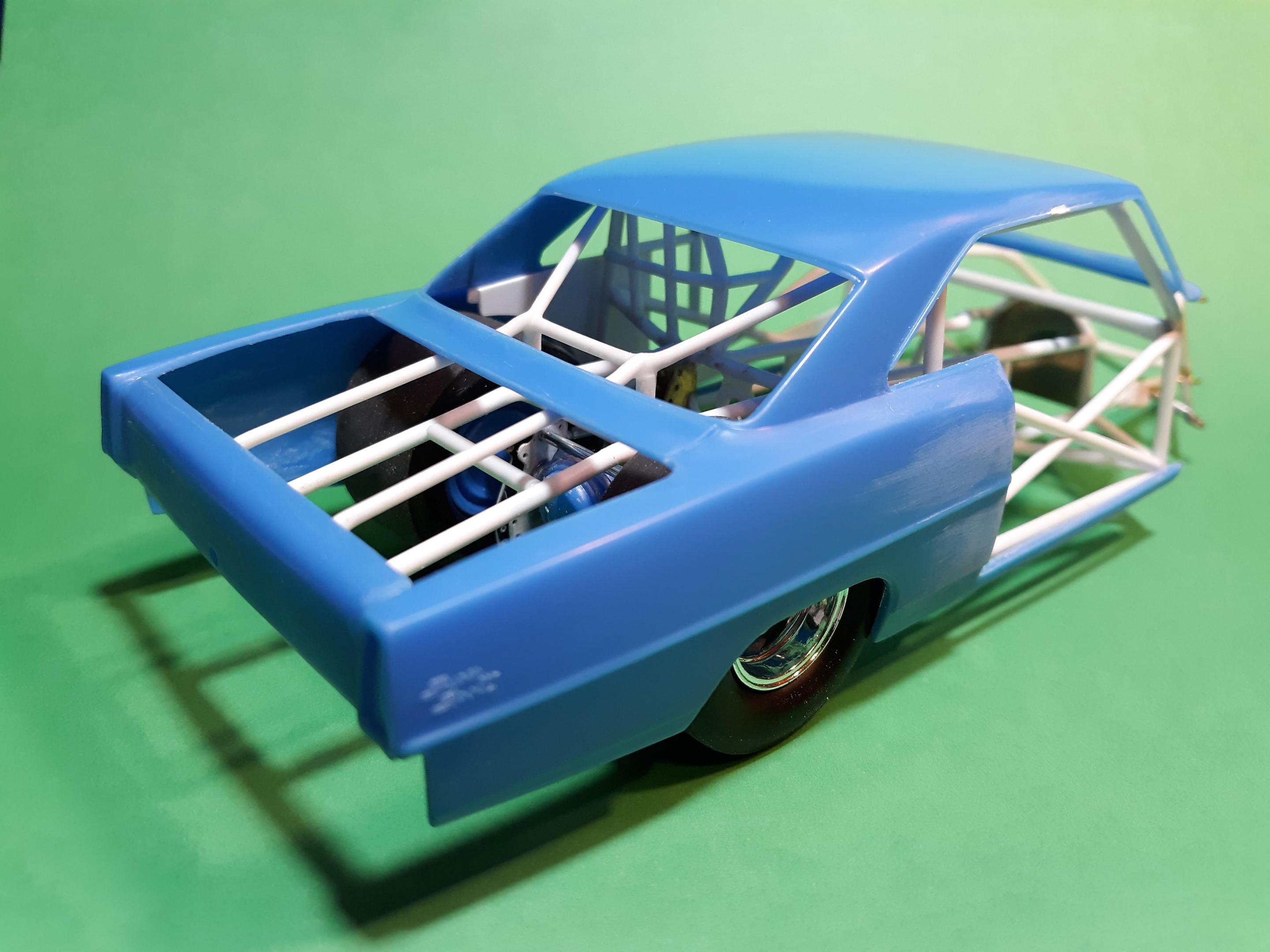

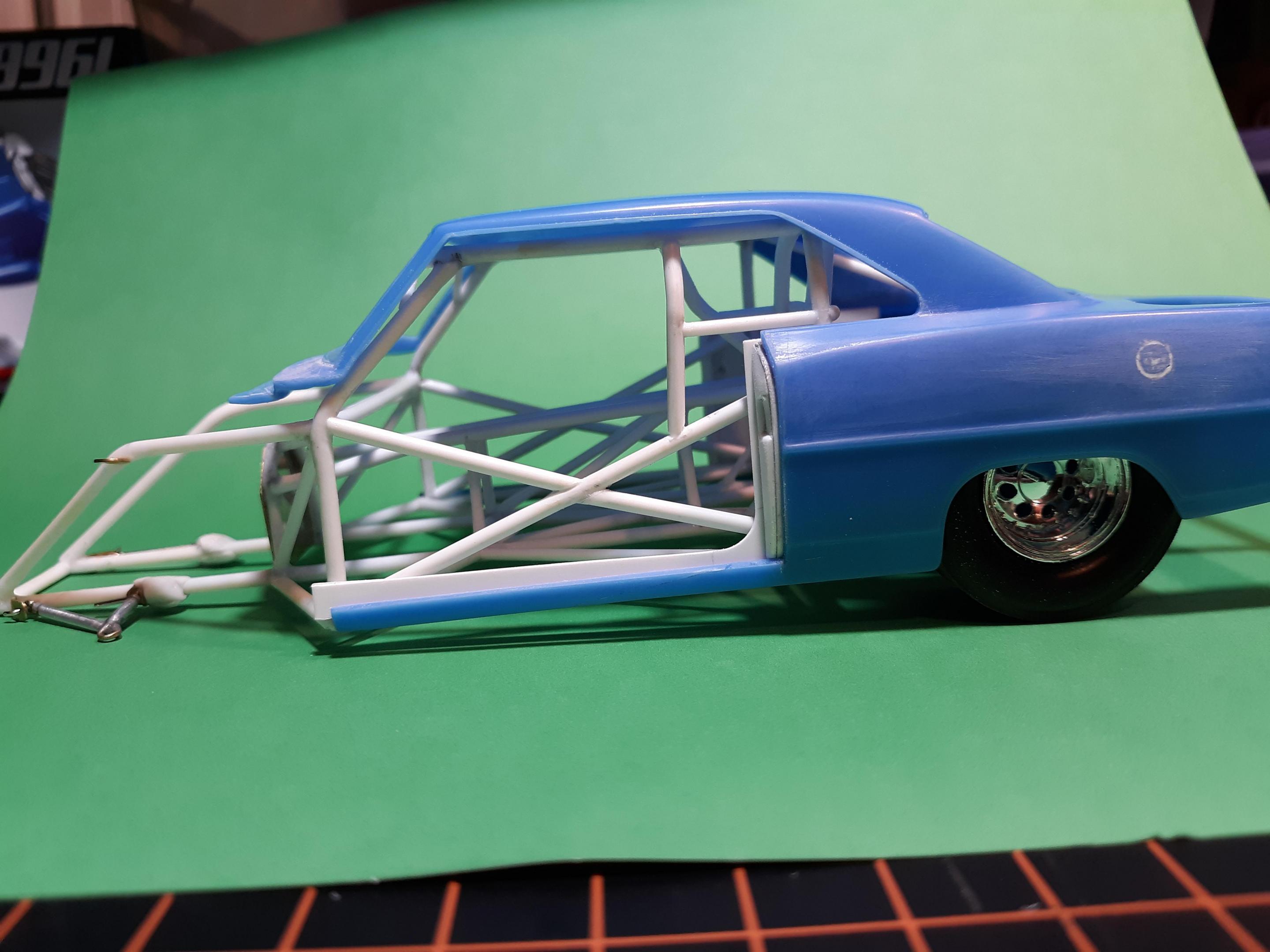

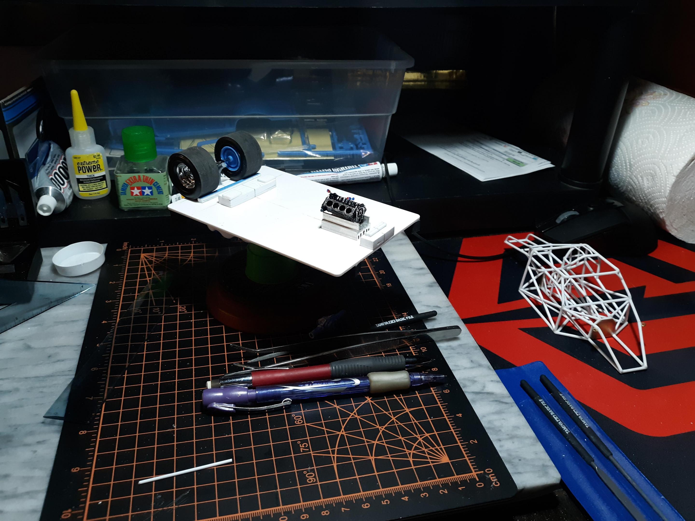

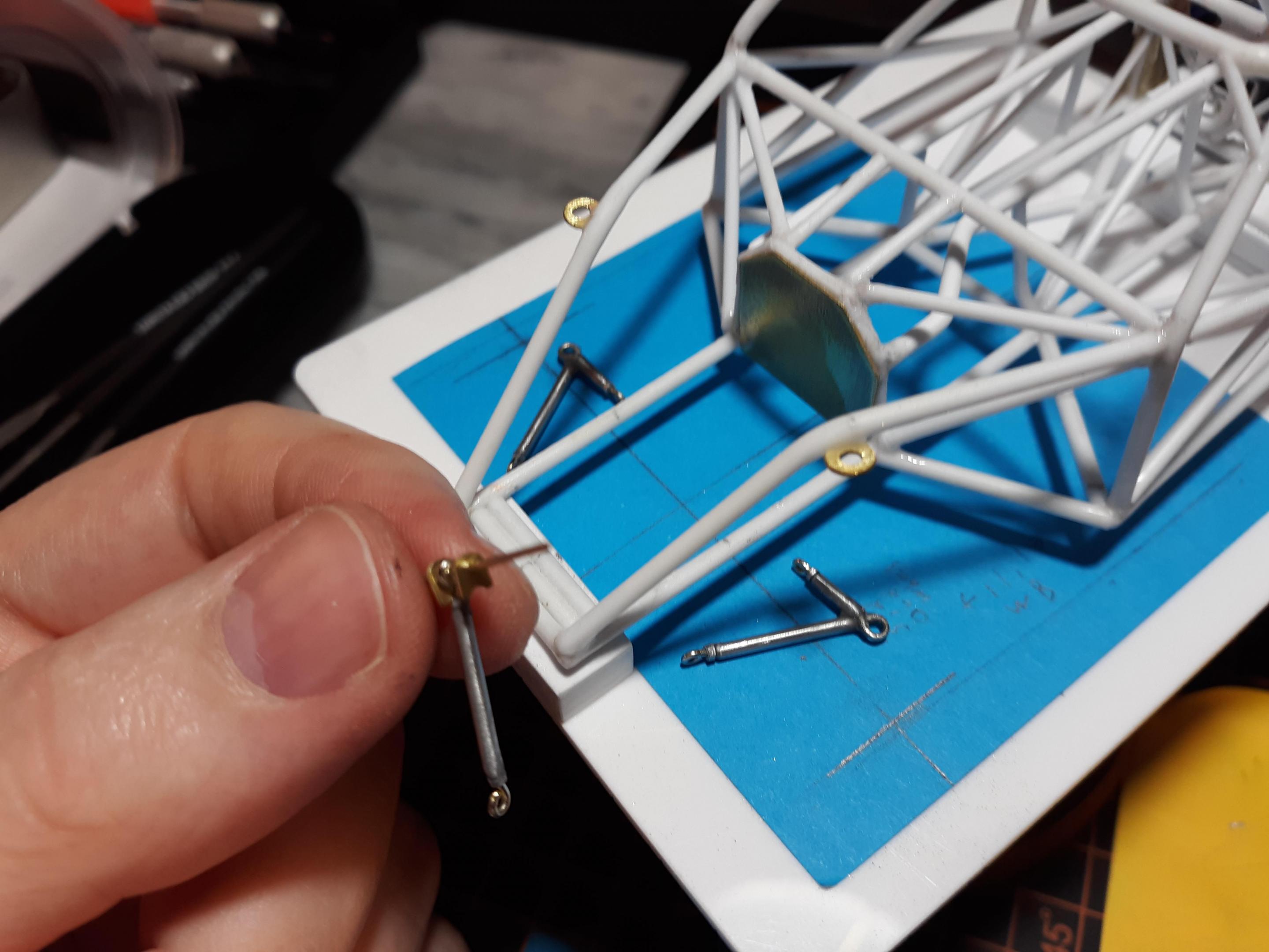

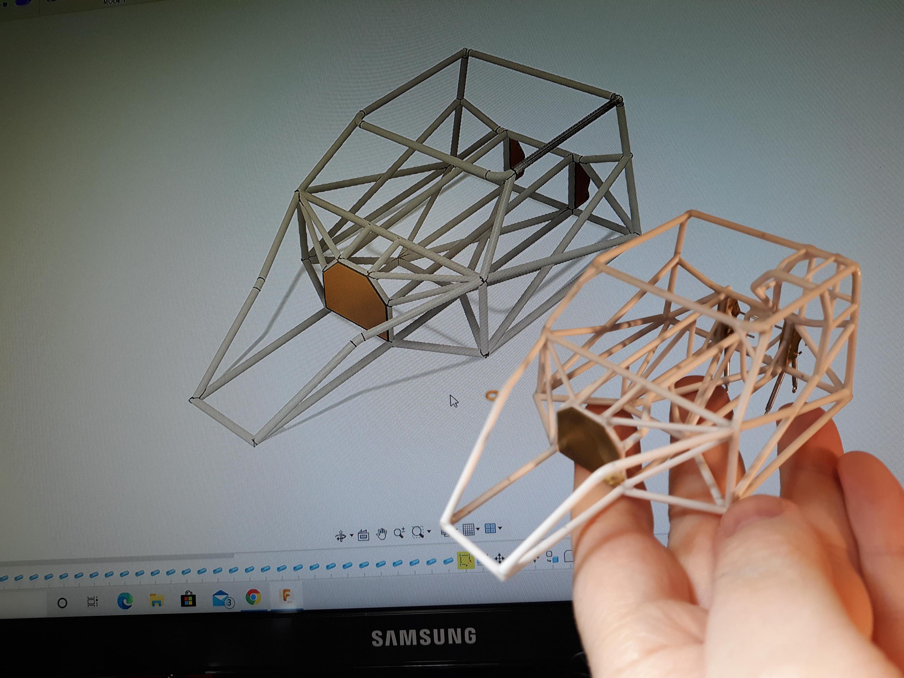

I got all the suspension pinned to the chassis and started skinning out the door jams. I've been spending more time building CAD parts in preparation for the 3D printer than working on the car.

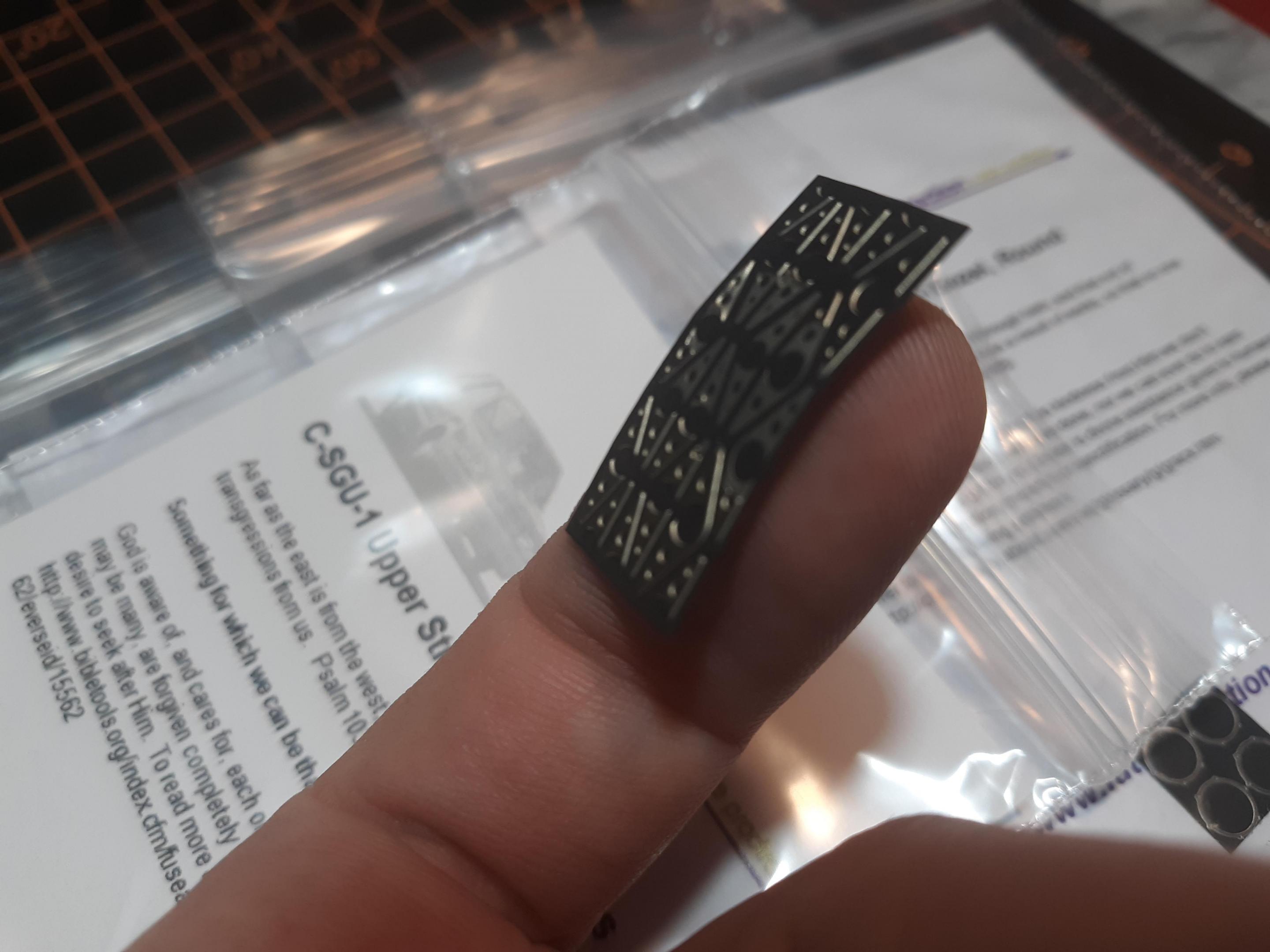

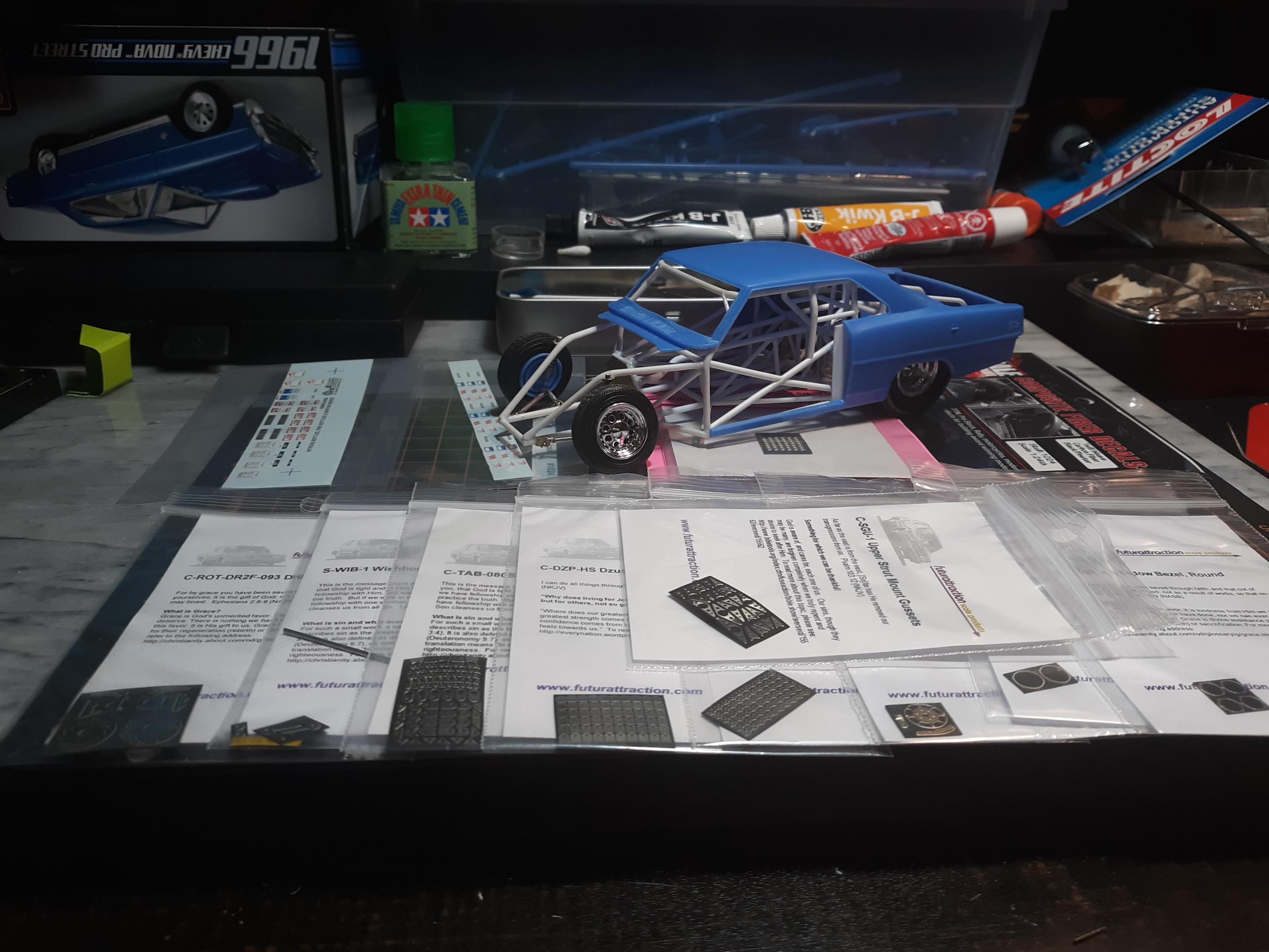

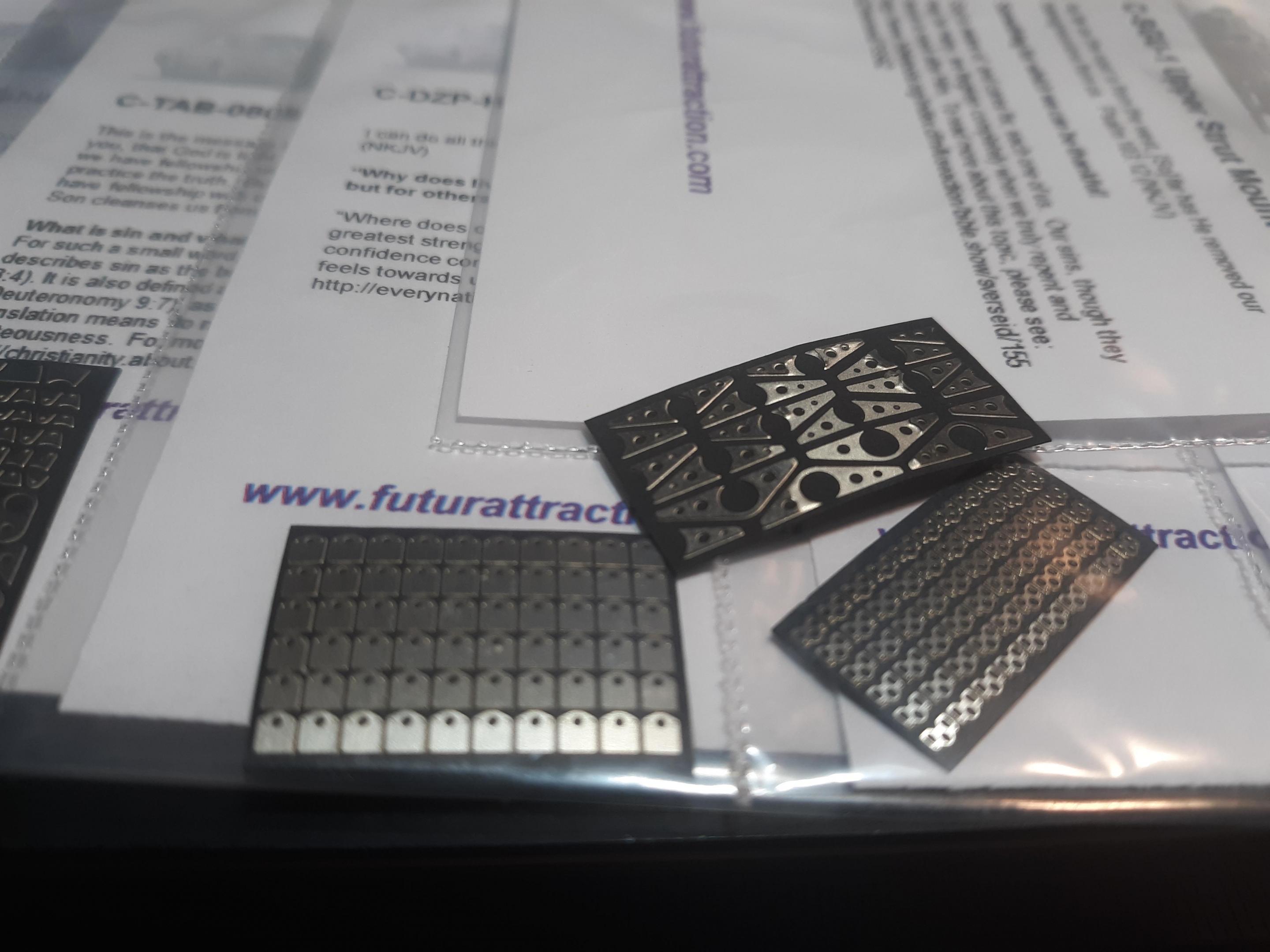

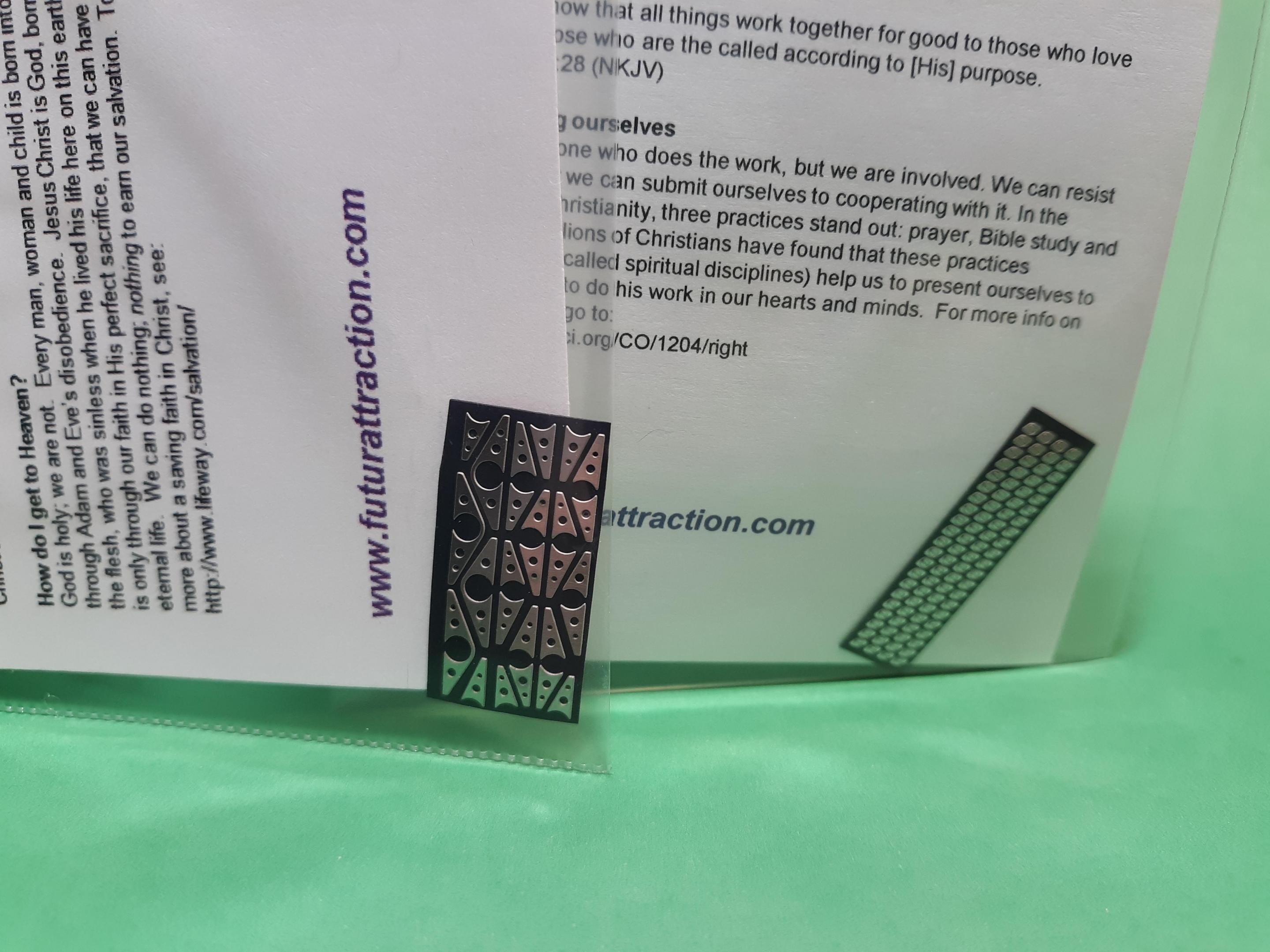

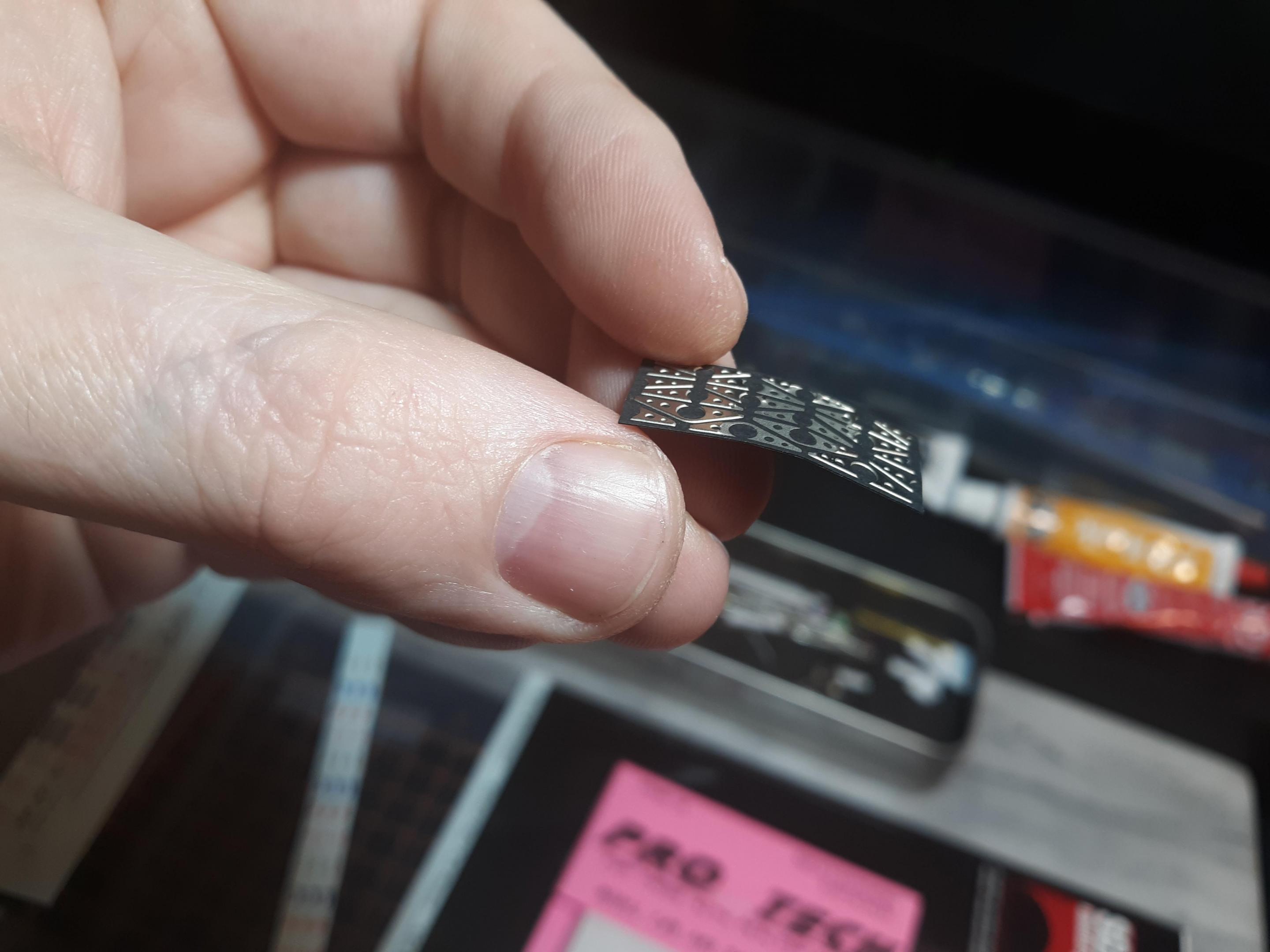

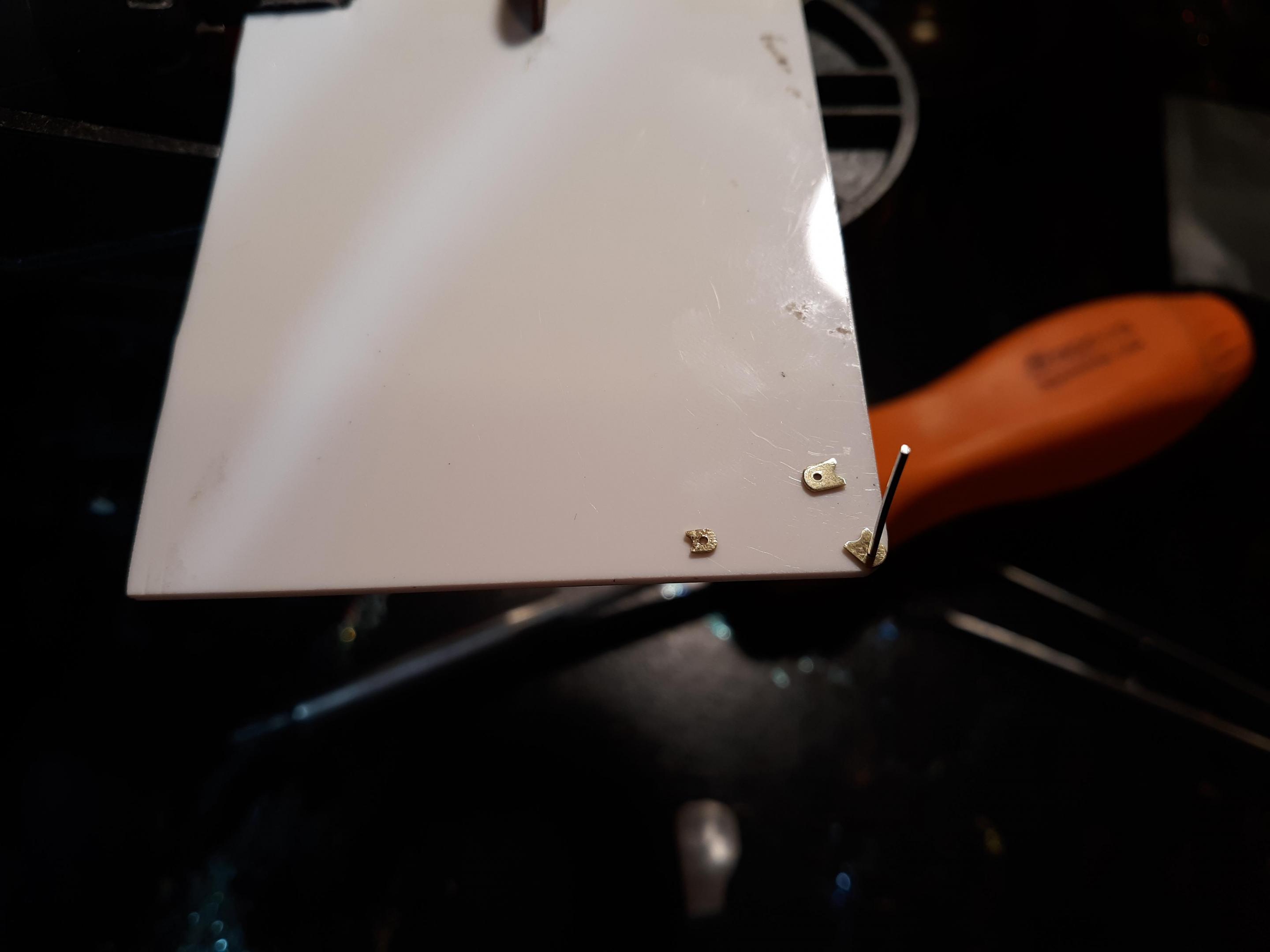

I got all my PE and decals in mail. Most of the parts look great, except for the front strut supports. Only half of them are useable, the rest are all eroded away.  Is this a common problem with PE parts? Is there another company that produces these that are better, or do I just order more and hope I get lucky?

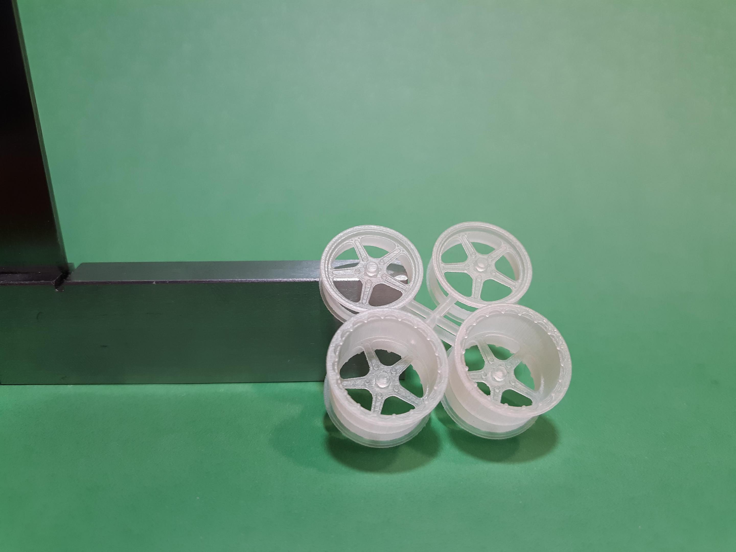

I'll be printing out my own parts before my Shapeways order gets here. I've got my RCD wheels ready to go and I'm making good progress on the billet AJPE 481X.

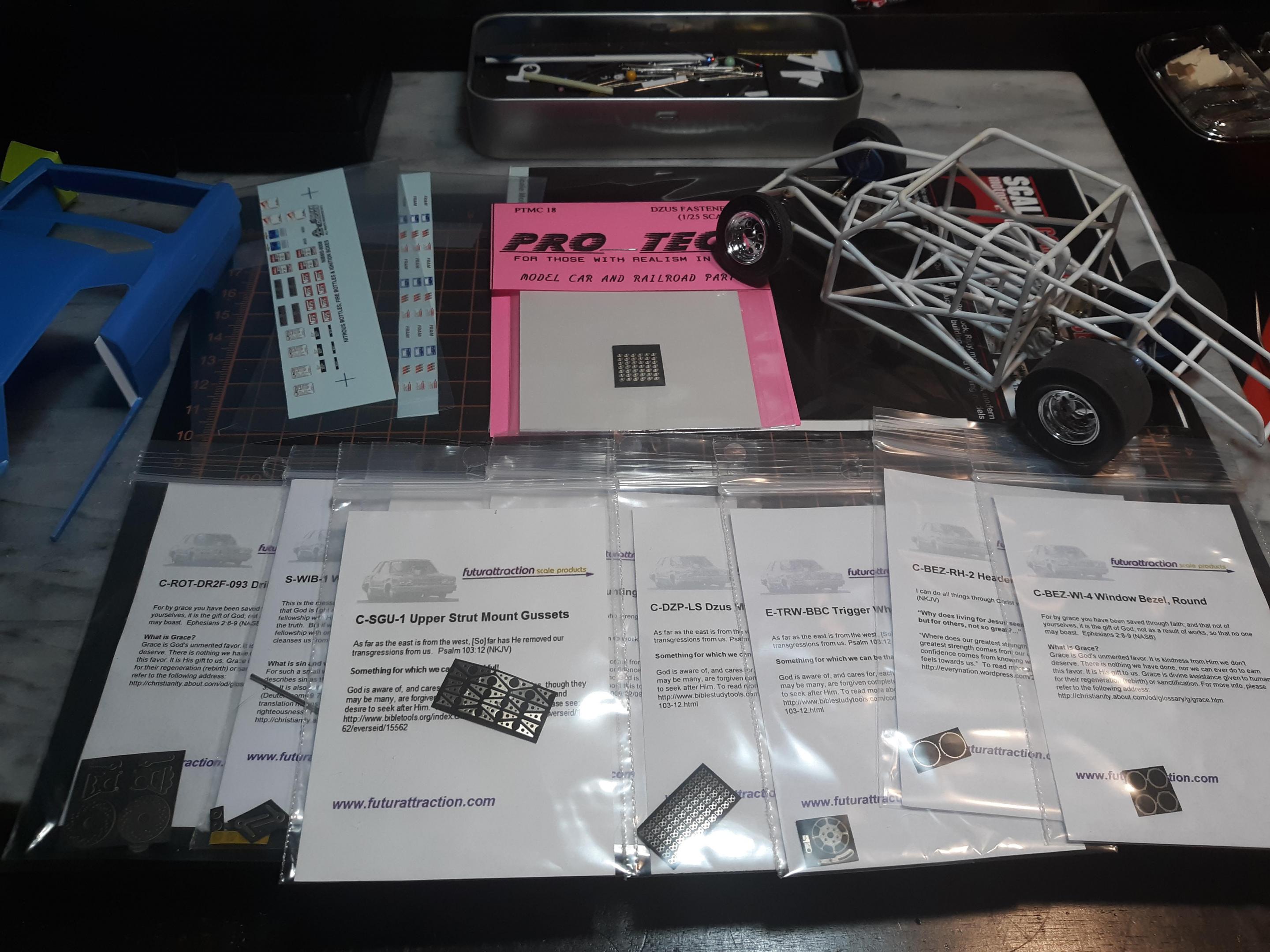

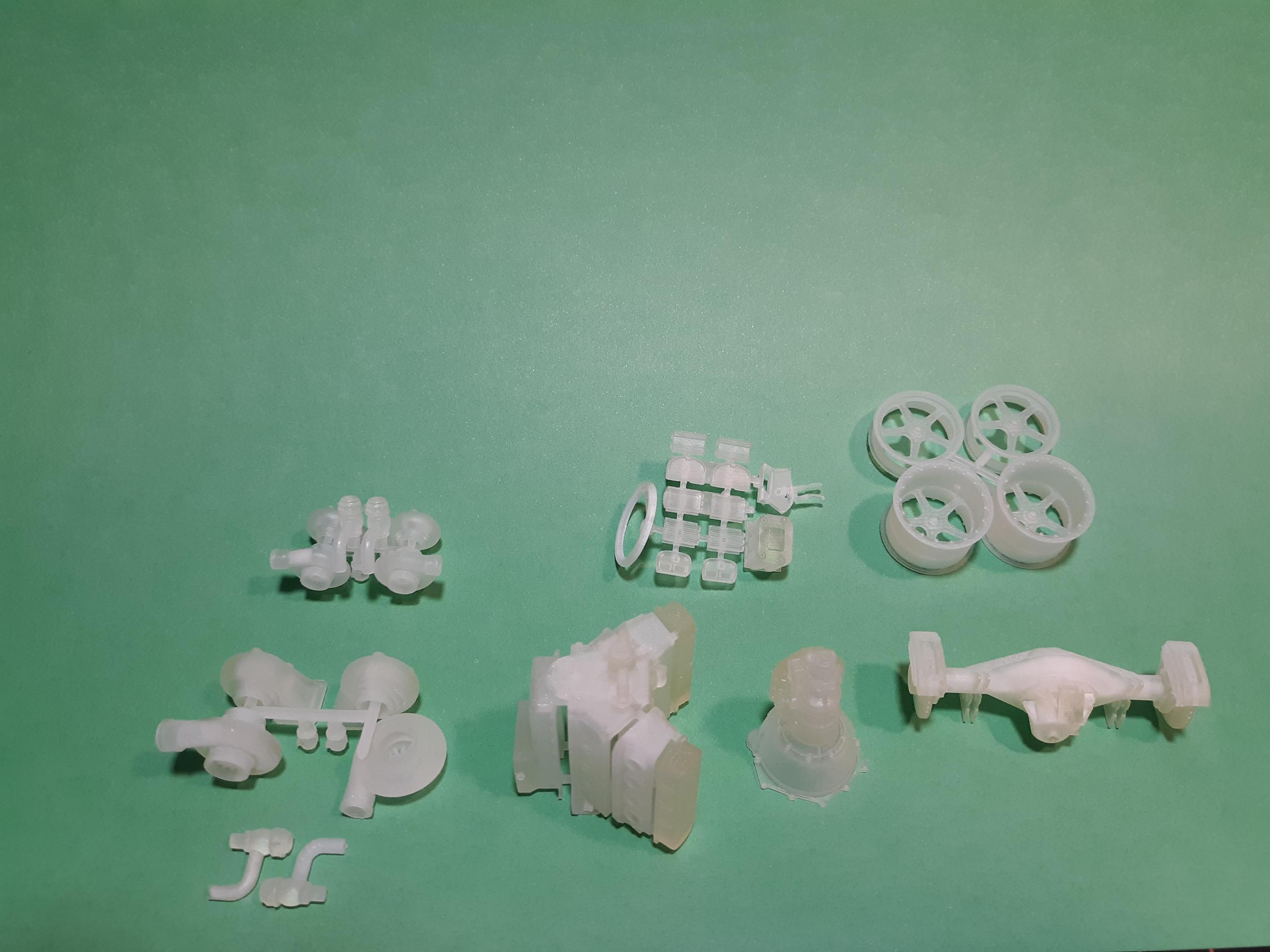

Got a bunch of stuff from the brown suit Santa Claus today.
I got in touch with Scott and he fixed my Strut Supports and I ordered some Dzus Fasteners from him. The new parts look great and dealing with Scott has been a pleasure.

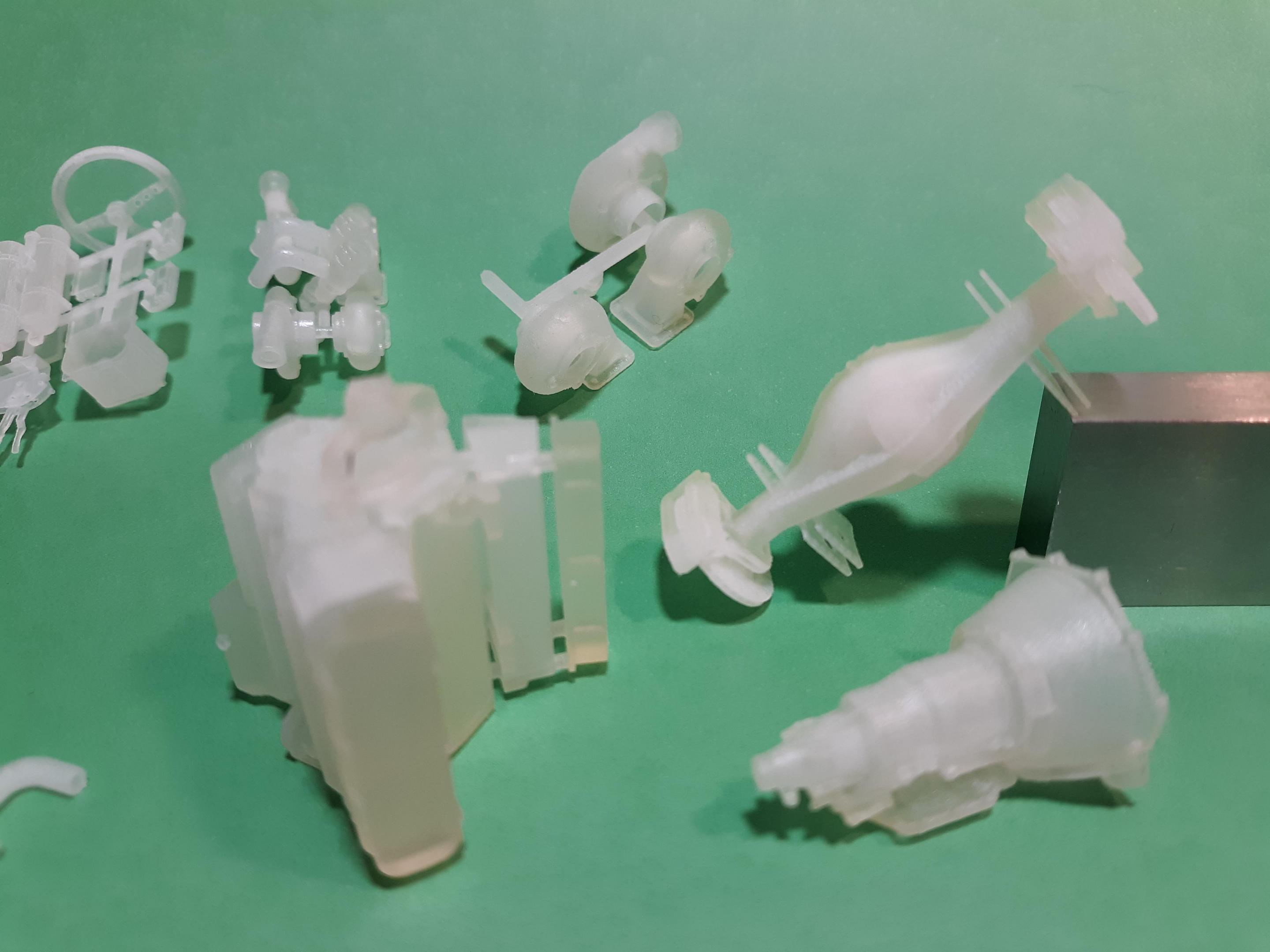

I also got my 3D printed parts and 3D printer.
