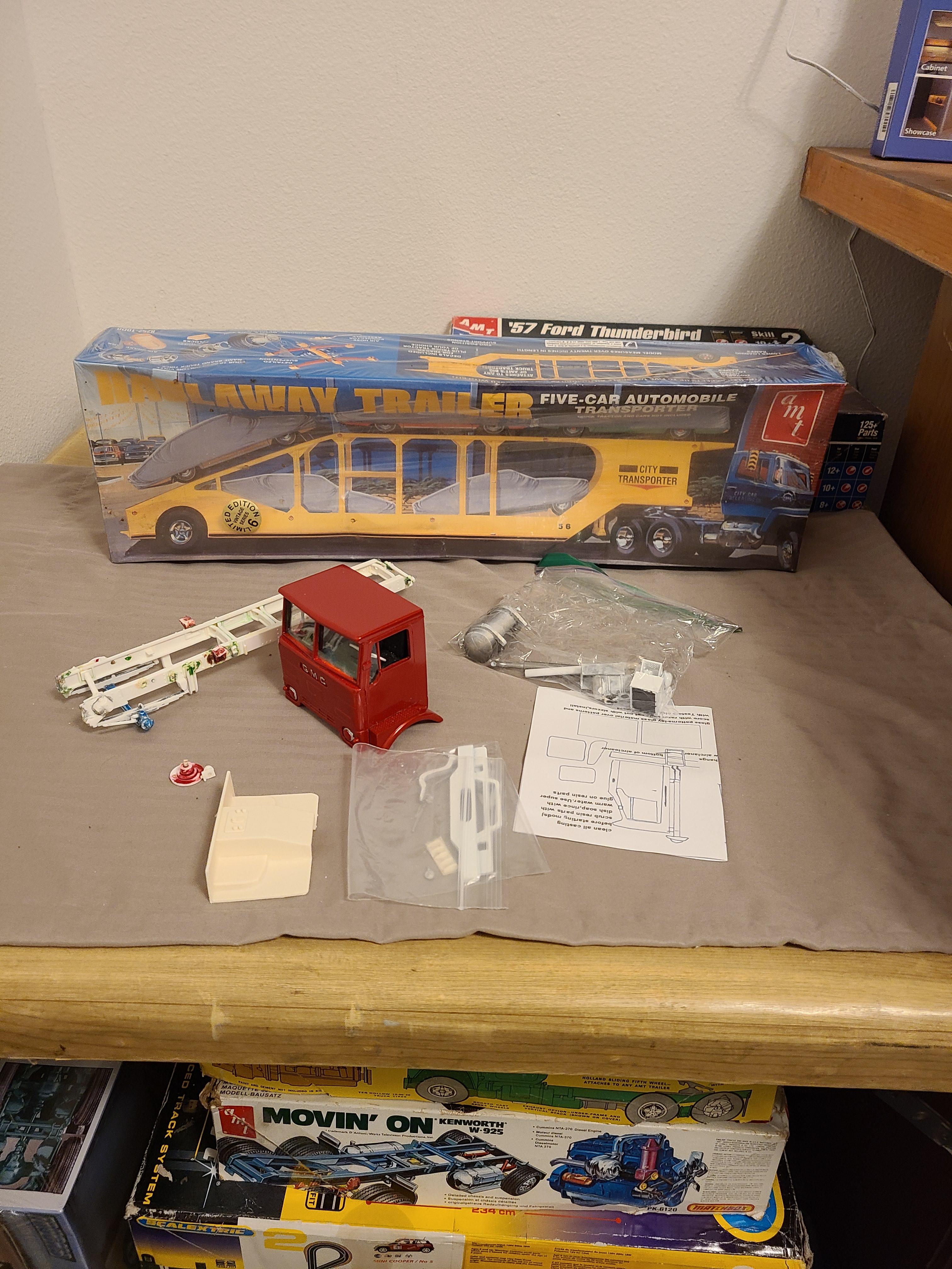

Sam I Am Posted January 9, 2021 Posted January 9, 2021 Finally decided to go with this. I received the cab in a trade with Jeff, and he said it was designed for a Titan chassis. (little does he know how many questions he is in for ?) So here is the starting point. The rest of the chassis will come from the parts box. First question. The Titan had a sleeper, this obviously does not. I personally think the truck would look better if I shortened the frame. Since I have not altered a frame on one of these, where should I take the section out, and how much should I take out. TIA

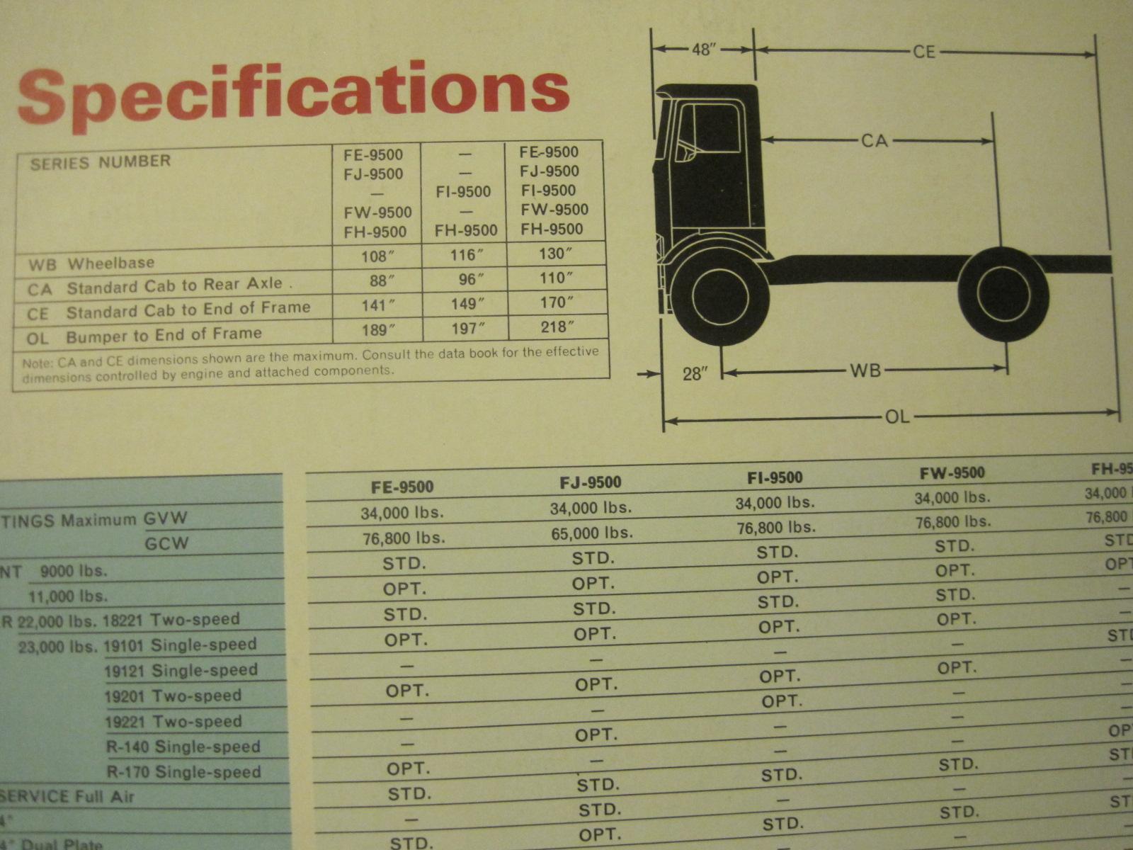

leafsprings Posted January 9, 2021 Posted January 9, 2021 Great to see another classic being built! The GMC and haulaway both date to the early 60's. Hope this data helps.

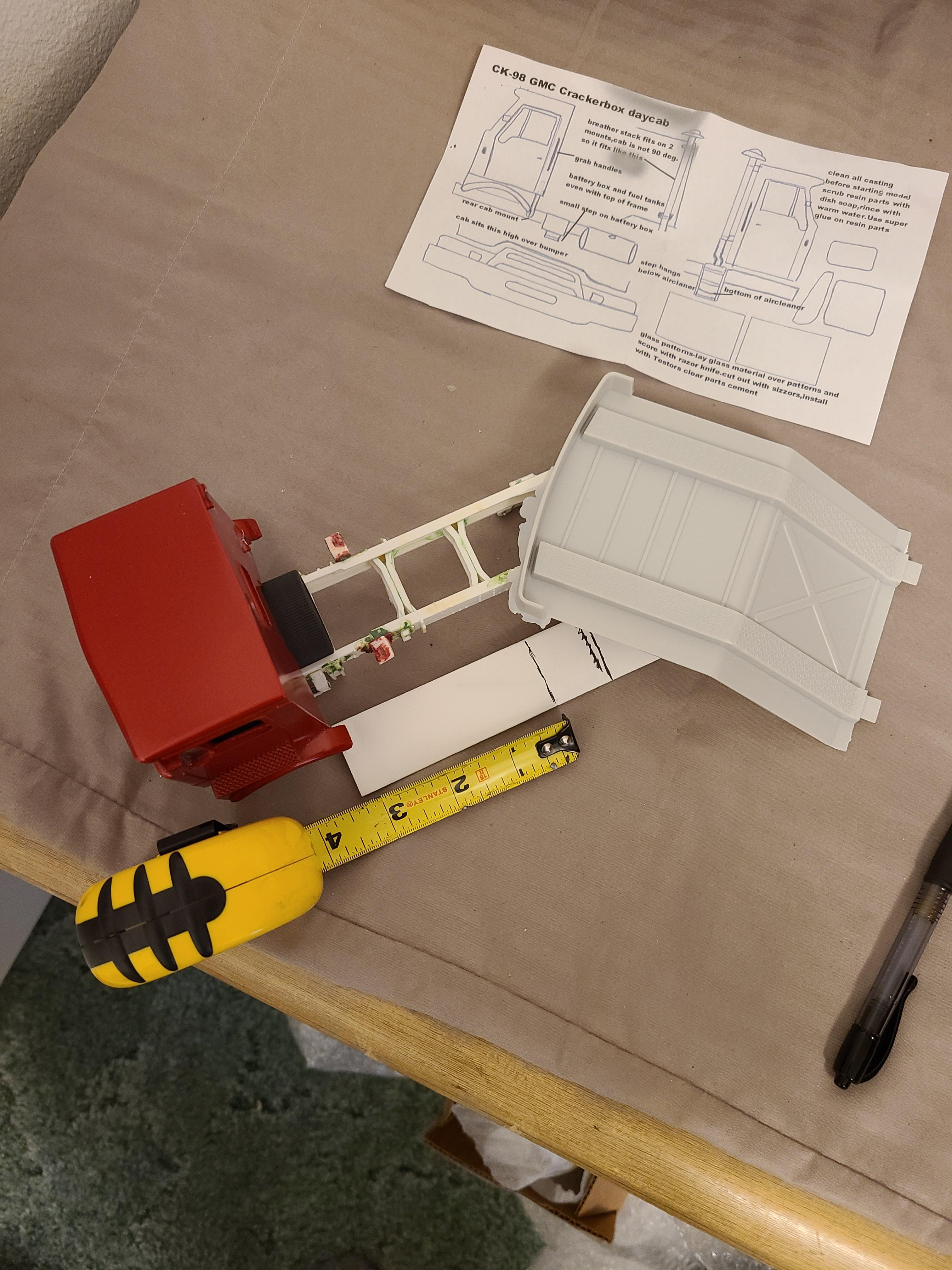

Sam I Am Posted January 9, 2021 Author Posted January 9, 2021 9 hours ago, Mopar - D said: Sam nice combination. When you are deciding on your frame length take the over hang on the trailer into consideration. So after mocking up everything. Cab is on the frame where the instructions recommend, pin on the trailer is centered in between the axles. Looks like 3.25 . So maybe take out two inches?

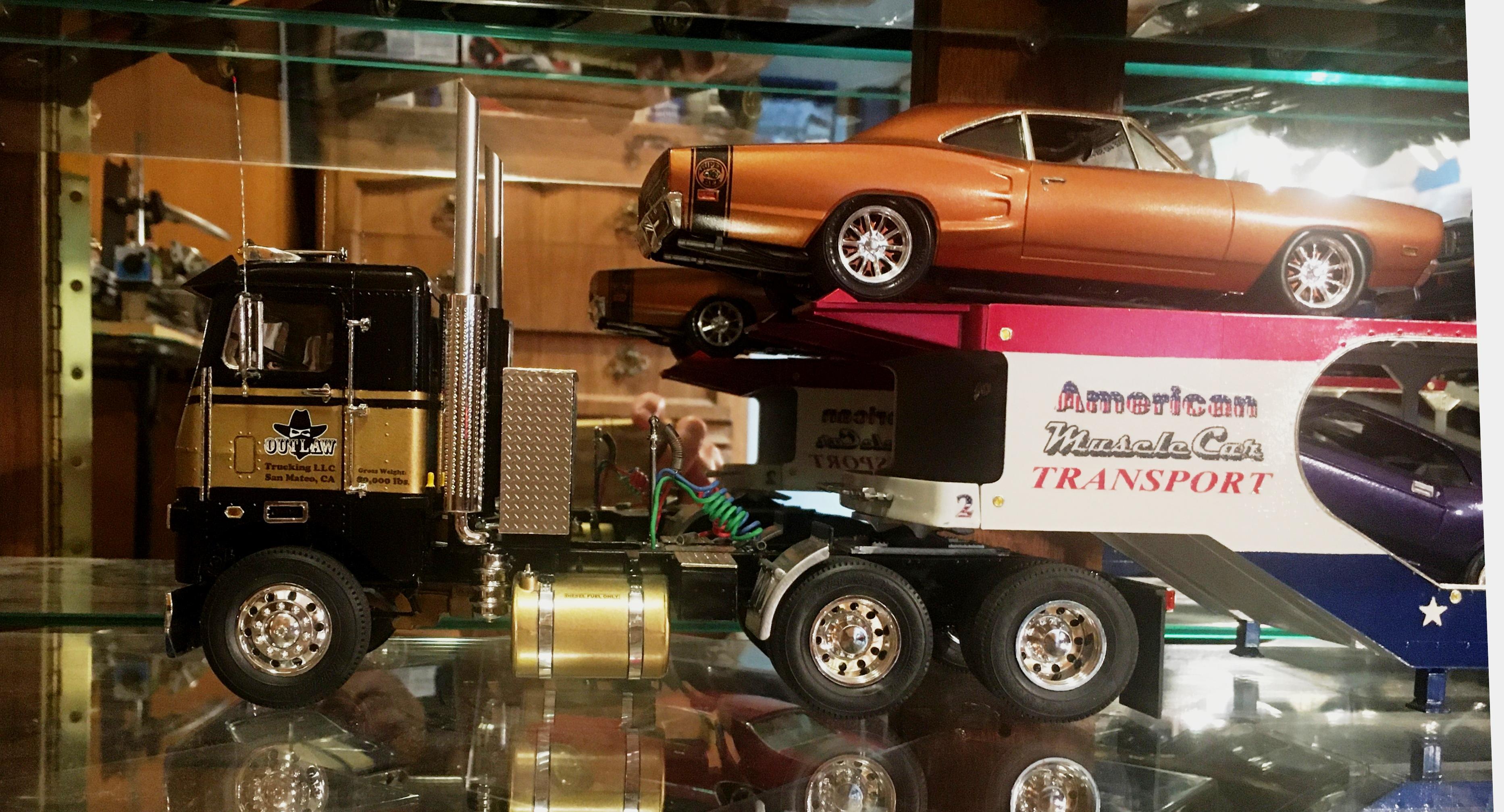

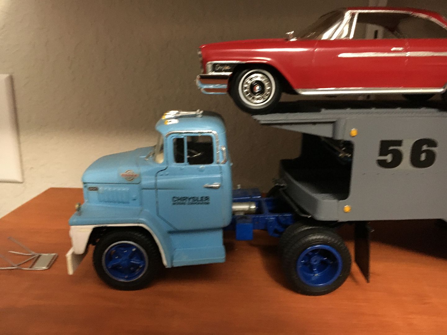

Mopar - D Posted January 10, 2021 Posted January 10, 2021 Sam you have to check on the upper part that overhangs. Check mine out.
Sam I Am Posted January 10, 2021 Author Posted January 10, 2021 Thanks for that Dan. Looks like I should just build the trailer first.

Bills72sj Posted January 11, 2021 Posted January 11, 2021 Yes, build the trailer first or at least mock it up enough. The upper level overhang and the overhang of long car can be your guide.

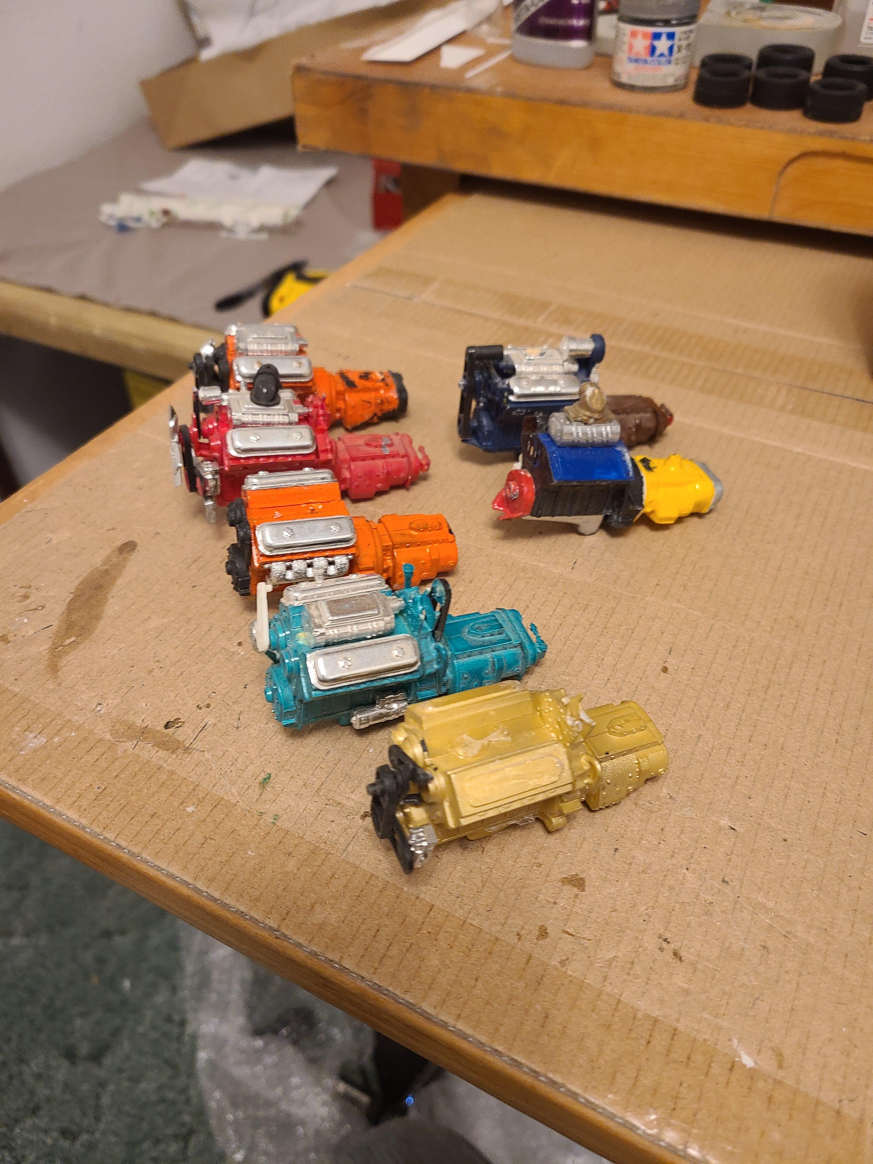

Sam I Am Posted January 11, 2021 Author Posted January 11, 2021 (edited) Thanks for confirming that for me Bill. I noticed that on the box the trailer had five spoke rims, and thought to myself, "cool". Big disappointment when I opened the box, just regular wheels. Fortunately I have a few extra sets of five spoke trailer wheels. I think I will go with a Detroit... Edited January 11, 2021 by Sam I Am
gotnitro? Posted January 11, 2021 Posted January 11, 2021 Cant go wrong w a Detroit!!! Hopefully you'll have clearance enough if ya choose the 8v

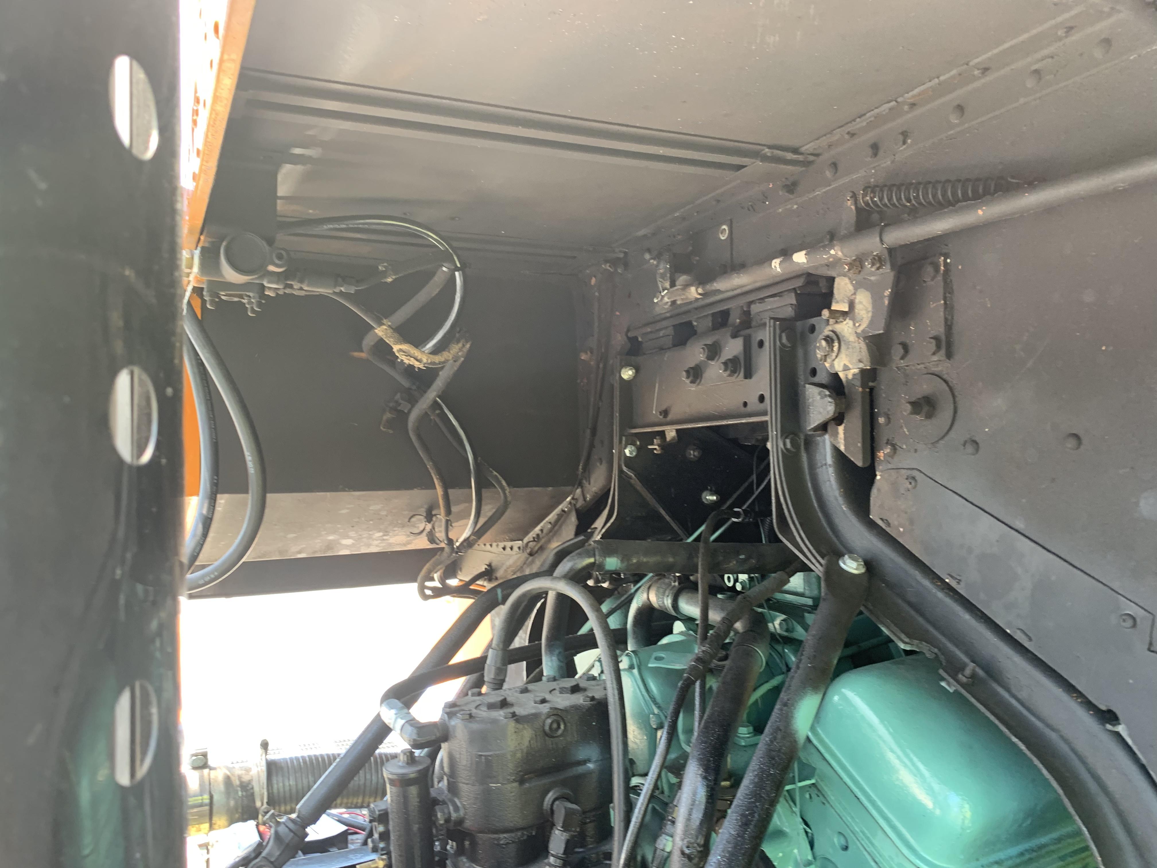

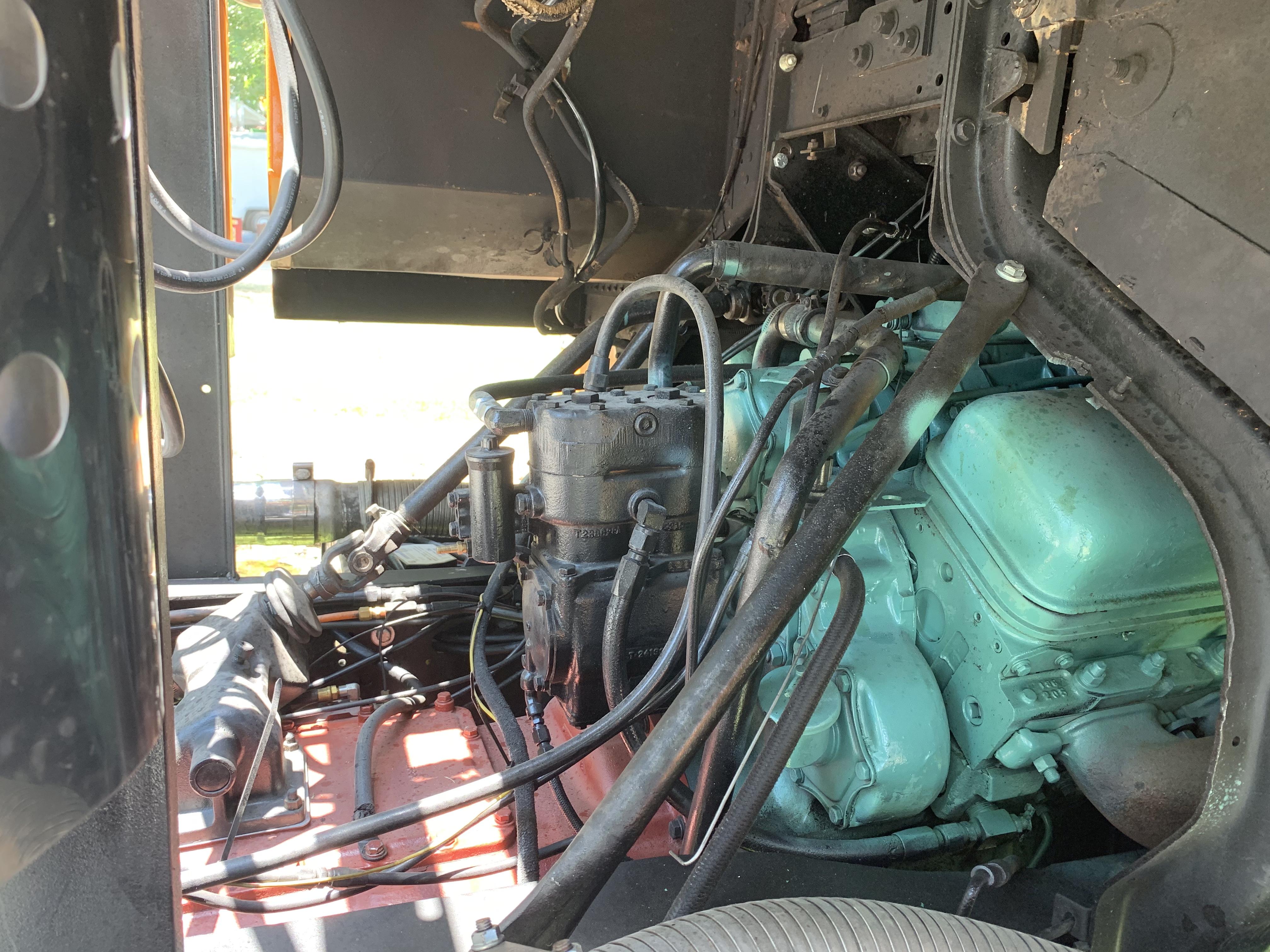

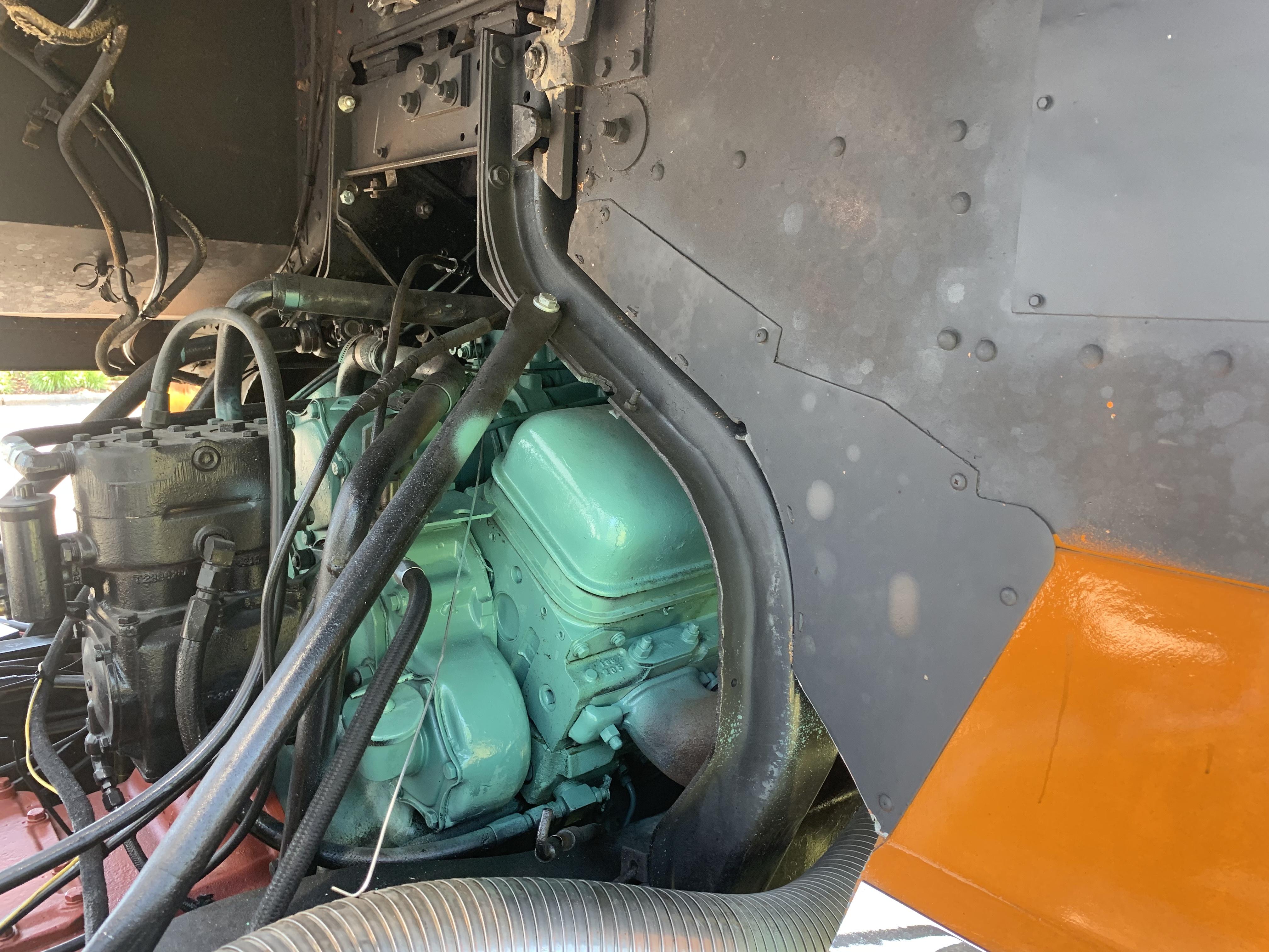

DRIPTROIT 71 Posted January 11, 2021 Posted January 11, 2021 11 hours ago, Sam I Am said: Thanks for confirming that for me Bill. I noticed that on the box the trailer had five spoke rims, and thought to myself, "cool". Big disappointment when I opened the box, just regular wheels. Fortunately I have a few extra sets of five spoke trailer wheels. I think I will go with a Detroit... 48 minutes ago, gotnitro? said: Cant go wrong w a Detroit!!! Hopefully you'll have clearance enough if ya choose the 8v Great choice for an engine. It will be a tight fit, but don’t get frustrated. Sometimes resin and kit manufacturers alike don’t get the floor pan exactly right. Don’t be afraid to trim or even make a new pan. I have had to completely remake a floor pan before. A good example was my H-63 Mack that I put a 12v-71 in. As you can see on the real deal, it is a tight fit.
Sam I Am Posted January 11, 2021 Author Posted January 11, 2021 (edited) 54 minutes ago, gotnitro? said: Cant go wrong w a Detroit!!! Hopefully you'll have clearance enough if ya choose the 8v So are you telling me when I shorten the frame, don't stop there? Edit: just saw your post Brian. Thanks for that pic...I think. lol Edited January 11, 2021 by Sam I Am

DRIPTROIT 71 Posted January 11, 2021 Posted January 11, 2021 (edited) 7 hours ago, Sam I Am said: So are you telling me when I shorten the frame, don't stop there? Edit: just saw your post Brian. Thanks for that pic...I think. lol I have a few reference photos if you need any, I will be glad to post them. This was a sleeper cab, but should be the same as yours as far a mounting, because as you can see the sleeper is just over hang. Edited January 11, 2021 by DRIPTROIT 71

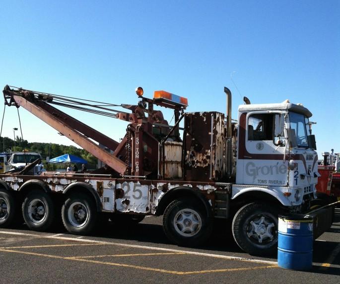

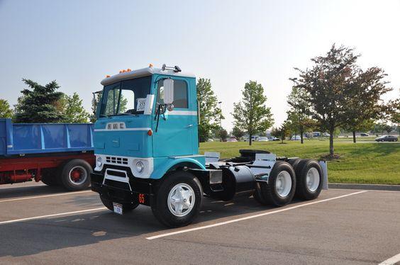

Sam I Am Posted January 11, 2021 Author Posted January 11, 2021 Thanks Brian, I would appreciate those pics for future reference. Right now,, for mock up sake, I would like to know if the Titan location for the engine is ok, or if I need to lower it in the frame. Oh, and I started looking for reference pics. The first two are what I am going after, the last ones are squirrels. ?
