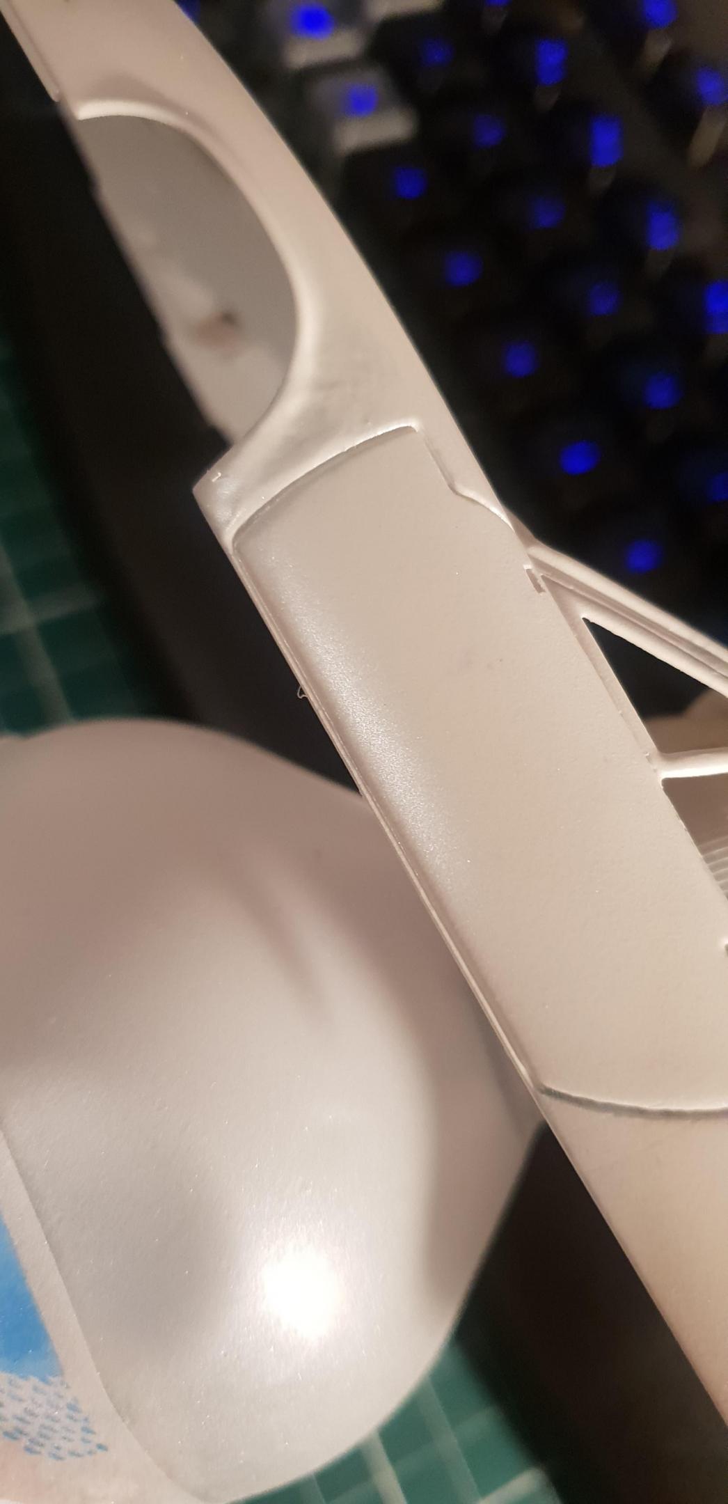

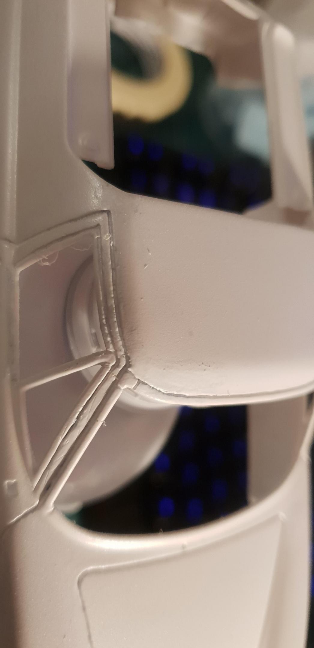

Hello everyone! I've literally just started building my first car and have obviously ran into some problems. It's a Lotus Europa 1/24 from Tamiya and the main shell that came off the sprue is white. After the first base coat, I had some tiny paint holes and build up, like bubbling or mounds, one area near the front fender, and one under rear bumper.
This is the part where I think I began to get overcomplicated and ahead of myself. I tried sanding down and filling the holes with Tamiya basic putty which is grey. I waited a day for the putty to settle then sanded it so was smooth and in the shape of the shell, and the holes were filled out. Then, since I sanded the first basecoat (because clear coat is not recommended to go on a sanded base coat IIRC?)I tried spraying another (2nd) basecoat of the pearl white, and to my dismay, I found out that the pearl white spray (TS-45) I was using was very translucent, and showed the grey putty areas. So, I sanded the car again trying to get rid of as many grey areas as possible. At this stage I have ran out of spray (100ml can), and am too eager to finish the shell. Now this was probably another rookie mistake,  I tried hand painting the more difficult grey areas with Tamiya flat-white enamel because I couldn't wait to buy another can of the pearl white.
Now I've bought 2nd can 100ml can of pearl white and sprayed the other parts (bumper, back engine cover, spoiler) and then on the main shell yet another basecoat (3rd). There is still some orange peel from my amateur spraying, one or two grey putty areas (3-5mm in size) you can see when it is well lit, as well as some scribing scratches. You can also see slightly raised patches where I've used some enamel in my amateur attempt to cover up the grey putty areas.
Now I've used two cans of Tamiya pearl white spray, and still have a pretty mediocre shell. Please refer to the photos.
So now, do I buy third can of the pearl white and spray to cover up the grey regions and fill scribing mistakes? Do I sand down everything and start again? Or should I just clear coat it now, polish, and just build the car.
Regards
LG

If I understand correctly, you applied putty to correct problems found in the first coat of paint.  Don't do that, you'll then have to put a lot more primer and paint on in order to smooth everything out.  Instead, remove the paint and start over.  Tamiya lacquer can be removed with 91% rubbing alcohol which can be problematic to get lately.
Once everything is clean, I'd start over with a base coat of solid white, or white primer if any putty was needed anywhere.  (The previous "paint correction" putty should all be removed...in general, most, if not all, paint removal will take putty along with it.)  The bubbling was likely caused by applying the paint right after shaking it.  I believe there is propellant mixed in with the paint.  Next time, let the can sit for a few minutes after shaking before spraying.  Even then, spray something else briefly before going right to this project.
The pearl will be translucent, so you do need a solid base color under it.  When applying one coat of Tamiya over another, you'll have to check the directions...you may have to apply the pearl (and clear over that) within a certain amount of time, or wait a couple of weeks to make sure the base is thoroughly dry.
No doubt others will offer advice too...let a few more folks chime in before finalizing a plan of action.

A couple of things.
Fiirst washed the body with dish soap and water, and let it fully dry
Next, use white primer on the body before any color coats.
After then paint it with the color coat
And sanding and body prep should be done before any painting
Also, is that a resin model? I have only seen pin holes like that in resin. That needs a bigger cleaning if it is. I think most people wash resin with bleche white, but i would wait for other, more experienced resin modelers chime in

To echo what Mark said, Tamiya paints (especially in the cans) are notorious for having IMO way too much propellant action in their cans for spraying. I get why they do that to keep paint flow consistent, but I wholly recommend doing what he said.
Strip the paint thoroughly and then repaint. Yes, letting the can sit for a spell (maybe a 1/2 hour) till the propellant settles down is not a bad idea at all. I take it you're not familiar with airbrushing, but this is the chief reason I'll decant spray cans and airbrush them on my own. I don't trust cans (even Tamiya's) for painting bodies as I've had some rather bad issues with them in the long ago past.
As I can see from my end, that looks an awful lot like trapped propellant which decided to gas out in bubbles after you did your paint coats.
Hope this helps.....to be honest that's not one of my favorite things------repainting bodies. But, it's a necessary evil if you want the model to be painted and look nice when done.

From the looks of your paint job, you're holding the can way too close to the body when you're spraying it. That's what's causing the air bubbles. You want to hold the can 8-10 inches away when spraying.
Whenever you have a paint mishap, dumping on more paint isn't going to solve the problem. Stop, correct the issue and begin again.
As I have also recently learned, Tamiya Pearl White can be a finicky color to paint. Even the slightest variance in the base color will show through. If you use gray putty on the body before primer, you need to spray the whole body with gray primer before white primer to get it all a solid color. Those gray spots will show through white primer as well. If you don't use any putty, you can shoot it with white primer. Once you have the body in a solid white primer base, two coats of Pearl White is all you'll need. Then you can spray a couple of coats of TS 13 over the Pearl White to get a decent shine.

Those bubbles will form in Tamiya paint when your wet coat is applied to thick. Tamiya works best with 3 light coats, or more (I actually do multiple light coats over high spots with an airbrush first). Follow with wet coats. Tamiya paint is actually very forgiving and shrinks quite a bit while drying, but still has its limits. I think the bubbles are gasses in the paint that are trapped due to the thick application, which could be caused by:
1. Painting too close to model
2. Painting too slowly over model
Watch some YouTube videos if you can and see how far away to paint and about the speed you want to pass the paint can over the model. Practice helps, but it’s tough to practice when spraying a $8 dollar can of paint.
You should be able to easily paint an entire model with one can of Tamiya.
