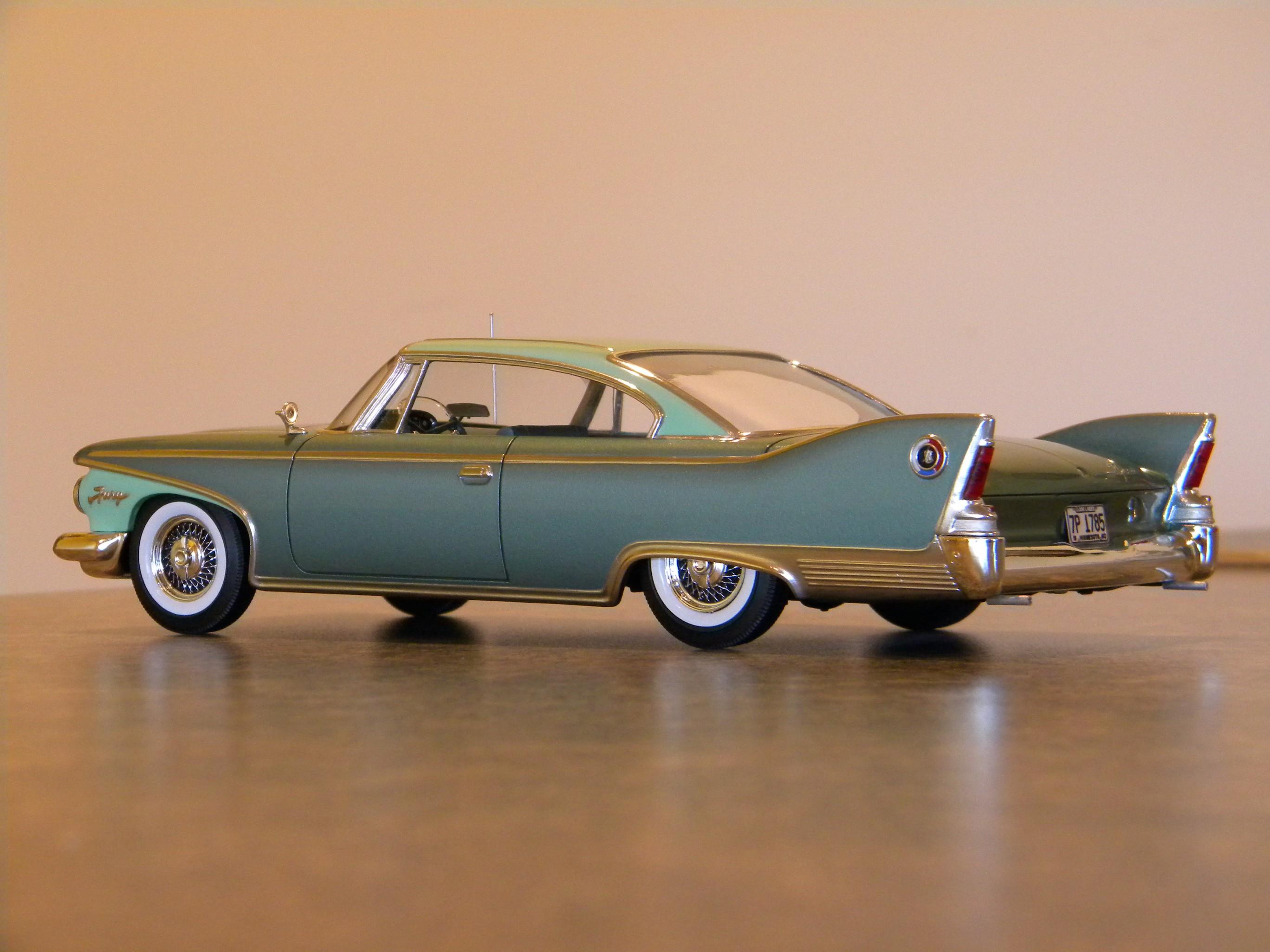

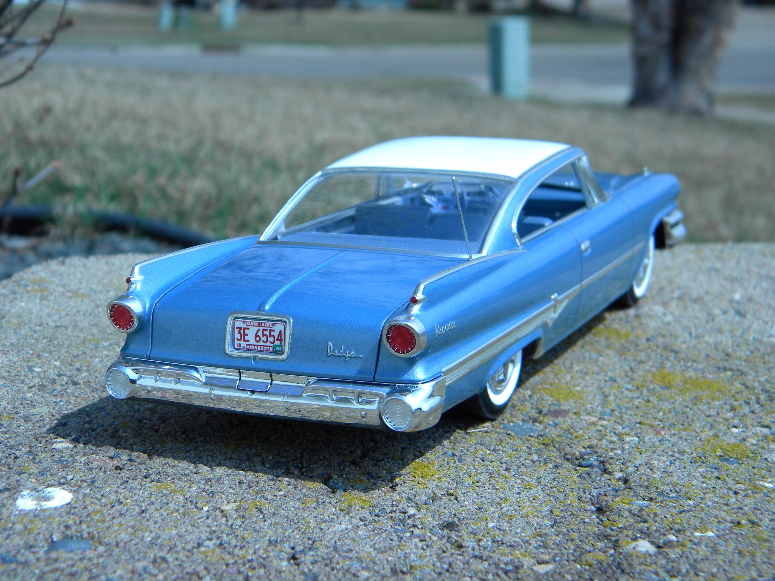

I’m not knocking BMF. I use it. But the MIG is a great alternative to where I don’t need BMF. Such as my illustrated photo.
Link to comment
Absolutely!
There's always room for new tools and materials.
I just have real reservations as to whether or not this is a true "BMF Alternative".
It might be an acceptable substitute in certain circumstances, but my gut tells me it's not a replacement.
Steve
  • Like 1
