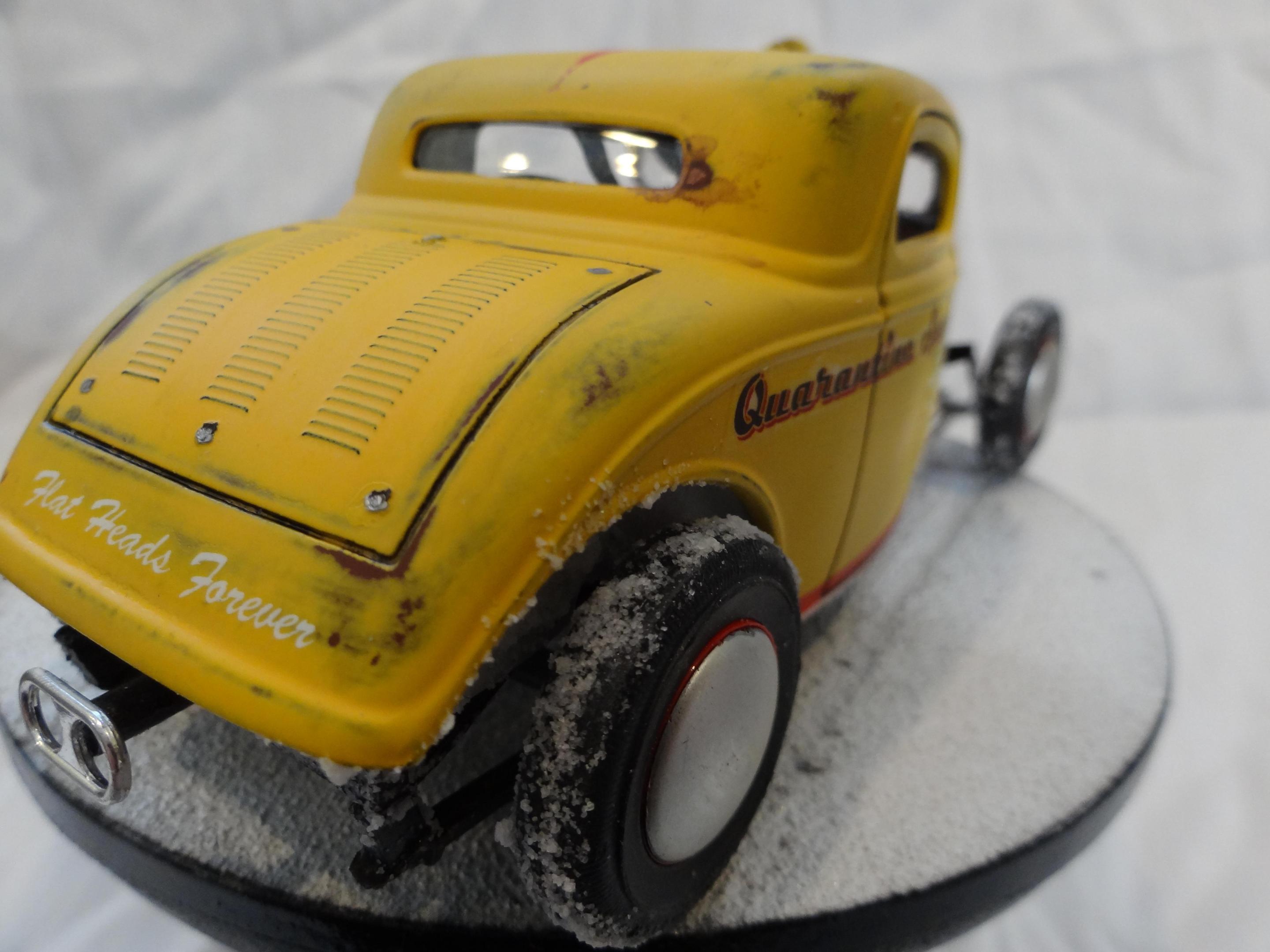

Plowboy Posted November 29, 2022 Share Posted November 29, 2022 I've done louvers a few times. But, not on resin. Only difference is the glue. The way I do it is graft the louvers from a panel that has them onto the panel that doesn't. I cut each individual row of louvers. I place the row of louvers onto the panel, trace around it, cut out the section and glue the row of louvers in. Then repeat the process until done. The toughest part is sanding between the rows of louvers. I made a sanding stick from sprue with sandpaper glued to it. Quote Link to comment Share on other sites More sharing options...

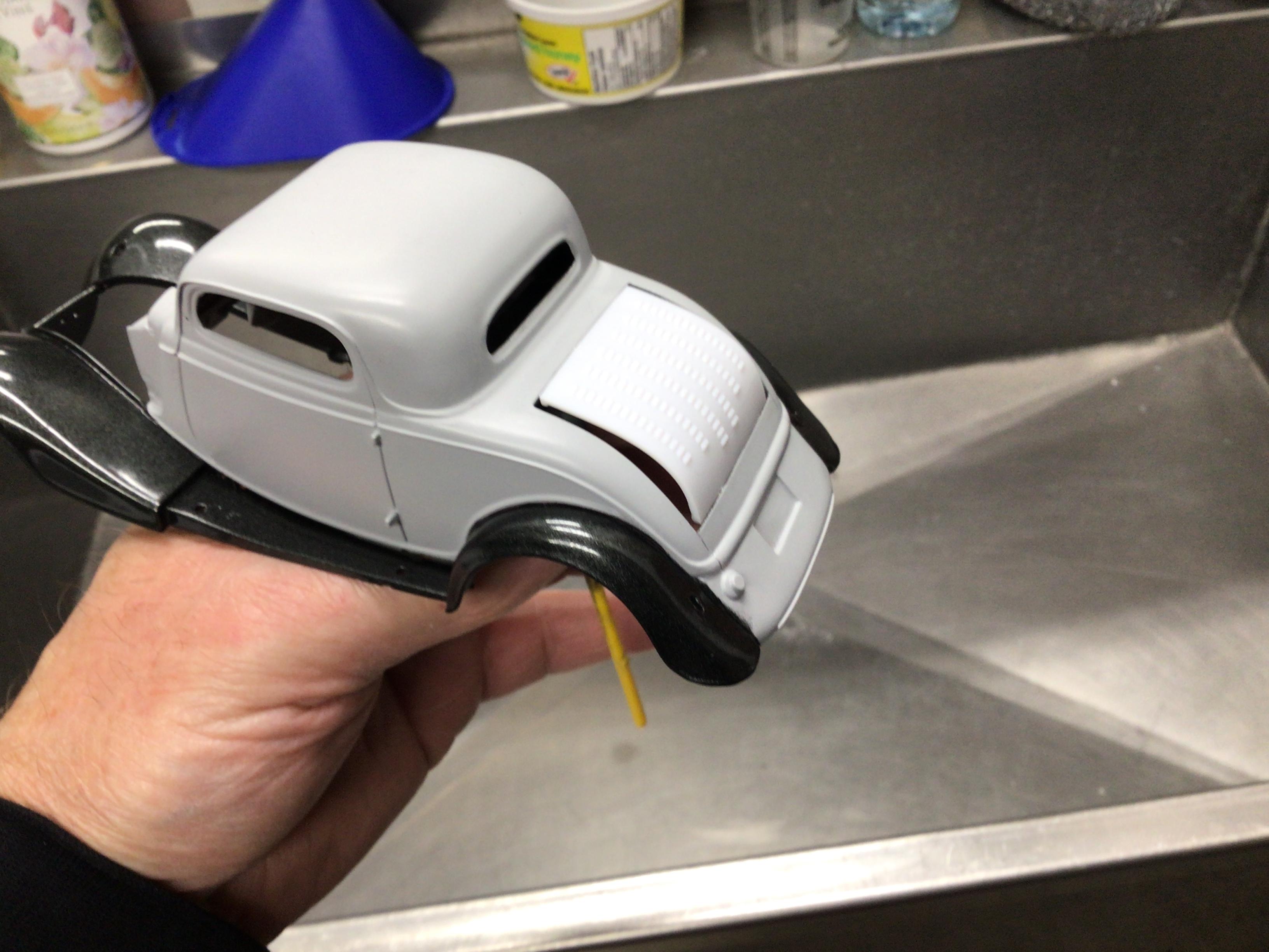

Plowboy Posted November 30, 2022 Share Posted November 30, 2022 This model has resin copies of of the pieces I mastered using the technique I mentioned earlier. The hood sides were done differently. I did a tutorial on the TRaK forum if you want to look it up. How different are the '34 and '36 trunks? I think I have an extra resin trunk around here somewhere. 1 Quote Link to comment Share on other sites More sharing options...

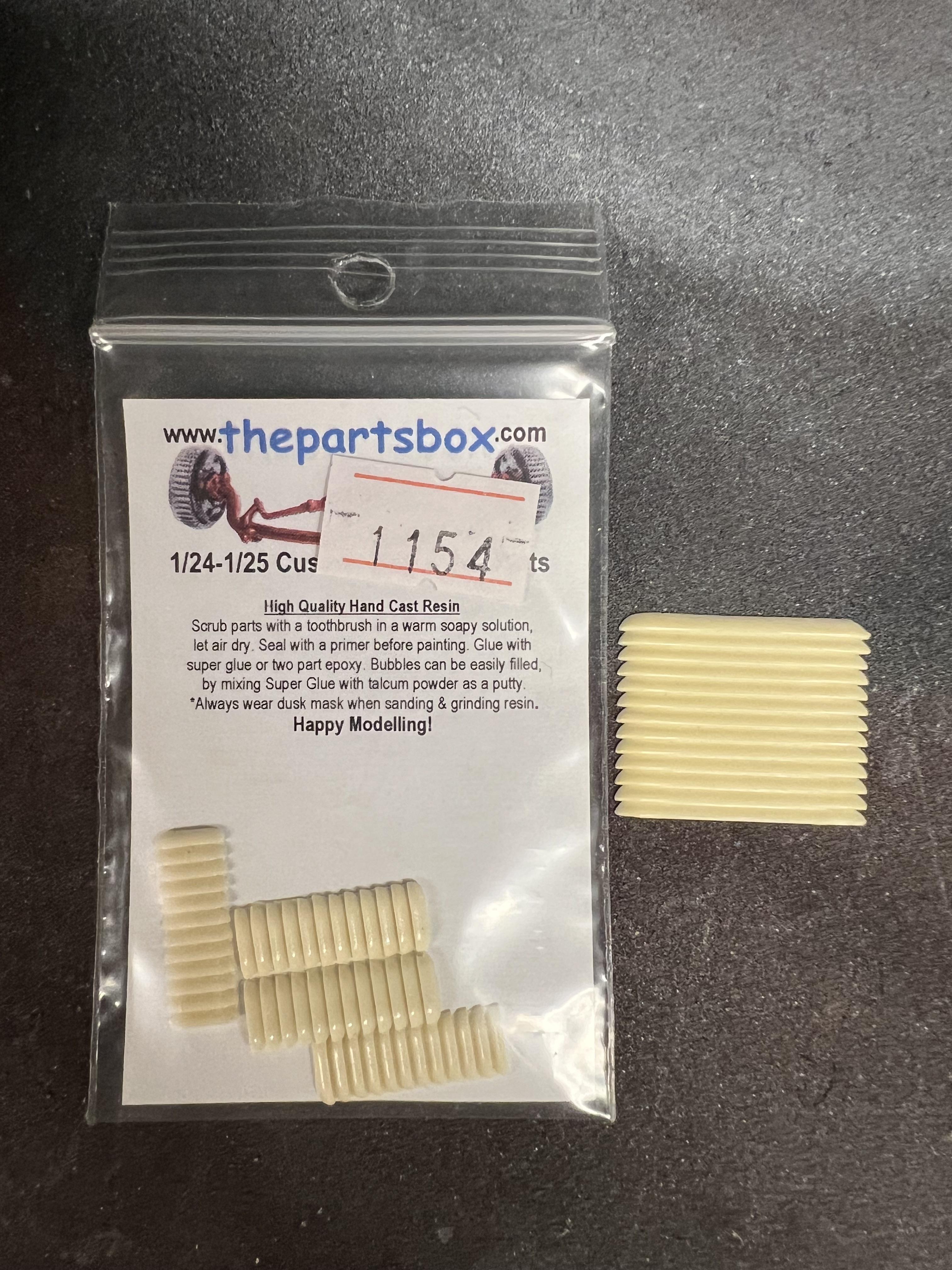

blizzy63 Posted December 1, 2022 Share Posted December 1, 2022 9 hours ago, Calb56 said: https://www.thepartsbox.com/shop/the-parts-box/exterior/accessories/louvres-x-4-l-19mm-x-w-7-5mm-x-h-1-5mmta/ Haven't used them but I really like their other resin. thepartsbox resin louvres are very good. They each measure 7mm x 18mm. I'm seeking louvres that are 9mm wide. On the right is a resin louvre unit from my parts box. It measures 25mm wide x 20.5mm. I don't know where it came from (!)... Quote Link to comment Share on other sites More sharing options...
Mark Posted December 1, 2022 Share Posted December 1, 2022 Those resin pieces look like copies of the short louver strips that came in some AMT and Jo-Han kits in the early Sixties. The wide strip also looks like a copy of another such piece that came in a handful of AMT kits. Quote Link to comment Share on other sites More sharing options...
