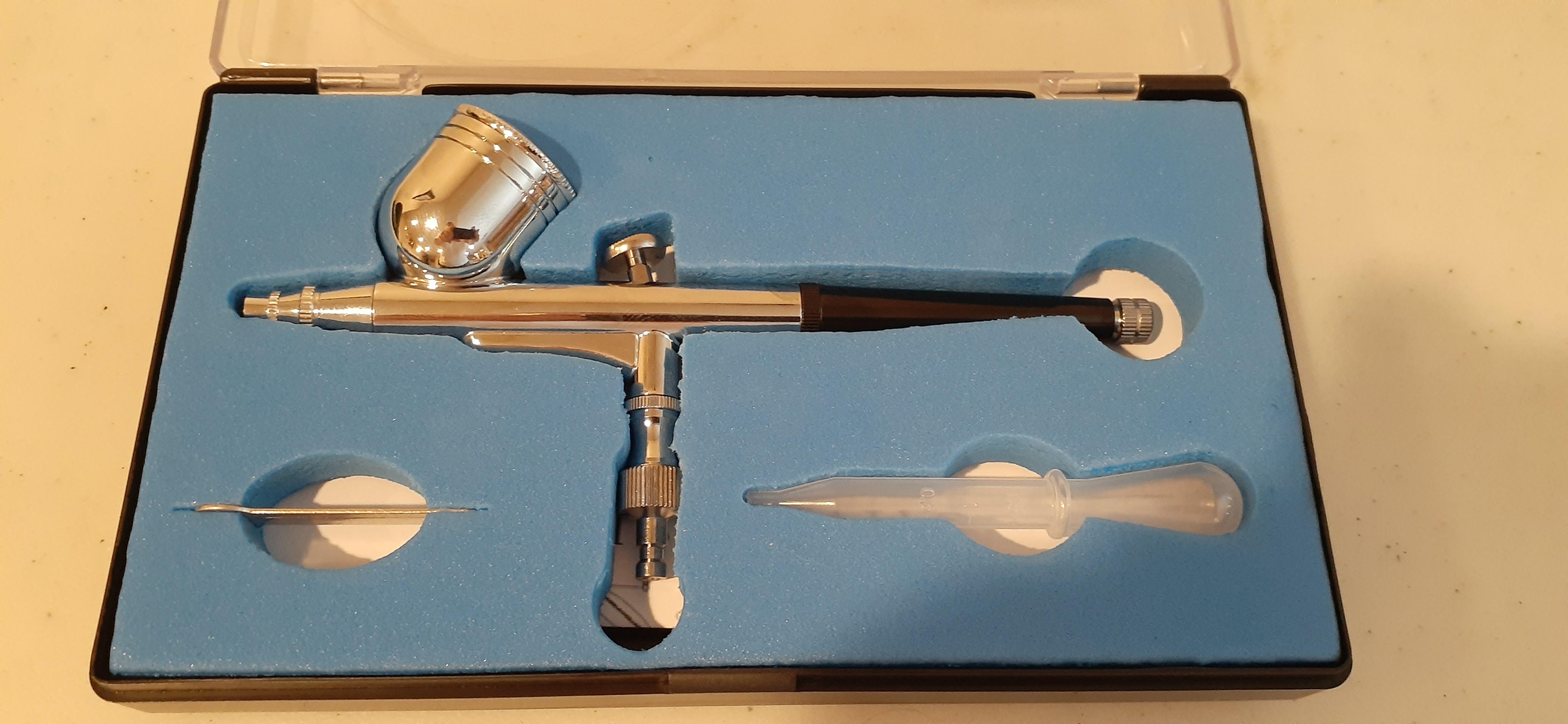

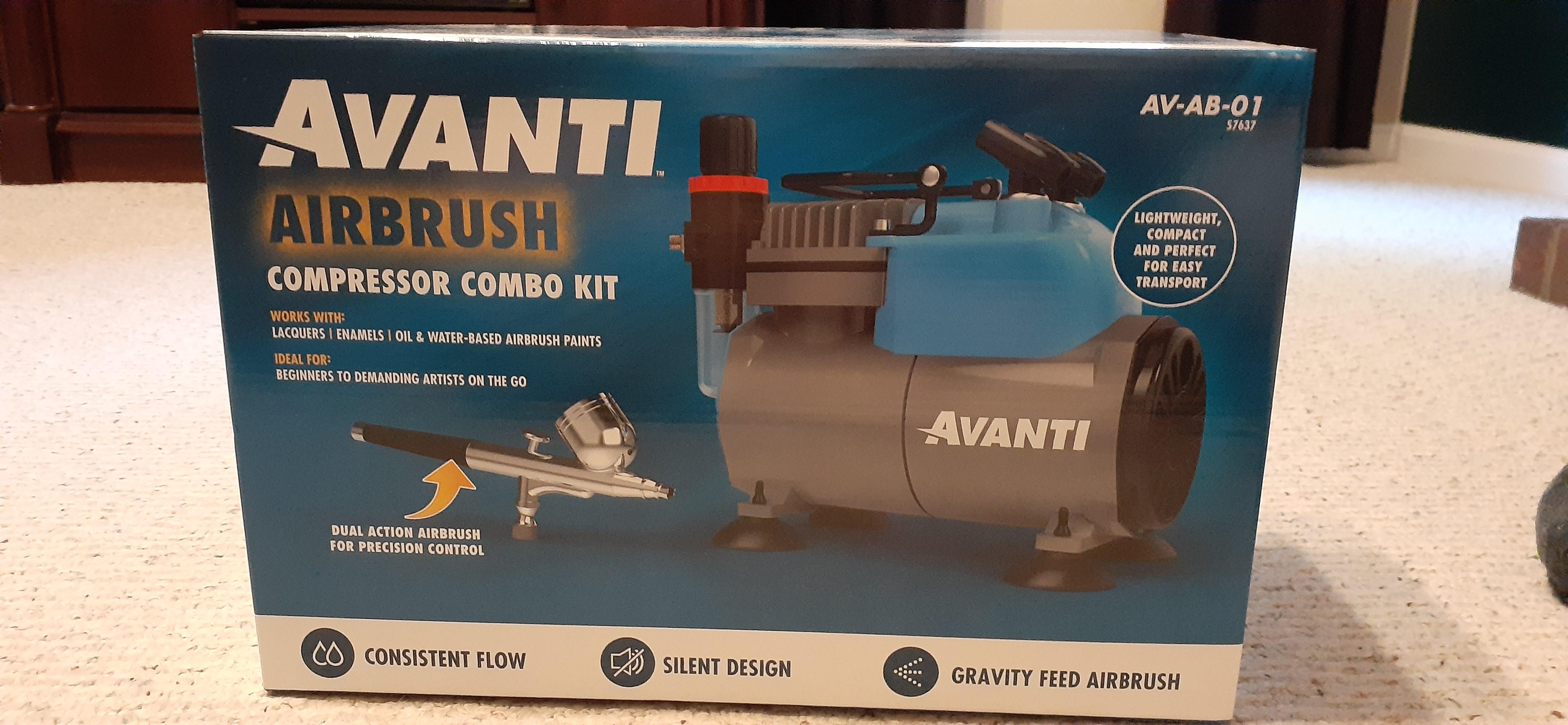

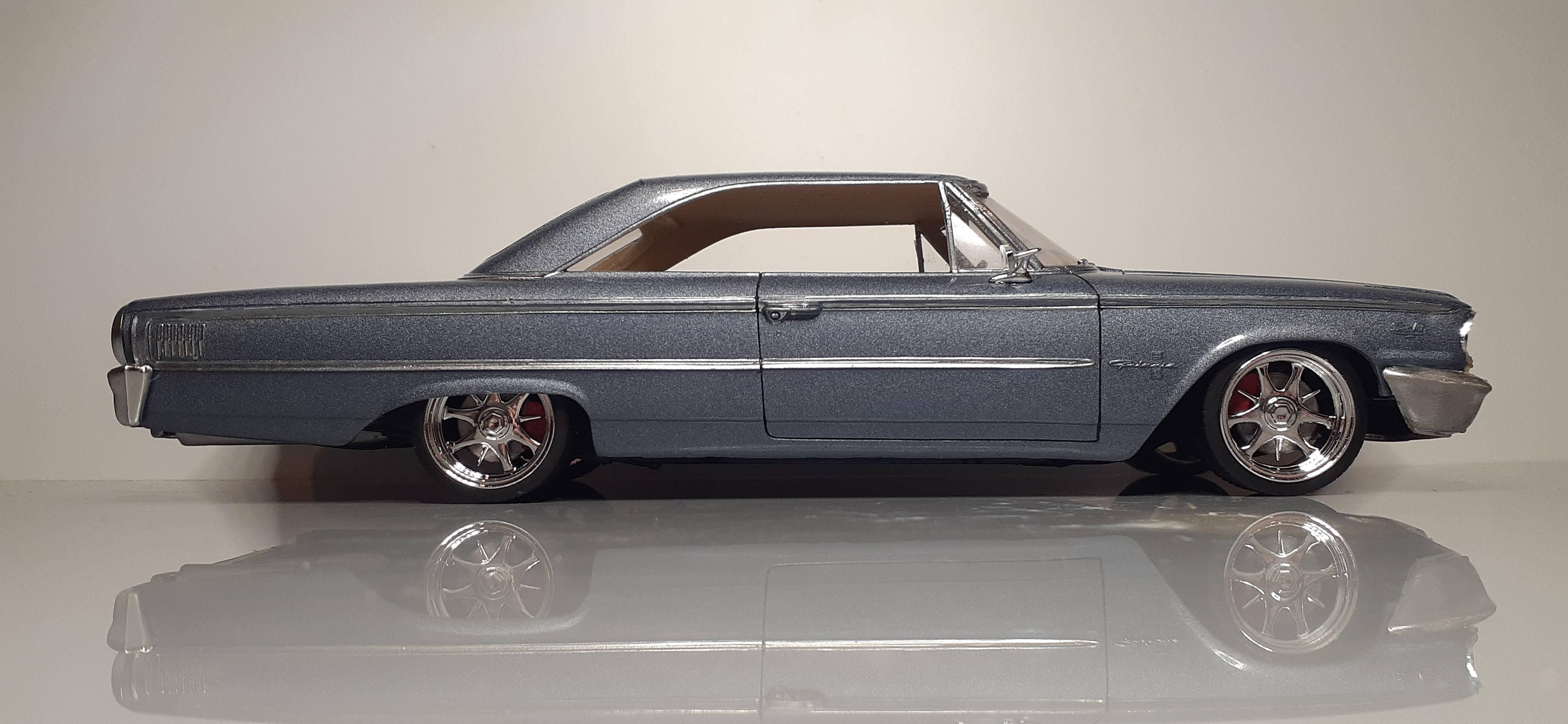

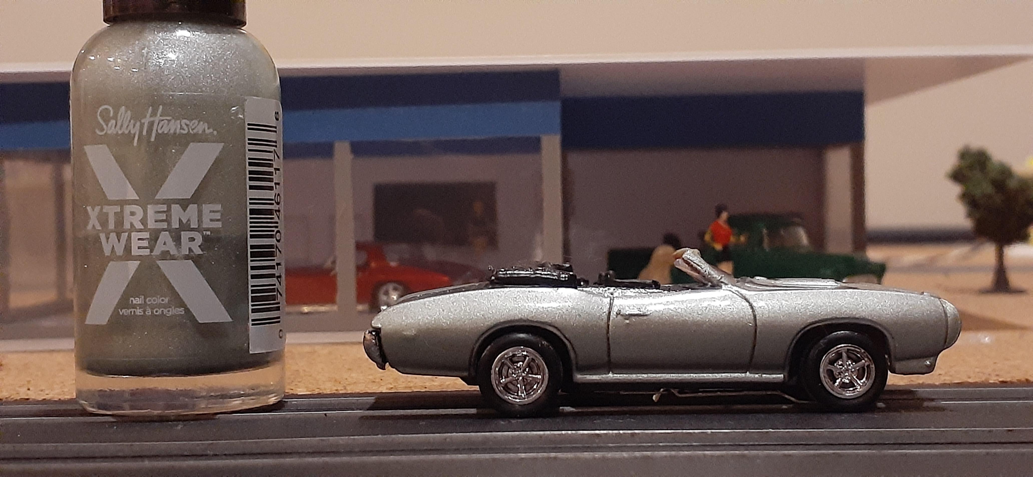

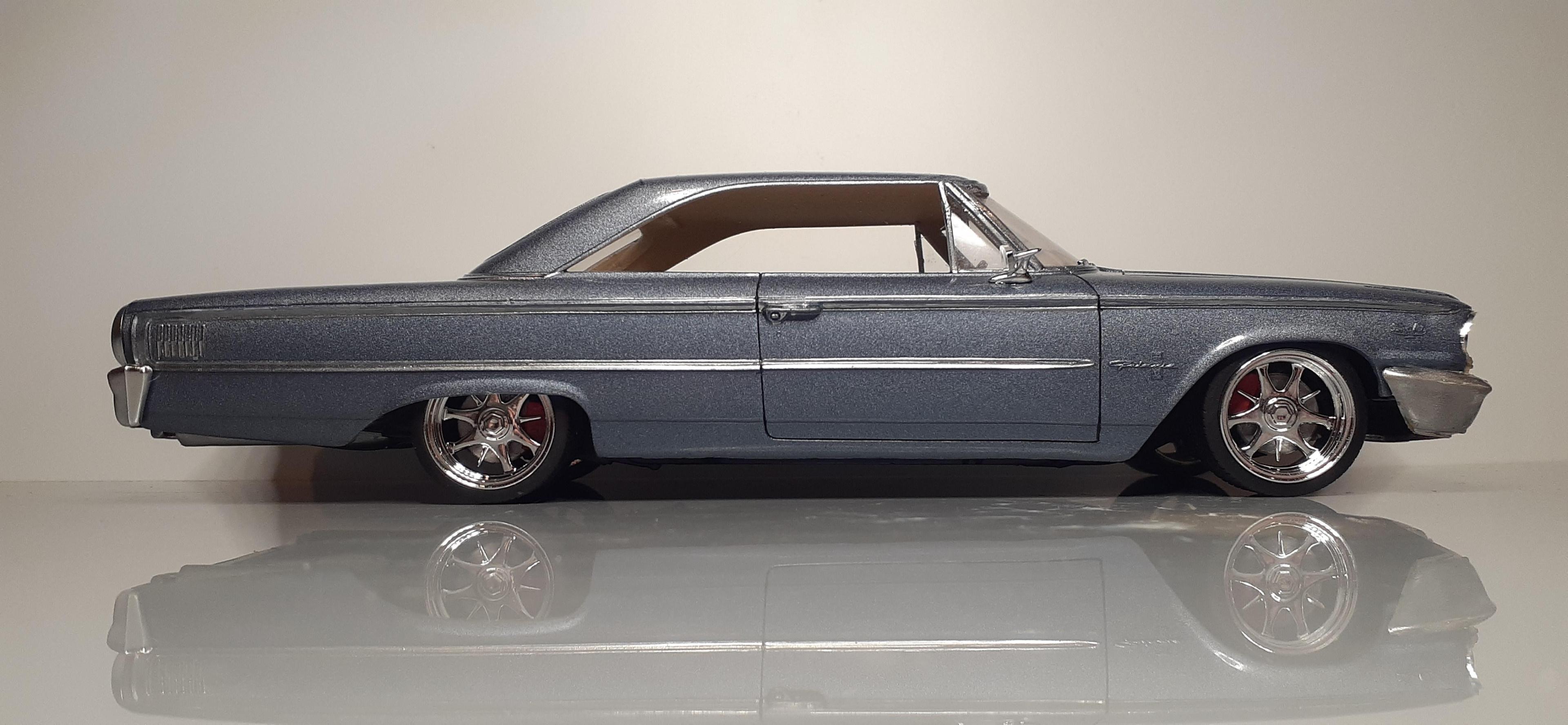

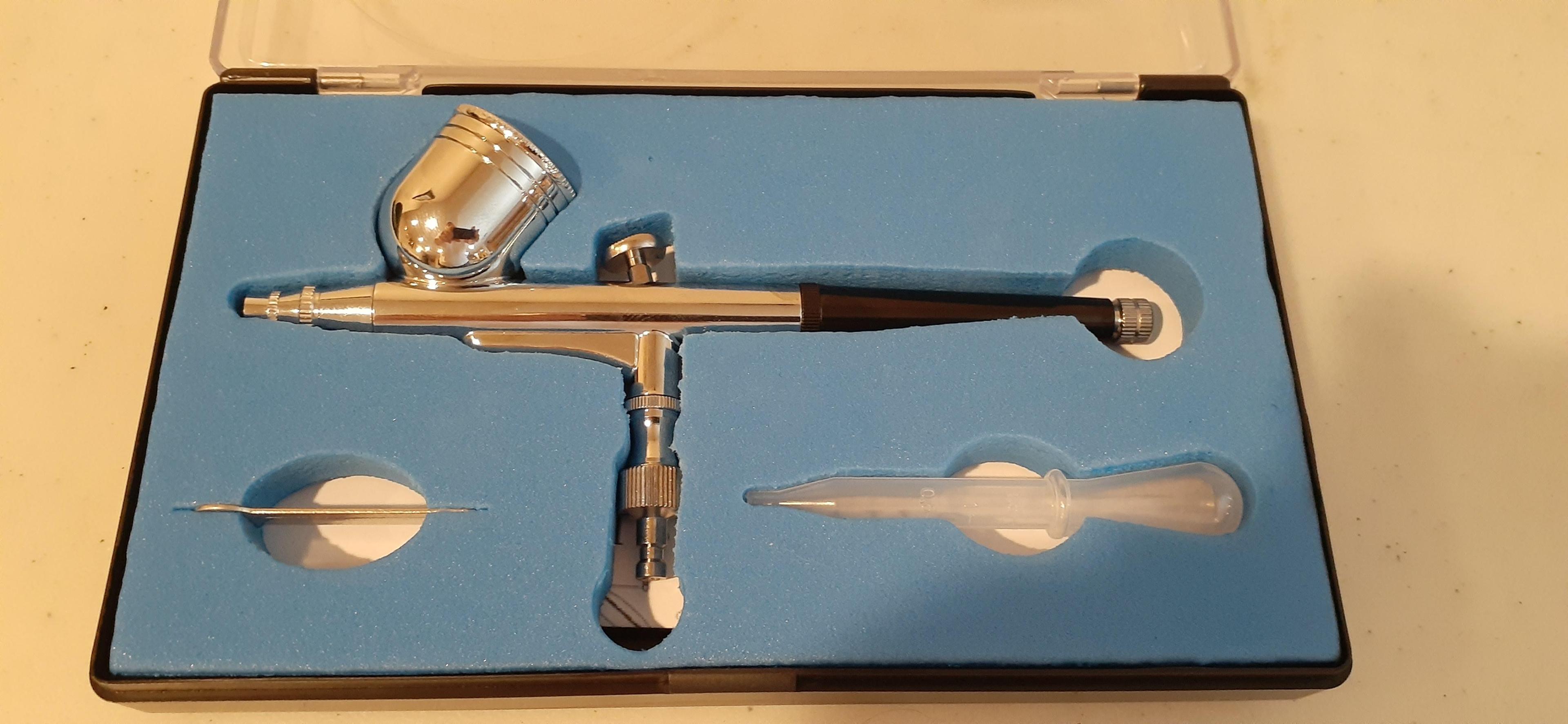

Slotto Posted September 22, 2022 Share Posted September 22, 2022 I bought this about a month ago. Wanting to up my paint game I thought I'd give it a try. I got them at Harbor Freight for about $118. Not knowing a whole lot about airbrushing I consulted You Tube and learned a few things. I've used it 5 or 6 times so far with pretty good results. So far I've shot the crafting acrylics mixed 1:1 with IPA 70% at 25psi and finger nail polish mixed with remover mixed 1:1 at 25psi. The only downside is the clean up process. I still use rattle can for bodies but have found this to be real useful to paint the head liners. Just my .02 Quote Link to comment Share on other sites More sharing options...
