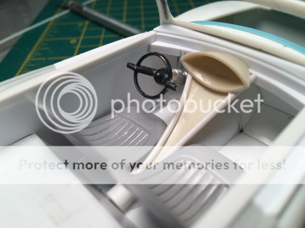

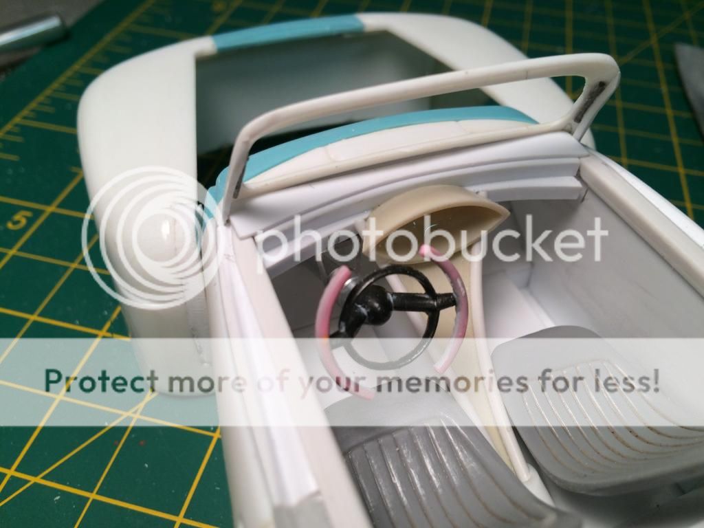

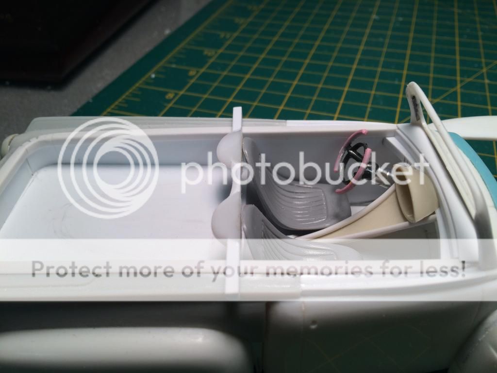

Impalow Posted February 2, 2015 Author Share Posted February 2, 2015 (edited) Love where your heading with this . Could I suggest you put a bit more rake to the windshield frame . Just my two cent's Thank you! That may happen... I want to keep that funky sixties look, but i agree that would look better. I'm transitioning back onto the exterior tonight now that the interior is shaping up. Last night I added some detail to the center console and mounted the seats(AMT 49 Merc? I think) Then the steering column (Detail Master) And the steering wheel (59 caddy) Then I started on the "targa bar/headrests" (more spoons) after some conversation with Exesivefire/Andy, I am thinking less targa bar more "floating" with an artsy stantion coming from the interior tub. This wont interupt the exterior as much, and look more 60's I am thinking.... Edited February 2, 2015 by Impalow Quote Link to comment Share on other sites More sharing options...

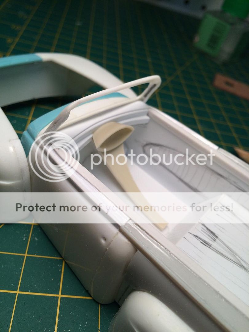

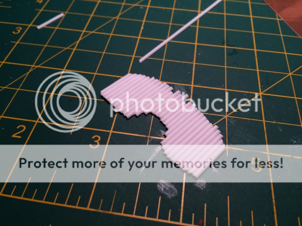

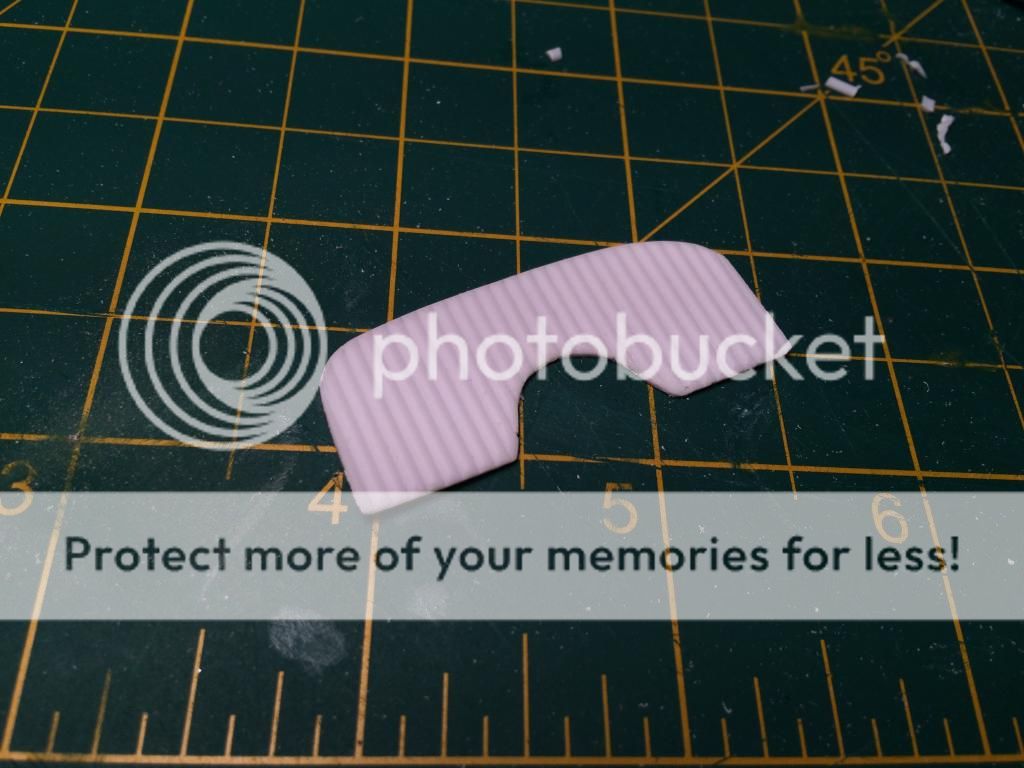

Impalow Posted February 6, 2015 Author Share Posted February 6, 2015 (edited) Thank you guys for all the kind words! You are all helping me stay motivated on this thing. Here is a quick update, I started working on the tuck & roll interior with the seats. Each pleat is .060 styrene half round and I'm planing on using detail master ingition wire as piping.. First time doing any of this, but so far im happy with the result, I'm also happy that there are only two seats and the rest is somewhat flat. (excuse my nasty fingers) Next up is the exterior styling... I knocked out one side last night, not my cleanest work by any means... but it will get some filler and be fine. Just need to make the other side match and I can move on to the grille and filler/primer. Edited February 6, 2015 by Impalow Quote Link to comment Share on other sites More sharing options...

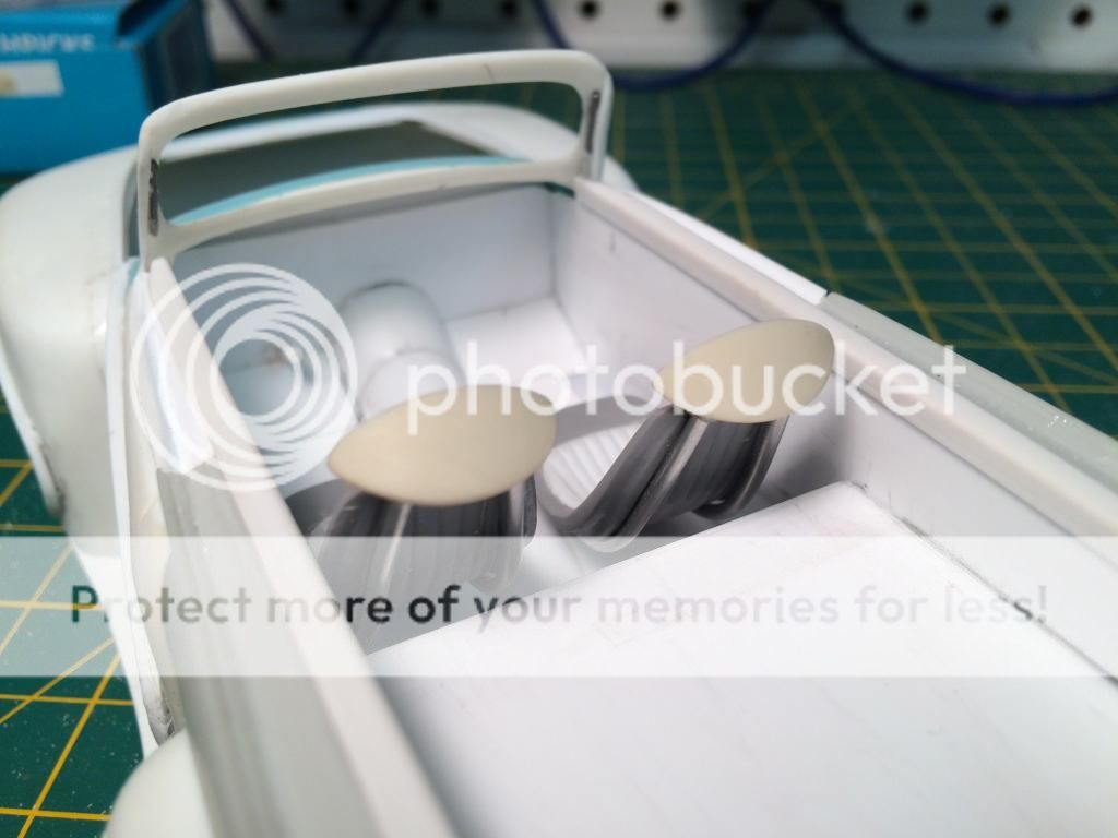

Impalow Posted February 9, 2015 Author Share Posted February 9, 2015 (edited) Thank you guys! Made the Wendy's spoon headrests today, changed up my original idea on that. Went with independent headrests for each seat on floating tubing supports. Need to stop stalling on the grille design and fabrication. Edited February 9, 2015 by Impalow Quote Link to comment Share on other sites More sharing options...
