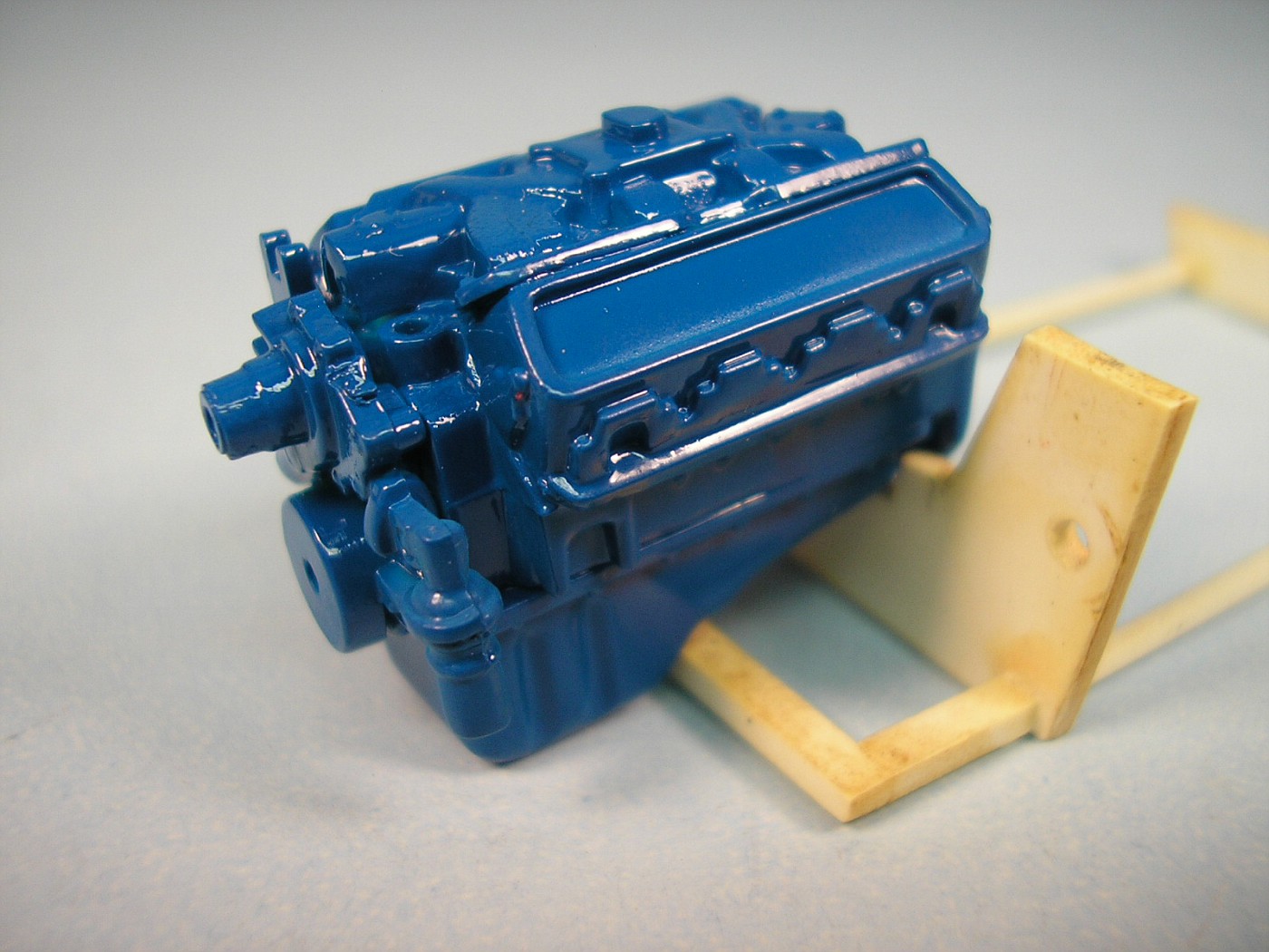

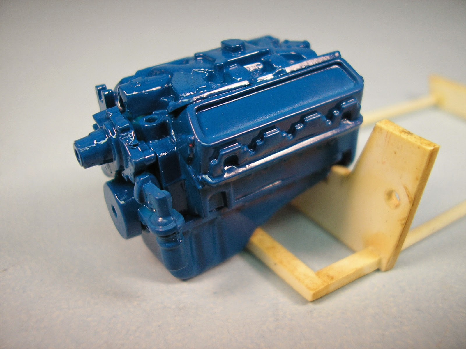

Well, here’s what I have so far……….I’m pretty much done with the body work including the glass, so it’s time for me to move on to the engine. I started with gluing some of the sub-assemblies together, and then painted these as a unit. The block, heads, oil pan, water pump, and transmission parts were all airbrushed as you see here.

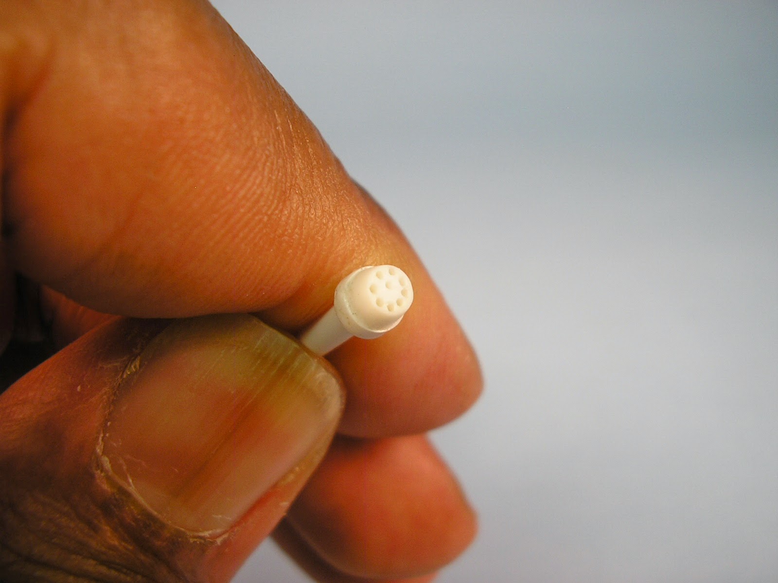

While these were set aside to dry, I wanted to start work on making my own distributor. While I could have gone out and bought one of those pre-drilled ones, they lack some of the detail that I want to put in. Namely plug boots, (which I could add) and a vacuum advance.
A challenge for me would be to make those angled spark plug boots that you might see on older cars………especially cars that have the old points and condenser (remember those??).
I’m going to present now a mini tutorial on how I make mine………
First, since I work in an industry that deals with cables, I have access to all sorts of wires and shielded cable of all sizes. I’m not certain of the size that I’ve used here, but the diameter of what I have looked “right” to me in 1/25, so this is what I figured on using. I took my scale and measured 3/64” of the insulation.
Then I did an angle cut of the insulation-----the total length of the insulation is about 7/64”.
With a sharpened toothpick, I then wanted to expand the insulation slightly. Slicing the jacket deforms it somewhat and I wanted to get back the roundness that it had. I did this to both pieces.

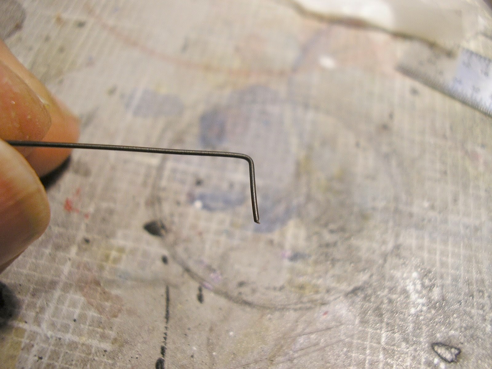

Continuing on, I then took some 30 AWG black kynar wire and made a sharp bend to it………..
Then just simply slipped the insulation on the wire………
Notice how there’s a “break” in the insulation? I just filled this in with gap filling super glue, and used some Zip Kicker to speed things up.
Now since super glue tends to “frost” when dry, I'll just painted the frosted area Polly S Engine Black.
Now just repeat this eight more times and there you’ll have it! :)
